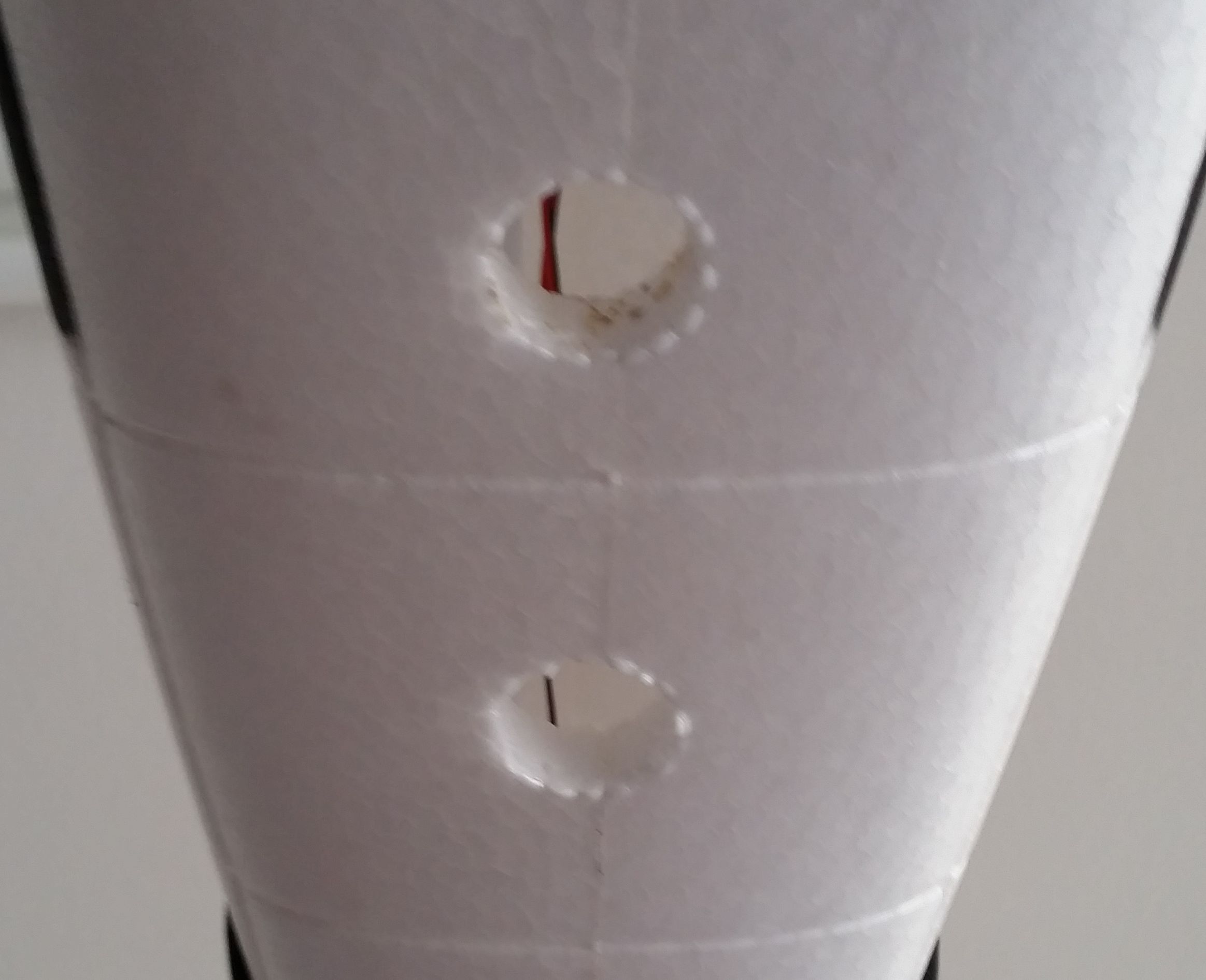

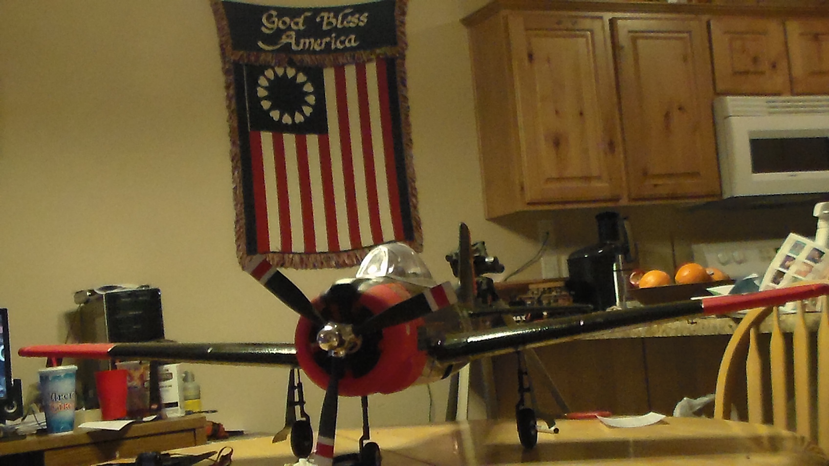

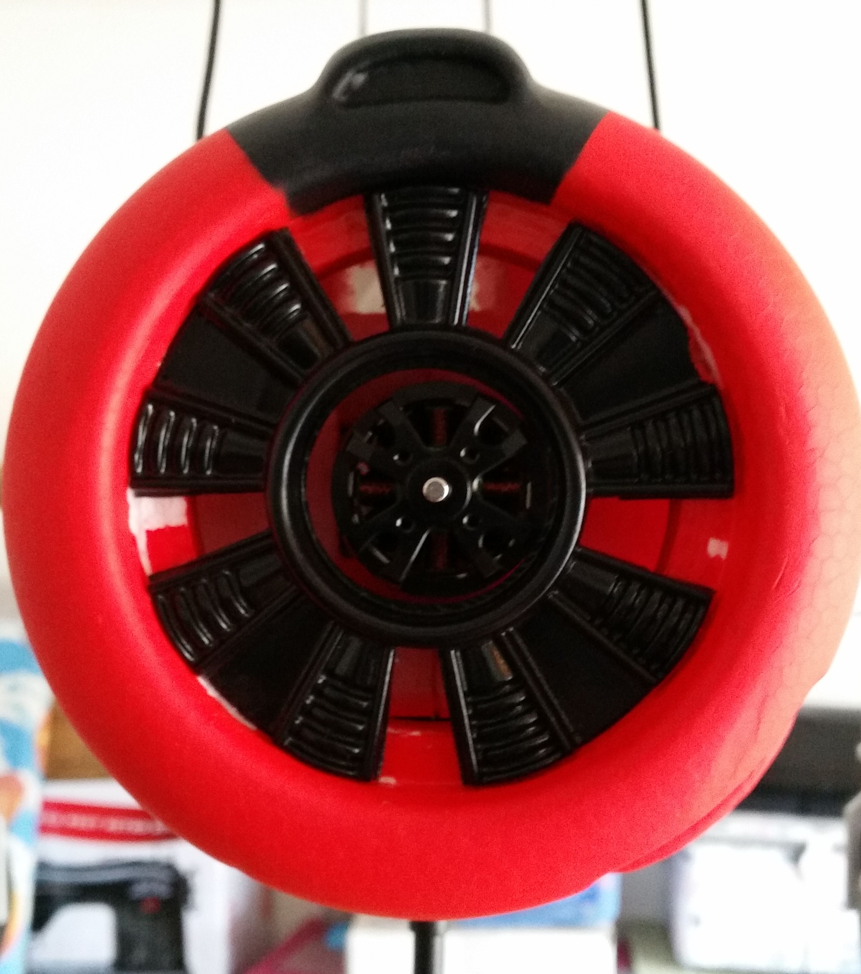

      Here is the cooling mod I did to my T-28, I also cut a hole behind the cowl to help cool the battery down.
        I'd suggest putting a Velcro strap around the battery, so it won't fall out if the canopy flies off. I found out the hard way; doesn't fly well with the battery in a cornfield. I also added an extra couple magnets so I don't have to buy another canopy.

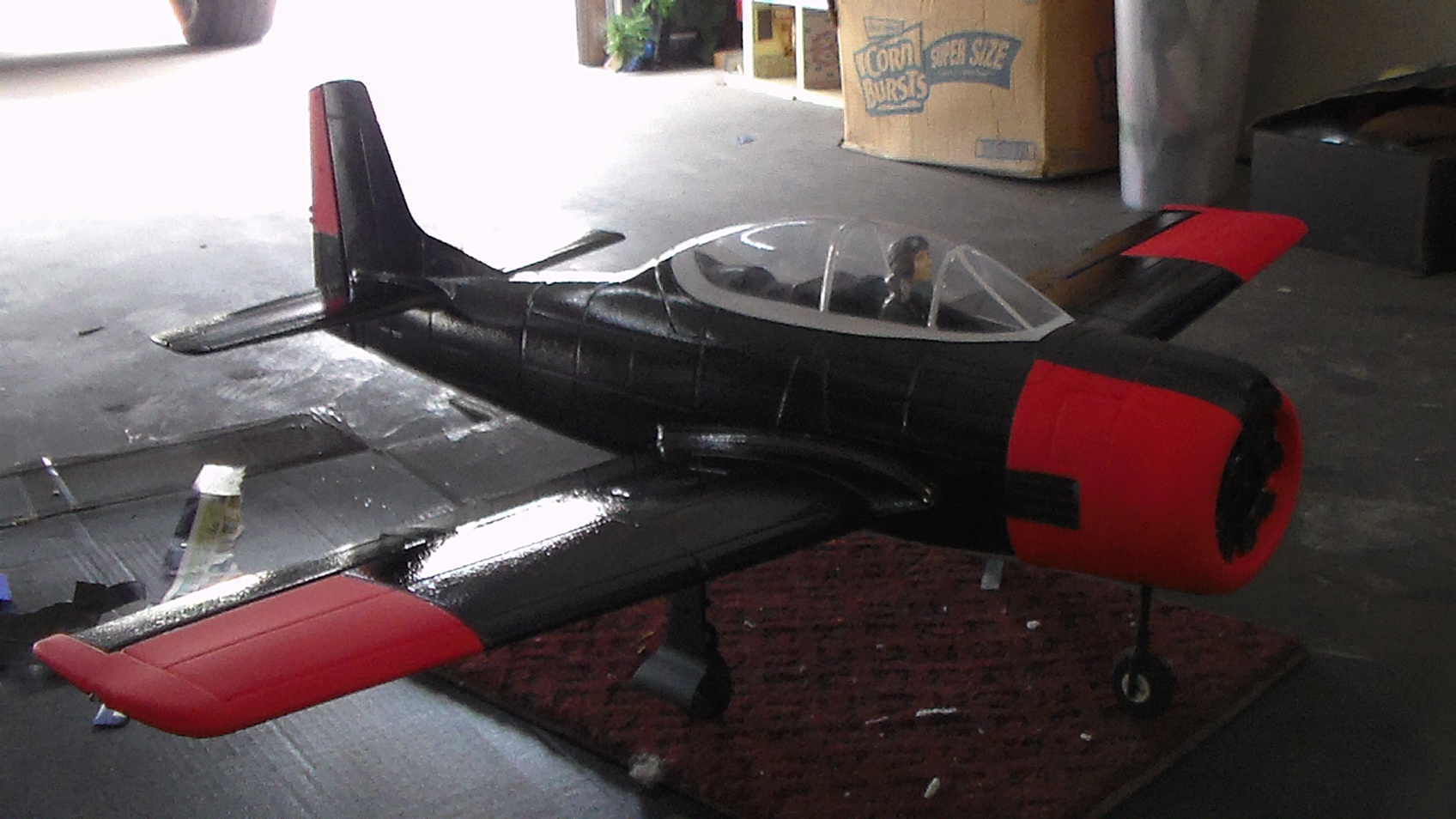

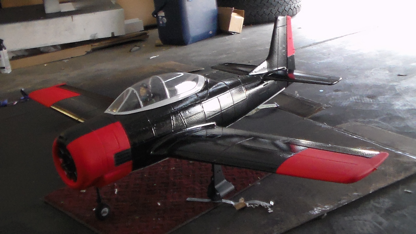

              T-28 is getting a paint job today; figured I cant fly it, paint it!

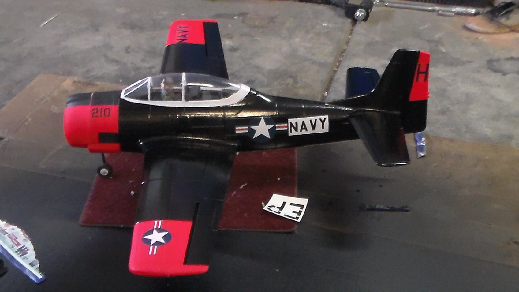

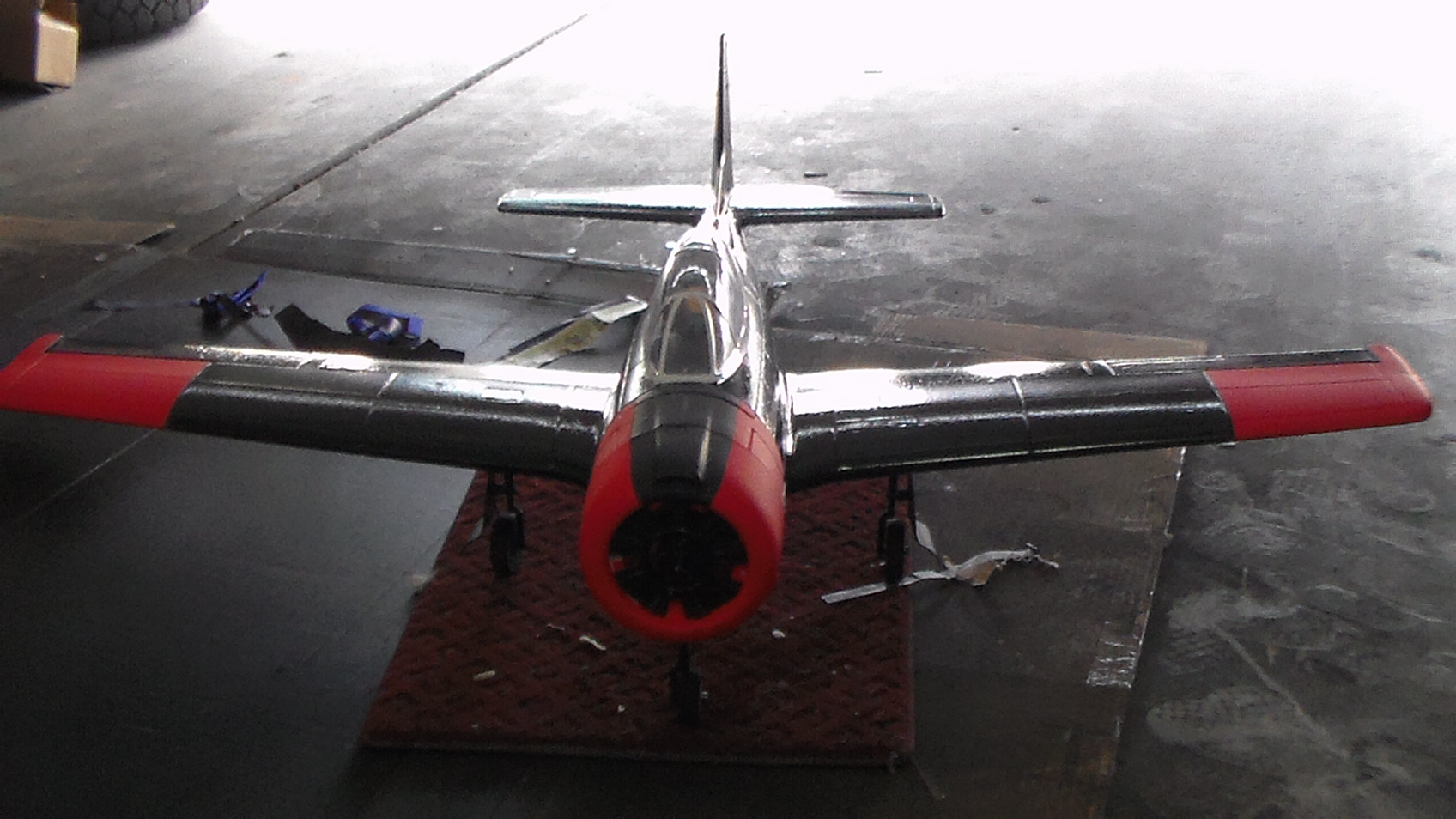

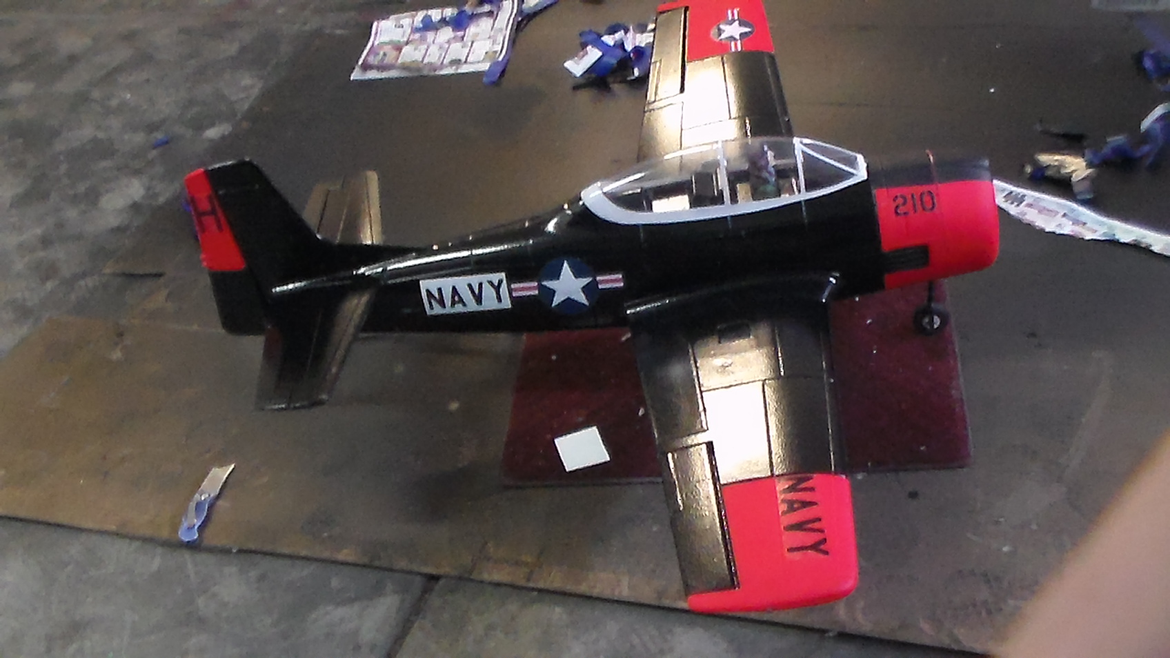

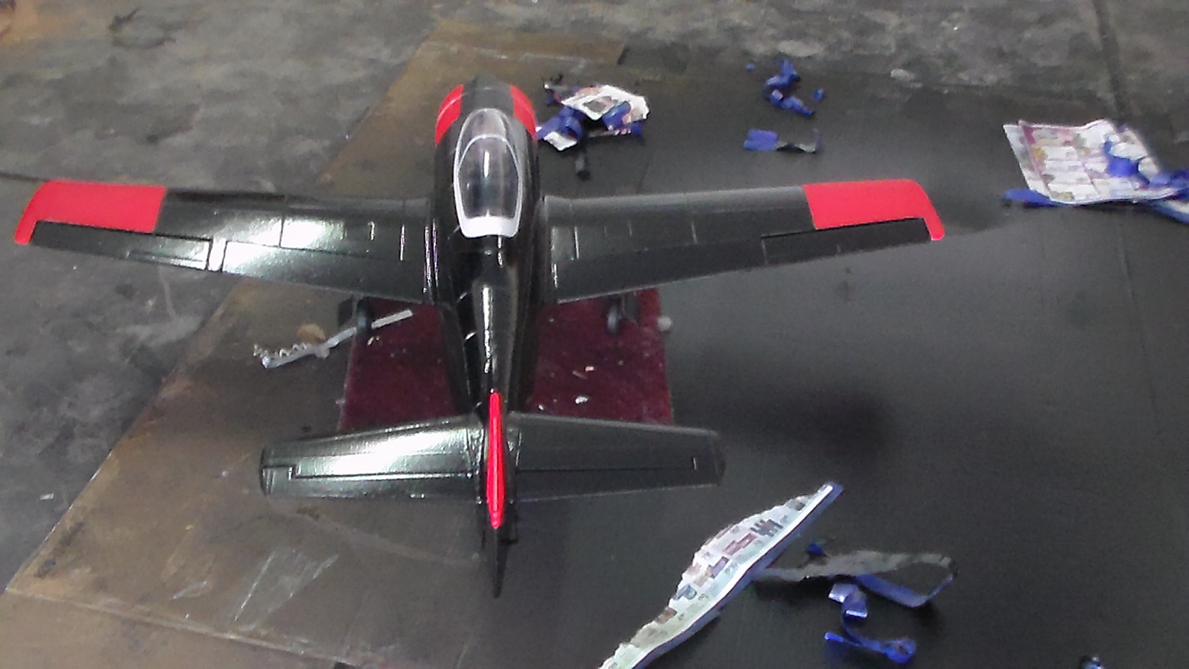

                RE: Dynam T-28

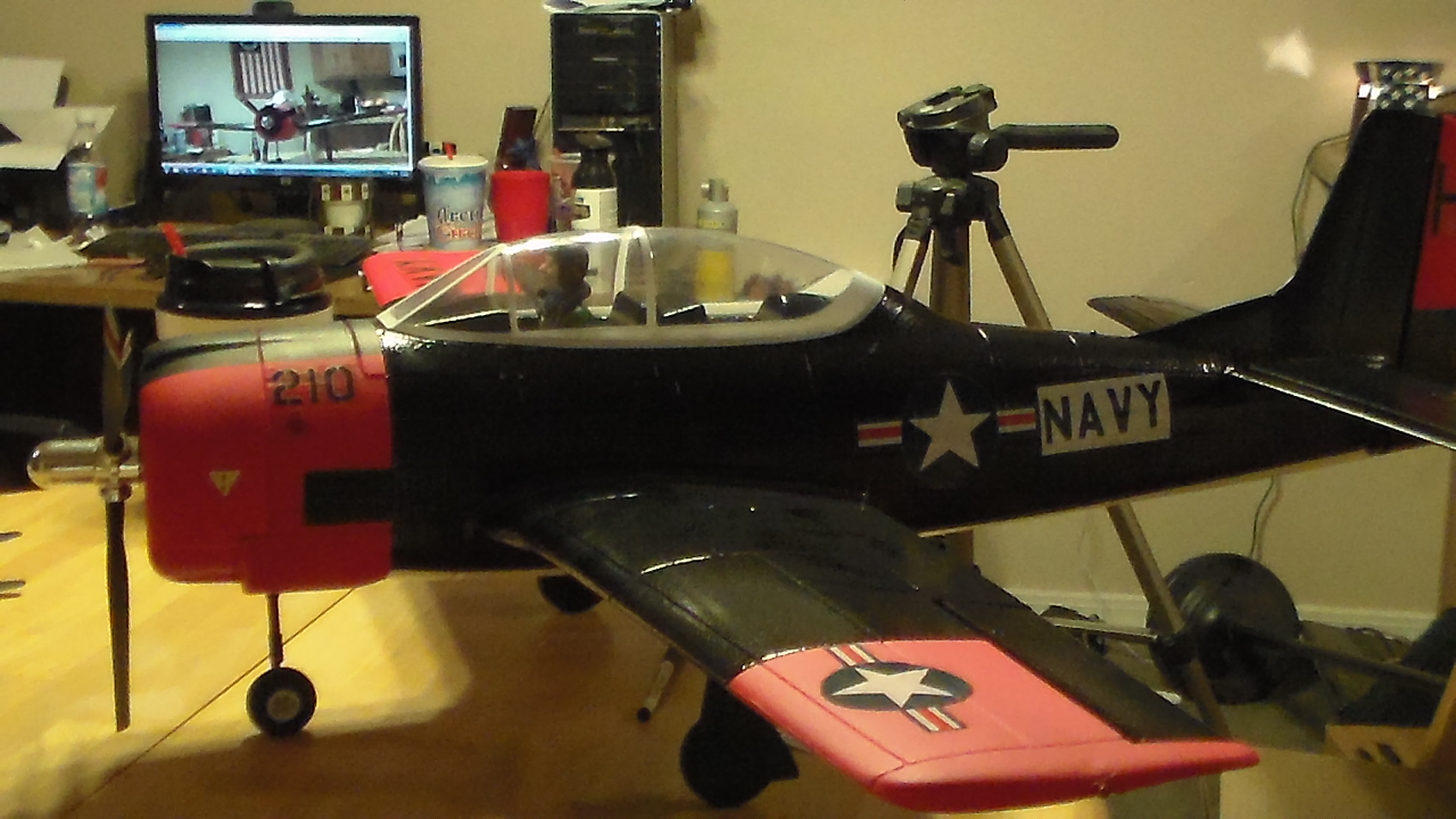

                Paint job done! I like it, what do y'all think?
                Just sticker it up and it will be finished!
                got the decals on.

                  Sean,
                  Going back to your unboxing video and the question you threw out concerning the beacon wires. They weren't cut, Dynam does not put connectors on the lights in most if not all their birds. Also the LED's are not 4-6v lamps but are 2.5v and are basically crap. I ripped them out of my Waco and put FMS lites in.
                  On the repaint, what is that color and are you going for a racing scheme cause from a scale perspective have never seen that motif?

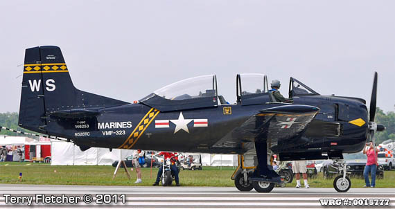

                    RE: Dynam T-28
                    Its gloss black, I was not really going for any certain look, I just felt the plane looked cheap, half done in the white. My wife and I were talking I was going to paint it to look like the picture below as I am a Marine but the wife wanted to keep the red, long story short she won on how it got painted. Honestly I like the way it looks; it is not "scale" but it gives the plane attitude.

                      Sean,
                      I had never seen the VMF version. That is a damn good look. To be pretty honest here, you should've stuck your Marine chest out and stuck by your guns and honored that VMF-323 livery. Get those red Navy trainer tips off that model and do yourself a righteous Marine T-28. You asked what we thought so that's my input for ya   :P
