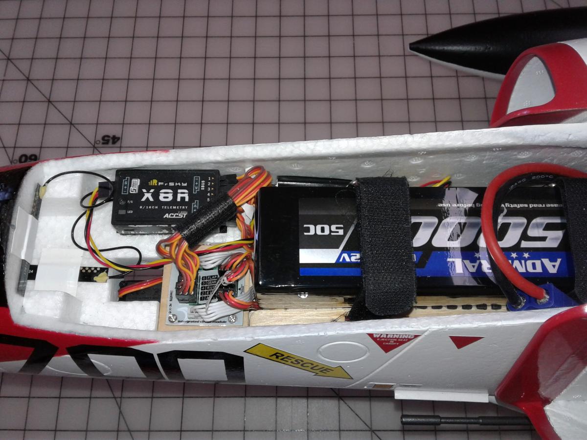

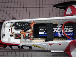

      I use short pieces (usually 2") of this velcro wrap. Works nicely and is easily removable for maintenance. I also use white electrical tape to hold wires flat against foam or in those wire channels. It sticks well to foam and blends in.
      And it's not that you have OCD. It's that sloppiness has become the norm these days. I always remove the wiring and re-run it in these PNP kits. I hate wires under tension and/or twisted.
      Click image for larger version  Name:	20180314_145304.jpg Views:	4 Size:	138.4 KB ID:	151402

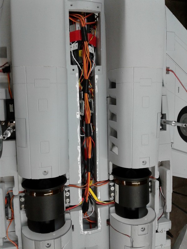

            Here is a shot of my velcro wraps in action on the su-35
