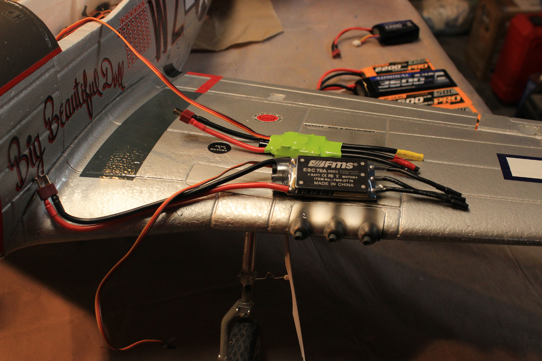

                                  Hey Guys and Gals, just an update regarding the esc swap on the P51D
                                  As you can see, the stock battery lead is a lot longer than the Mantis, why I couldn't tell you.
                                  So, if you're going this route, throw in a set of 3.5 mm motor leads to make up for the short coming, I just went 100mm and it worked fine.
                                  I'm sure that for those of you who are better at soldering than I am could lengthen the battery lead, but for me this was the easiest route to go.
                                  Now, since this is done, it opens up a whole new world for me.  I can go 5s now which I'm thinking of doing, just to see.  The combination of the 85A ESC and the 580kv motor really adds some pep to the plane.
                                    By the way, I pulled the trigger on the FMS 1400mm P40B so I'm really looking forward to that as well!!
                                    I'm with you on the soldering. I just can't seem to get a good result, so I go with the same method you used! I am really looking forward to reading your impressions and first flight reports on the new P40. Beautiful plane!
                                      So, if you're going this route, throw inut a set of 3.5 mm motor leads to make up for the short coming, I just went 100mm and it worked fine.
                                      Gman,
                                      If you do try 5s. You will find yourself going to it all the time after the experience. I still run 4s on mine because i'm waiting for the 5s to recharge:).
                                      I got some flights in yesterday. First couple flights was with the 5s. While 5s was charging i put a 4s in. While flying i found myself pushing the throttle forward, but i was already a click or two from maxed out! I'm sure Santa is going to contribute to my inventory of 5s this winter, making 4s flights with the Mustang rare next year.
