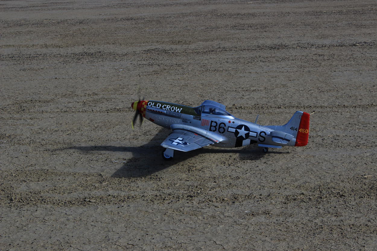

        As you might have gathered, I'm replacing the wings on Old Crow, it's given me a chance to rethink the placement of the light and gear boxes as well as the gyro.

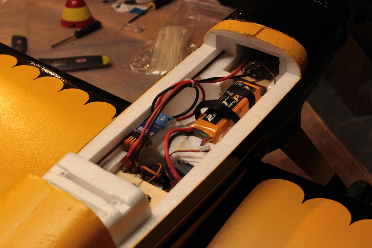

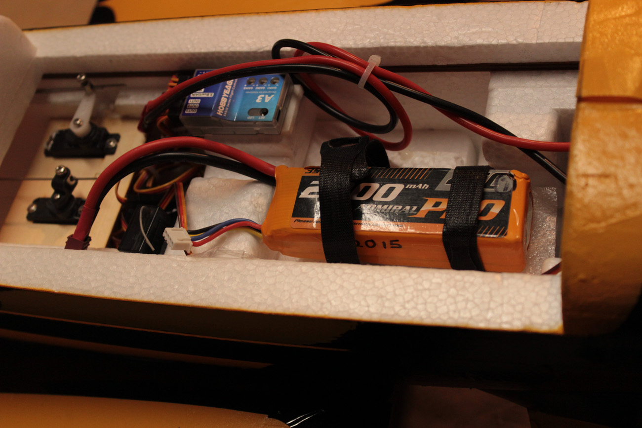

        As some were asking whether you can get a gyro in one of these beasts with a sound system, here's the route I went.
        As a side note, I'm using Dubro double sided sticky tape to anchor it as this stuff really works (LHS)
        Just waiting on the wings.  I ordered them first, then remembered I needed a shell door servo, so went back and ordered that as well as a spare nose an set of props, hey, might as well make the $5 shipping fee worth while.  So, ordered within hours.  The servo and prop came yesterday through USPS.  Still waiting for the wings from UPS.  Seems USPS is faster in the case at least.

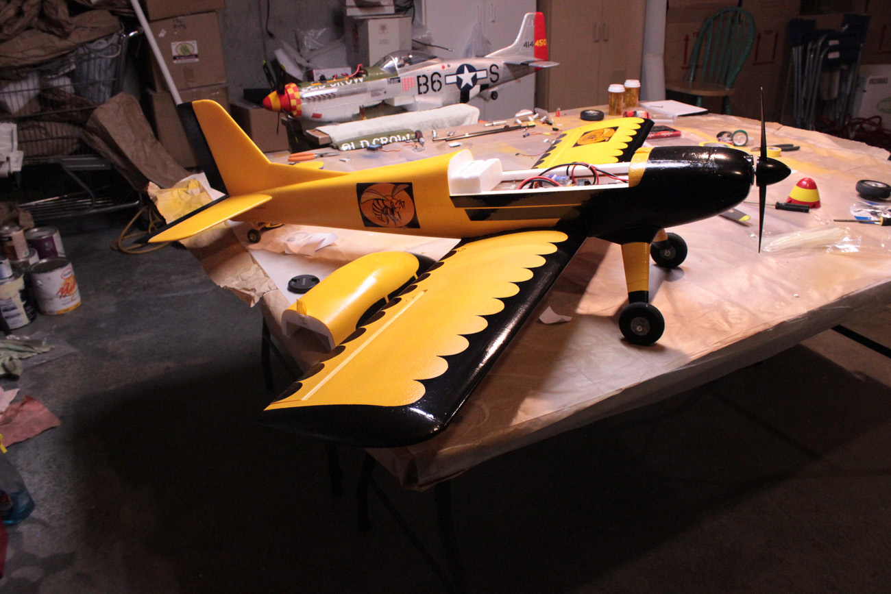

            Pandora Two in her new livery.  Did I mention that they're lots of fun to paint?  The decals peel off easily.

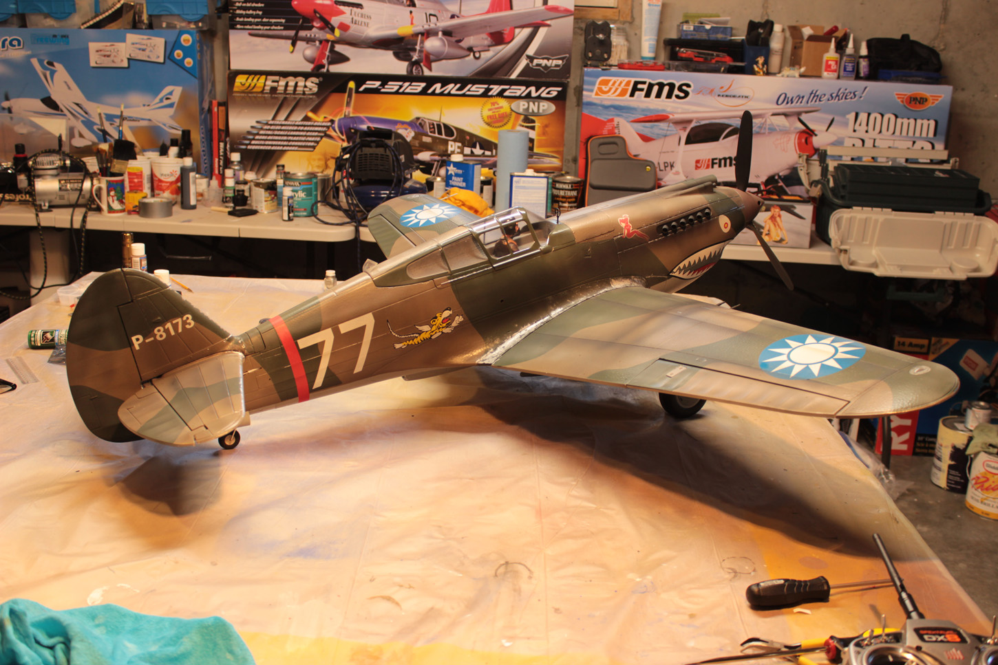

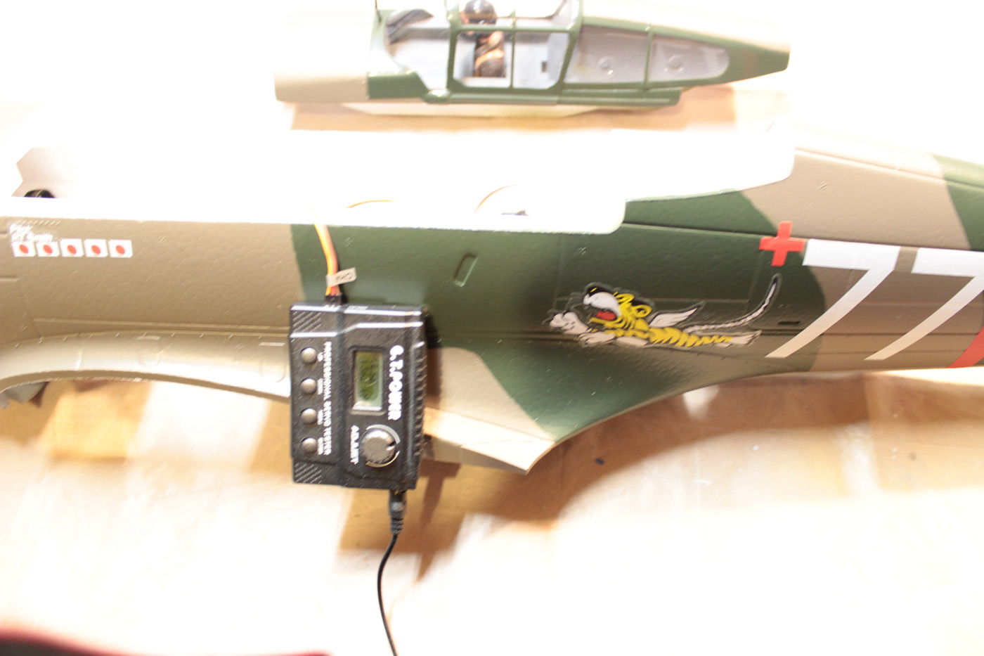

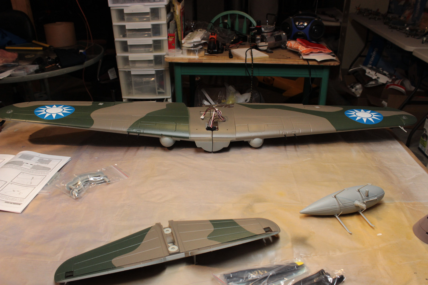

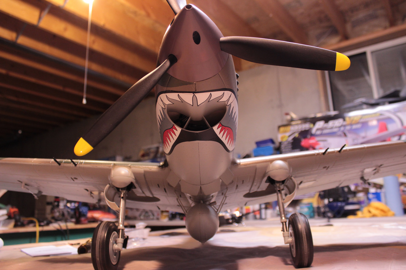

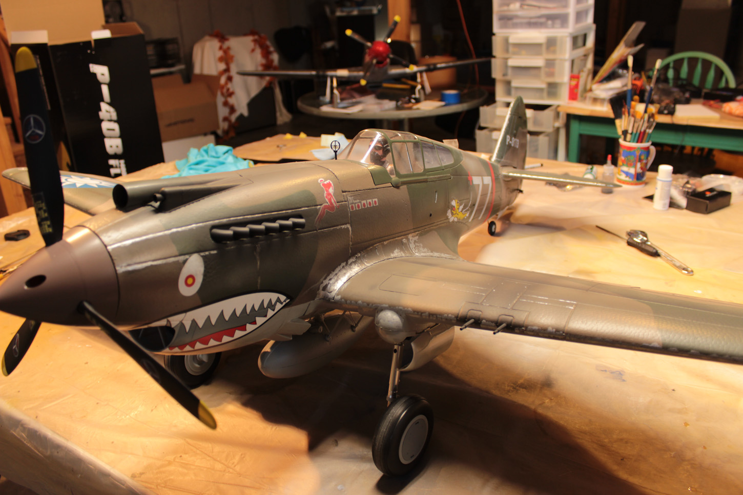

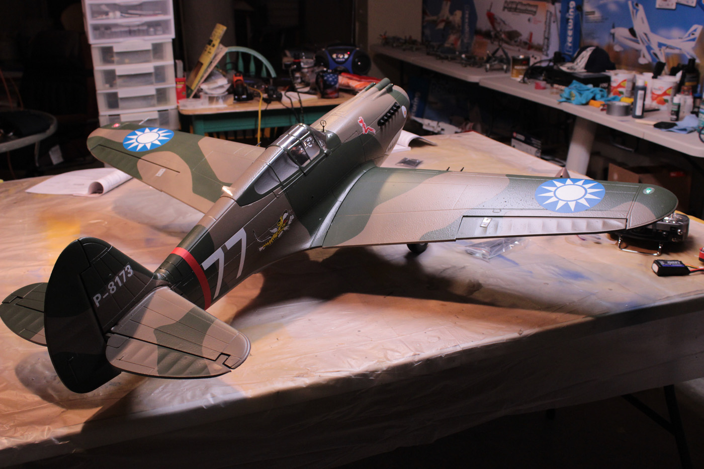

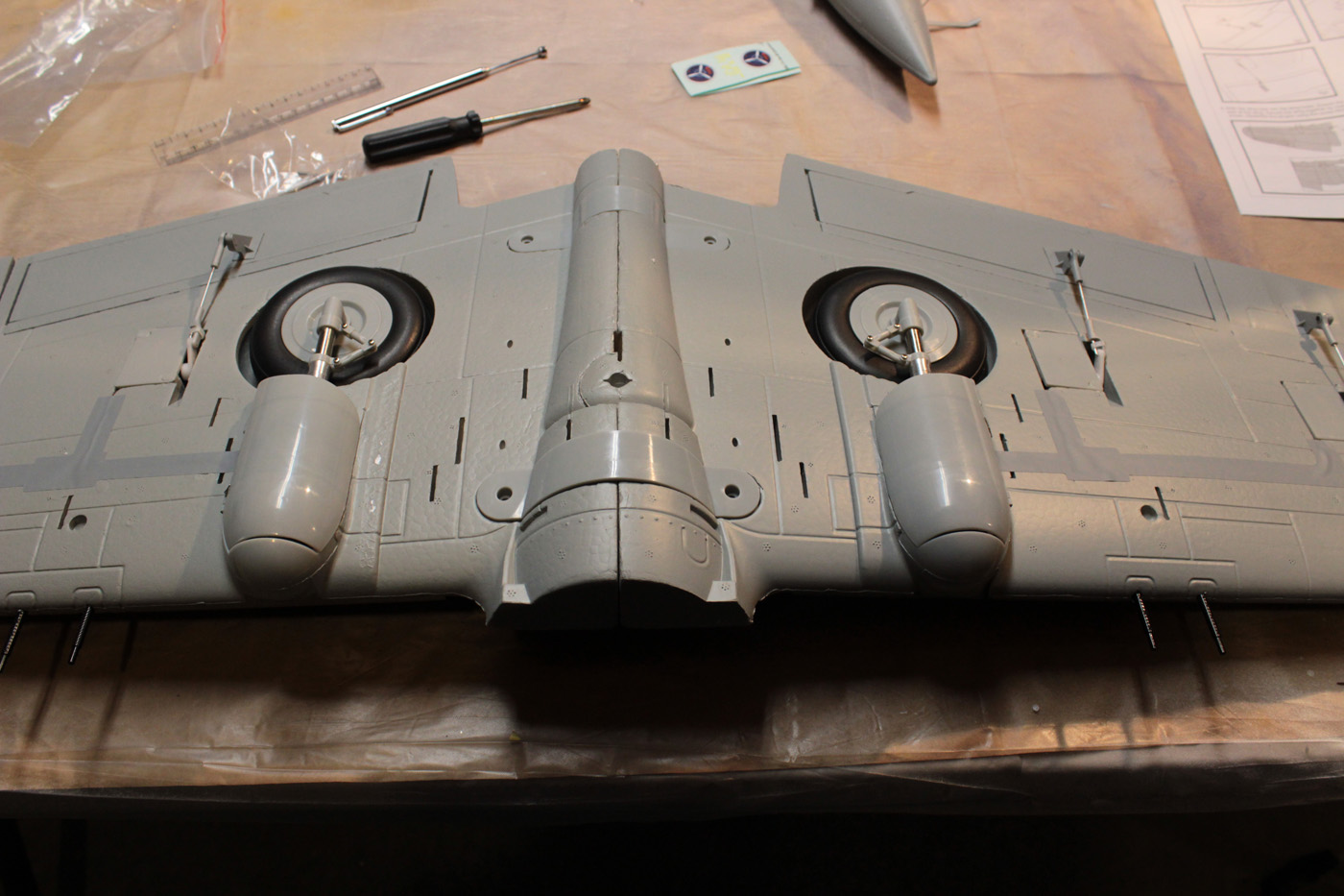

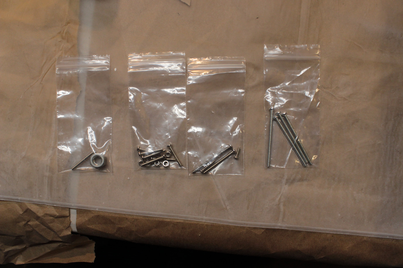

                    Hey guys, here's a basic builders guide/experience.  The instructions are......you guessed it, pretty poor, thankfully, the build is straight forward, so....

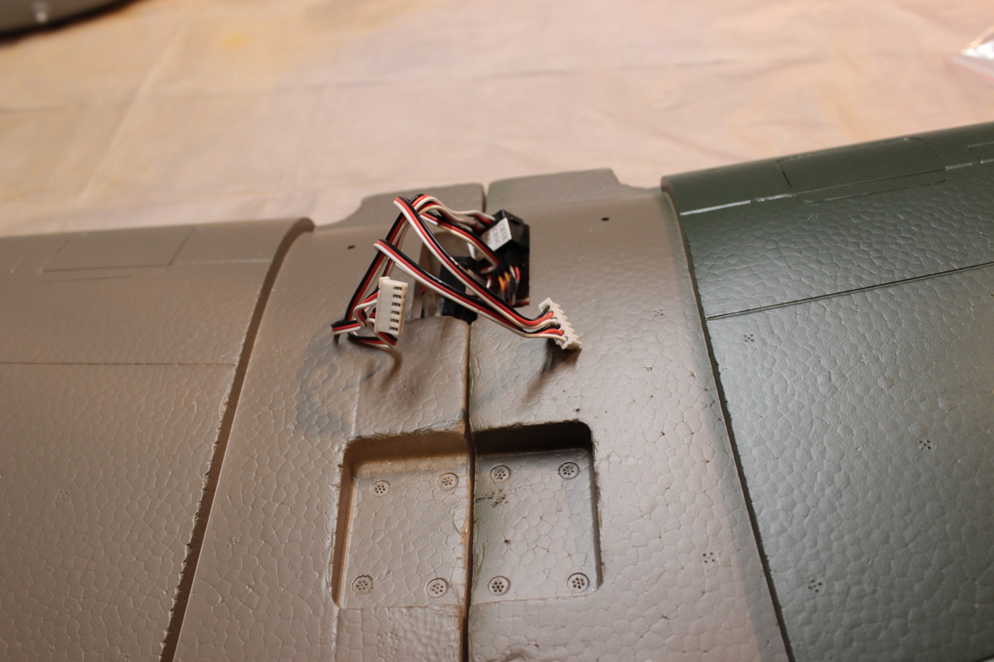

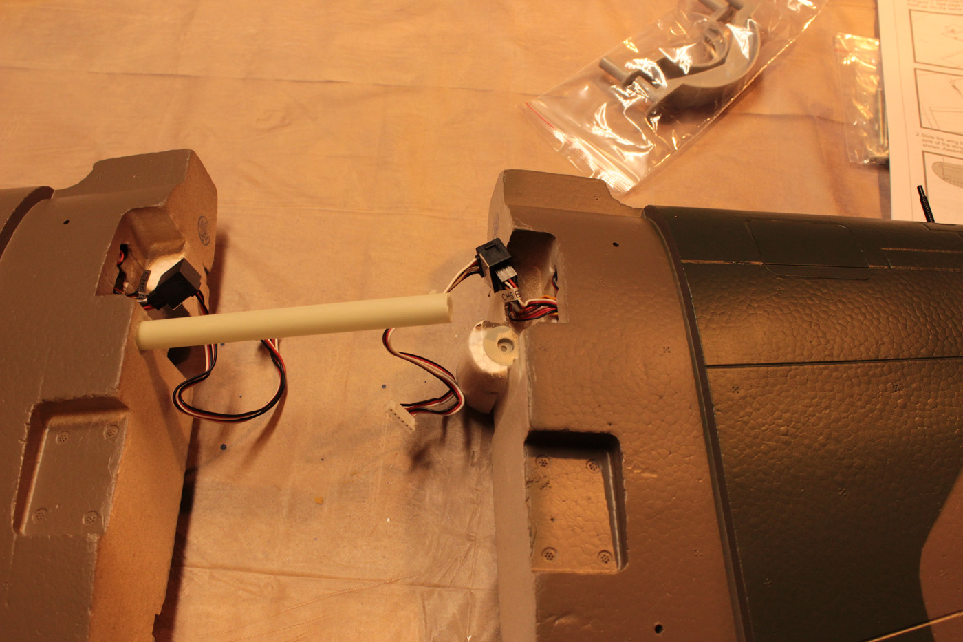

                    First of all, the wings assemble so easily, just look at the wiring, simply amazing

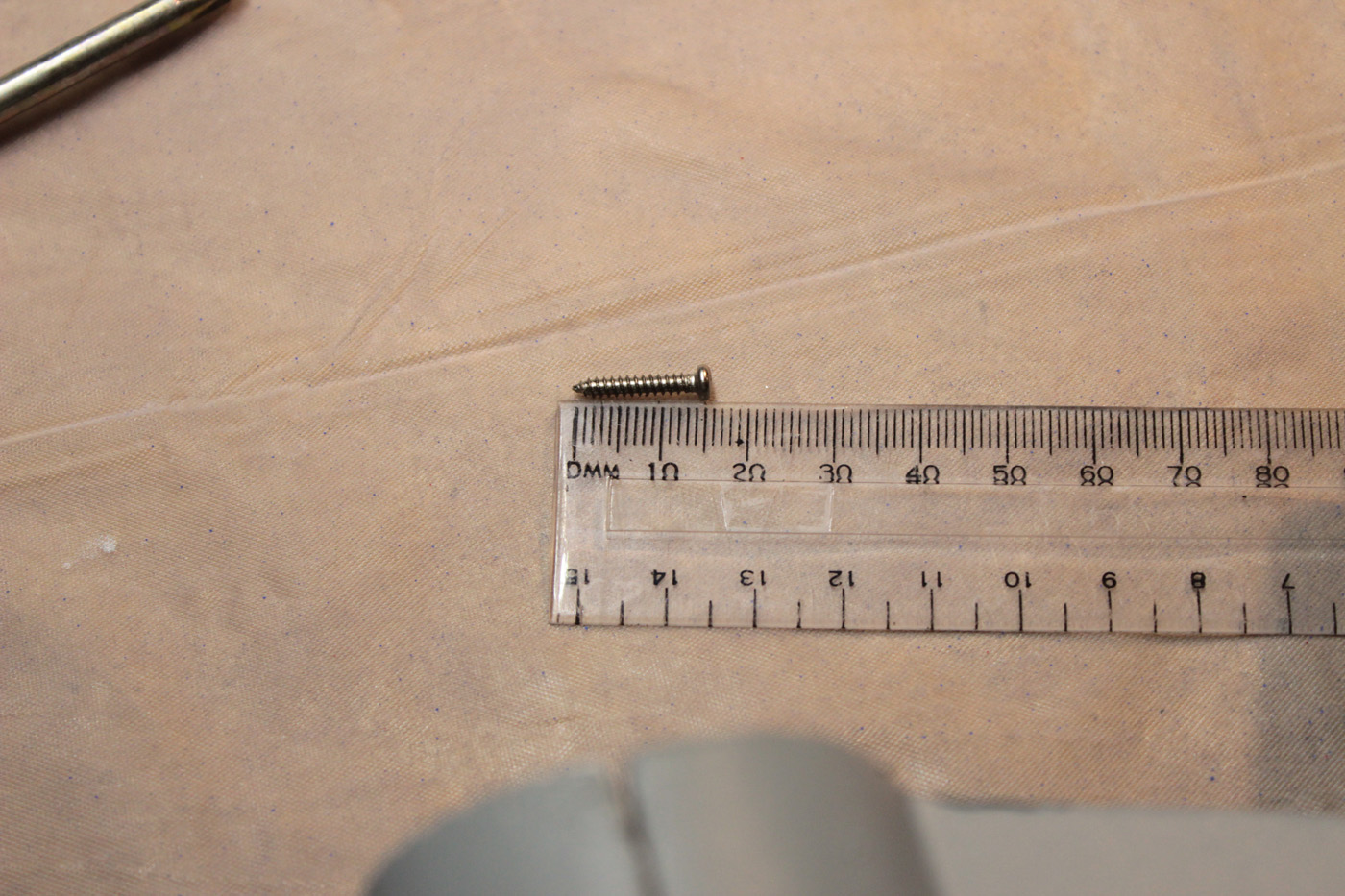

                    And when they're joined, there's hardly anything there!This is the complete set of screws, including the prop screws and nuts!notice that before you install the drop tank, there are four slots on the underside of the wing that the rods fit into.  One screw in from the top of the wing holds the whole thing on, so install the drop tank before mounting the wing to the fuseThe two handiest things to have when building, a magnetic pen and a mm ruler.The drop tank mounted, note the wing joiners are in place as wellCheck the servos firstThe tail section is strange, hardly any bite on the screws for the horizontal stabThe vertical stab is a very tight fit, did a little damage working it into placeThe whole thing is held into place by that short little screw that's left in the bag!  Oh yeah! Retract the tail and install the screw through the L/G bay.  I thought the screw would be longer than that...Flip the fuse over and mount the wings.  Personally, I just get the screws to bite then flip the plane over to make sure all the wires are where they're supposed to be.
                    The finished product.
                    As usual, I had a heck of a time getting the receiver to bind.  You'd think after 10 planes I'd get it figured wouldn't you.  Anyway, the darned thing wouldn't bind...
                    Binding plug in, the throttle wire plugged in, nothing.  Beep....Beep...beep.  Anyway, after multiple try's, the brain kicks in, reduce the trim on the throttle, and wouldn't you know it, the goose call and we're bound.  That was the only trying time in the whole build.

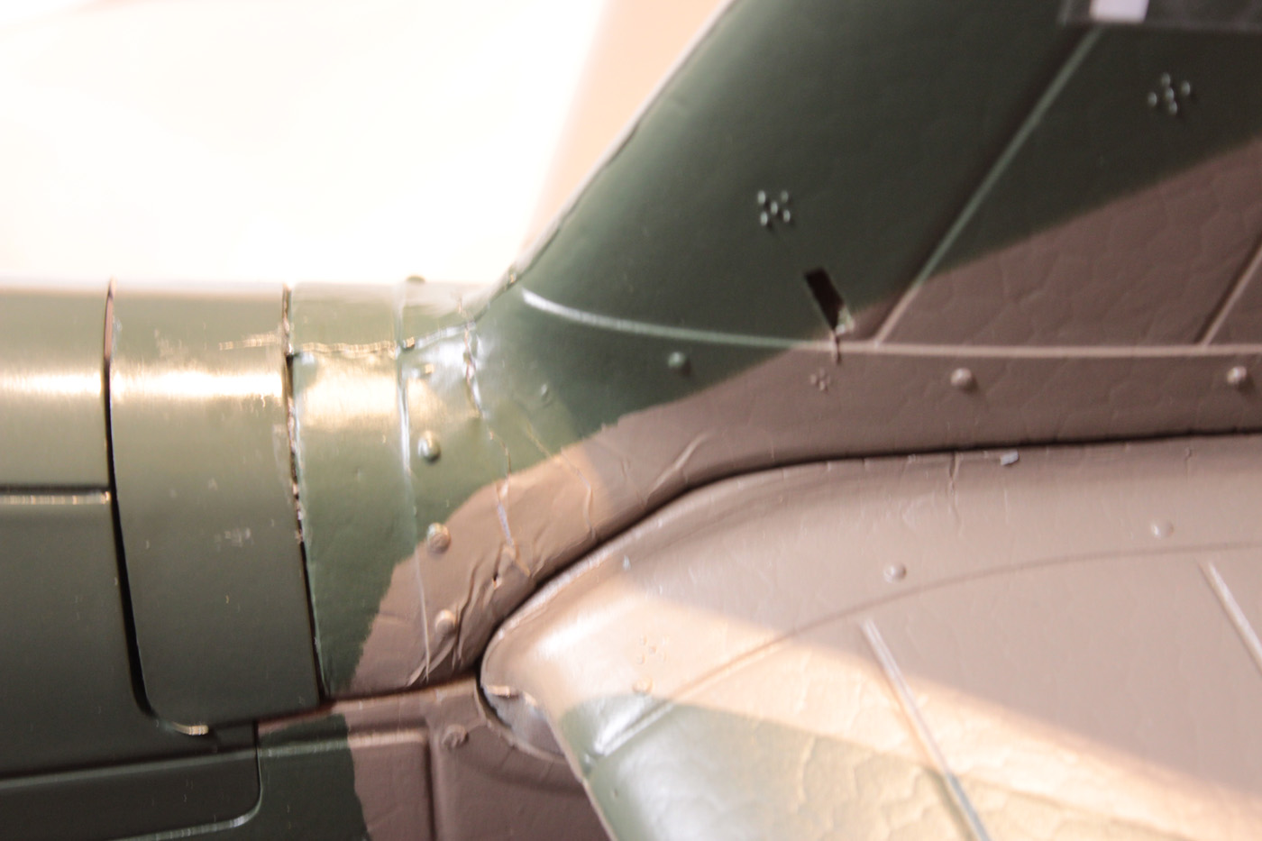

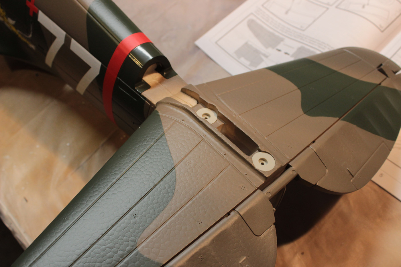

                    The manual is typical, there is nothing regarding installing the vertical stab and references to screw sizes is minimal, hence the ruler.  But she's quite the bird when she's done. The bay is a pretty good size, reminds me of the P 51B.  The battery tray is cool in that it has a little loop on the end to make pulling it out easier.
                    All that's left now is placing the receiver where I want it and the gyro, then on to set up.
                    As I stated before, I was really hoping for a better cockpit and its too bad that the canopy doesn't slide back, little things that would have been nice. Also, I wish that the would have given us the option of applying the different squadron emblems and numbers. There was Hell's Angels, Adam and Eve's and Panda Bears, it would have been nice to pick. Nothing against RT Smith, but the markings are exactly the same as the 980 version.
                    BTW, the gear is really cool!!!

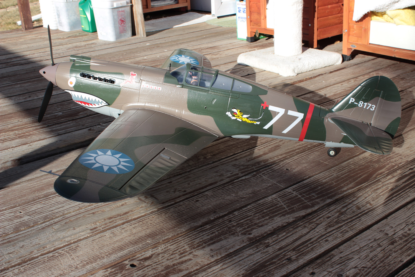

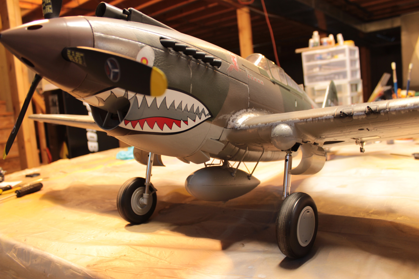

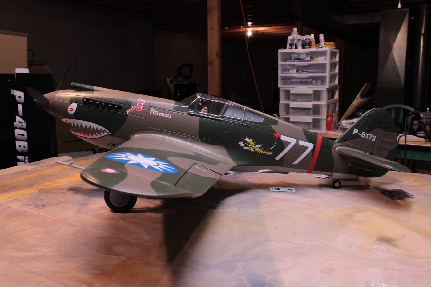

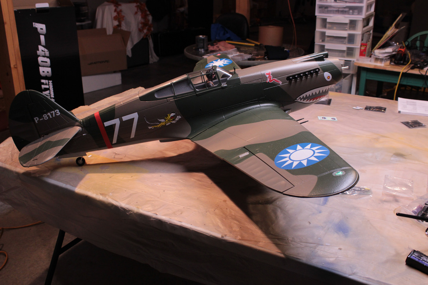

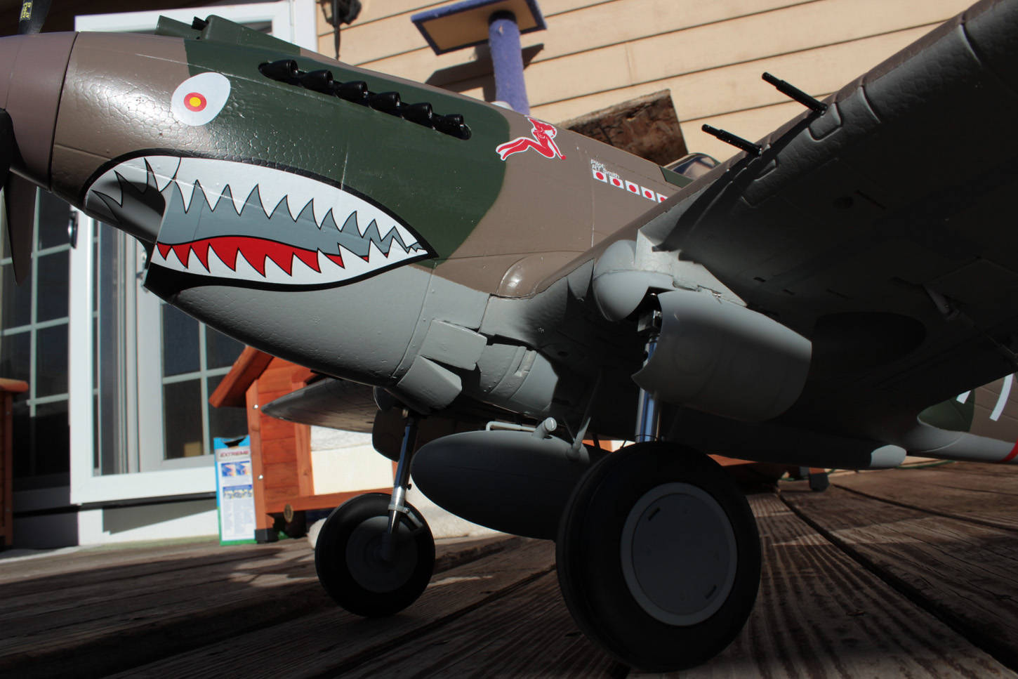

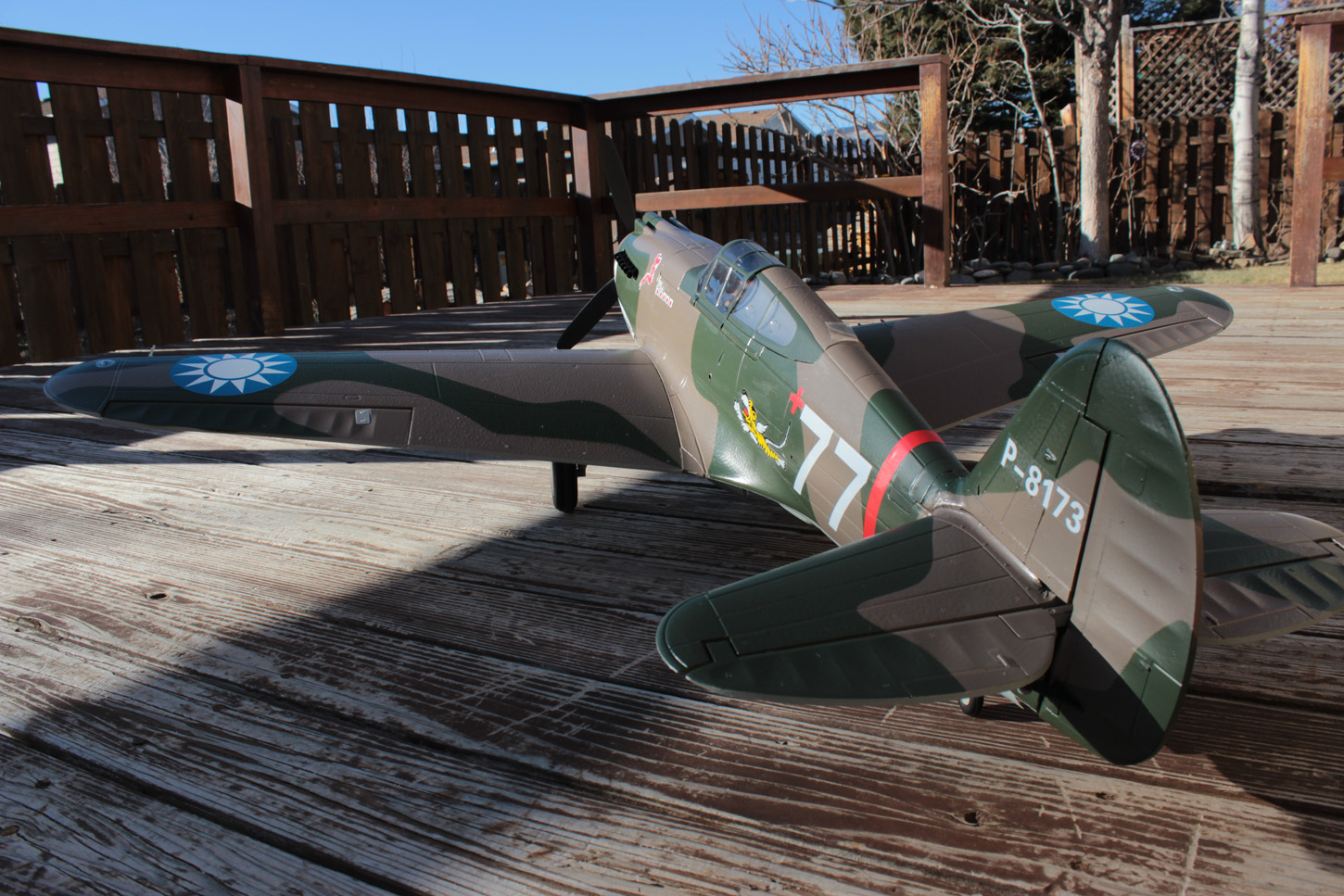

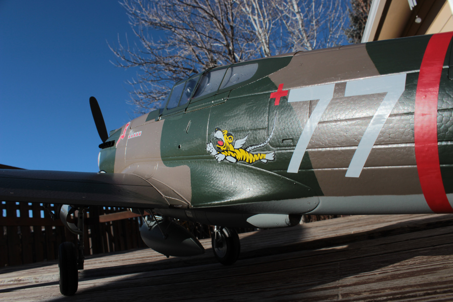

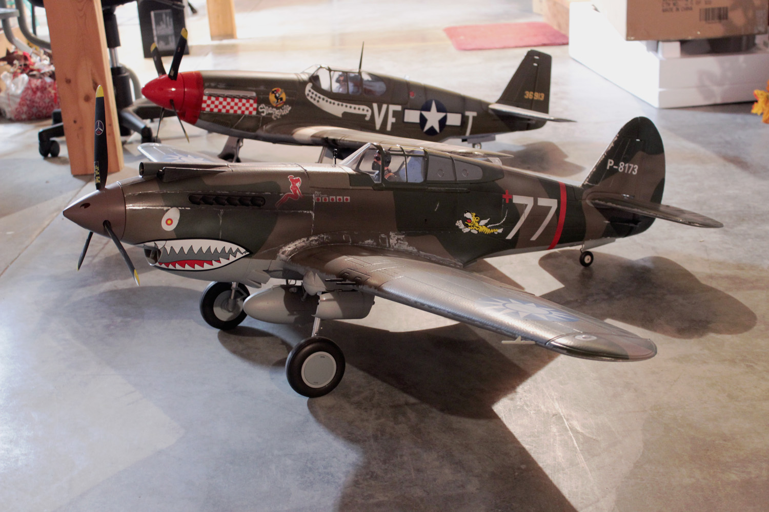

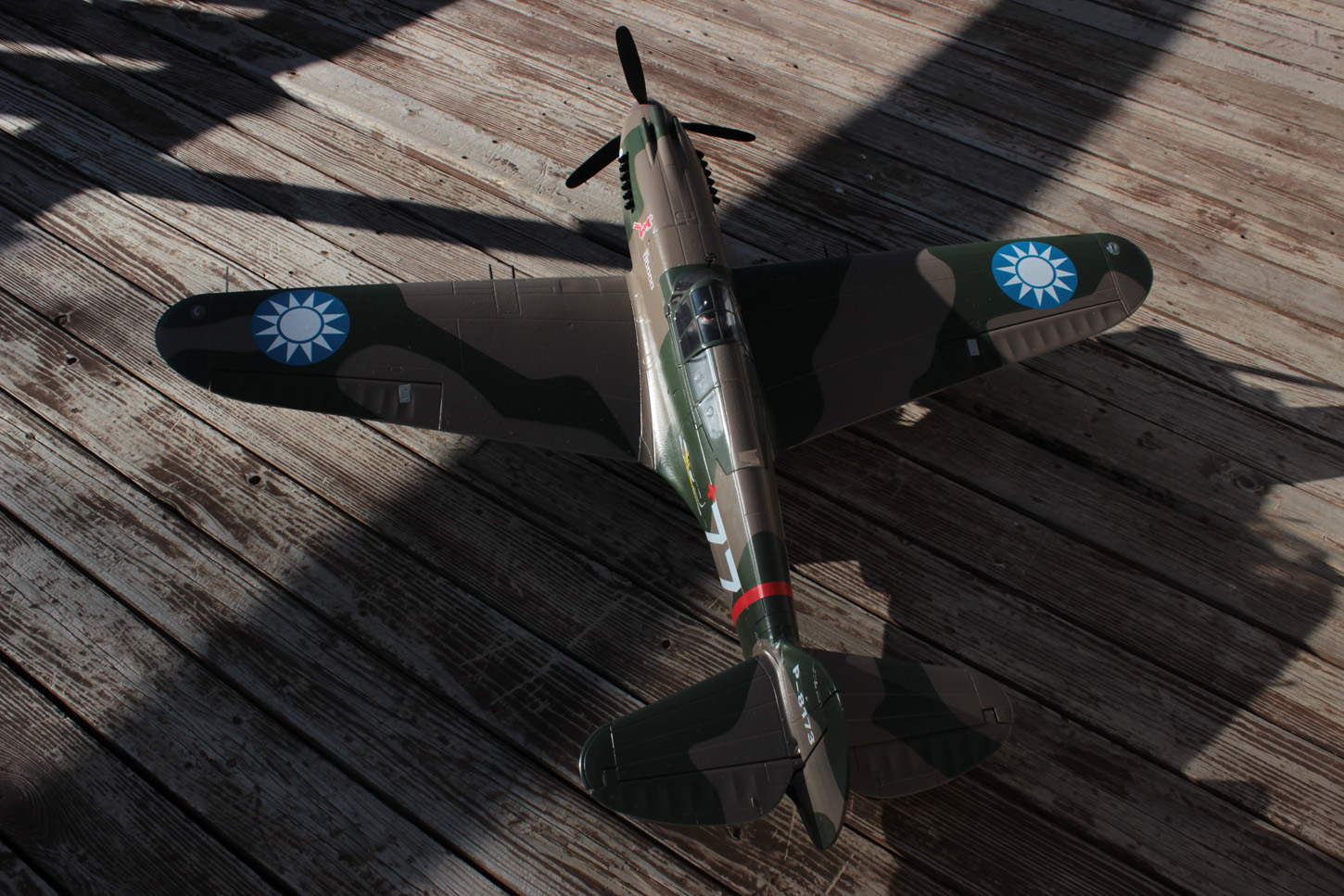

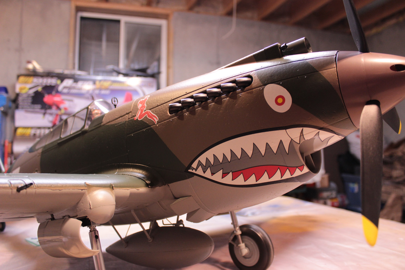

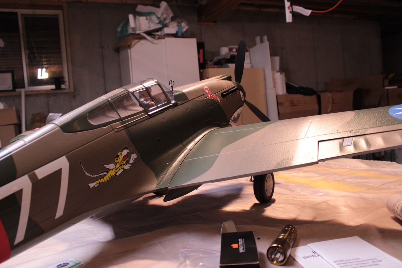

                      Out in the sunlight as her official presentation.  I'm thinking that this is going to be one of the sweetest flying birds in the stable
                      Now the one thing I did notice is that the colors for the tiger are off
                      Also, some have the Tiger jumping out of a blue sideways "V"
                      Not a huge deal, but interesting.....

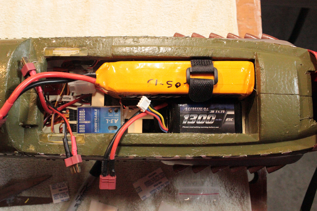

                                  Here's some food for thought.  Since the 3600 battery has to go right to the firewall and the 4000 isn't much different, it seems to me that this bird is an ideal choice to go 5 cell with.  Anyone more knowledgeable than me, would you give us some insight about that?
                                  • #77
                                    RE: All Us intermediate pilots, Lets Share
                                    Gman,  I'm thinking that just like my other planes i have upgraded from 4 cell to 5 cell. The increase in power and performance is well worth it. I still fly with 4 cell, but that's only because i'm waiting for the spent 5 cell batteries to charge.

                                      I was just checking into the ESC and it will handle up to 6 cells, so that might be something to try (5 cells I mean).

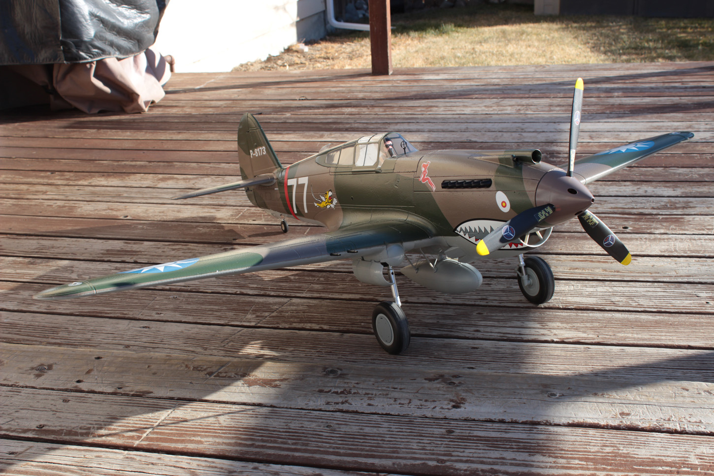

                                      I was talking to Ryan yesterday regarding the P 40.  Interesting to note that he lost a main wheel while taking off on the first flight.  Now, I had the exact same thing with Big Beautiful Doll on her first flight.  Mine was just as I was approaching for landing, boing, off goes the port main wheel, bouncing down the runway.  So I went around, dropped every bit of flap I had and slowed her down to minimal, did a one wheel landing, keeping the port wing up as long as I could.  When the strut did hit, she ground looped on the side of the runway in what we call grass here in Wyoming (whole different meaning).  I expected the worse, but when I looked her over, I scraped a little paint off the strut and that was it.  Eventually found the tire, went to Ace Hardware and found some clips, reinstalled the wheel and applied foam tack to the c clip so she isn't voluntarily coming off again.

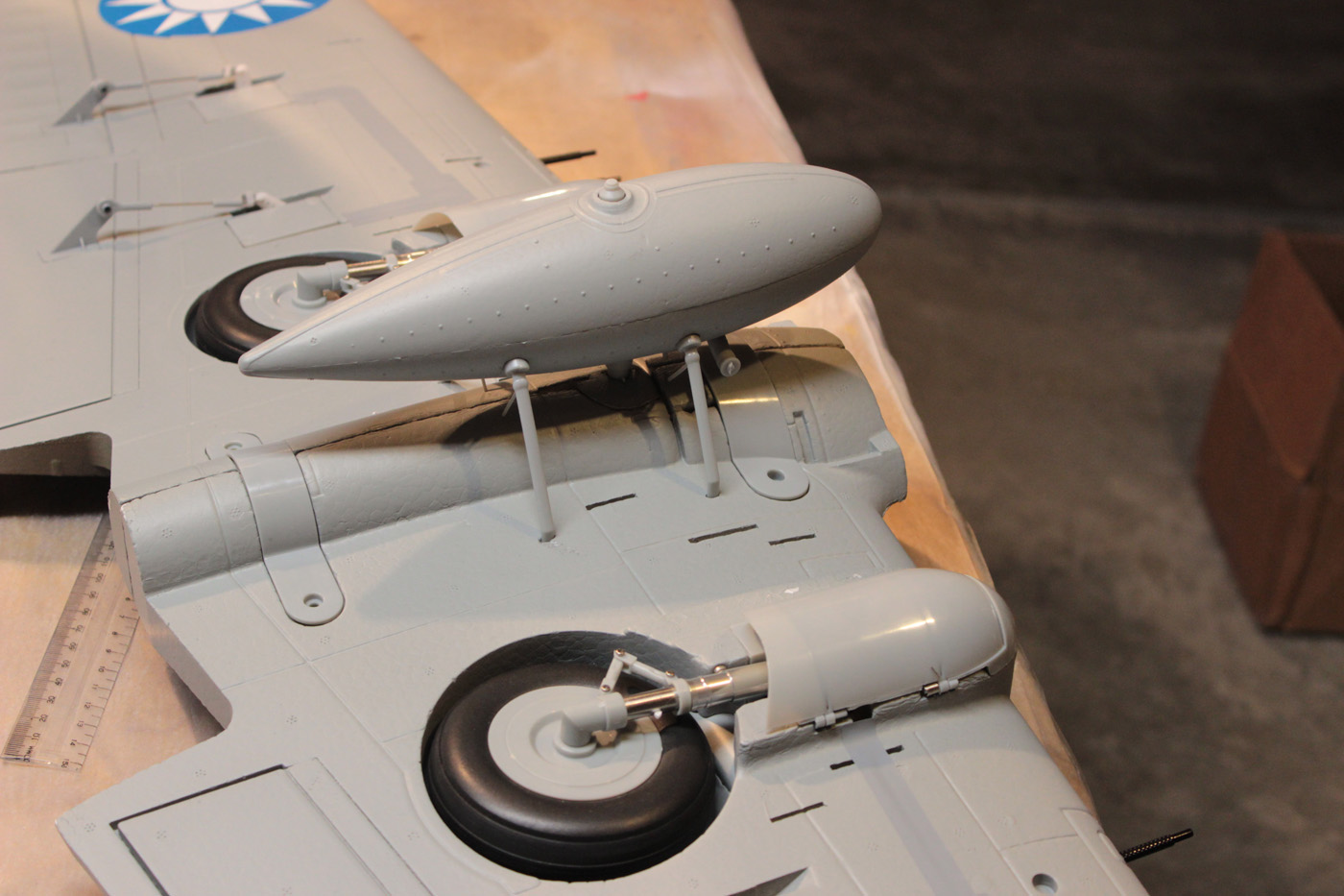

                                      So, with the P 40, I'm doing the same thing.  One thing about the shell over the wheel, it keeps the clip inside it, so you're not trying to find a replacement, but let's not lose the wheel in the first place!!

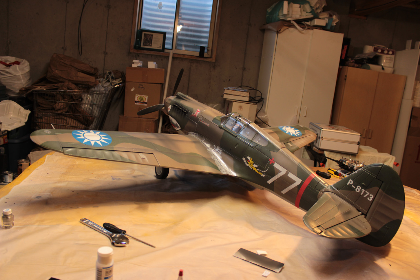

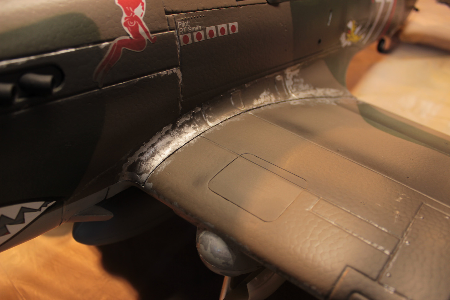

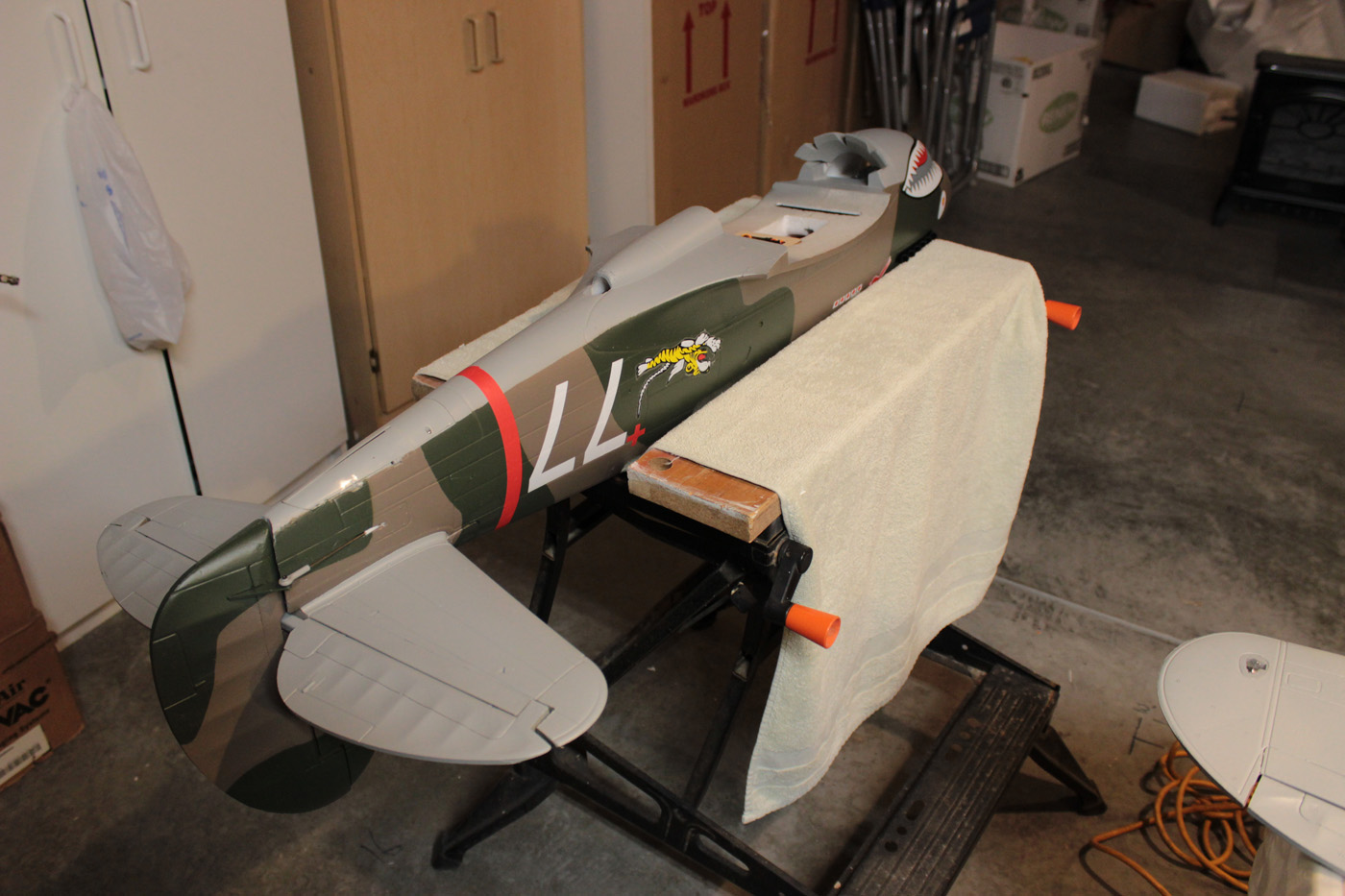

                                        BTW, I did paint the P40 a little differently, method-wise.  Very thin paint and a piece of cardboard across the panel lines blocking the forward edge.  Went right through the insignias on the wings and it looks great, it locks the markings right into the wing.  I'm debating whether to get a set of the Flying Tiger logo in the correct colors as well...........
