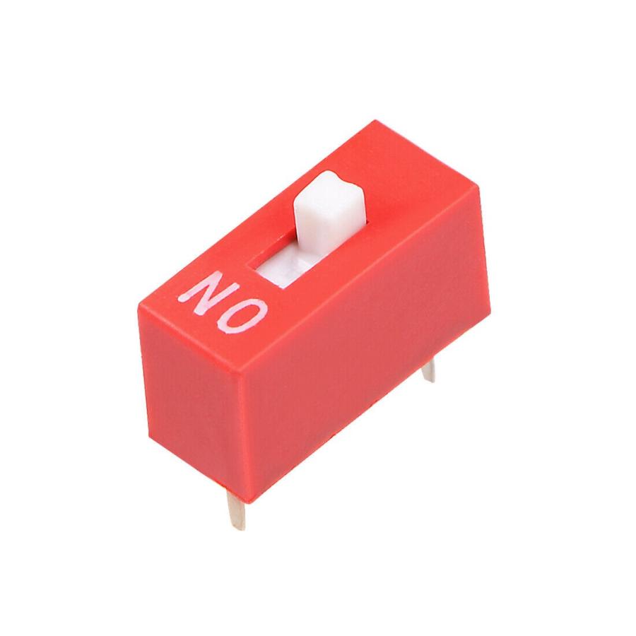

                                  I thought from the beginning that the MCB-E should be powered directly from the BEC, with a separate feed from the BEC to power the receiver, and then single leads from the receiver signal pins to the MCB-E. Why feed the power for everything through the receiver? It's not what I do when I install an external BEC on a model. So I "modded" mine in this way on the L-39 and am in the process of doing the same on my new OV-10 Bronco.
                                  No problems at all on the L-39 with the mods. Maybe it would have been OK with out them, of course, but it makes me feel better 🙂
                                  Oh, and I opened up the MCB-E box in my OV-10 and there's an ON/OFF switch in there that looks like it was soldered in after manufacture. It's in the ON position. Wonder what that's for?
                                    • 5385
                                    #57
                                    Did you take a picture of the switch by chance? I agree that electrically it would be better to power the MCBe directly especially if you use it to the max connecting everything to it, or a Y to it and the receiver. But that said I usually bypass most of the MCBe and I have never had a problem with one, knock on wood.
                                    • kallend
                                      • 1859
                                      #58
                                      Be aware that if the receiver and MCBe are powered directly AND the -ve from the receiver is also connected to the MCBe by way of the servo leads, you have created a ground loop. It probably won't be an issue but in general ground loops are best avoided as potentially they can cause interference.
                                      • JDill
                                        FrSky Thumber
                                        • 12
                                        • Traverse City, Michigan, USA
                                        #59
                                        Sorry, no photo and the box is buried in the OV-10 now. I looked at the circuit board traces it was soldered to but couldn't tell what it would affect. The switch itself was like the attachment.
Name:	dip switch.jpg
                                        • JDill
                                          FrSky Thumber
                                          • 12
                                          #60
                                          Originally posted by kallend
                                          Be aware that if the receiver and MCBe are powered directly AND the from the receiver is also connected to the MCBe by way of the servo leads, you have created a ground loop. It probably won't be an issue but in general ground loops are best avoided as potentially they can cause interference.
                                          Thanks for making this point as I didn't state it in my post, and it's a valid concern. To avoid this the only ground wires (black leads) on my install from the BEC are on the 2 plugs (I created a Y connector), one to the receiver and one to the MCB-E box. All connections between the receiver and MCB-E are single leads for the signal channels, so no ground leads.
