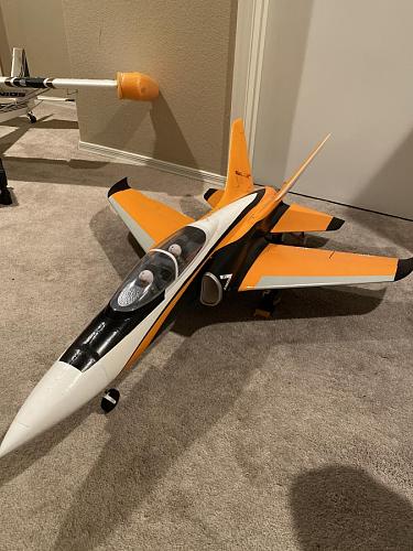

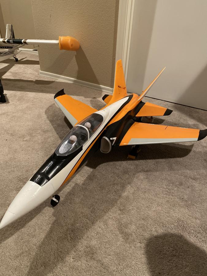

ID:	226093 I am having an issue with my freewing super scorpion. I have the model completely setup and ready to maiden however I am hesitant to because I am getting a twitch with all servos at the same time every 30 sec - 2 min. It’s not a huge amount but it is pretty noticeable. My radio system is a spektrum dx7s with an ar-8000 receiver, I also have an AL3 gyro installed. The issue happens with the gyro on or off and with a full or dead battery. I have checked all servo connections and battery connections and found zero issues. I don’t know if I am missing something or if I am just being to paranoid. I have spent a good chunk of time repainting the bird and would hate to put it in the dirt. Any suggestions would be great thank you!
