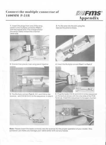

    Can any one give me some instructions on how to use these? I would appreciate the help.

    Hi Phoenix, did these come with a plane or did you buy them separately? Just curious what you are using them in. Ill take a look at our Dallas Darling this evening and get back to you.

      Pheonix, these are the instructions from the FMS Dallas Darling that uses these connectors. It really is very slick. I hope you can read the print. Let me know if you have any more questions.

        Guys, I made a quick .pdf so it's a little easier to read. It's on the multi connector product page under the Support Tab and also here is the link: Click Here

          Thanks Ryan. I appreciate you responding to my request for help. I am using on other FMS planes. These should make removing the wing for transport much easier.

              thanks for the PDF. I got them to work on my F4U. Now I can remove the wing for travel to the field. Again, many thanks.

                You are very welcome! Thank you. Now the instructions are up on the website linked to the items. Your question will help many people.
