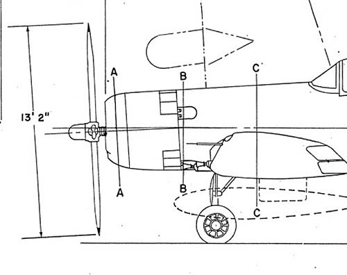

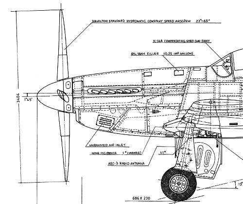

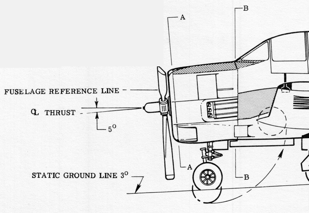

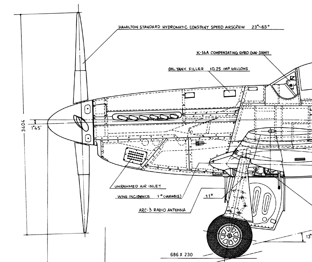

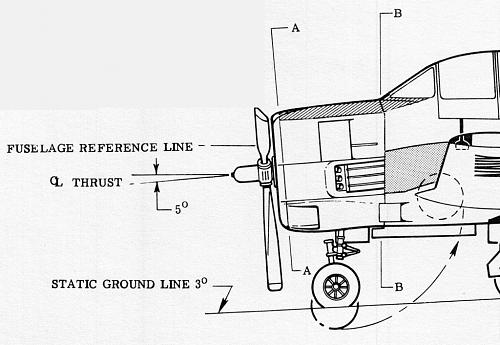

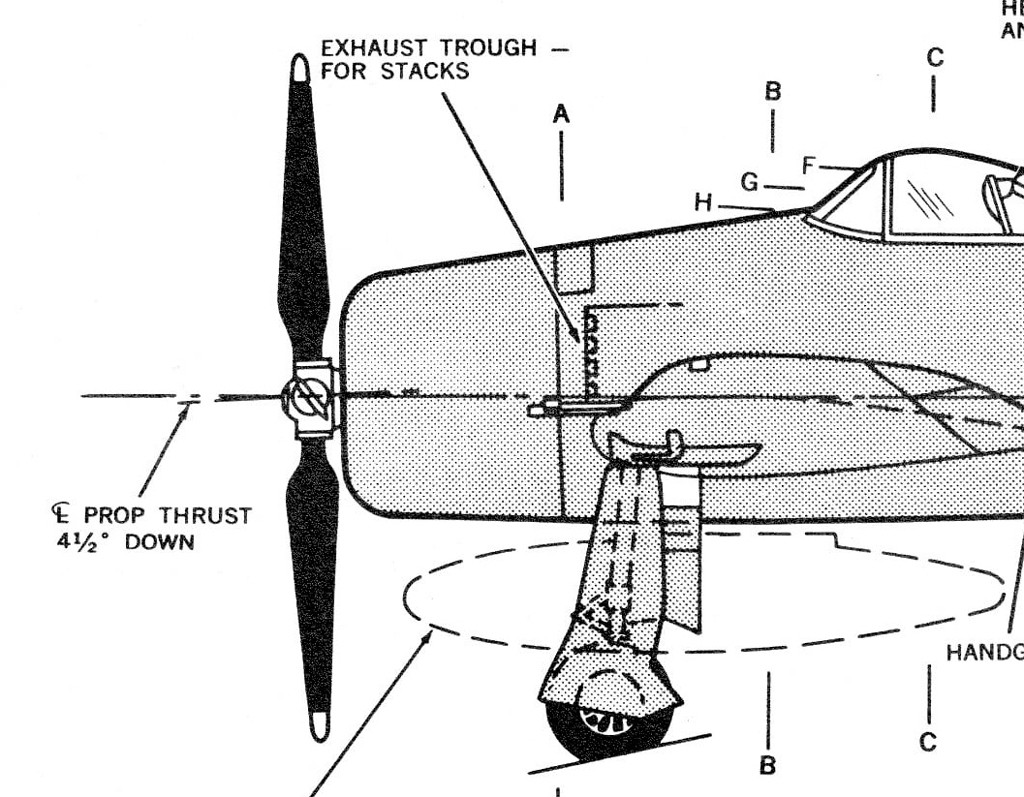

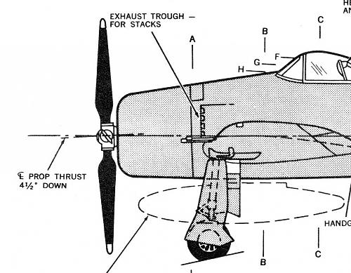

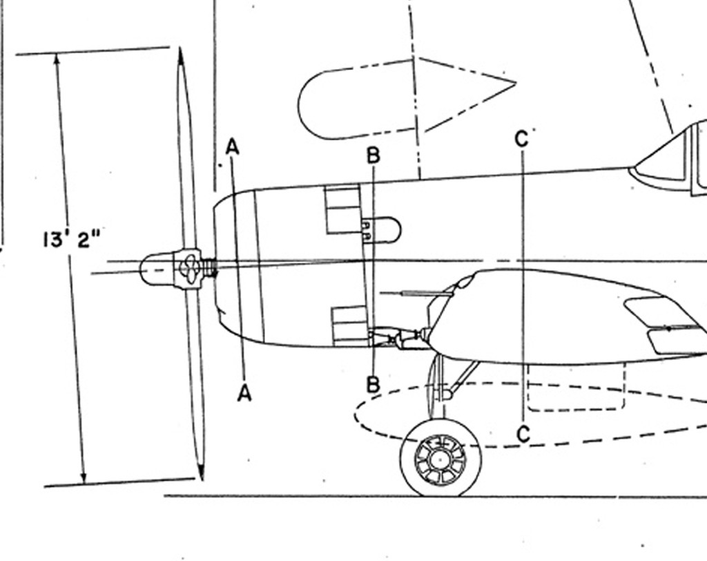

        ..and not just for model airplanes. Full size airplanes can also have at least a few degrees of down thrust as well as a couple degrees of right thrust.
        Here's a couple examples for full size aircraft:
