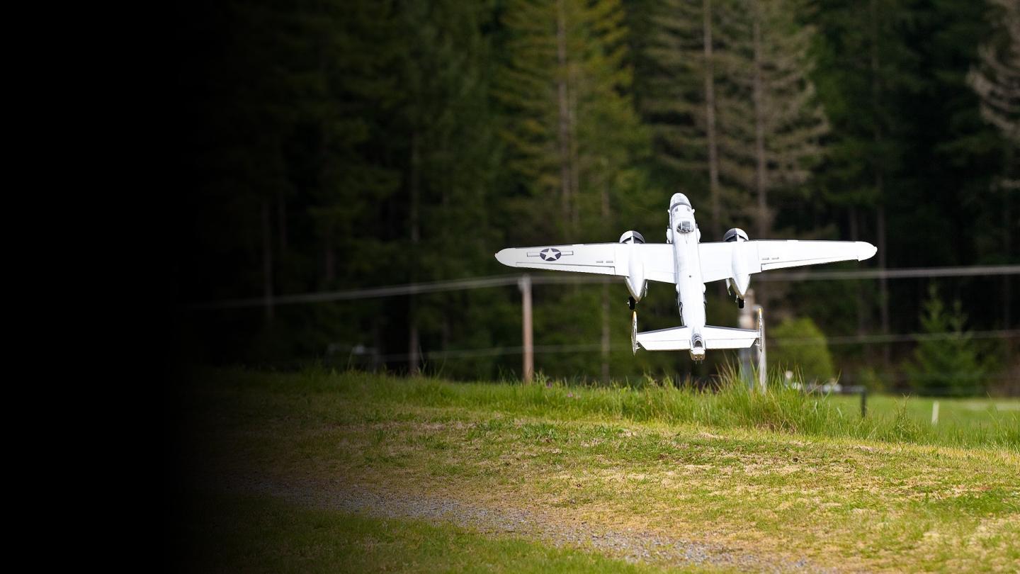

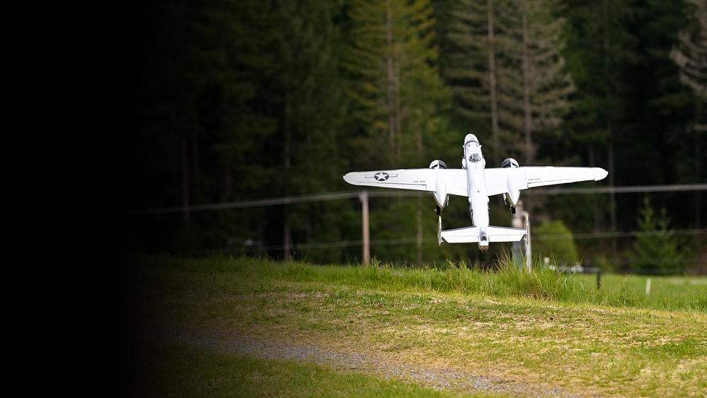

    Good stuff Martin! Even though I am familiar with the aerodynamics of a stall, it's always good to read and refresh. A lot of times over the years I get complacent and rely too much on "motor/muscle memory" and get lax and BAM that's when I find myself doing The Walk of Shame. Here's a photo sequence a buddy took years ago documenting this very topic. The first photo shows the aggressive AoA that created a stall and the second photo is the dreaded Walk of Shame as a result, lol.
    Click image for larger version  Name:	wallb253.jpg Views:	0 Size:	118.7 KB ID:	276621
    Click image for larger version  Name:	walkofshame.jpg Views:	0 Size:	130.7 KB ID:	276622
