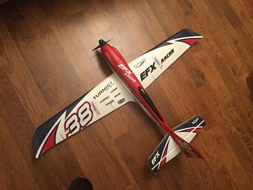

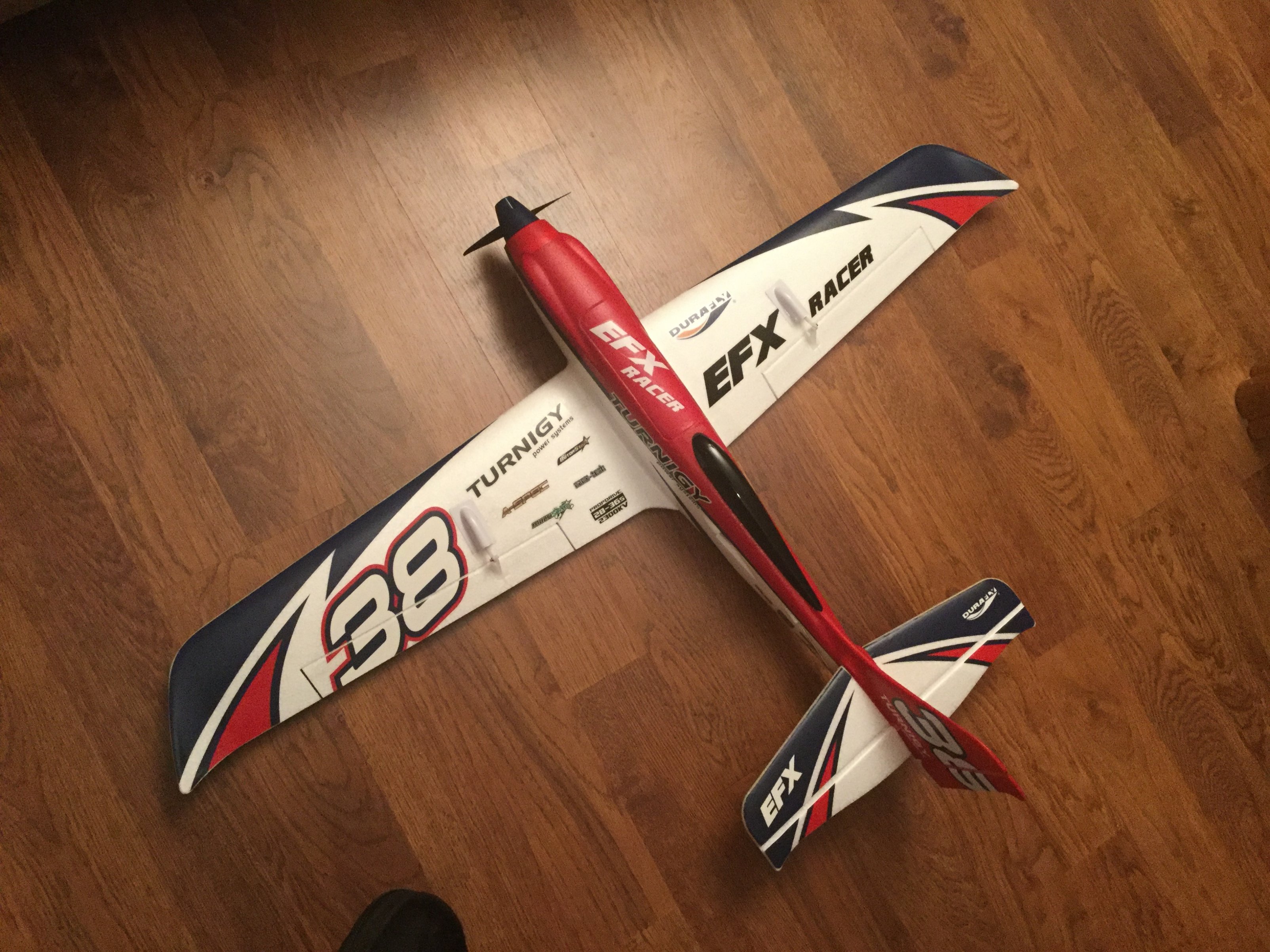

      I have a durafly efx racer, and for the price, I really do think that its great, you can be adventurous while flying, because you only have around $120 in it. The wings are really stiff and it handles wind beautifully. I'm thinking of an upgrade to the powerplant, though.

        When flying our EFX racers on 4S, I was impressed that you could pretty much leave the throttle at 100% and yank and bank it at will. It has always endured our abuse, so far. We even had a few mid-air contacts when racing them and so far they have only come down with a minor scuff or two.

          Is this the EFX racer?
          http://www.hobbyking.com/hobbyking/s...dproduct=65458
          I've never seen one, it looks like if not landing on a smooth prepared surface the servos are at risk.
          This is a bit late, but yes, that is the EFX racer, there is no danger to servos on landing as they are either in the fuse or in the wing w/control horns and pushrods on the upper side of the wing. It's a great plane for the money, which gave me the idea to start a thread on planes that are fast yet affordable.

            I see that now. How are the hand launches? This is looking more and more like a practical ship for speed.
            Do they have a version that DOSEN'T look like a flying bill board?

              They make a white version, comes un-afiliated

                Yes, Durafly has a clean white version in an ARF form, but personally, I kind of like the billboard look. Hand-launches, are quite easy and uneventful at 3/4 throttle with some right aileron factored in right from the start. There are only two things that I would change/add to the plane. I definitely recommend replacing the metal motor mount with a carbon fiber one, as I have read that it isn't strong enough for a 4S setup, and I would get the 5.5X4.5 prop which Hobbyking recommends for better performance. If going with the ARF, definitely buy the parts from MRC.
