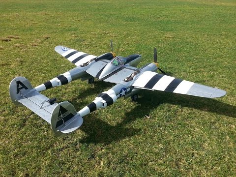

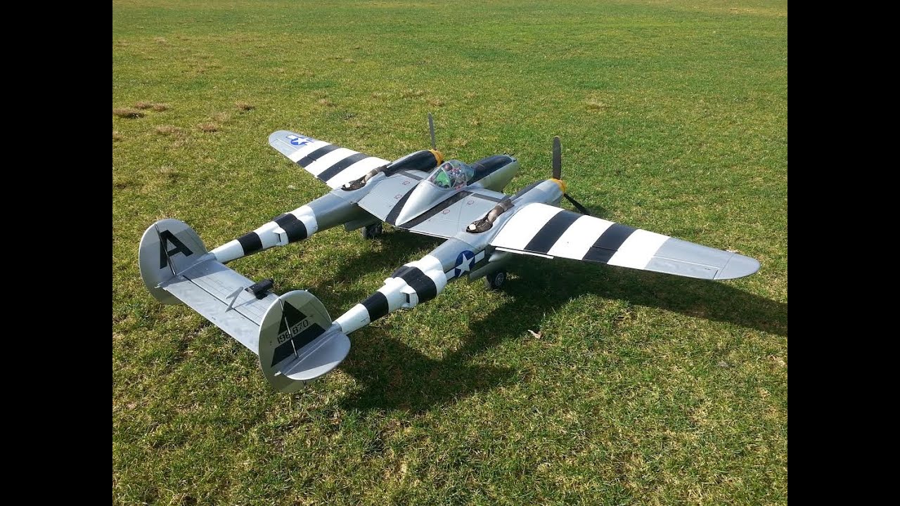

    This was my first non-foam P-38. My buddy built her for me and I've added some scale detailing. Definitely a sport scale mold, but she still looks the part and I love the size. This used to be the VQ for those who know of that manufacturer.
    Flight performance is typical P-38: Outstanding. She carves through the sky beautifully. She's 21 pounds and here's my setup:
    2x Dualsky 470Kv motors
    2x Master Airscrew 16x10x3 counter rotating props (rounded tips down to 15.5")
    2x Castle Edge 100A ESCs
    2x Admiral Pro 60C 5S 4000 mAh
    20A Pro Amp BEC
    Spektrum AR9020 9ch rx
    HS-5485HB servos for ail, elev and rudder
    HS-77BB servos for flaps
    Detrum 9g servos for main gear doors
    HS-55 servo for nose gear door
    JR MatchBox Servo Matching/Power System
    2x Robart #670 1/2" dia Straight RoboStrut (main struts)
    #663L 7/16" dia LH Offset RoboStrut 3 3/4" - 4" (nose strut)
    630RSE 90 Degree HD Mains RoboStrut Electric 24LB (electric retract system)
    Took her out today as the rain finally stopped and the sky opened for what feels like a taste of Spring. Here's video:

    Nice flight and what a beautiful P-38,. Good flying !

        Smooth flying made the video feel like I was the co-pilot. Your buddy built you a really nice looking and flying Lightning....DJ

          Thank you for the compliment! And indeed my buddy did do a fabulous job on the build. I am so thankful for his talents.

              This is a great Plane Aros, but I have to ask, do the wings come off, 83" is tough to move!!
                • 8205
                Indeed they do! Not unlike the FlightLineRC P-38...The outboard wings come off for transport. Otherwise there's no way I could have this bird.

                  wow great looking plane....does that thing fit into your car? lol way too big for me...cant store it cant fit it in my car but sure is cool...
                    • 8205
                    Yeah it fits in my Ford Flex without the outboard wings on...Just barely! :)
