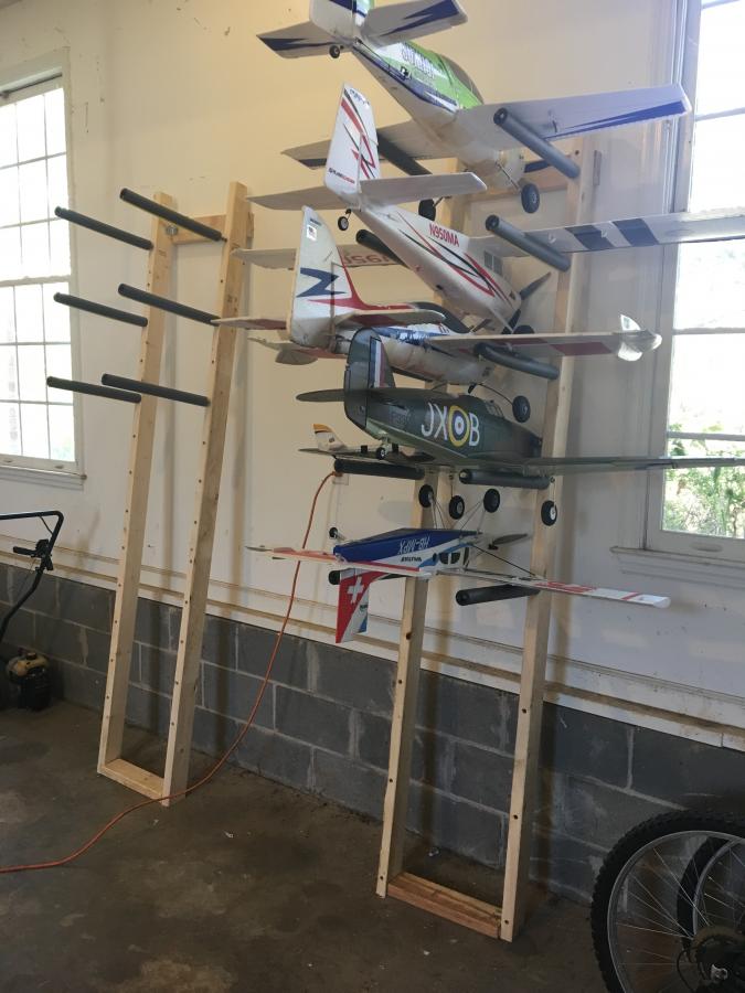

    Nice idea Oxotnik. Are those just wood dowels with pipe insulation for the wing supports? It looks like you can move them around as the need changes, true?
    Yes, 1/2" wood dowels with 1/2" pipe insulation. It works well. I have screwed the stands into the walls, but they'd be really easy to move, as the stands are really just leaning up against the wall. I cut 10° angles into 2x4s for just a little bit of lean. I'm really happy with this setup. My heaviest plane is the FlightLine P-38, and it's supported very well.

    Yesterday, I made a couple new racks, to expand my hangar into the garage. Most of my planes are still inside or in the Tahoe, ready to go the field.
    Obviously, I now need more airplanes! Click image for larger version

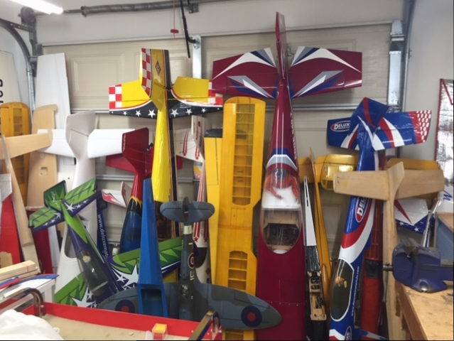

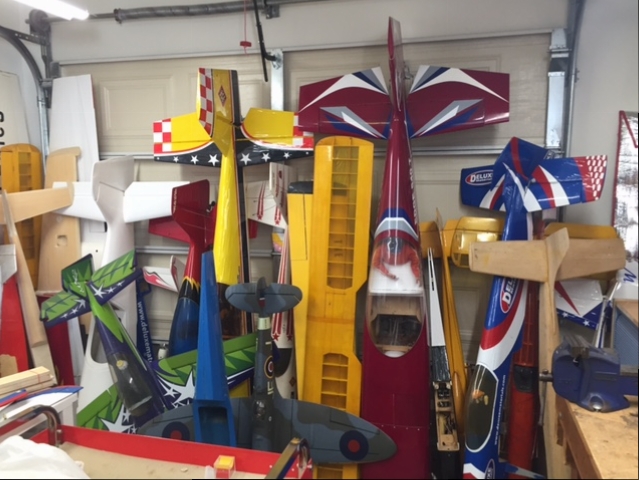

    I've always found storing models to be a pain in the neck one way or another. However I do find the ideas that you guys are using to be interesting. I either hang mine from the ceiling or I stand them on the nose up against a wall. I know it may look a little untidy, but it does work well and as long as you are careful they don't get damaged either. It is a good idea to remove the plug from the garage door opener and also lock the door so it cannot be opened at all ! Some of the models in the picture are now hanging on the ceiling.
