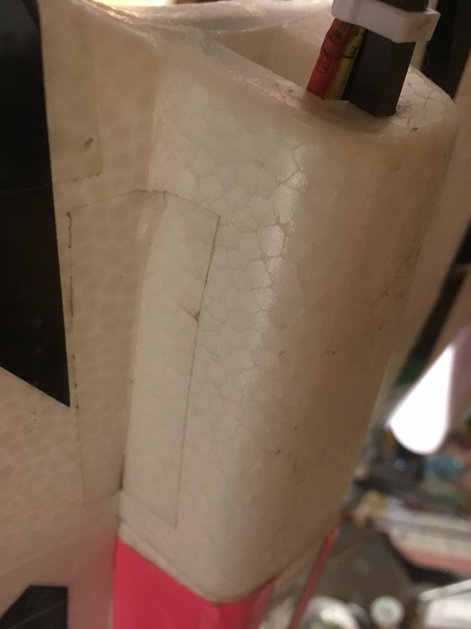

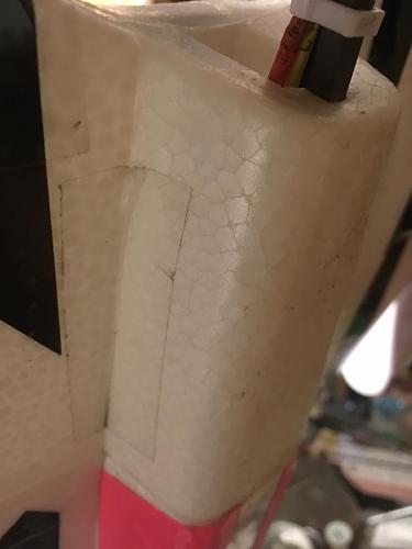

                          Xviper2, I really like your approach to test flying, and since you are the resident expert here in this wonderful community, I have a question for you. My Convergence just arrived, and even though I ordered the Plug-n-Play version, the good people at Motion substituted a Bind-n-Fly at no extra charge since the pnp's don't seem to be coming. Anyway, I have been following all this activity and plan to do a thorough preflight inspection. In a previous message you mentioned re-glueing and reinforcing the "rear motor pod" due to failures. Are you referencing the two piece plastic mount that attaches to the metal boom and actually acts as the rear motor mount?
                          Thanks for your help, and thanks for sharing all the great research you have performed on this bird!

                            Actually, no, it's that foam cover that fits from below. The rear motor pod extends out from that cover. If you look carefully (from the rear) into the cavity inside that cover, you will see that the motor pod is somehow connected to the cover. The cover is only glued on at the two side seams. It's that seam that can come loose with vibration and time. Some covers are glued better than others. For insurance, I wicked in some CA and applied a strip of hinge tape over each seam. I've attached a picture to show you that cover (note the hinge tape on the seam that can give way). Admittedly, the hinge tape is overkill. I'm sure the added CA in the seams will be enough, but I fly mine several times a week and I didn't ever want to worry about it. If that cover drops down, so does the whole rear motor. The flight controller then goes crazy trying to keep the thing level and it just can't. Thanks for the compliment but I'm not really an "expert" on this plane. I just consider myself extremely lucky to have gotten a glitch free example and having read all about the problems, I've done the best I can to address the quirks and deficiencies. I've also flown mine a lot so I've tried different things with it to see how much I can push the flight controller before it has a brain fart. I've had one such brain fart but was quick to throw the switch to stability mode before the plane reached the ground upside down under high power.

                              Thanks Xviper2! One picture says a thousand words. A quick inspection so far has revealed no problem there, I did find a loose ball link on the left nacelle and will be checking everything else you fellows have mentioned. I am sure that all this shared information has probably saved my airplane. What a great resource! Thanks to all! Rick
