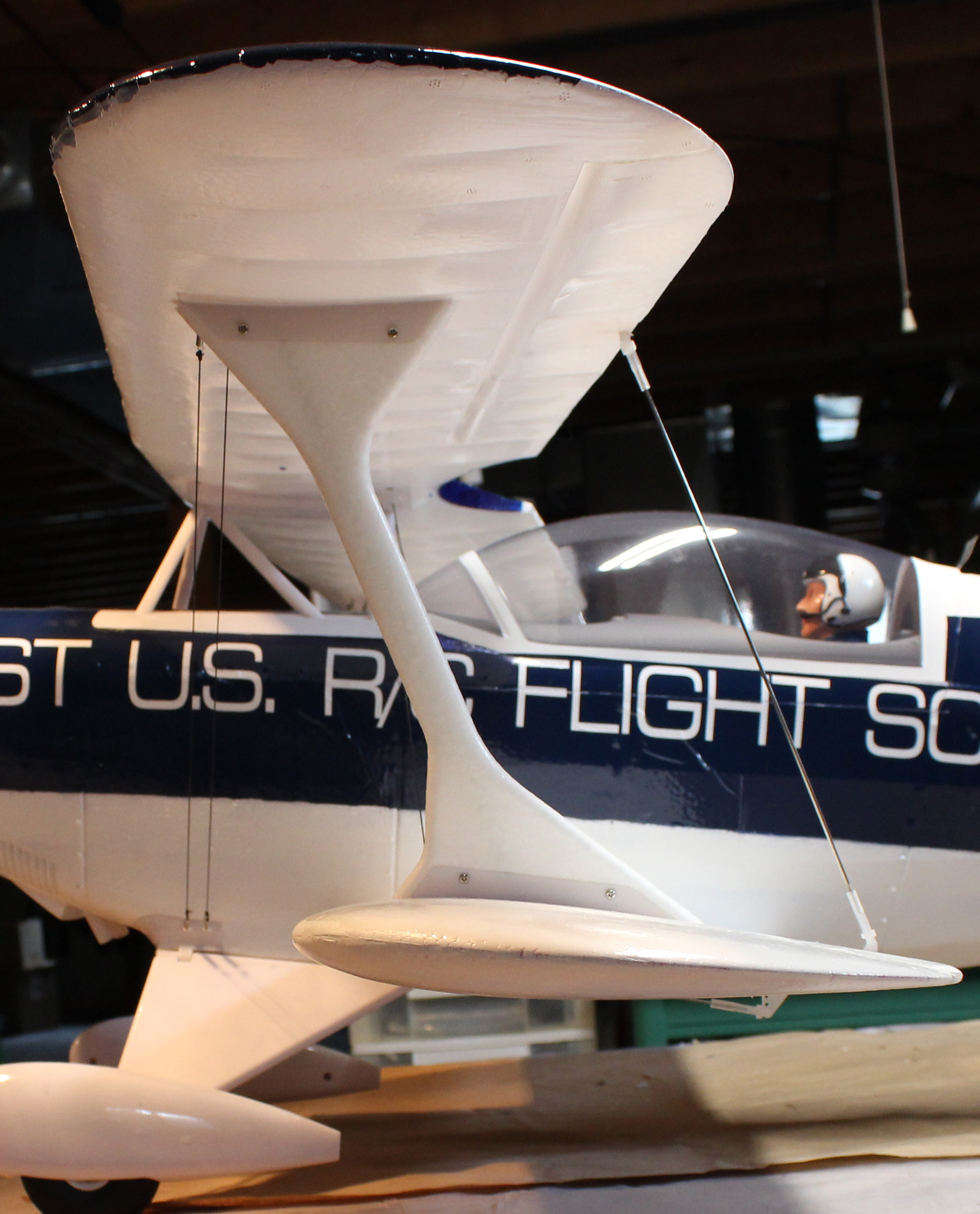

            Yep, as soon as I can get another elevator servo and get the throws dialed in, she should be ready for the air.  I've talked to some of he other guys online who have one and they land at around 20% throttle or less which I found interesting as this is NOT a light bird, well, maybe it is and all the others I have are super light!
            The next heaviest is the Freewing Mustang with the sound system and two batteries, I thought she was weighty!!  So it would mean that the wings are generating a heck of a lot of lift!
            Stands to reason I guess when I've got two of them!  Its interesting how the pictures don't really give the idea that she's got some size, until you look at the one where I'm carrying it
            I was a little leary of the fact that the cabane  is glued to the fuse and the two outer struts are glued into place, but the way its designed is ingenious, like a great big kite and those who have them say the same thing, no one has ever reported losing a wing, which is good!

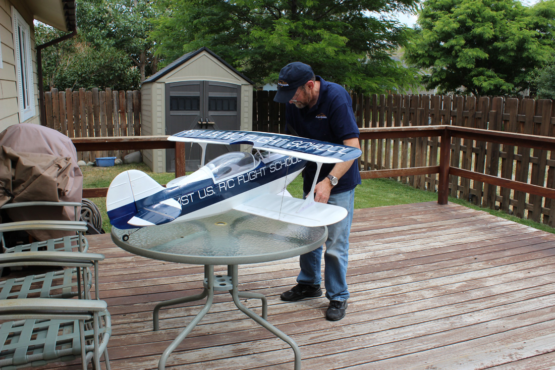

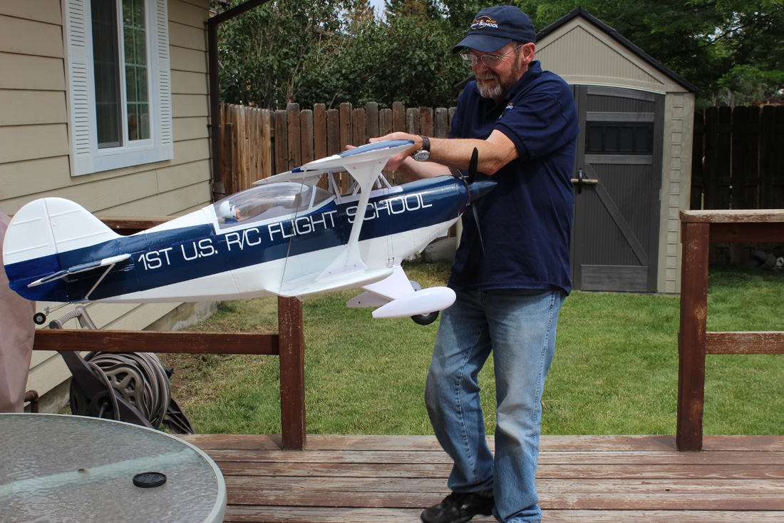

              Got the CG set and man do you have to get the battery way up front!  The problem, as I see it, is that the ESC has to go in front of the battery, between the motor and the battery in the little bay up front, in order to use its weight as well to balance out, which means that the wires going from the esc to the receiver have to be pretty long.  I've already stuck my receiver down and rather than pulling it back off, I'm just going to use an extension cable. I put a couple of dots under the upper wing where the CG should go and had to throw some lead into the nose, but there she is.  The tie downs are totally out of place as the battery is further forward than the furthest forward strap.  I bought some industrial strength Velcro and man that stuff is incredible, it takes some work to get the battery unstuck, good news for me.  Of course, its a little tricky hovering the battery and moving it forward far enough before she grabs onto the Velcro, but its doable and beats cutting up the inside of the plane.
              I've seen it suggested by other guys that the straps could be used to hold a piece of Styrofoam to brace the battery, but I don't see the point.
              I would never have believed that she was going to be so tail heavy because whenever you go to lift it by the lower wing, she nose dives, but the CG is so far forward, well, there you have it. Also, I've heard that the CG is better at 100mm.  Mine balances out flat at 90 so 100 is only going to make her slightly nose heavy which I would prefer.
              Was up early this morning with the idea of taking Big Beautiful Doll up again, all the batteries are charged she's preflighted and all set, but the wind is up!!

                      Checking the CG
