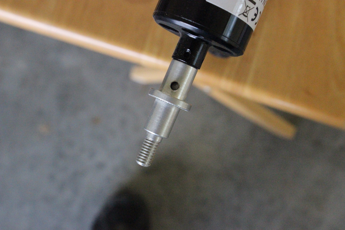

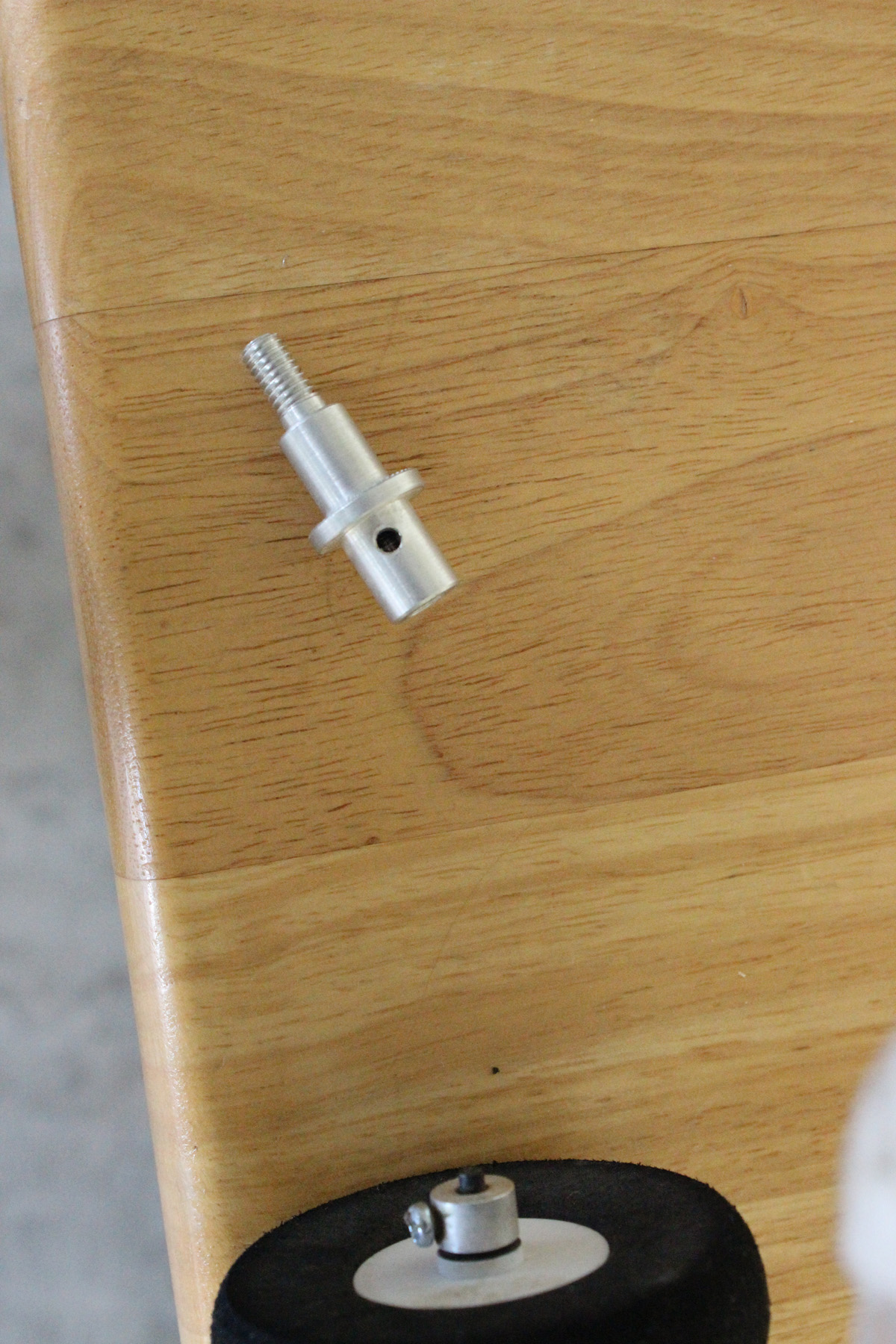

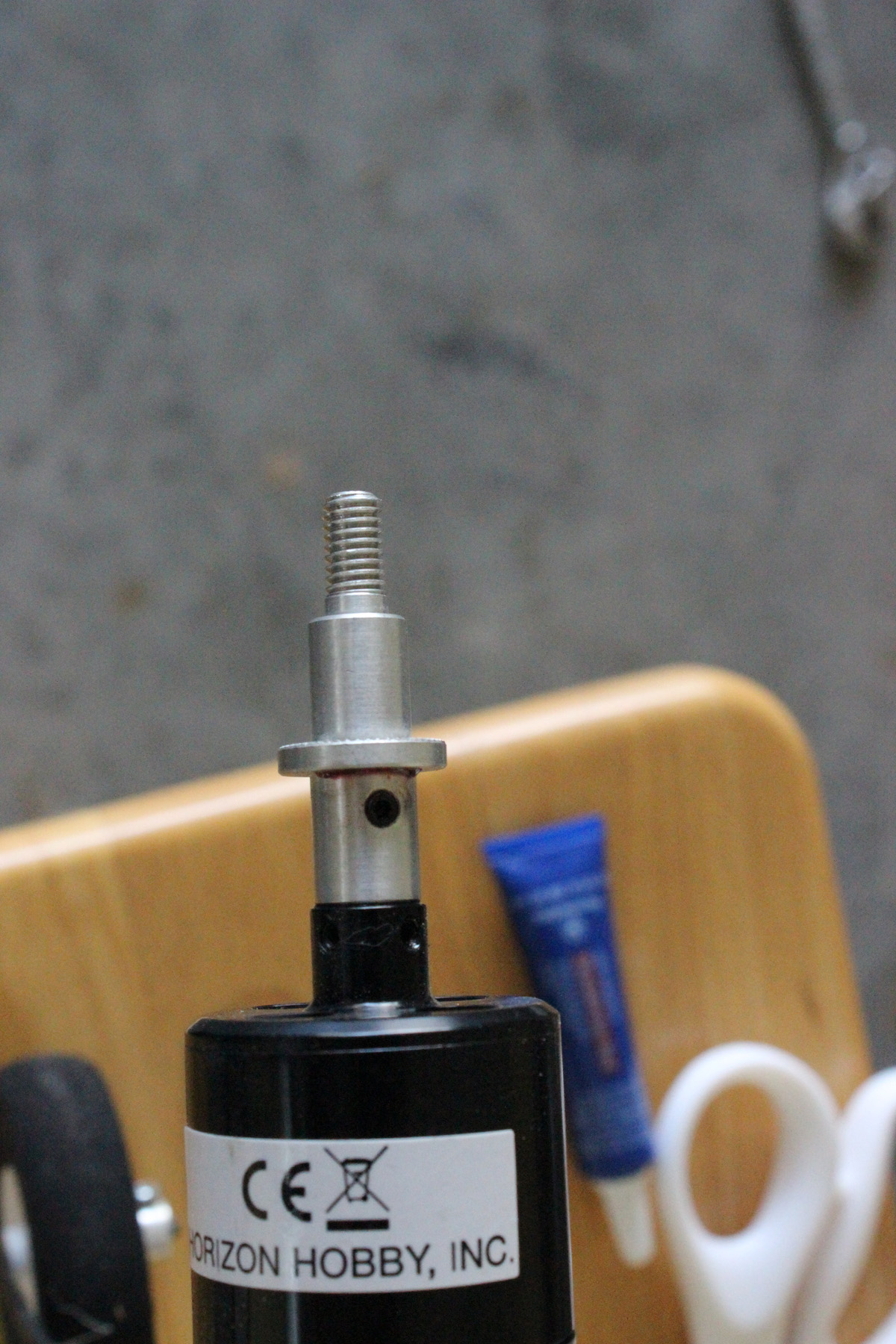

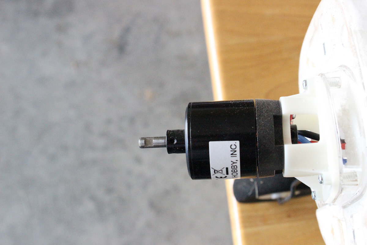

                                    We had some trouble with the Apprentice today.  She lost her prop just shortly after take off.  Diane managed to get her down safely, no small feat in itself, no damage to the plane.
                                    Upon investigation (CSI Cody), the grub screw that holds the outer prop shaft to the inner shaft that comes out of the motor, was stripped. the threads actually came out of the aluminum shaft , on the grub screw.
                                    To heck with this, thinks I.  I get out the thread lock Red version.  Now I know enough to keep it away from the foam and plastic, never fear on that account.  I ran some on the flat part of the engine shaft and some in the hole for the grub screw and threaded the grub screw back in.  If that doesn't work, I'll drill a hole and run a screw right through the whole thing.
                                    This is actually the only silly thing about the plane that I found so far.  Why isn't the shaft one solid piece, screwed onto the engine with four screws like all the other planes I have.
                                    The last thing a newbie wants to worry about is losing his or her prop.
                                    Much to Diane's credit, she remembered the first rule, fly the plane.  She hit the panic button to straighten it out and guided down onto the sage brush.  It landed right on top of one and flipped it over, but it was going so slow that there was no damage, she did a great job!
                                    So, I'm letting the lock tight cure and then I'll tie the airplane down and run a battery through her on the bench.
