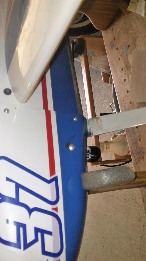

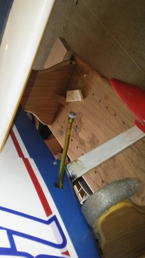

    This is how I did the fuel port on my Phoenix Edge.
    I drilled a hole in the cowl just big enough for the fuel line. Click image for larger version

    Pull the line out to fill, and push it back in when done. Click image for larger version
    The plug holds it secure when in flight. Simple but effective

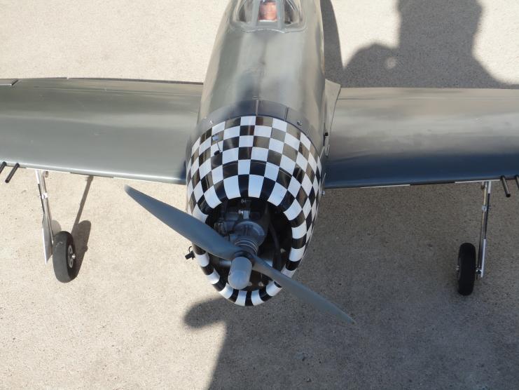

          You can see the fueling valve in the cowl on my P-47.
