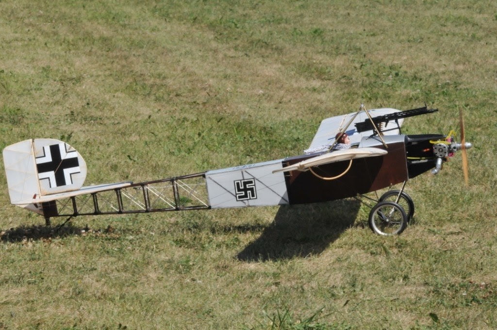

Simple...Find a plane with the same weight and wing span on MRC. Go to "parts" and pick out the ESC and motor for that plane. This is what I do with all my balsa/ply ARF's. Has never failed me. I prefer FMS. DocComment
By the way...Am I mistaken or was the Maltese cross used in WW1? Not the Swastika. Your WW1 plane seems to have WW2 markings. DocComment
