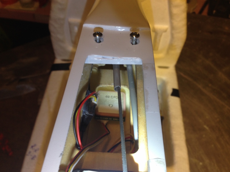

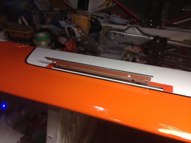

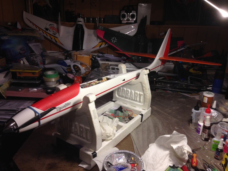

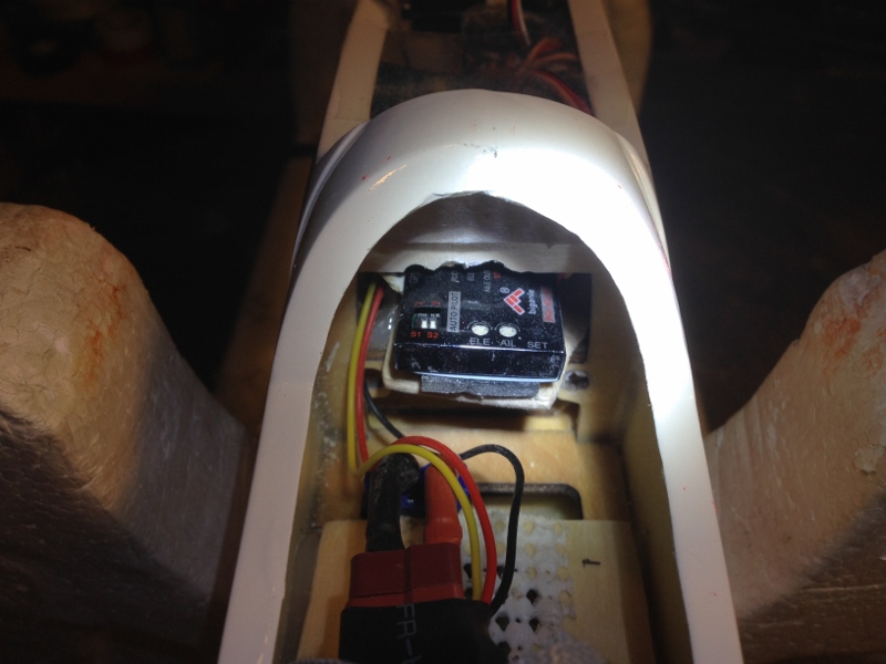

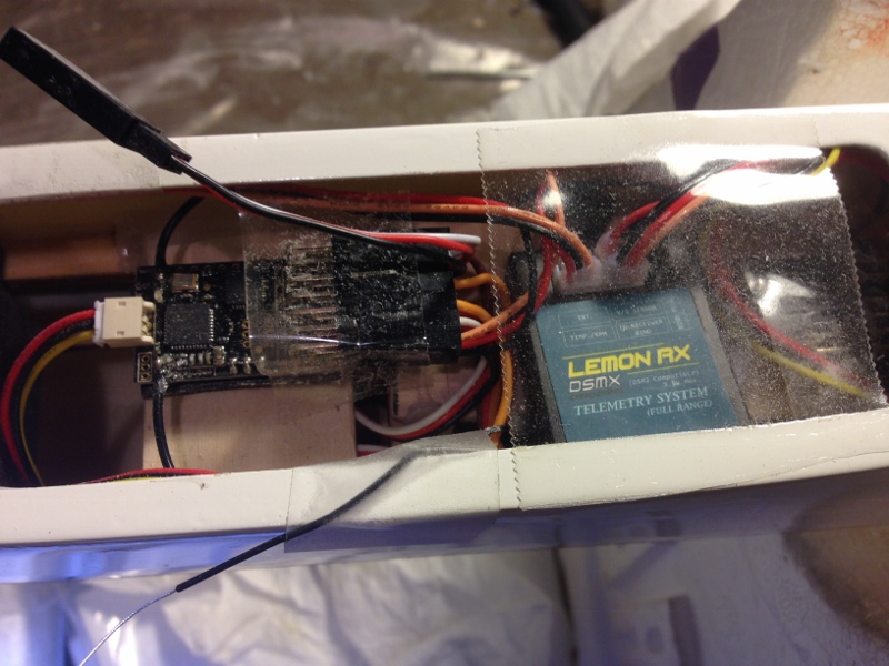

                Here's a few shots of the various items in my BoT.

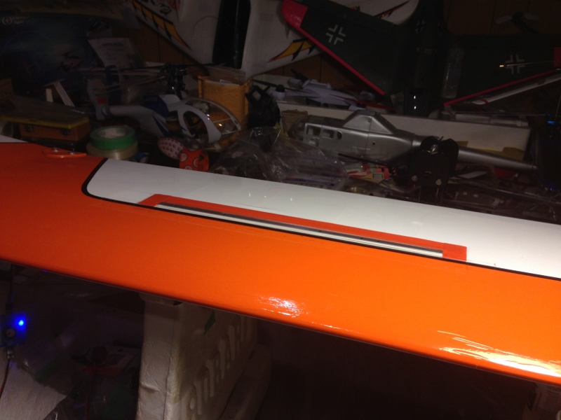

                Middle wing section with spoiler:
                Middle section with spoiler deployed:

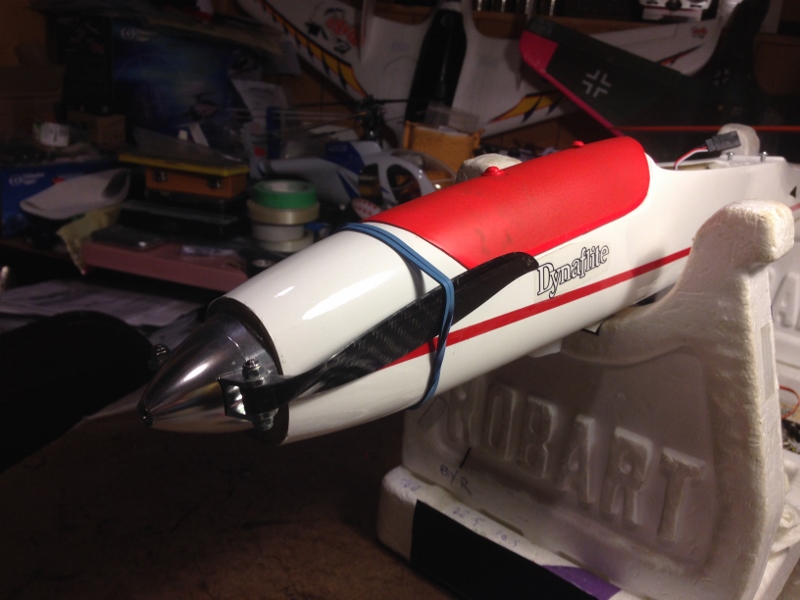

                Shot of complete fuselage:
                Shot of prop/spinner:

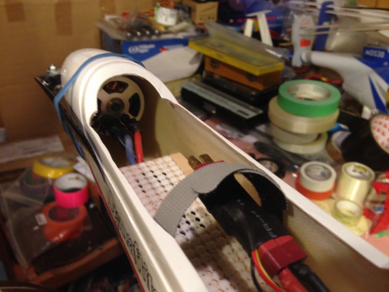

                Shot of motor from inside:
                Shot of Bigaole stabilizer/Return To Home:
                Shot of section under wing with Lemon Rx, Lemon telemetry and back part of Bigaole:
                Shot down to interior showing GPS antenna and satellite Rx antenna:
                Shot of wing tips:

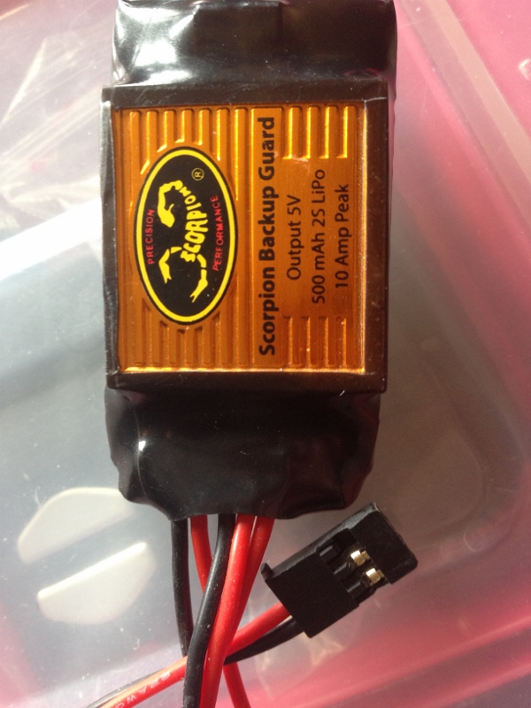

                Shot of Guardian Back Up Rx battery:
