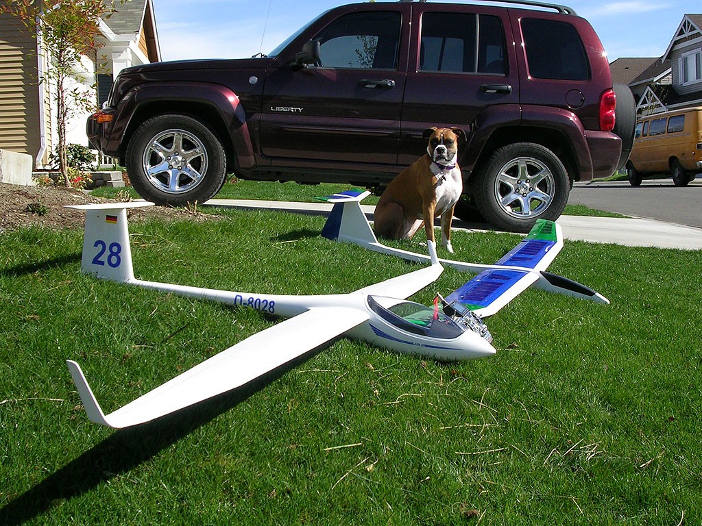

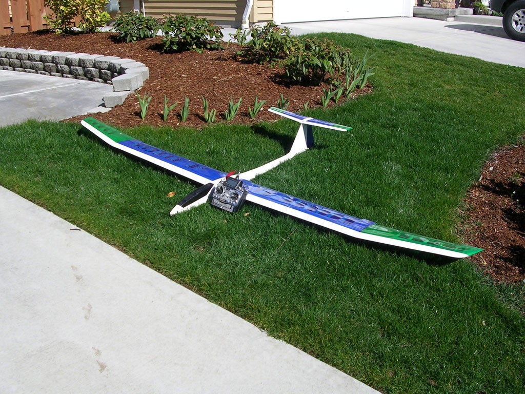

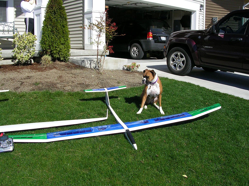

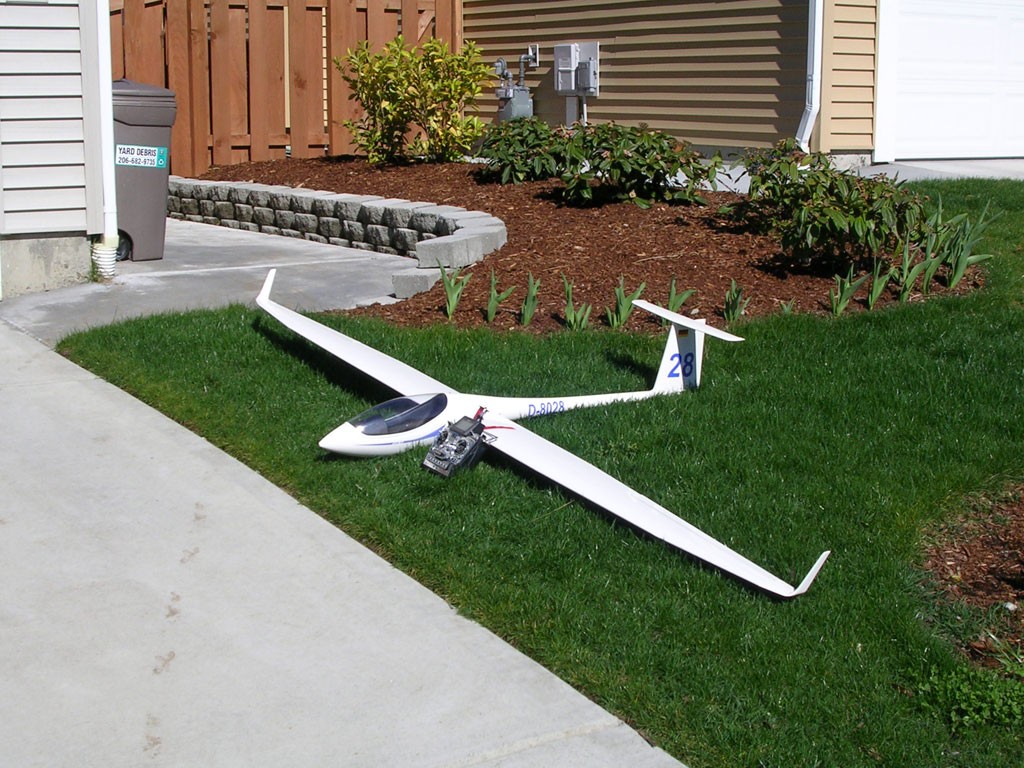

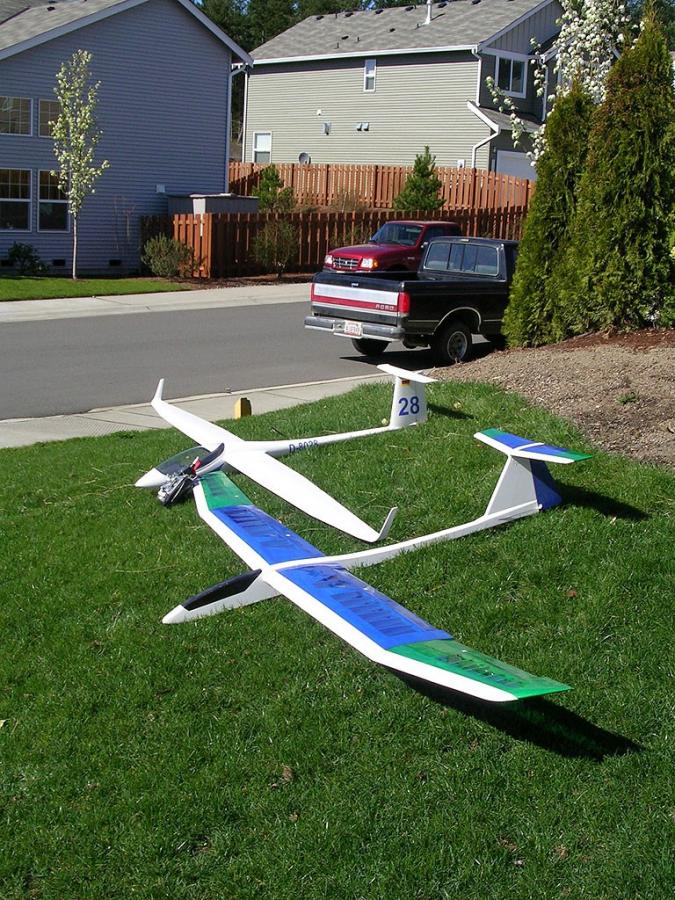

                The guy who taught me how to fly RC had a BoT and it flew as elegantly as it looked. Of course this was a true glider. Only a winch or high start for that bird. So when I think of the BoT I think light and a thermal pro. It's a shame that this EP sounds like a dog.
                My first 3M ASW-28 was a beauty but sounds more like the characteristics of this EP BoT. My favorite thermal glider was my full house "Mystery Ship". Loved that bird. What I would give to still have her. Wish I never sold her. Here's some photos of them. Taken many moons ago.

                  They look very nice models, bet that Mystery Ship was a real thermal catcher. Used to fly competitively with Grand Esprit and Challenger -- sailplanes that could sniff out thermals better than a hound dog ! Just sold an ancient Airtronics Legend, set up for aerotow. If the BoT goes that will be my last sailplane, sticking to my EDF's from here on out. We go out to Colorado every summer and I get to see some of those glass slippers on the slopes -- fantastic but no good on our 78ft hills !!
                    #89
                    Yeah the Mystery Ship was a thermal queen. I specked it out several times. Sometimes I even needed assistance from folks to help get her in a controlled spin just to get her back visually, lol. Ah, the good ol' days.
