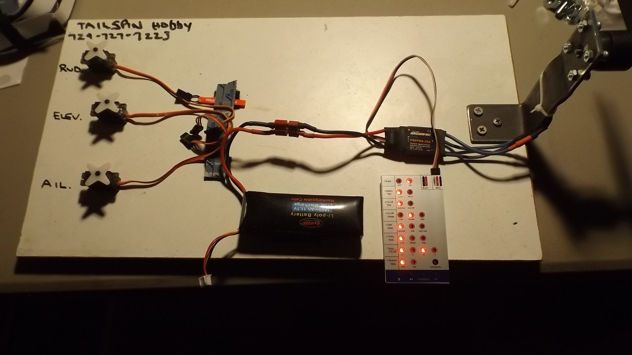

    I have found that the easiest method to setup your ESC is to use an inexpensive ESC programming card from your LHS or online. I got mine from HK & is always in my field kit. It saves many headaches attempting to discern all the beeps. Here's a link & pic of mine....
    Denny
    http://www.hobbyking.com/hobbyking/store/__2169__TURNIGY_BESC_Programming_Card.html

        I had this same problem with a Mantis ESC. They, apparently, don't program well using your transmitter. Buy a programming card. Doc
