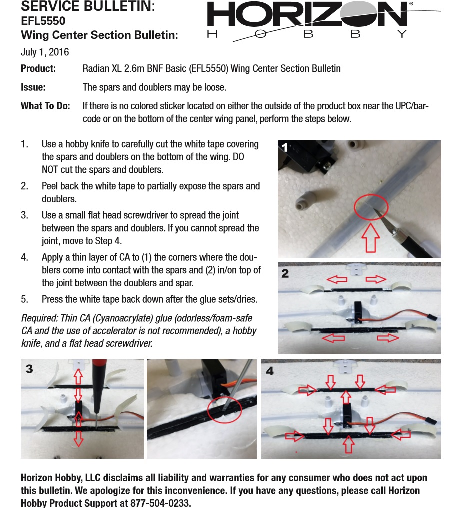

                                  Everyone - If you received your Radian XL in June or Early July - please read the following bulletins from the manufacturer:

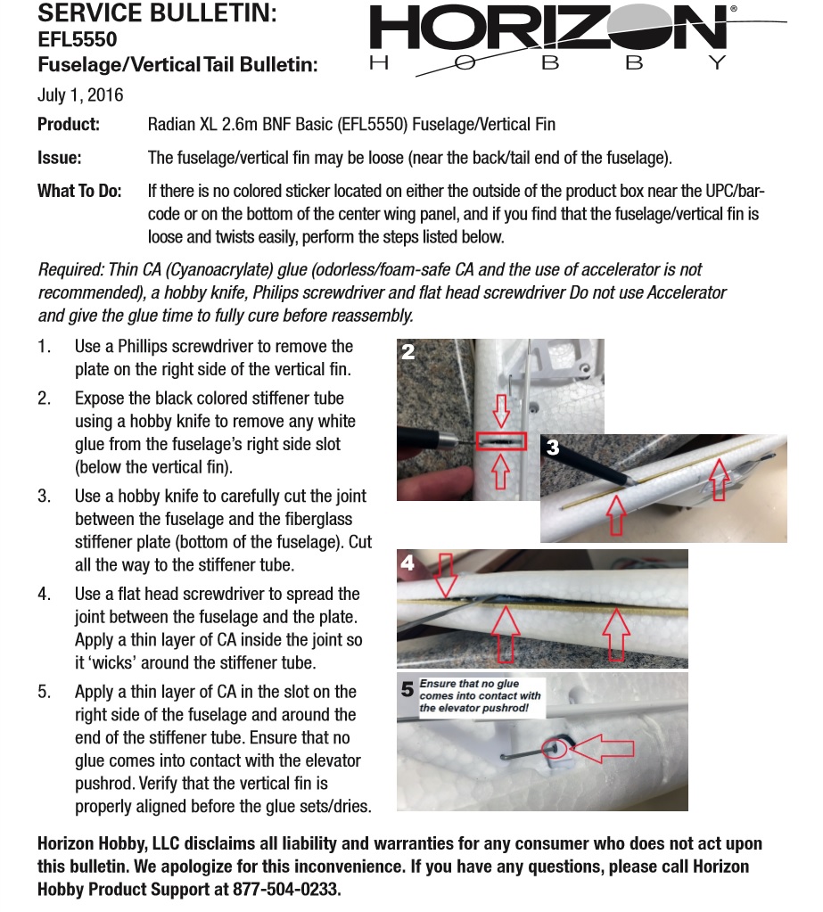

                                    Bulletin 2

                                      Bummer!!!! Thanks for the heads up.

                                        Will Motion RC be adding these Addendum's (Service Bulletins) to the sales front page “Quick Links”, so that perspective buyers can ascertain these and future performance and quality issues for themselves? Or is this the sole responsibility of the importer? Do the SB's call out a serial number range, or production range of effected dates? Or is this solely done with stickers On the Box UPC bar code?
                                        So in the future we will need to cut out a file away the UPC bar code to validate any warranty issue should any future product fail. The problem appears to be so severe that Horizon will not honor any warranty claims for their issue that the customer doesn't fix.

                                          We will not need to add this to the Radian XL page. It looks like the manufacturer is not expecting more until very late August. I'm guessing this is due to the manufacturing problem. The new ones will be correct. We have a couple left in stock which need to be addressed.
