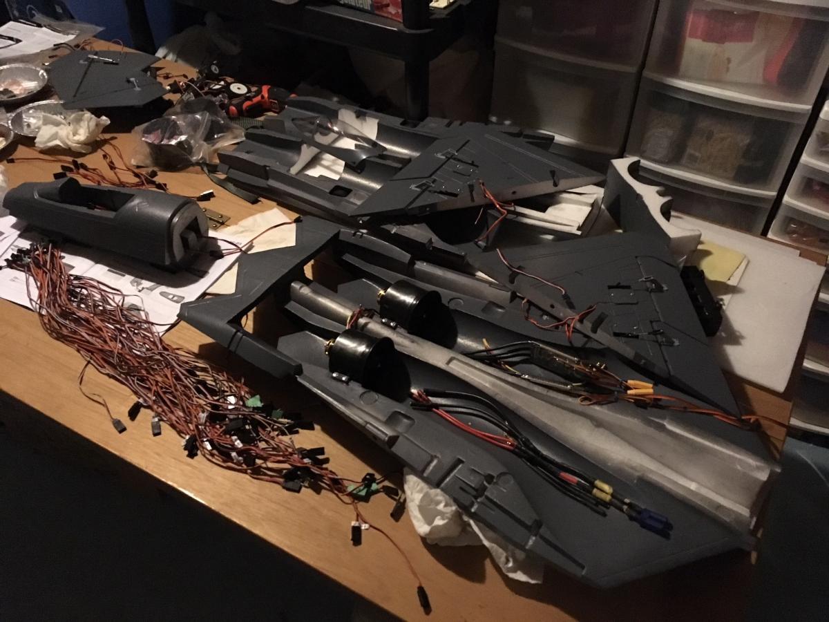

    I am currently in the midst of my YF-23 build. It looks very similar to your F-22 in appearance and process. It's not the best quality kit I've encountered and those supplied retracts are odd - not sure how long they'll last if they will work the first time at all. Bench tests were not smooth and a bit problematic. I hope it flies as well as the F-22 in the videos in this thread.

      Before you get too deep in the build I'll give you some first hand advice on the landing gear.... DITCH THEM !!!! They are crap. The springs in the main gear are soft and you will lose half of the gear's compression if not all of it just from the model's own weight. :Scared:
      I ended up using the main gear from the FreeWing 80mm F-5 with the main shaft pins from the FW ME-262 to get the right orientation on the wheels.
      The nose gear came out of a FW Mig-21 I had available and I installed the landing gear mounts from the FW 90mm F-15 Eagle.
      I've also had some troubles with their ESCs. One of mine failed on testing run up.
      Also be ready to repaint the plane. The paint Banana Hobby used on this model and their F-4 phantom is really soft, rubbery, and my other paints from Homedepot or Lowes do not like to stick to it well.
