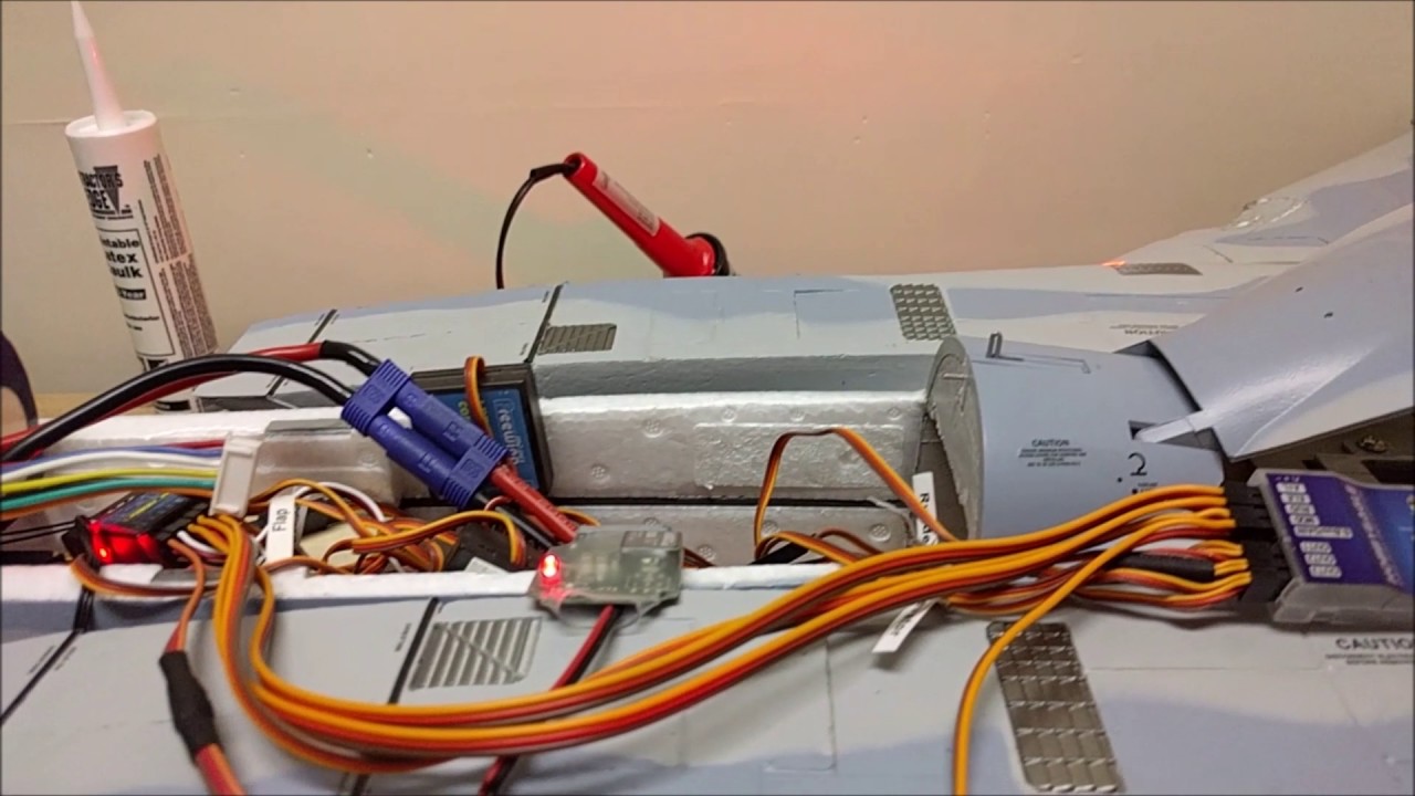

                        I flew this plane for over a year without the gyro. It flew great but had the tendency to do this annoying wiggle and I had no Idea why. So I went through all of the usual things to see what it could be and figured out that a lot of it was due to adverse yaw. The ailerons are not set up in a way that allows for differential which causes the plane to fight itself a little when you use ailerons. SO an aileron to rudder mix was used and it helped A LOT!! But the wiggle was still there.. So I then did a flight that was just to see what the control surfaces did to the plane. I used the rudder and what do you know... the plane wiggled!!! SO I got the LemonRX 7CH (Same as the admiral that just came out) with stabilizer and got to work. Come to find out all of the issues were because of the rudder. My gains are the highest on Rudder with only a small amount on elevator and about half the gain of rudder being used on aileron. The plane is now locked in and does everything I ask of it with zero wiggle!! So the whole reason for me saying this is to say that the plane will fly just fine with out a gyro... But once you add a gyro and tune it right, the plane will become an even more amazing flying machine!!! Here are my flights from this weekend... and yes the gyro is enabled on all of these flights...

                          gooniac33 wow..appreciate it bro..so that means rudder also have something with wiggle rite?i just adjust some expo with it,its better but not too better..so,i think i should put a gyro,and i just ordered and arrived to me yesterday,i will fly soon..i agree with some opinion that this bird flying nice..really..but to make it more nicer,i think gyro help much..i have seen this video on you tube..and it was nice flight..thumbs up :Cool:..and thanks for advice.. i also buy a Runcam 2 for my flight :)..

                            It is the vertical stabs themselves. So when the wind hits them in a cross wind the plan does the wiggle dance. Now that I have the gyro the wiggle is 100% gone. It is working a lot to keep it at bay but you don't see it moving at all now. Much more stable and realistic now!
