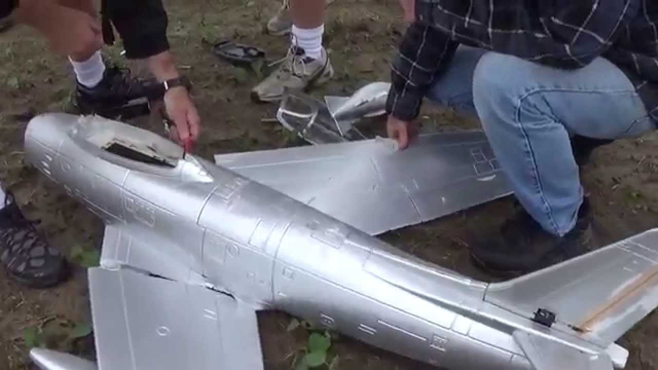

    Finally! The F86 is done. It's ready for a Maiden Flight. It's been windy in Southern California for the past 2 weeks. I hope tomorrow the weather permits the maiden flight of this F86. Here are some photos of the finished build. There is also a FreeWing F86 next to this FLY FLY F86 for size comparison. I will post videos of the maiden flight and landing, as soon as I am able to fly this jet.

    Since this is made of EPS , the spray paints will just eat up and melt the foam. To make the soft and easily dented foam a bit stronger and provide a protective barrier and a smooth surface for paint, I clear coated it with water based MINWAX polyurethane from Home Depot. I sprayed three coats to fill in all the pits and cracks. Then used a silver RUSTOLIUM Metalic Finish paint from Home Depot. The final outcome is very impressive and Scale.
