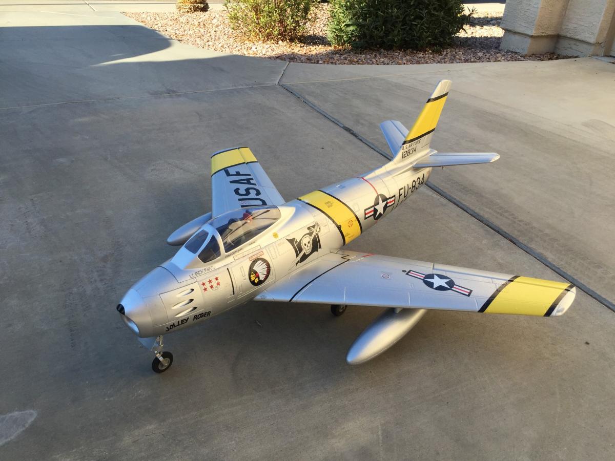

You can't go wrong with the Freewing F-86. I've had 2 and loved them (lost them both in over-agressive flight. Nothing wrong with the plane).
I flew mine on 6S 5000, and got over 4 minutes of hard throttle flying time. You have to make a slight modification to the way the ESC is installed, because the battery needs to move back to the back of the compartment. But, it's well worth a little messing around in there. Not a big deal at all. The ESC just needs to be dropped a little lower so the battery will move farther back.
I think it's definitely worth it to fly a 5000. But, it will fly on a 4000 just fine and you'll get about 3 1/2 minutes.
Agree with what was said about the puffing. If you keep the discharge above 3.75 per cell, you'll be okay. Get them back up to storage charge as soon as you can, so don't leave them down at the low voltage for too long.
You'll love the plane. It looks and flies great.

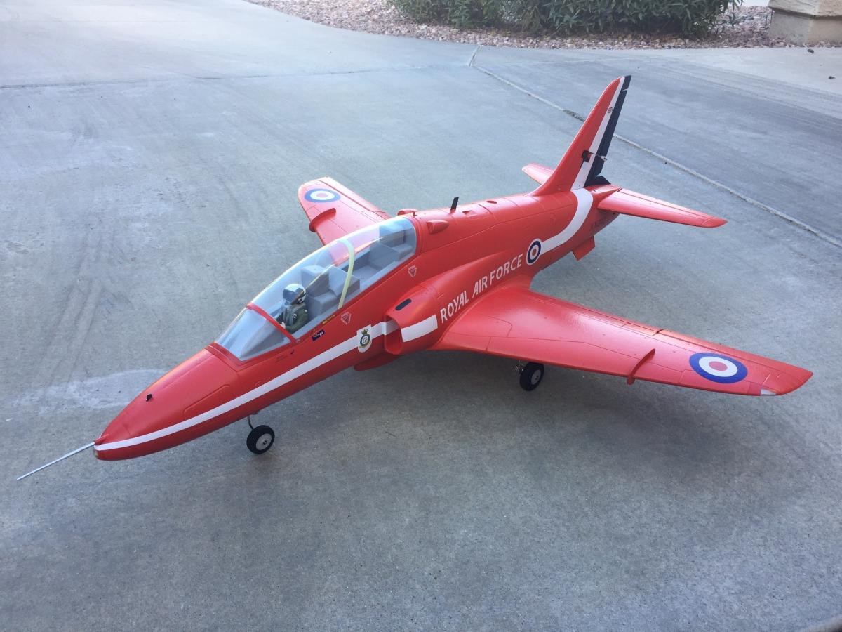

That all being said, if you want a really great EDF that flies great on a 4000 6S battery, consider the BAE Hawk. It's an outstanding plane. A little smaller than the F-86, but much more fun to fly.
