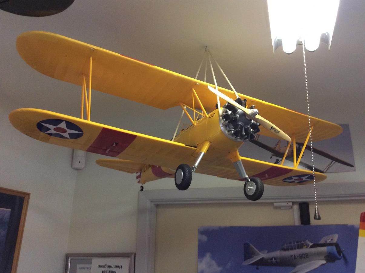

                  #68
                  The videos on UToob made set up and first flight near perfect. I had to add 5 turns of the clevis to give me down elevator. I figured out 2.3 oz in the dummy cylinders to balance and checked it inverted and right side up. CG checked at the forward limit and as far as the battery - I just tied it down with an inch hanging over the front of the sled and it touched the firewall. Still doing the same.
                  Since new, I have easily over a hundred flights. Replaced one wing servo and the rudder hinge got a new upgraded variety.I’ve worn out one set of tires all around and the cabanas needed a little Gorilla Glue at the fuselage as they got somewhat loose and sloppy.
                  the 2 coats of Polycryllic have also helped her maintain her charming girlish figure.;)
