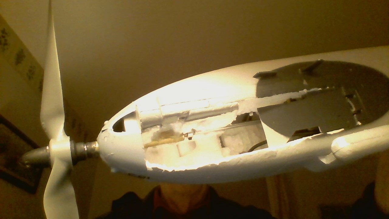

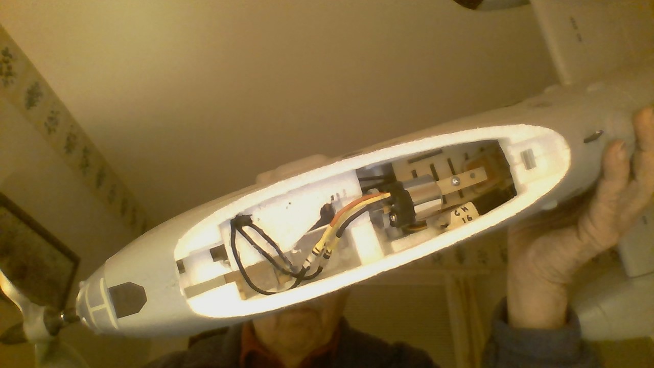

    A-10 with endurance.

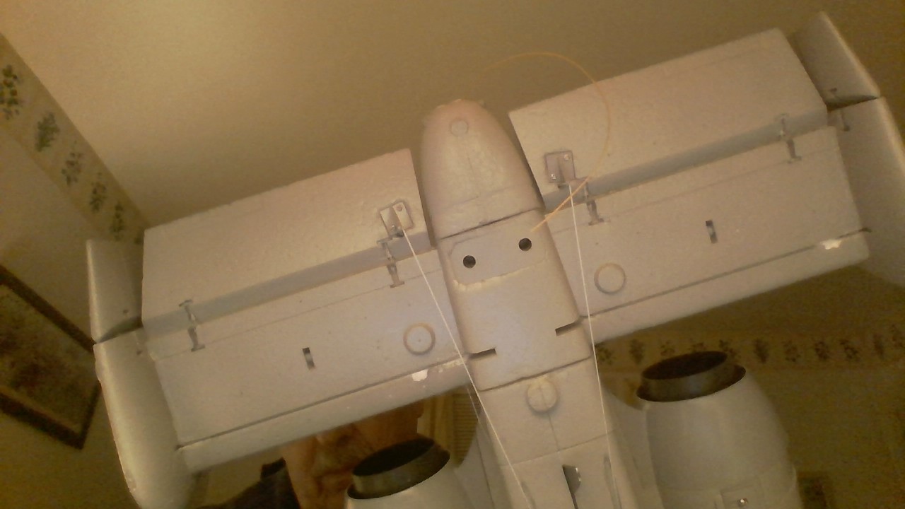

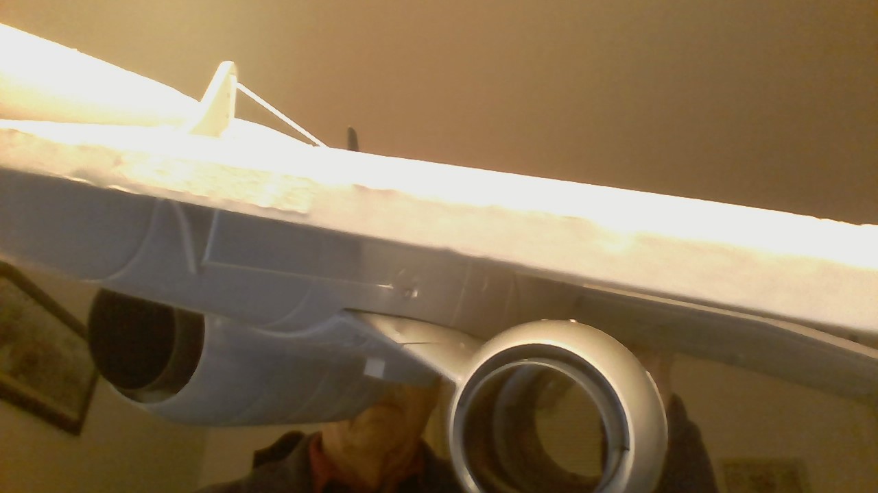

     Plane can fly for  10 minutes at WOT. 3 cell 1800.  Push pull elevators with fishing lines to reduce tail weight. remove both rear engines & wires. Move ESC forward. use of a Helicopter 3600 KV motor & GWS 400 size gearbox with 4.5 to 1 gears. APC E 9" x 6" prop.  gives about 53 mph & 30 ounces of static thrust.   Plane weighs 37 ounces RTF
    The geared down prop shaft is inside the cannon barrel.  Wound up, the prop disappears & the cannon  barrel is only visable in flight.
    I hand launch at any angle except straight up.  30 amp motors are loafing at 12 amps. during WOT.
    Final fitting of foam filler blocks & a touch up paint job on the belly.
