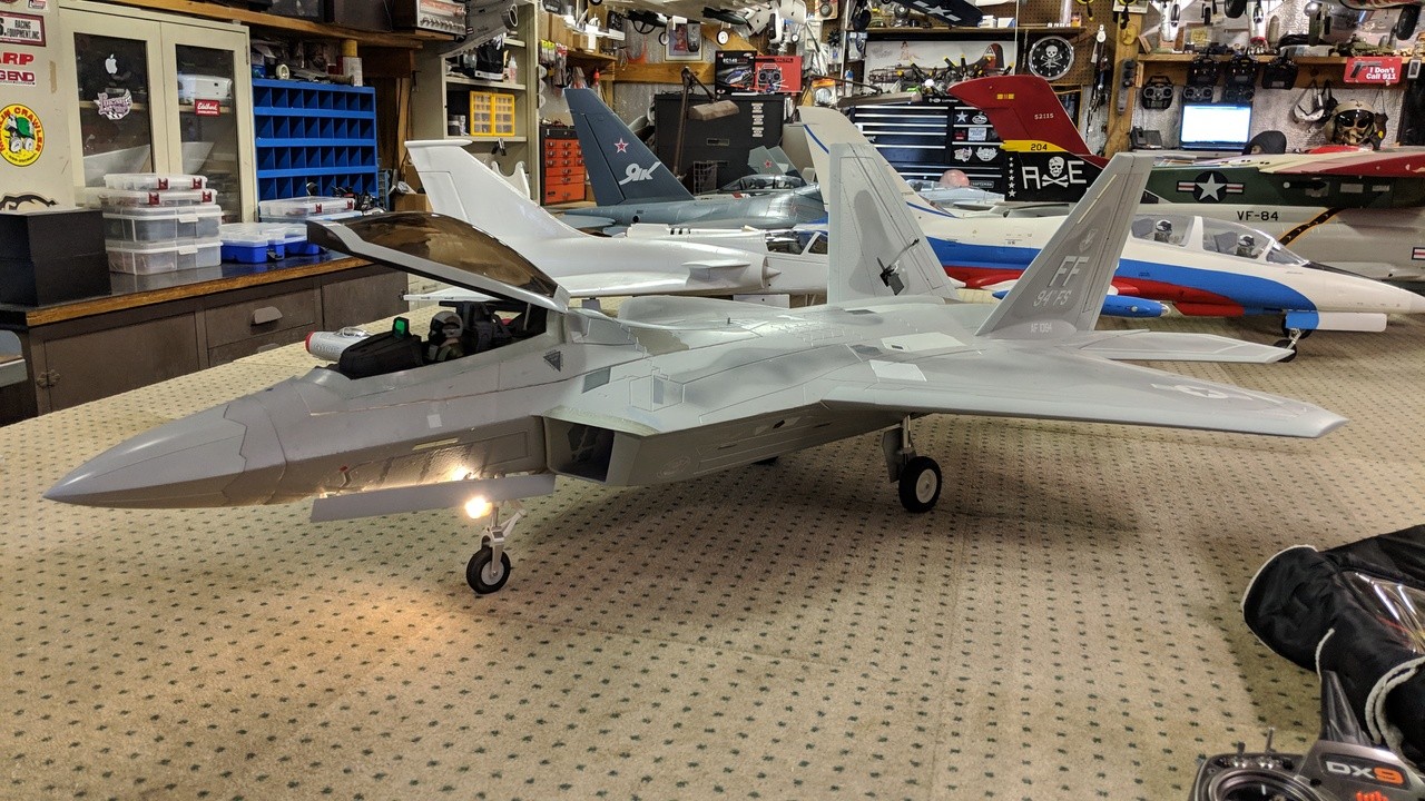

    Looks fantastic Steve. Nav lights, operable canopy, cockpit upgrade and rocket launch bay....all look super cool!! Merry Christmas and I got my wish, the Seahawks won and I ordered the Raptor today.
    For this shot I added the missle bay.

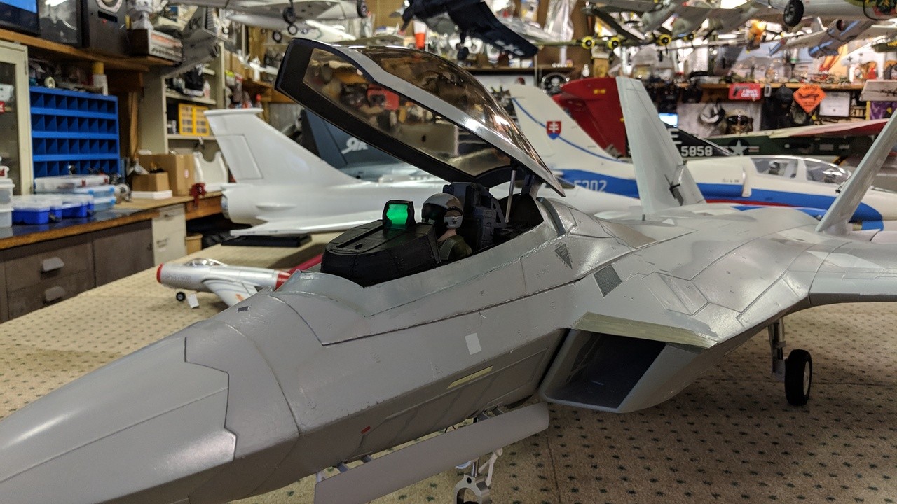

    Hey Steve, that canopy frame looks awesome and, as Tom said, having the hinge design already there is super handy. Looks like you had to shave the foam around the canopy seat area to allow for the frame thickness. I too would love to have that setup when your ready to sell me one. By the way, how did you light up that green sighting mechanism? After seeing how visible that is on the real Raptor, that would add even more realism and just plain bling. Go Hawks!!
    Yes, the install of the frame requires shaving some foam away around the cockpit. I then lined the bare foam with 0.010" styrene. The green HUD is not lit up but a piece of green transparent plastic I got from Hobbylinc
