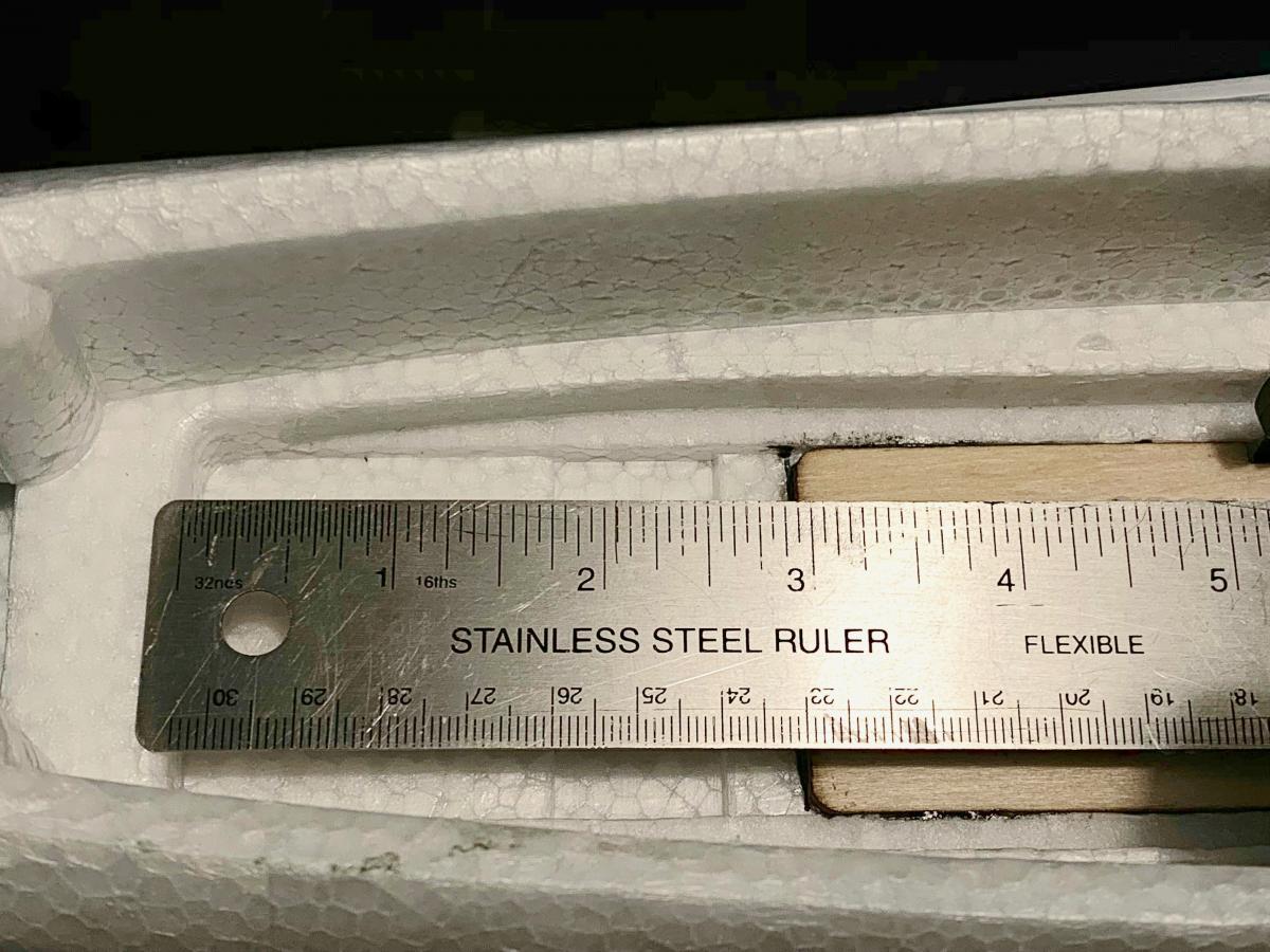

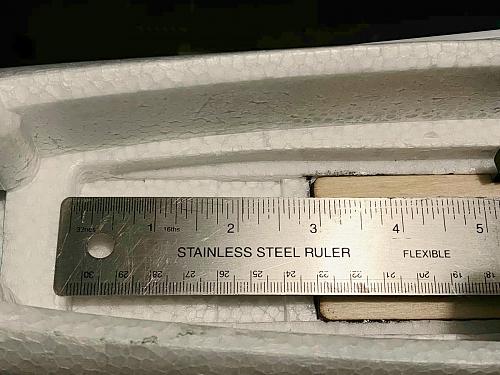

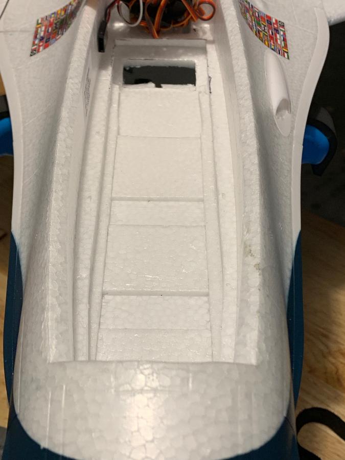

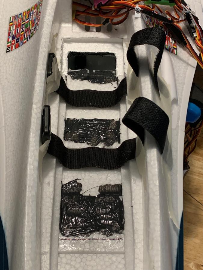

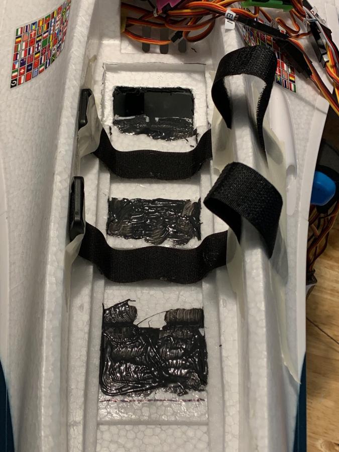

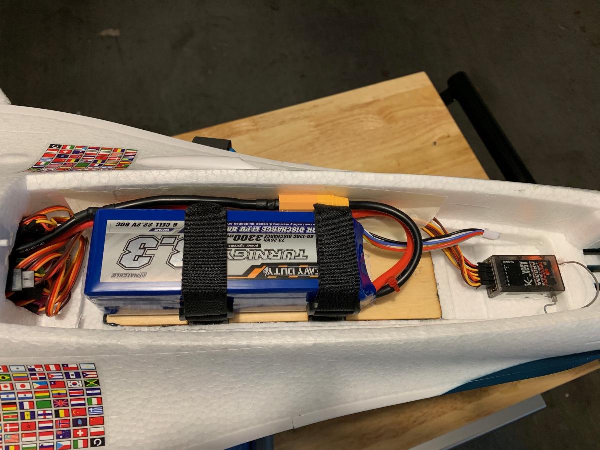

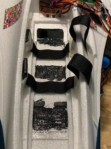

                              ZCOL, how did you manage to get the CG right as called out in the manual? At first I had to add 48g of ballast to the tail cone to make it balance with a 6S 3300!! Then I got to carving, relocating the battery tray 3" back (as far as I possibly could without obstructing the main intake), moving the receiver (I got the BNF version) to the front of the battery bay, extending the ESC leads, and running servo lead extensions to the new receiver position.
                              EVEN NOW the battery needs to be all the way back on this relocated battery try to achieve the CG called out in the manual. But hey... at least I didn't need to add any weight! :)

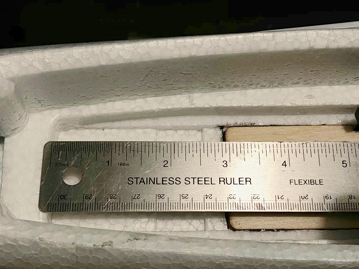

                                I found cg if I aligned the battery with the sticker that comes on it inside the battery bay. I’ll take a picture of what I’m talking about this weekend to show you. I hate you had to go through all that to get her cg. I usually use the manuals call out as a recommendatio. I know it’s bad practice but I do a unofficial finger balance and let it rip. I hope the bird is flying well for you. Starting to become one of my favorite flyers.
                                • #17

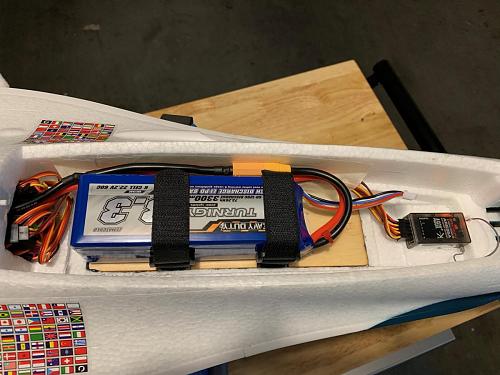

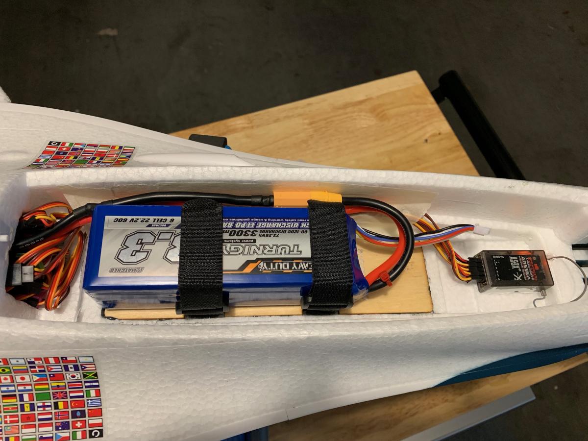

                                  Andrew_flyguy
                                  took some pictures today this is where I found CG my battery lines up with the last line of text on that sticker roughly 5.5cm from the the cut out for the battery. Manual called for landing gear to be down as well.
                                  Hope this helps

                                    Originally posted by ZCOL View Post
                                    Andrew_flyguy
                                    Hope this helps

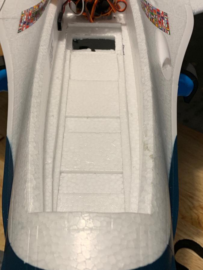

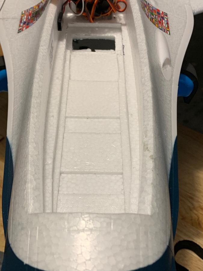

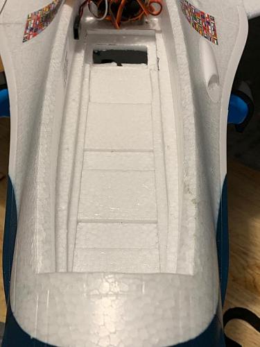

                                    I'd overlooked that part in the manual about working CG out with the gear down. Thanks for posting these pics!
                                    Could I trouble you to post a pic of the battery bay without a battery in it? I plan on making a video for YouTube and discussing the battery tray mod, but need a stock photo.
                                    • #19
                                      Andrew_flyguy
                                      no no worries brother I can take some pictures this Sunday and post them here. I’ll try to get different aspects of it.
