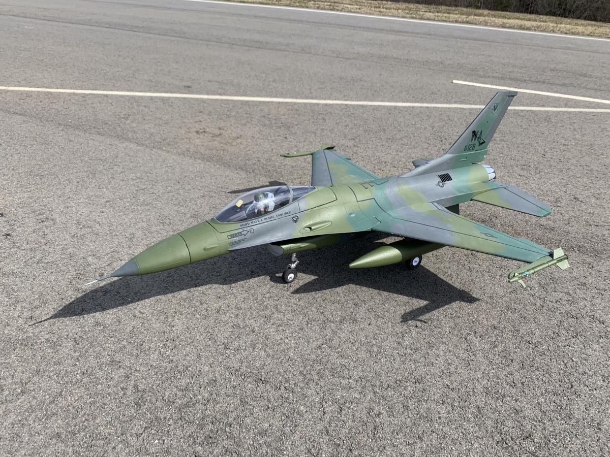

The U.S. Air Force tested the theory of a dedicated Close Air Support (CAS) version of the F-16 in the 1980’s. A squadron at Nellis AFB wear painted in the Euro 1 scheme similar to the A-10’s during that time. An Air National Guard squadron, the 174th out of Syracuse, NY, even traded their A-10’s for F-16’s to further evaluate the concept. The pilots would wear a patch saying, “Fast ass CAS.” Their planes retained the standard gray camouflage.
This repaint is of one of the Nellis birds. I added the Jet Hangar hobbies pilot figure and reduced the width of the F-22 ejection seat .stl file and printed it on my 3D printer. The wing tanks are from the Freewing A-10 64mm mounted with the Freewing weapons attachment hardware. I’m thinking about adding a centerline tank as well as some AGM-64’s on the outboard wing stations. I also have a centerburner installed.
