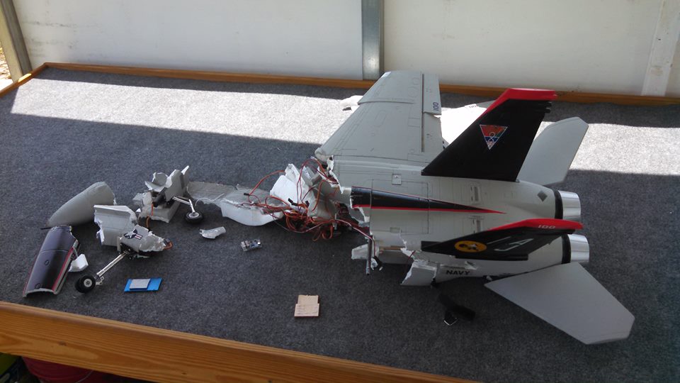

    Soooo If I needed a new fuse for the 90mm FA18, is it 'unglued/unassebled' so you can run the wire leads? Just asking, ya know, for friend.  :angel:

      Thanks Konrad that's good to know. It appears only the main fuse and wings were damaged. I think I can bring her back to life!

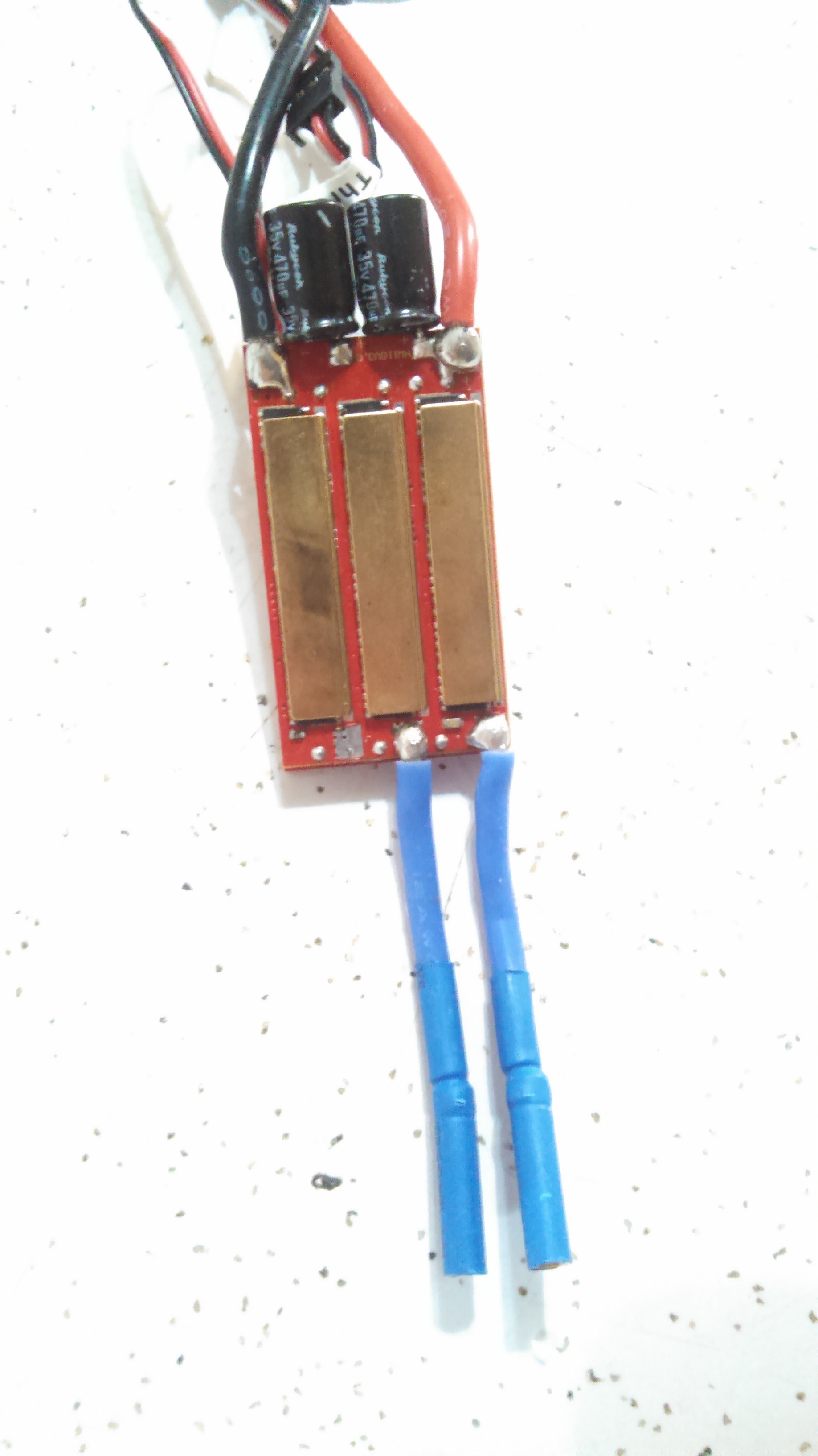

      I'm SERIOUSLY wondering if this is the cause of the failure!!! It seemed weird that it didn't have enough power to pull up!!!  There's no remnant of any solder on the board. If there was a break from the impact, there would at least be some damage to the board????
      I know on my rc race cars, you can lose one of the 3 leads and it'll still run, just wayyyy less power. That seems to be making sense now that I didn't have enough power to climb!
