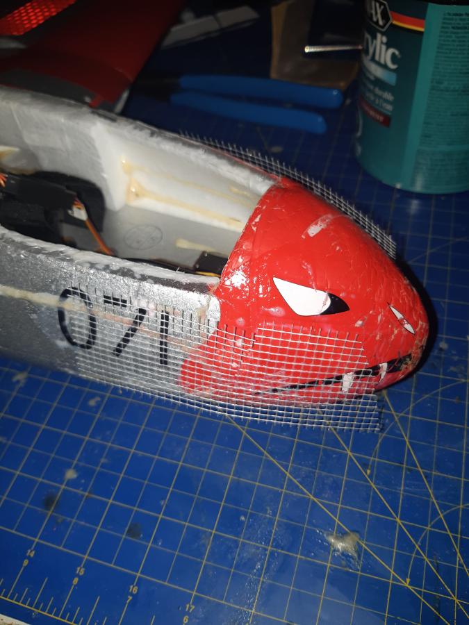

        This is a super weak spot. I'm strengthening the nose super solid this time.
