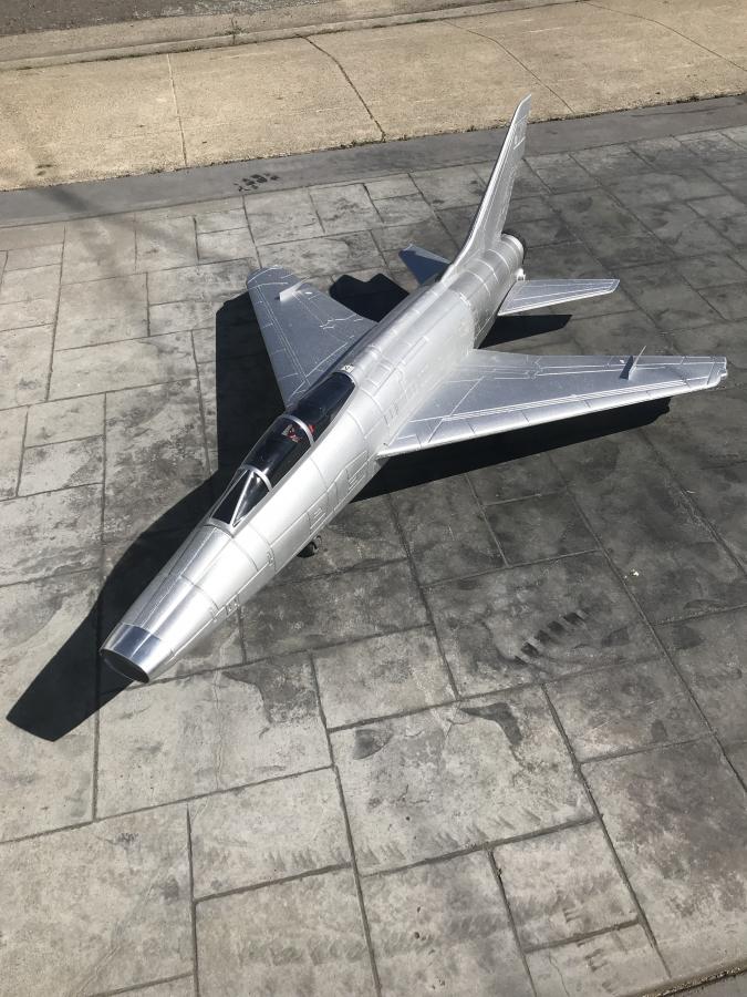

          Here is the link for my ad. Just look at some of the photos for guidance.
          Marketplace - Fly Fly F100 Super Sabre $600 Firm - Fly Fly F100 Super Sabre. This F100 Has been upgraded with West Systems Super light Epoxy Coating and has HiTec Servos. It also has upgraded Freewing Landing Gear with Landing lights. Currently Has 8S Freewing Phantom ESC and Motor but is not included in the sale.

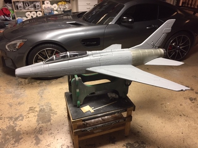

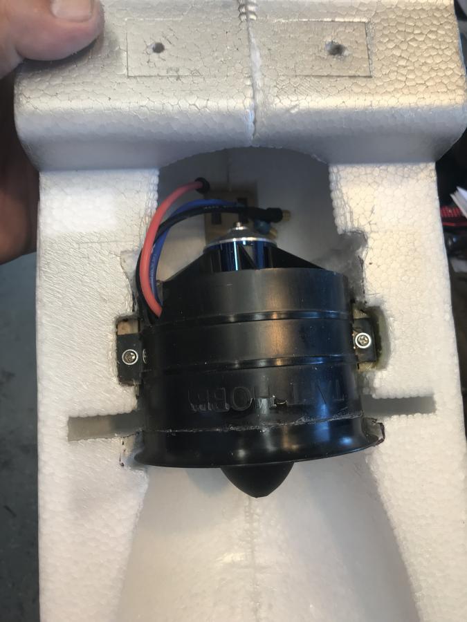

                  You guys are great. I have flown my F-100 twice. I had serious stab problems. And yes I had to add 8 ounces of tail weight. As I said I am using the Taft 90 with their 1470kv motor. Slow at the start but once it gets going it has plenty of speed to stay up and fly scale. The Freewing retracts are out of their Venom. But honestly, this jet although I love the look, is a great example of what we used to have to deal with. Under engineered and just a load of structural issues. I have plenty of experience in the situation because I built several of the Hobby Top Gun L-39’s. They were not as bad as the hun, but close. As soon as possible I will post a flight video. Sorry for the late response, I have not been on the squak for a couple weeks. As it sits it weighs in at 7lbs 9 oz. Heavy....I will look at that tutorial when I get home from this short vacation. Ordered graphics from Callie. Thanks Again for your responses. If Freewing came out with the 100, this FlyFly would be hanging at my local hobby store. But I am determined to make this a solid jet........

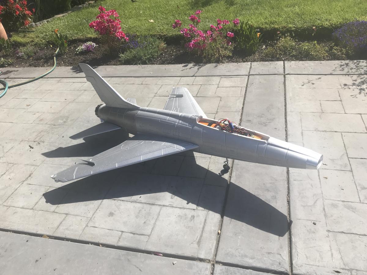

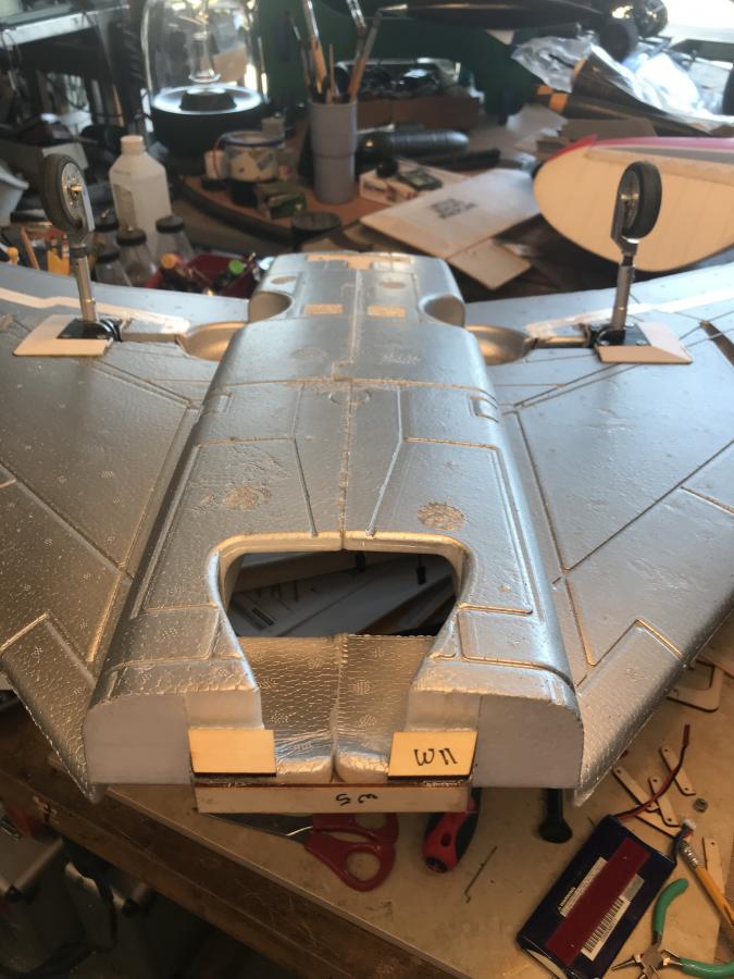

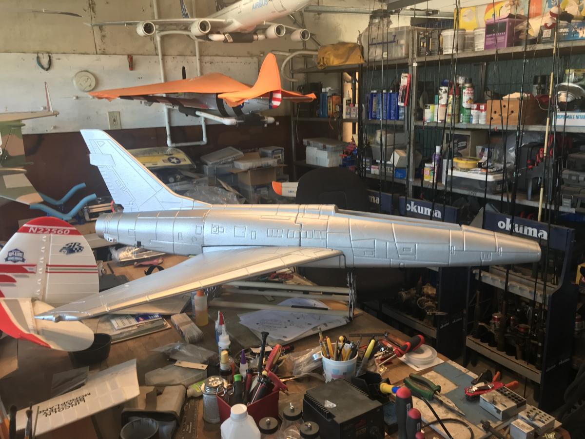

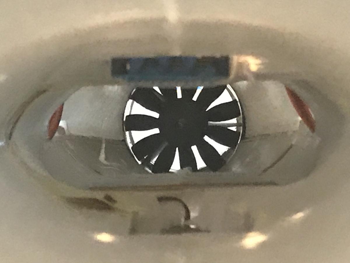

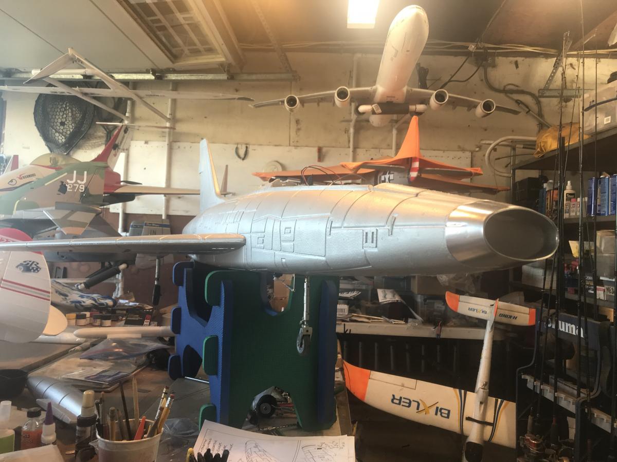

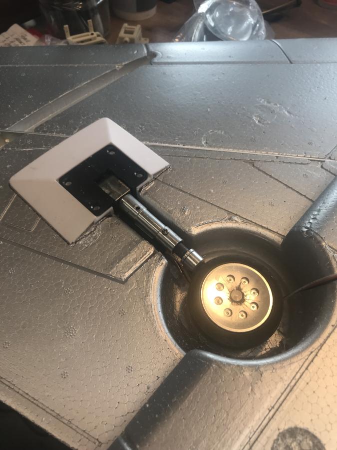

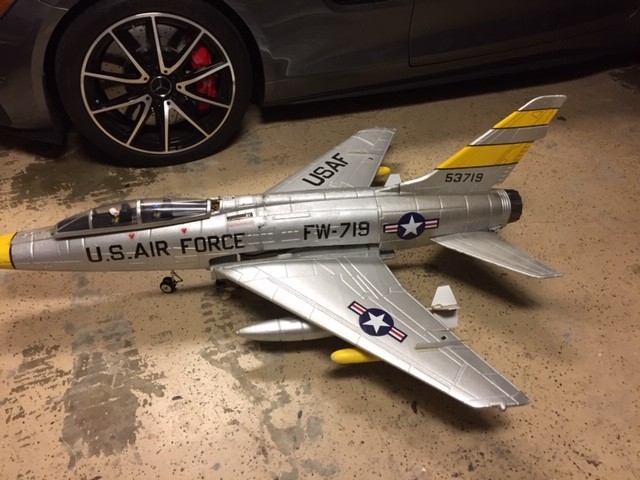

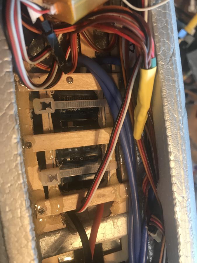

ID:	203493Click image for larger version
ID:	203494Click image for larger version
ID:	203495Click image for larger version
ID:	203496Click image for larger version
ID:	203497Click image for larger version
ID:	203498Click image for larger version
ID:	203499Click image for larger version
ID:	203500Click image for larger version

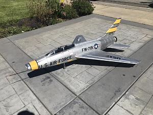

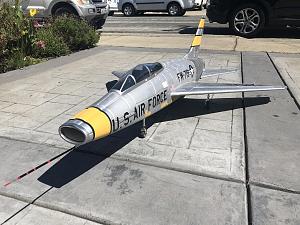

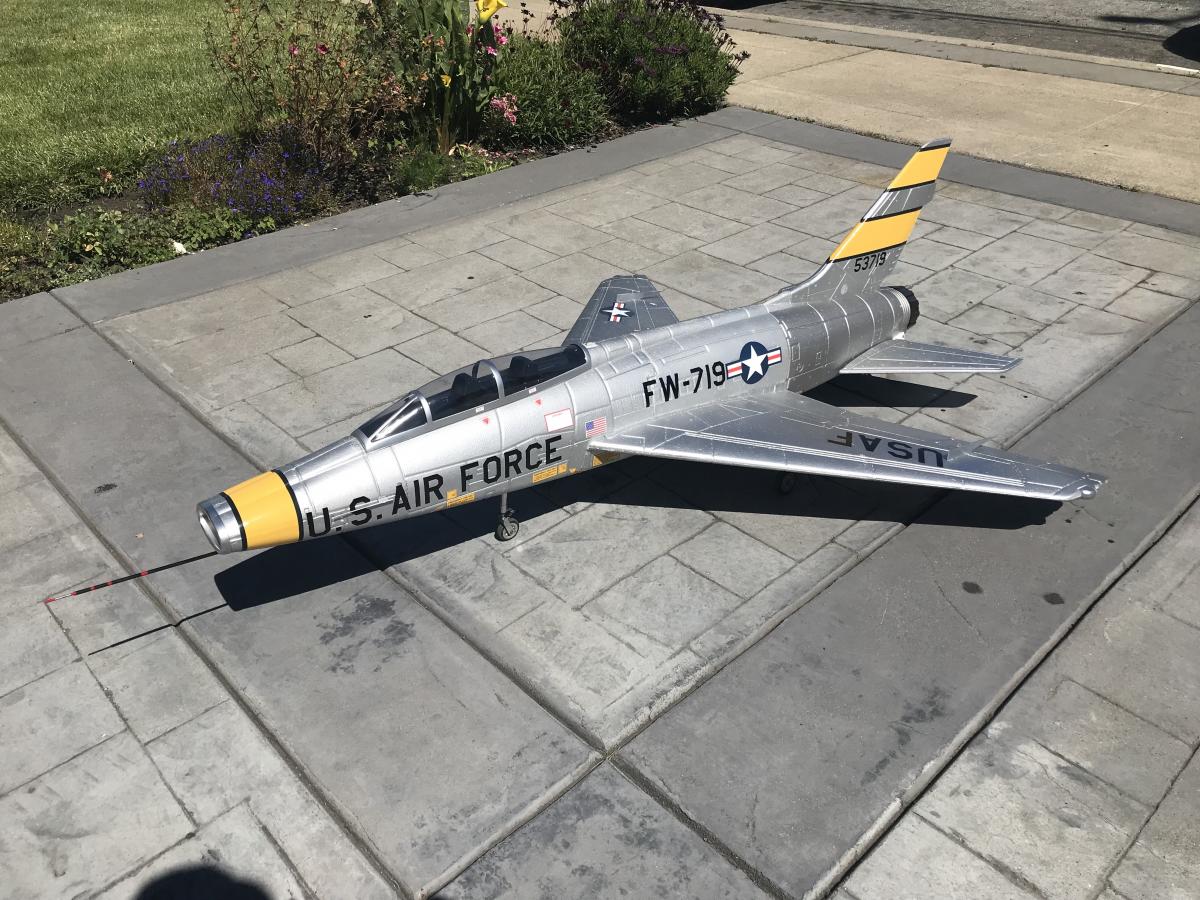

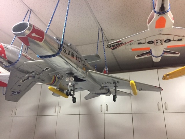

                              Shoutout to Callie Graphics....DONE! Click image for larger version
ID:	203626Click image for larger version
                              • scootergenie
                                Jet lover
                                • 261
                                • Stuart FL.
                                Now that looks sweet !
