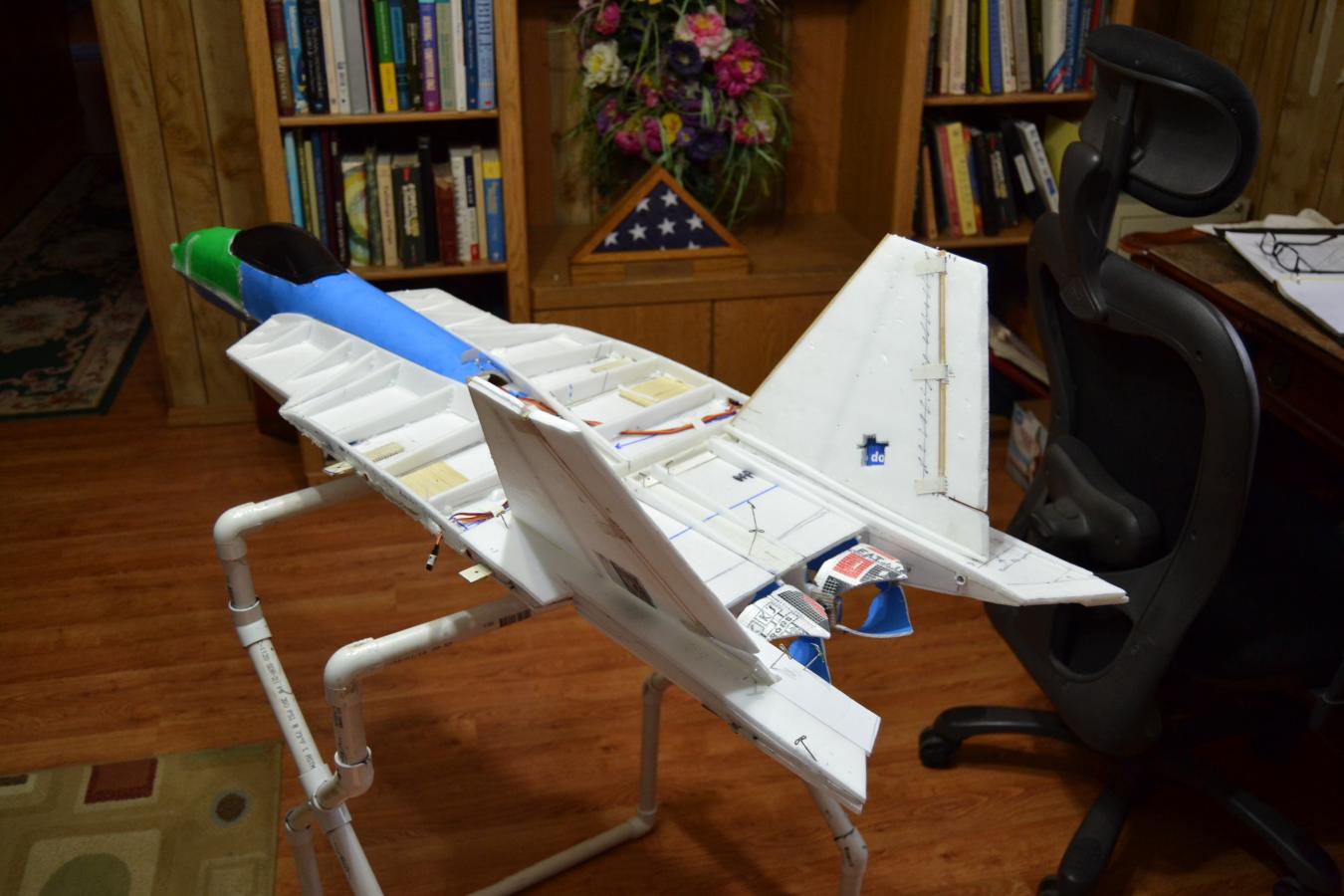

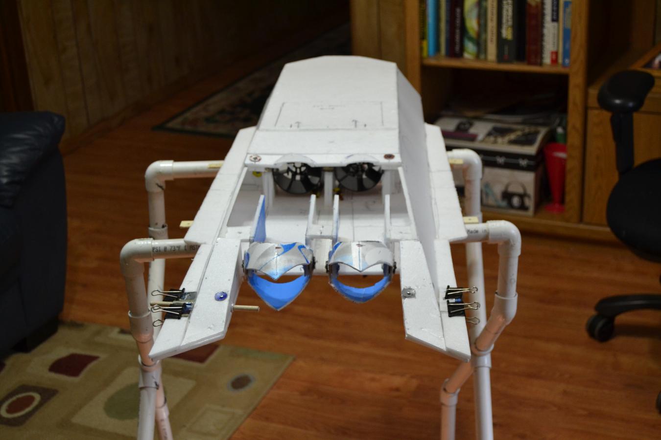

    Do anyone scratch build large military jets (with retracts, flaps and lights as close to scale as possible)
    I just want to see how others are building large (WS 38 inch and above) jets. here are some of my builds.

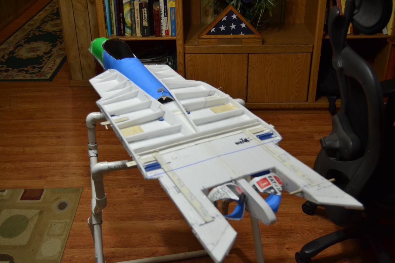

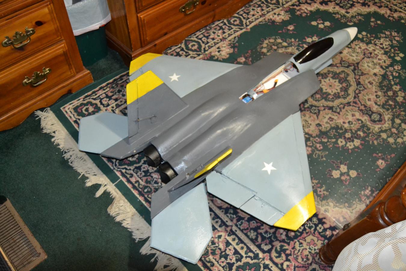

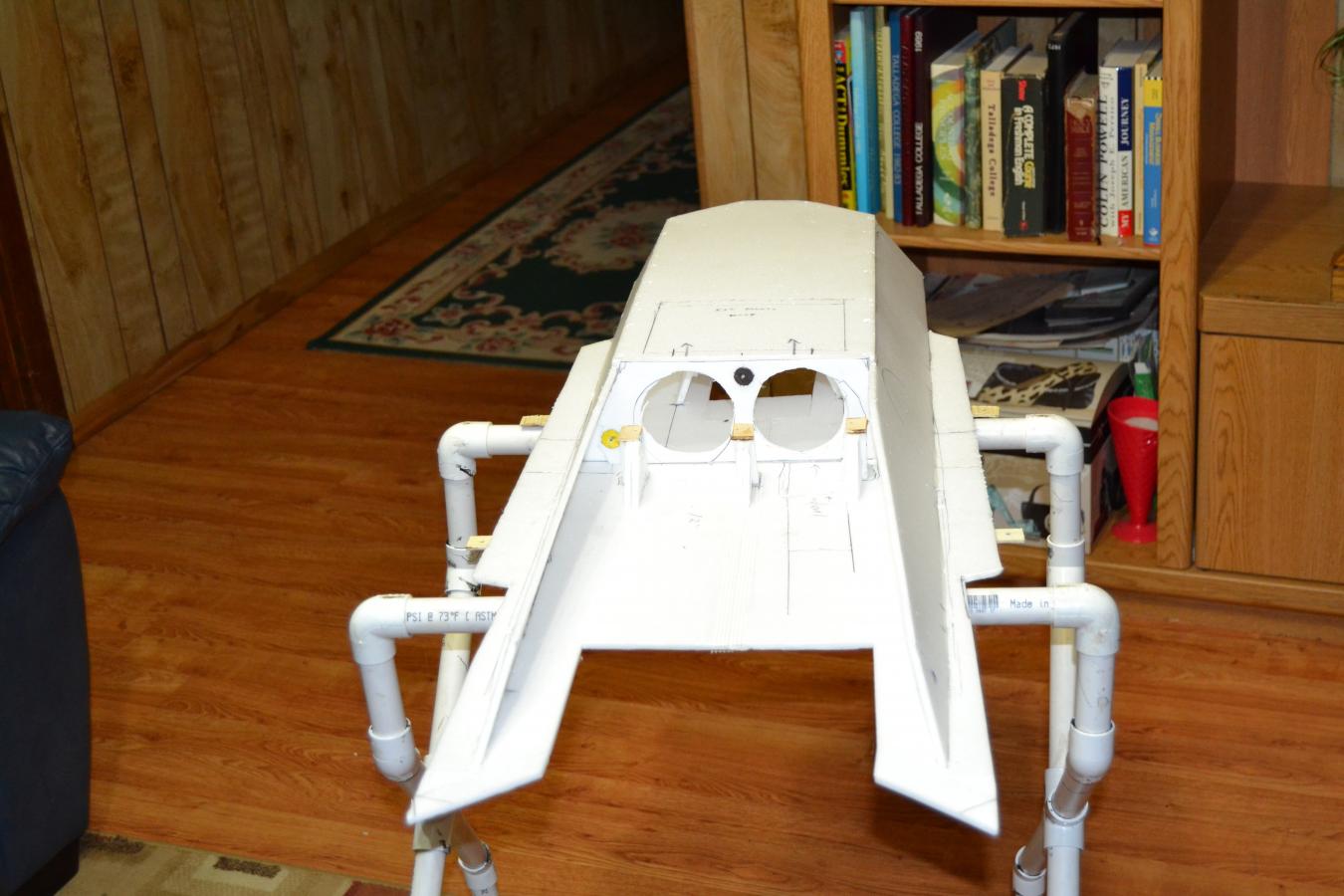

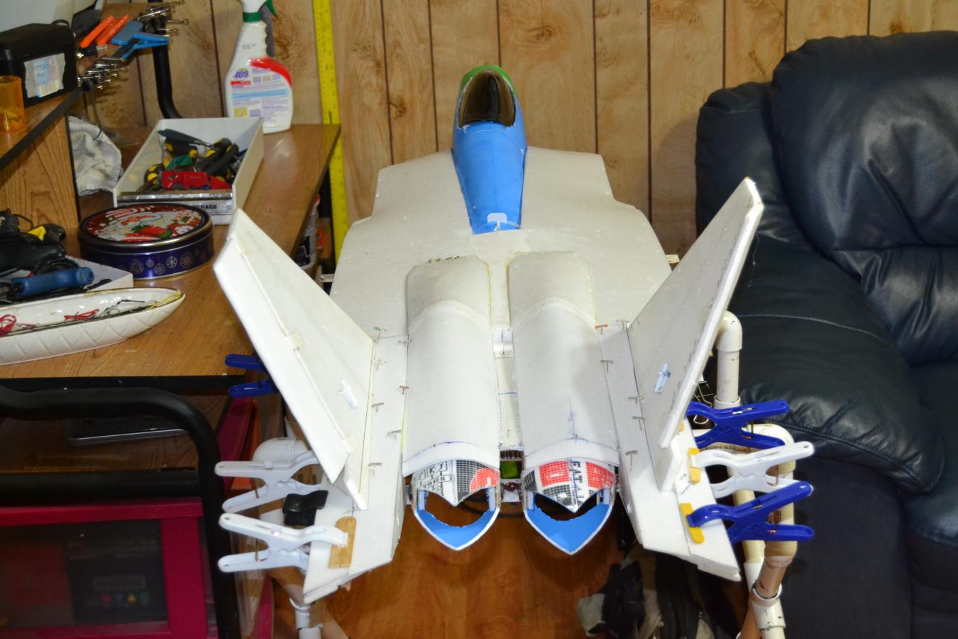

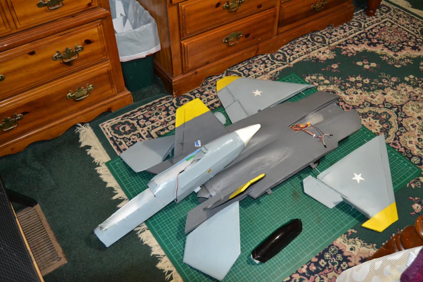

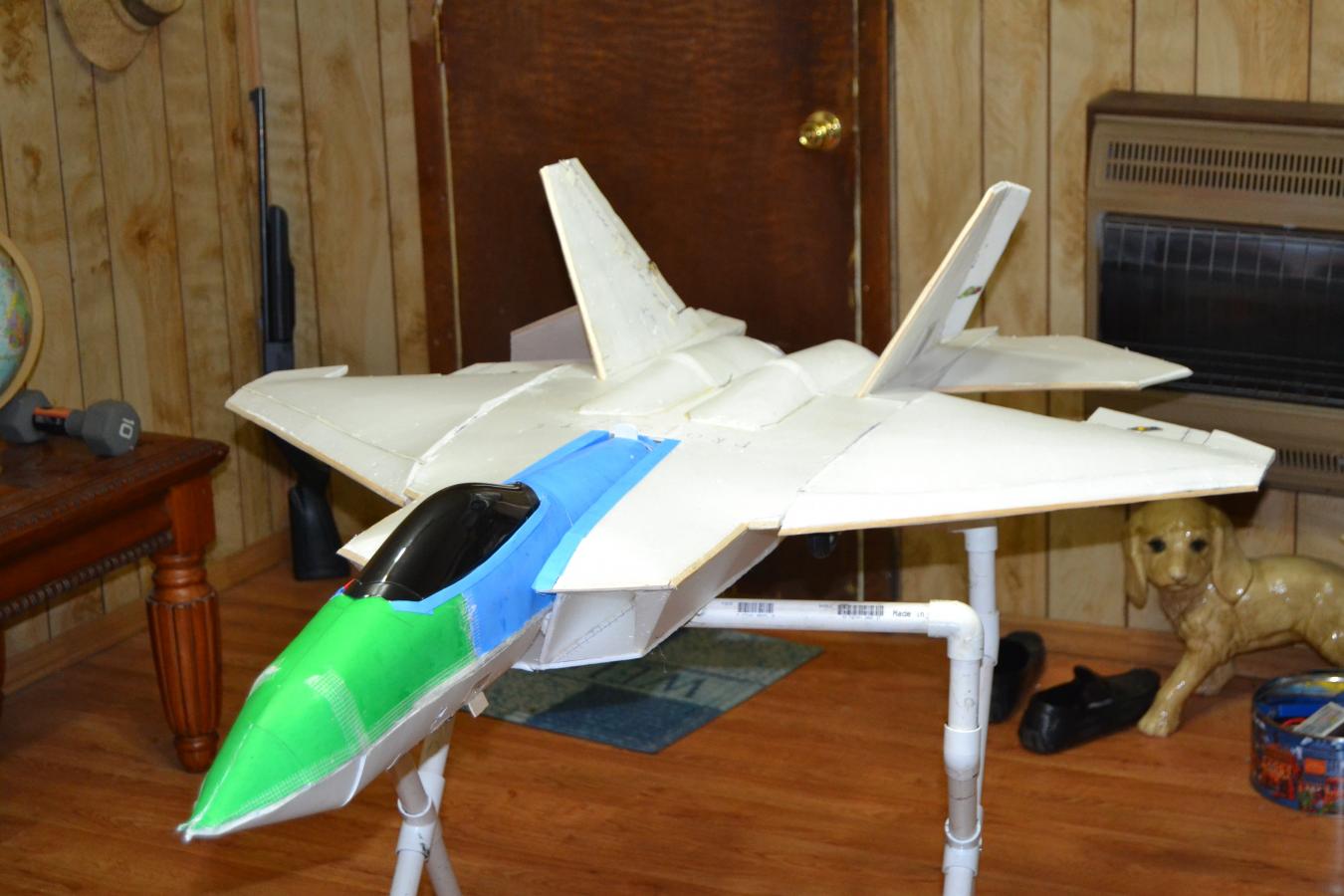

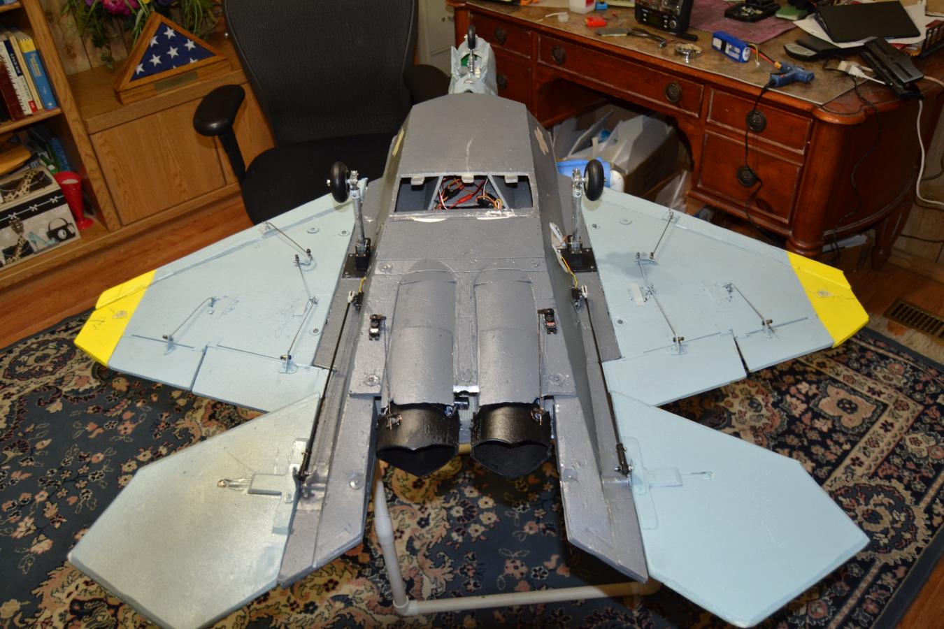

              Pictured is my latest project, an F-22, 42 inch wingspan, length 60 inches, 70mm 6S dual EDF's, and flying weight 125 ounces or 7.8 pounds. I have not done a maiden flight yet.
              If the dual 70mm EDF's are not powerful enough, I will upgrade with Freewing dual 6S 80mm EDF's. I have made patterns of all my builds and I also use the assembly technique to make repairing simpler.
              Thanks for your reply.
