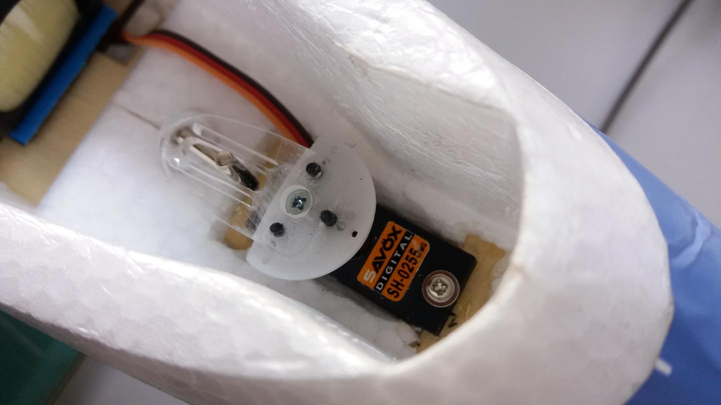

            Exactly:) Thank's anyway.. Just a side kick.Could this servo horn: https://www.tjdmodels.com/hitec-alum...o%20arm&page=3 '
            Replaced this: Click image for larger version
            Aren't the servo rods the same in diameter?
