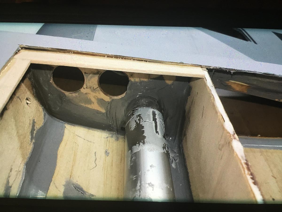

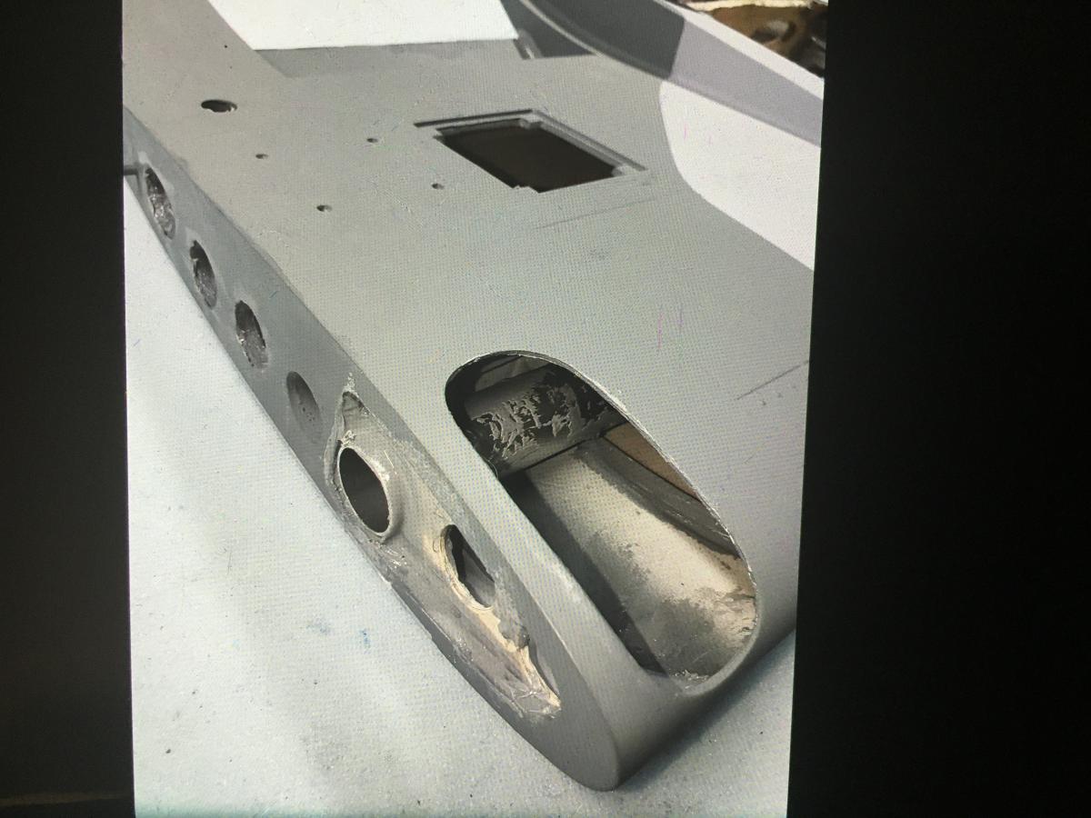

    I added an aluminum spar a some plywood formers to the center section, some structural epoxy to the ribs and formers as well as a small amount of glass cloth and resin. Click image for larger version  Name:	50F25A09-0DF1-4F71-B788-496582F6AD83.jpeg Views:	24 Size:	106.9 KB ID:	308156Click image for larger version  Name:	33BB522A-5917-4D9E-AFB0-811401CD7866.jpeg Views:	14 Size:	102.9 KB ID:	308157
    That looks like it should do the trick, the center section is without a doubt the weakest link in the airframe. I just bought my carbon rods and cloth to do my mods, soon as I get a little time off work im going to get back on mine. The jetfans are in my opinion the best choice as far as power to weight go. I'm using two of the Het 120 Zuess esc's in mine. The cost and weight were both appealing. I've tried to cut every ounce possible to make up for all the structural mods im doing. Have you checked with Matt at Jetfans USA to see if he has the fans in stock?

    The deeper I get into this airframe the more I find that makes me uncomfortable. I'm going to add another former above the mounting plate for the wing bolts and tie it into some actual structure. I just don't see a ply plate glued to thin glass being strong enough to keep the wing from pulling off. If it won't hold up to my style of flying I don't want it. I didn't want it to be a flying brick either but if it breaks in the air its not doing me any good. I'm just going to do what I have to do to be comfortable with the integrity and if it ends up being a flying brick so be it. I haven't opened up the bottom of the wing yet but I have a feeling that I'm not going to be happy with the two little pins that hold the leading edge on either so I'm already anticipating adding two bolts to the front as well. You guys that have already opened it up, how did it look to you?

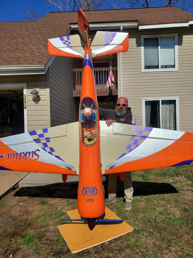

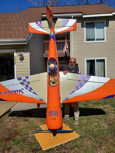

    Wow, that thing is a beast. Knew it was a large model but that pic really puts it into perspective. Hope everyone is well, not had any time to pursue my own projects. Currently in CDL school. Finally mustered up the courage to pass my ceramic tile business on to my little brother and make a career change. Scary stuff at my age, but it was time. Already have a good job waiting. Soon as I get settled in I intend to get this A 10 flying. I now have everything I need to complete it, including one set of flight packs. Although with one exception. I still havent decided if I'm going to go with a Powerbox or if I'm going to try the Smootflite 16. On another note, if I'm able to acquire it, I've found my next project. A complete, Byron Originals F 15 fuse and verticals. No wings or horizontal stabs, but otherwise untouched new in the box. Thats how current owner acquired it. Owner hasn't flown for many years but is reluctant 'understandably ' to let it go. I'll wear him down eventually. He's actually an old friend I grew up flying with that I haven't seen in 20 years. We happened to bump into each other on the dog food isle at the grocery store.

    Su-26mm done and ready for maiden Click image for larger version
