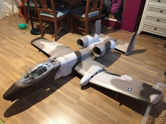

                                    Can anyone identify this A10 maker.... Same size as small Skymaster A10 but Skymaster wings different. ..... Slightly larger than Roban...wong splits in same place! Click image for larger version
