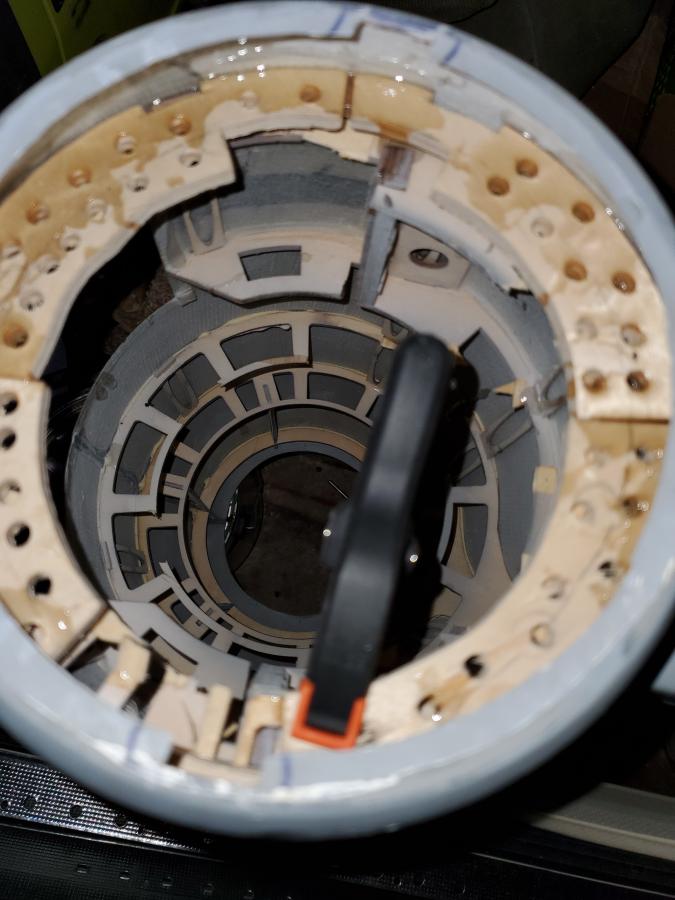

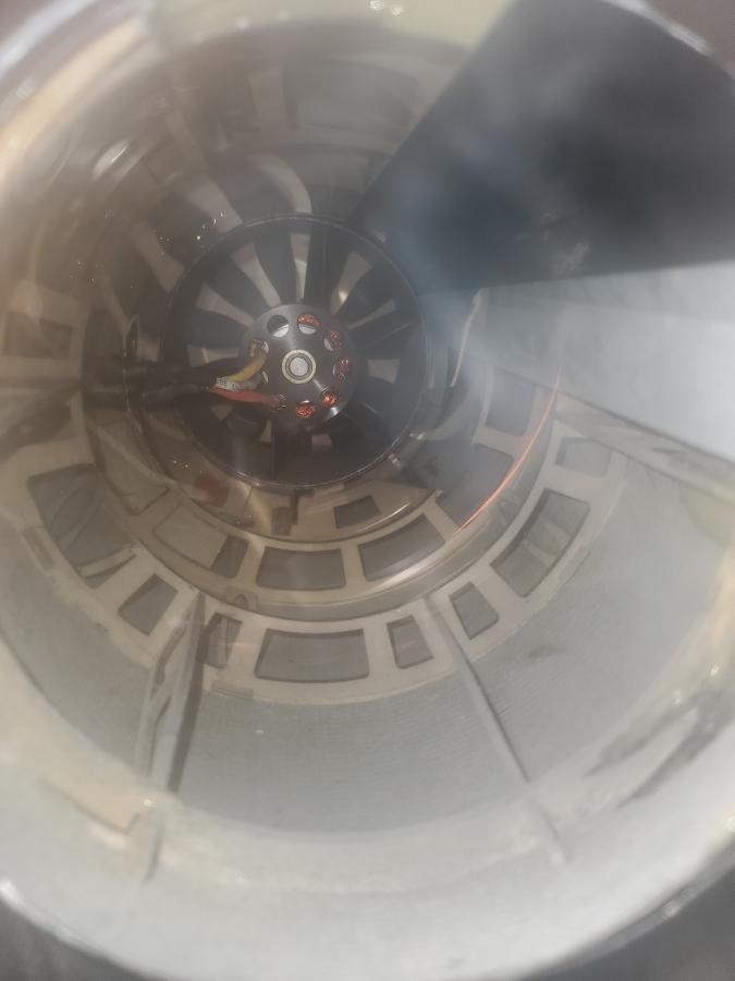

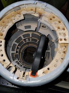

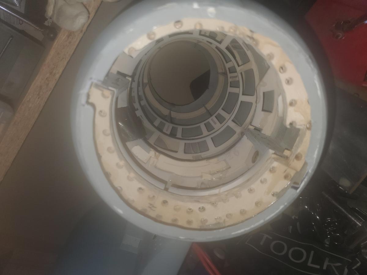

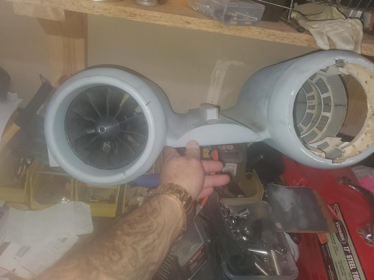

                            Jink i hear ya i just saw a skymaster yesterday for the first time in person a guy i met that live about 2 miles away from me has the 1/5 f-86 for sale for 3,000 and its unbelievable how well built it is holy crap im definitely going to purchase it ...as far as my a-10 i finished the repairs to the nacelles and got the first motor installed ..im waiting for Gary to finish the other one hes waiting for the shipment of fans so hopefully I can recieve the other motor next week if not it will be 2 more weeks before I get to maiden this bird Click image for larger version

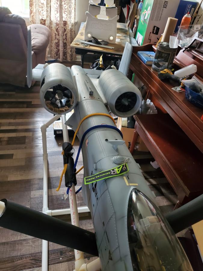

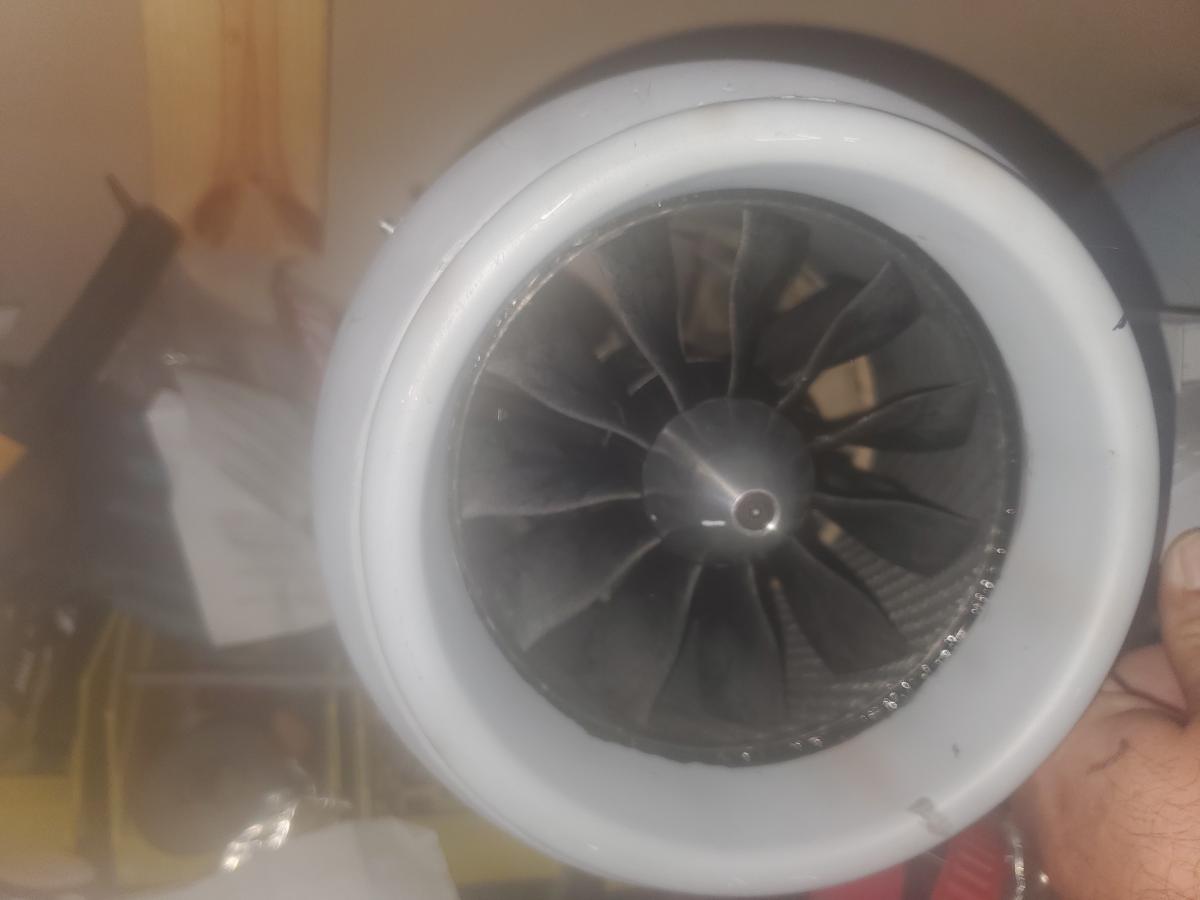

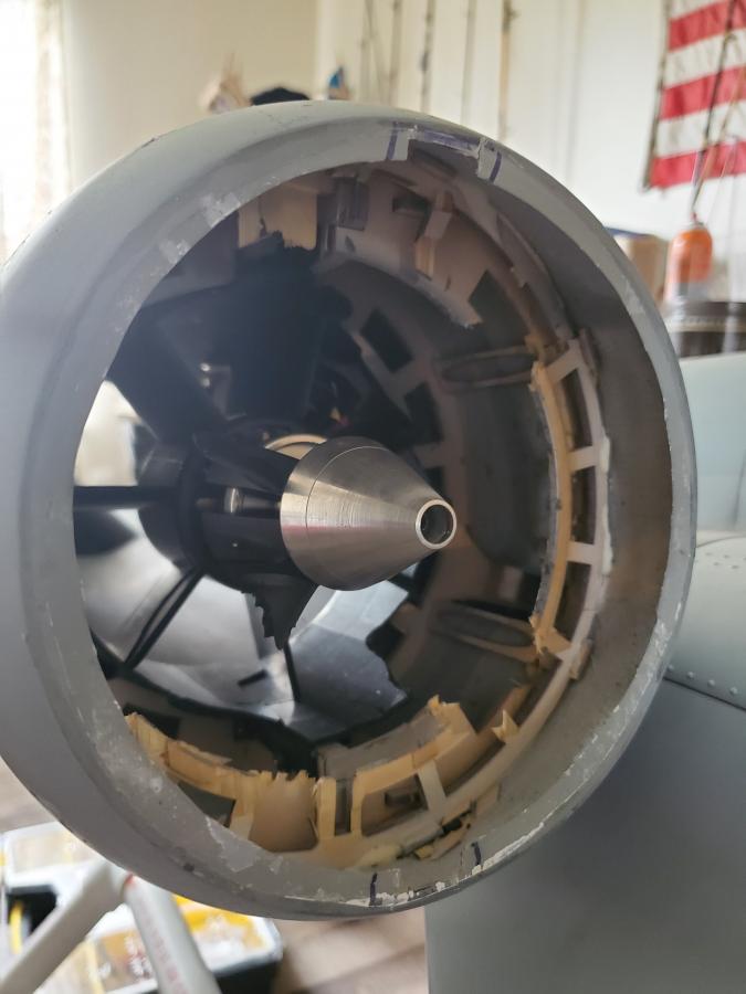

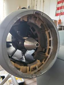

                              Here are some pics of the nacelles Click image for larger version
ID:	280699Click image for larger version
ID:	280700Click image for larger version
ID:	280701Click image for larger version
ID:	280702Click image for larger version

                                  I'm just leaving the thrust tubes clear until I maiden it ..theres no sense in putting more time if I crash it..haha.if she makes it ill make custom carbon thrust tubes and repaint the repairs to the nacelles and I will put the time to make the canopy operational w/pilot
                                  • Reeper38
                                    • 93
                                    #177
                                    Jink it is nice being able to remove the whole engine pod..it would be a pain in the but if I had glassed em on ..if u reinforce the structure under the pods in the fuse there will be no problem...also put bigger stainless washers on everything especially the wing connect point the little washers that come with it are junk ...I dremmeled the holes bigger and put big washers to cover more area .for the wings .
