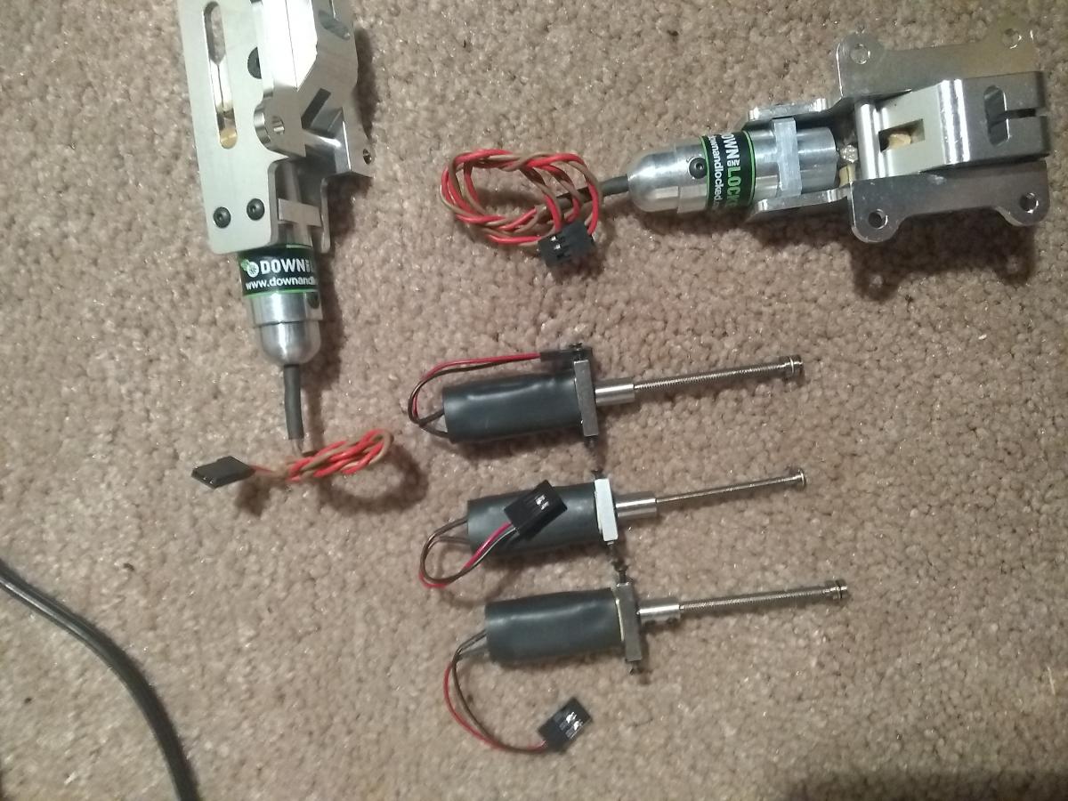

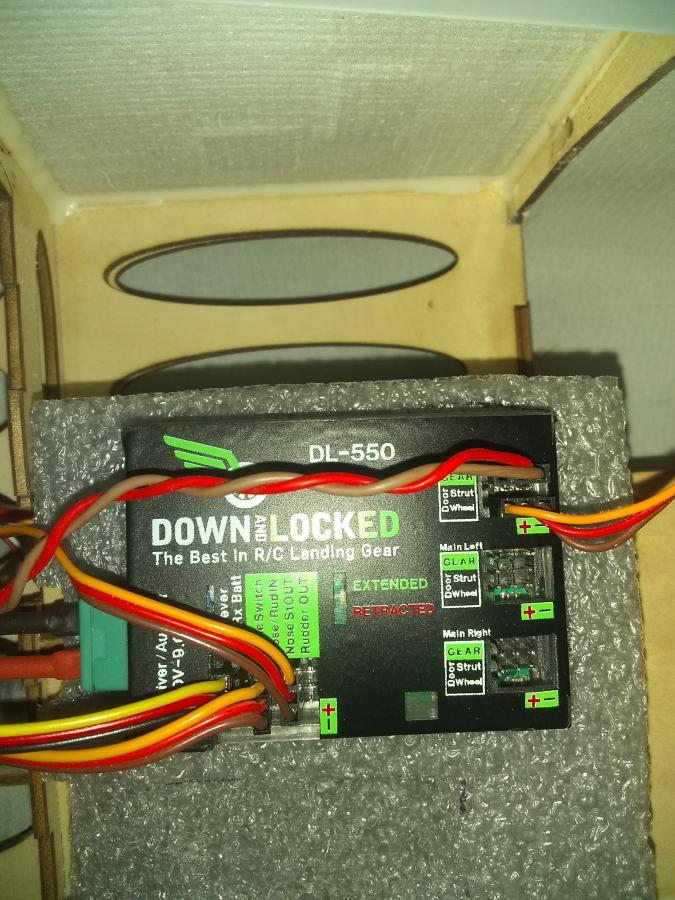

                    Sisaksen, my gear was rebuilt with bigger, stronger motors and a nice controller with door sequencers by Mitch at Down & Locked. He also machines all new parts for it including the trunnion. Only thing original is the frames. It cost $650 with the sequencer &500 without. Worth every penny. These are top quality retracts now and bullit proof too in my opinion. This much money in a plane, I want the wheels to come down every time I flip the switch. They are running on a standard 2s life battery at 6.6v. If you watch some of the YouTube vids of these things flying, in several of the vids they are flying around with the gear only partially retracted because the motors on the factory gear are not strong enough to raise the gear with the added wind resistance during flight. I saw you ask about an Electron replacement in the other thread. It's not much cheaper than the upgrade and it's quite a bit of work to fit them. With the upgrade they just bolt right back in

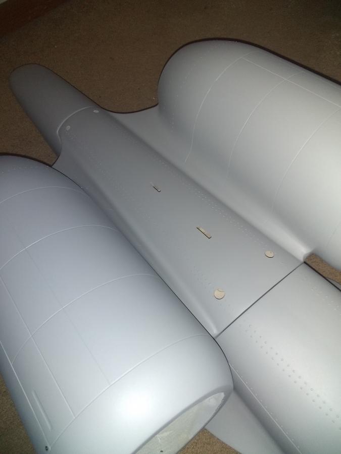

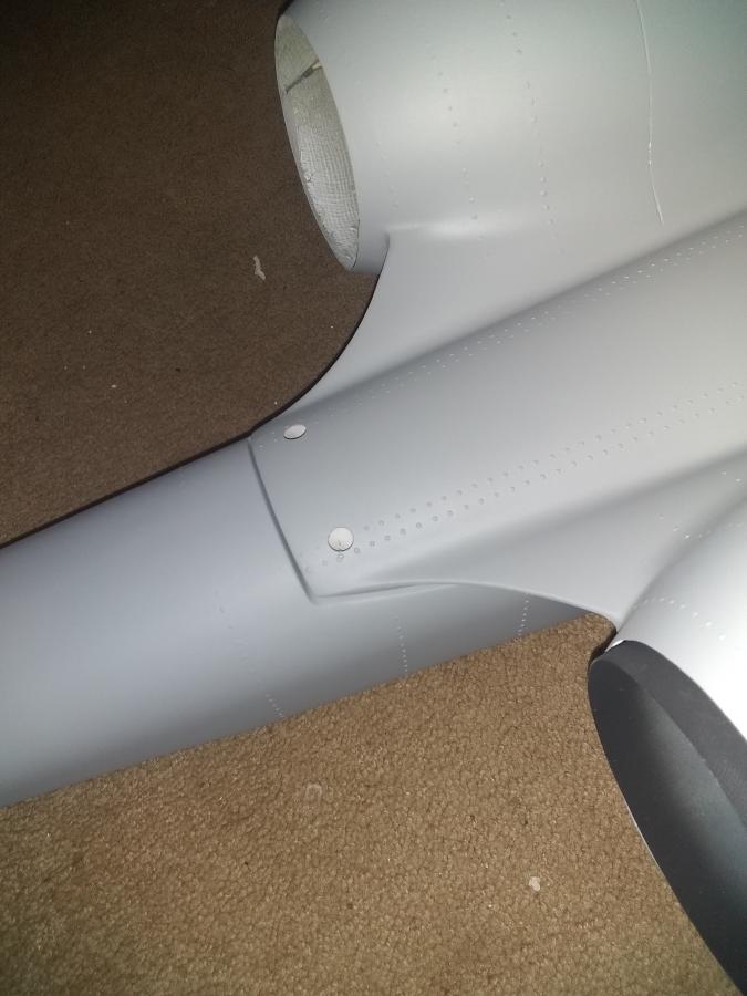

                        I'm strongly considering hysoling the nacelles to the fuselage. The reason being is I am really leaning towards getting rid of those giant screw access holes in the top of the the thing and filling and blending where it's mates up to the fuse. To me it's got a giant foamie look to it, just screwed together. It wouldn't be difficult and it won't add enough weight to be of any concern. It won't kill me on time either.
                        Do y'all think it will improve the looks enough to be worth it. And remember I like doing this kinda thing do it's not a chore or anything? And with my snow cammo scheme going on most of the work will be covered, the little that isn't can be easily blended back in. I already had the matching paint and my two Grey's for the job mixed and ready to go

                          That is really slow, doesn't mean you couldn't get by with it. The question is do you trust they are going to extend every time. This isnt a plane you want to belly land. l am concerned you may have trouble getting them up with wind resistance added. Especially with the gear doors. That make the drag even worse. But if u trust the system give it a go, see what happens. Personally I'd be looking into that upgrade
                          Pics of new motors and old motors together, and the new controller is very nice.
                            I will propably do the same thing to mine after i've flown a few times and dialled her in. Would perhaps recommend a spackle type filler in the screw holes.
                            Hysol would be nearly impossible to remove if you would have to dismantle the nacelles at a later point. How about making plugs that fits snugly on the surface?
                              For me there would be no need to dismantle them, and by gluing them you can remove alot of the material on the bottom which is there for strength. So it would about negate itself on the weight deal plus it would be easier fishing wires in and out of the nacelles. I'll glass the screw holes from the inside and use a little filler on the outside, iv got a couple different ideas for filling in around the fuse but I haven't decided which way I'd do it yet. I think it will make a huge difference in the finished look
                                Do y'all think it will improve the looks enough to be worth it......
                                Hi JR-
                                I think it depends on the likelihood of you needing to get in there for any maintenance and/or storage or transport. If everything is accessible (fans, wiring, etc.) and your storage or transport needs don't require them to be removed, then I agree it's definitely an upgrade in terms of looks. Alternately, maybe a solution like the pics below will do both. The CGRC has the luxury of a hatch just forward of the nacelles so you can get at the screws but it doesn't look impossible on the Roban if the fuse is empty during construction - especially since the forward fuse separates. Just thinking out loud.

                                  Yep, especially if you don't mind doing it and feel you wouldn't need to dismantle, I would go for it. The more you can do for scale I am always for.

                                    Originally posted by gravity tester
                                    Hi JR-
                                    Glad you got the gear worked out.
                                    Access wouldn't be a problem because the wing separates from the fuse, I'd have that as an access be point for wiring and such. Plus the big hatch on the front. Eveything would be fairly easy to access. I'm going to go for it, jus needed a little nudge in that direction. I followed your build thread on the cgrc a 10. I would have loved to get my hands on the Gen 2 version like yours. I talked to Chris but he jus wasn't into it. That kit has some incredible scale details. I remember you saying you came in at around 34lbs. That's a heavy bird but I've heard they fly well at that weight. How many flights do you have on her now
