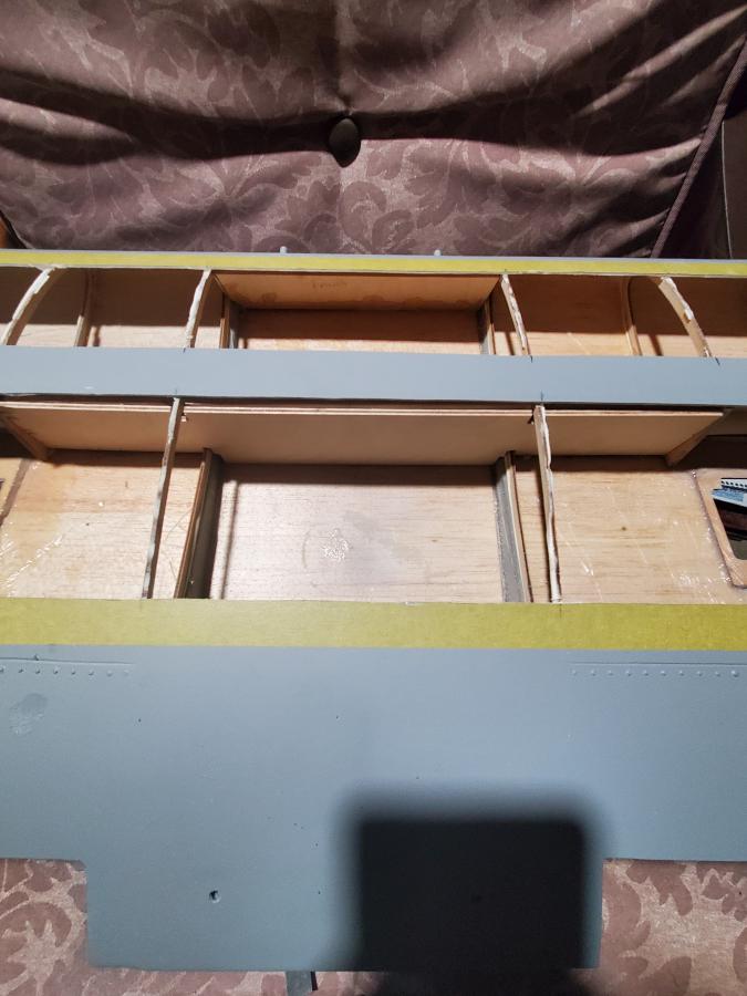

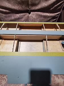

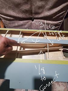

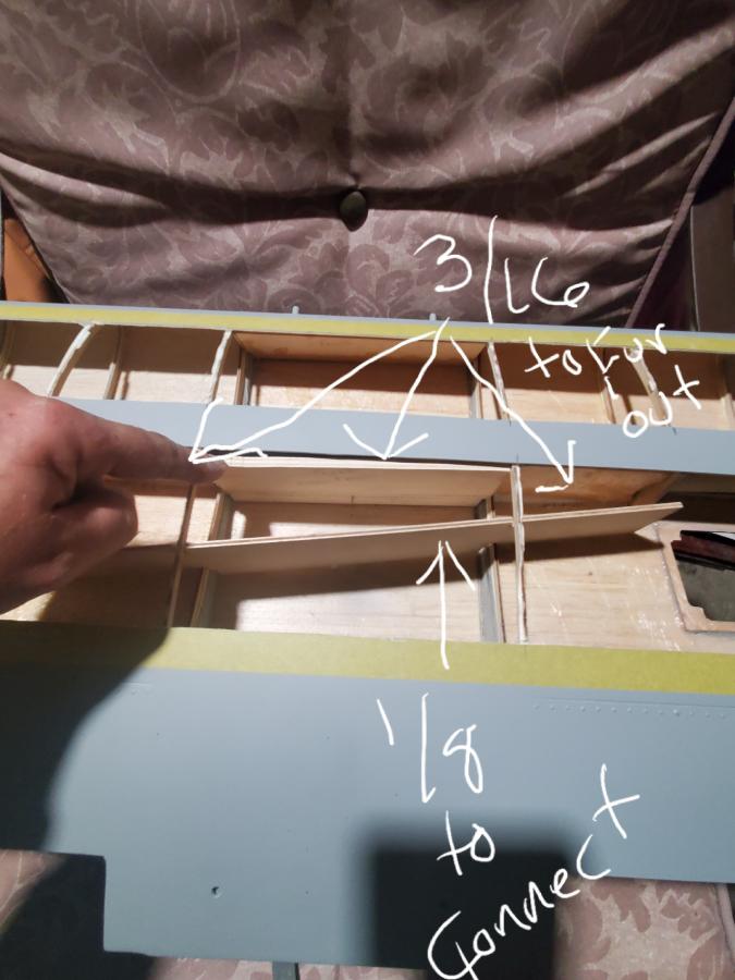

              The area between the spar sleeves is where it breaks
              firing out with 3/16 and then 1/8th to connect all ..then adding a carbon 20mm spar all the way across into wings..and adding 2 ribs also beefing up gear mounts Click image for larger version

                  I just added carbon instead of the aluminum tubes and fused the wings together yeah just call me later
                  • Reeper38
                    • 93
                    #209
                    And no I didn't do the center of the first one I didn't know that was where it was breaking I thought it was where the wings join..

                                    Yeah I was being really gentle on my turns and rubbering it around and leveled out and boom ...once i saw what the inside of the center section looked like i knew what was wrong..the shear webbing isn't even close to strong enough for 30lbs ...I spoke with the roban man at motion and he said do a layer of glass on the leading and trailing edges also...and jinx its a matter of time before theres blows apart too if they dont fix it now
