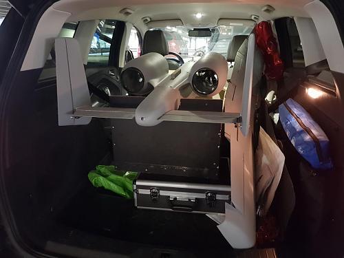

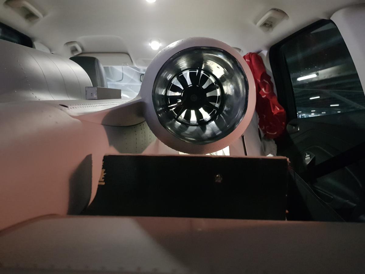

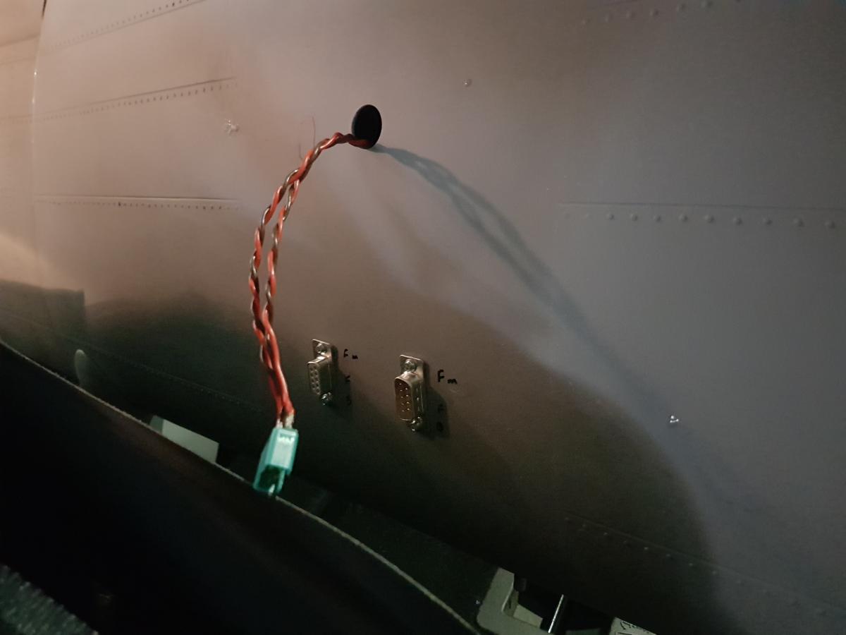

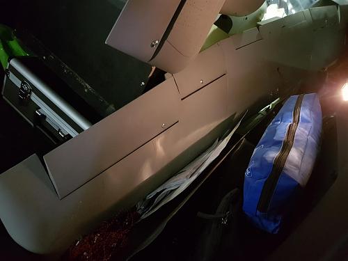

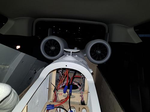

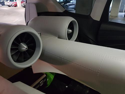

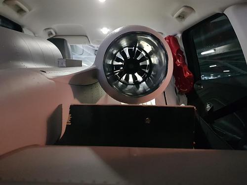

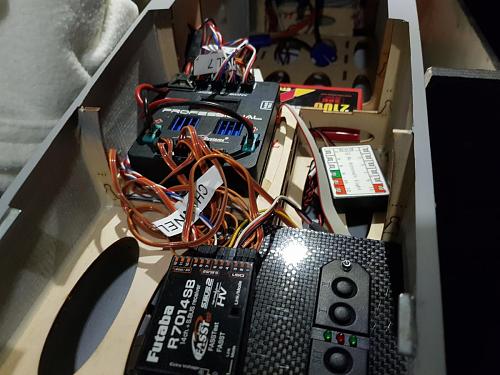

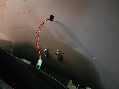

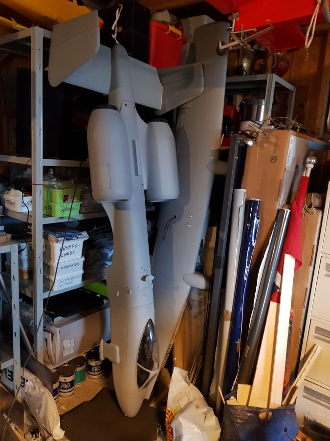

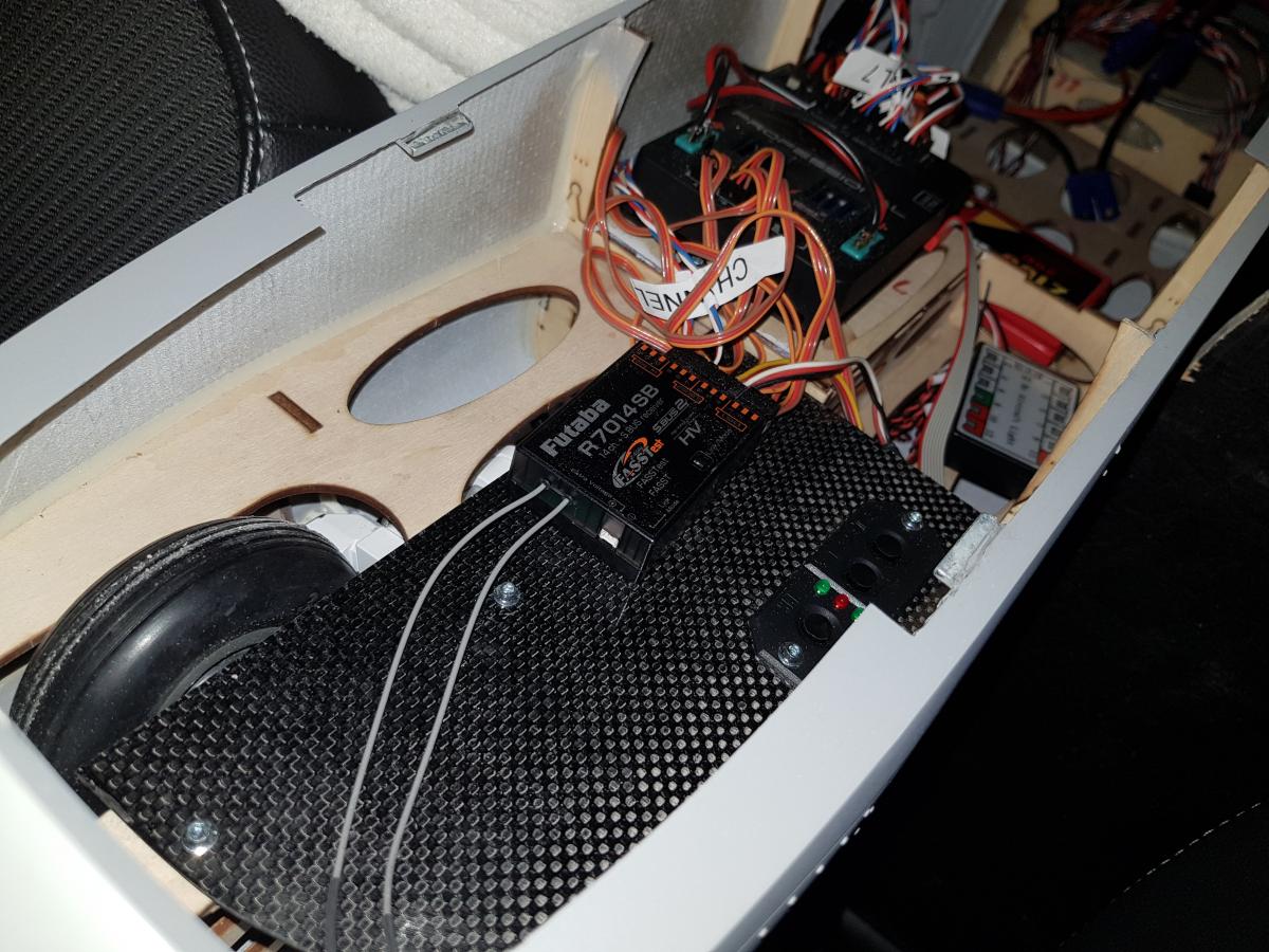

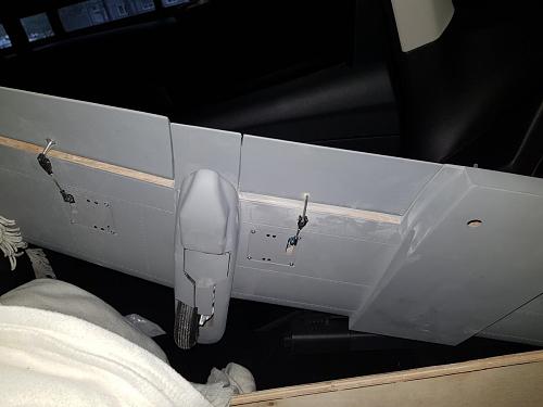

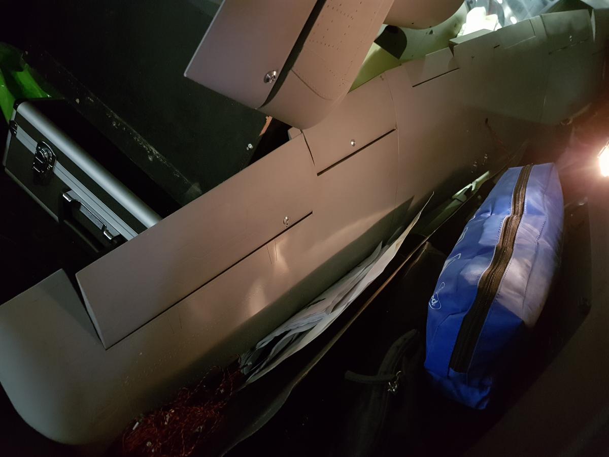

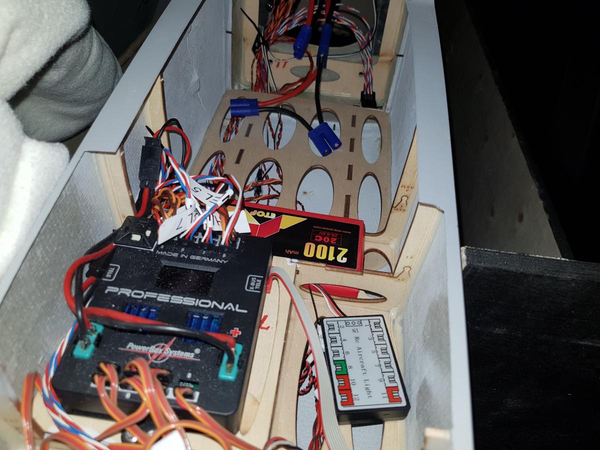

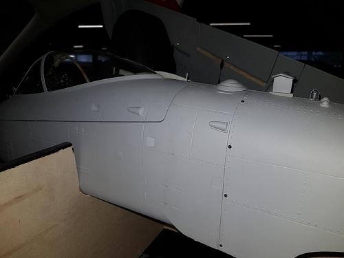

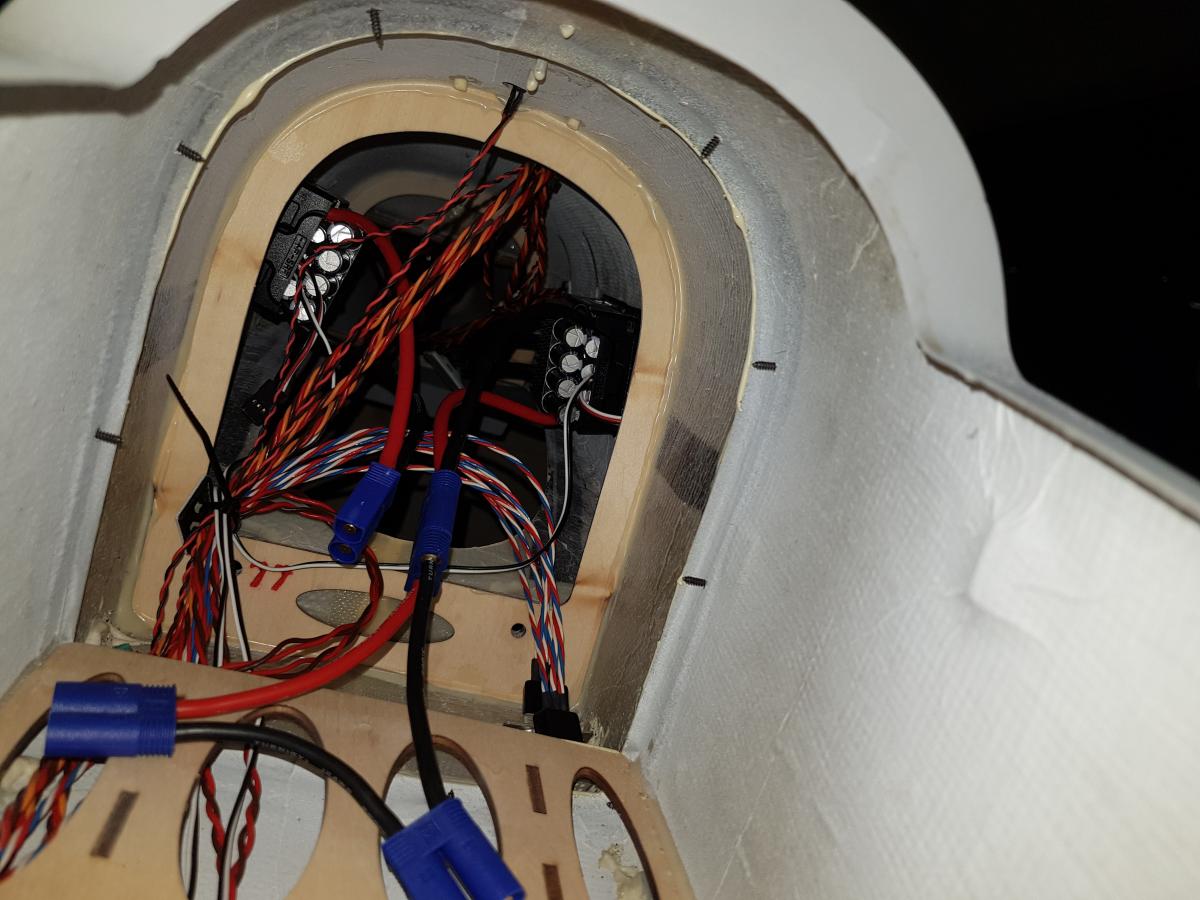

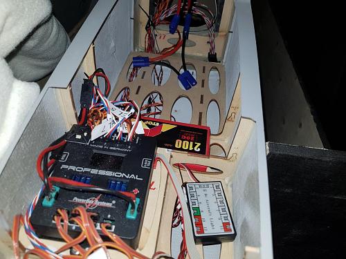

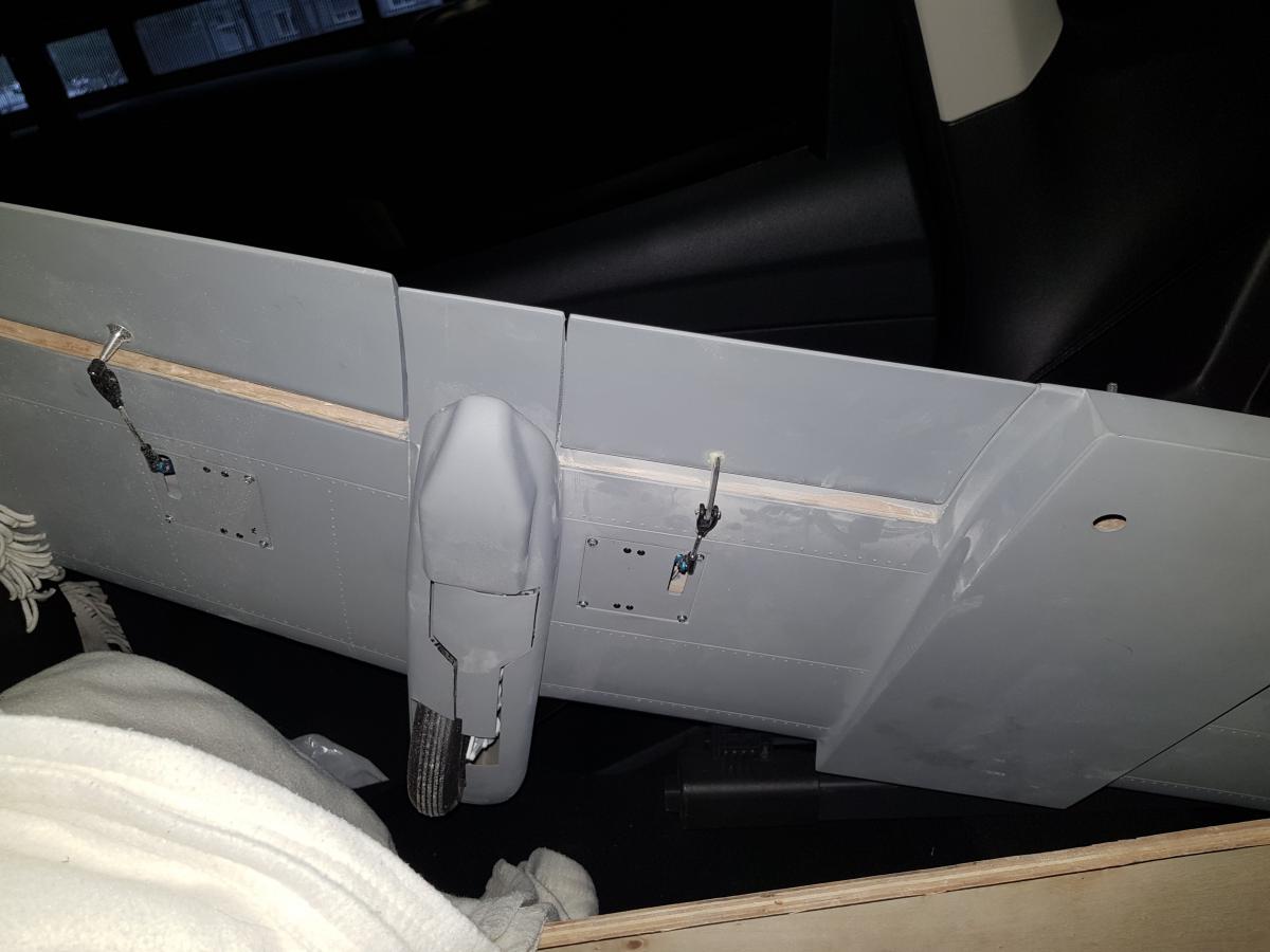

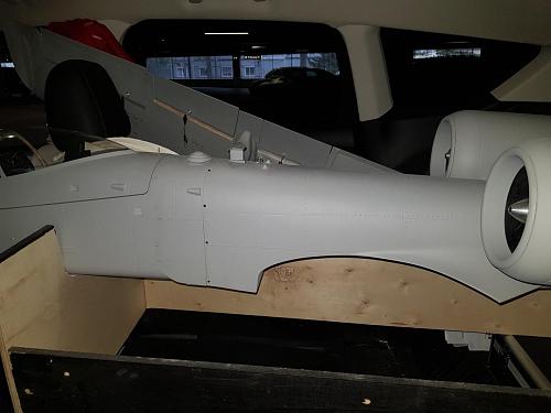

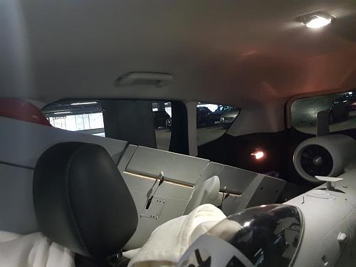

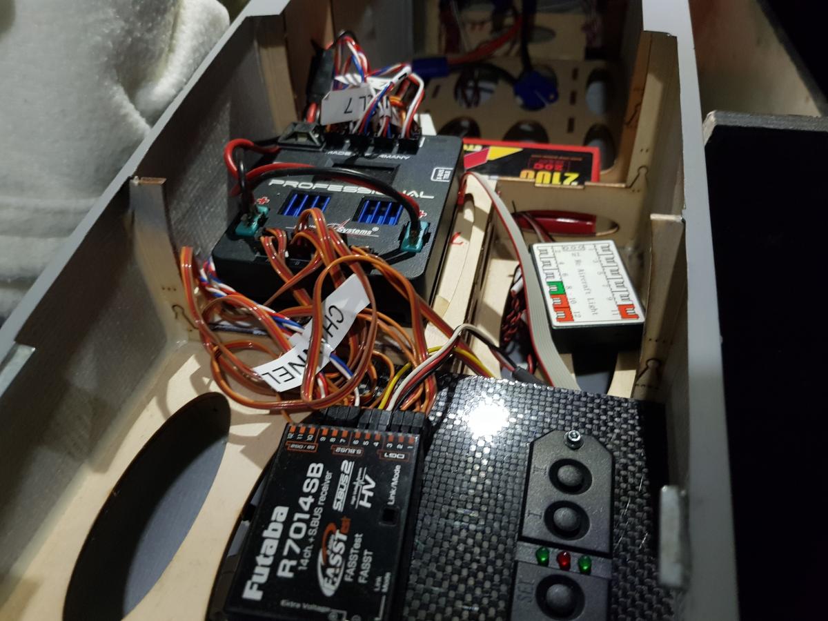

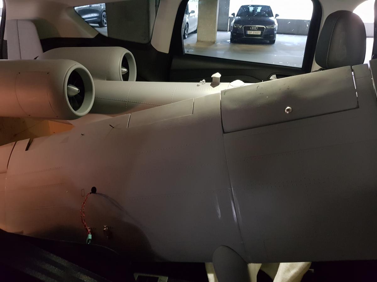

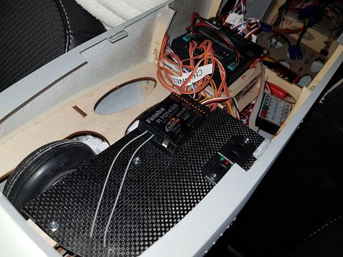

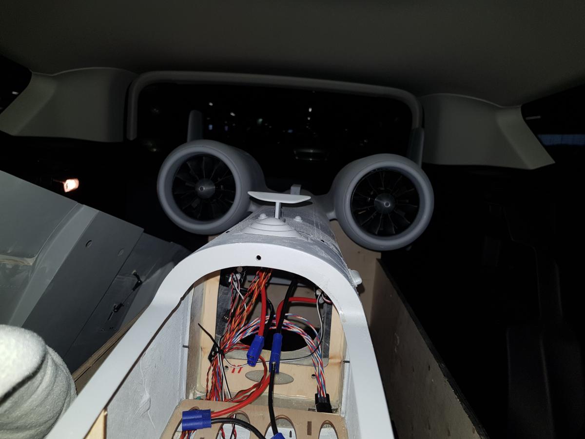

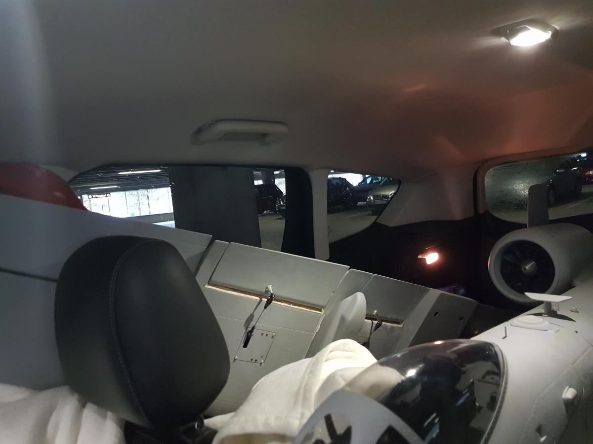

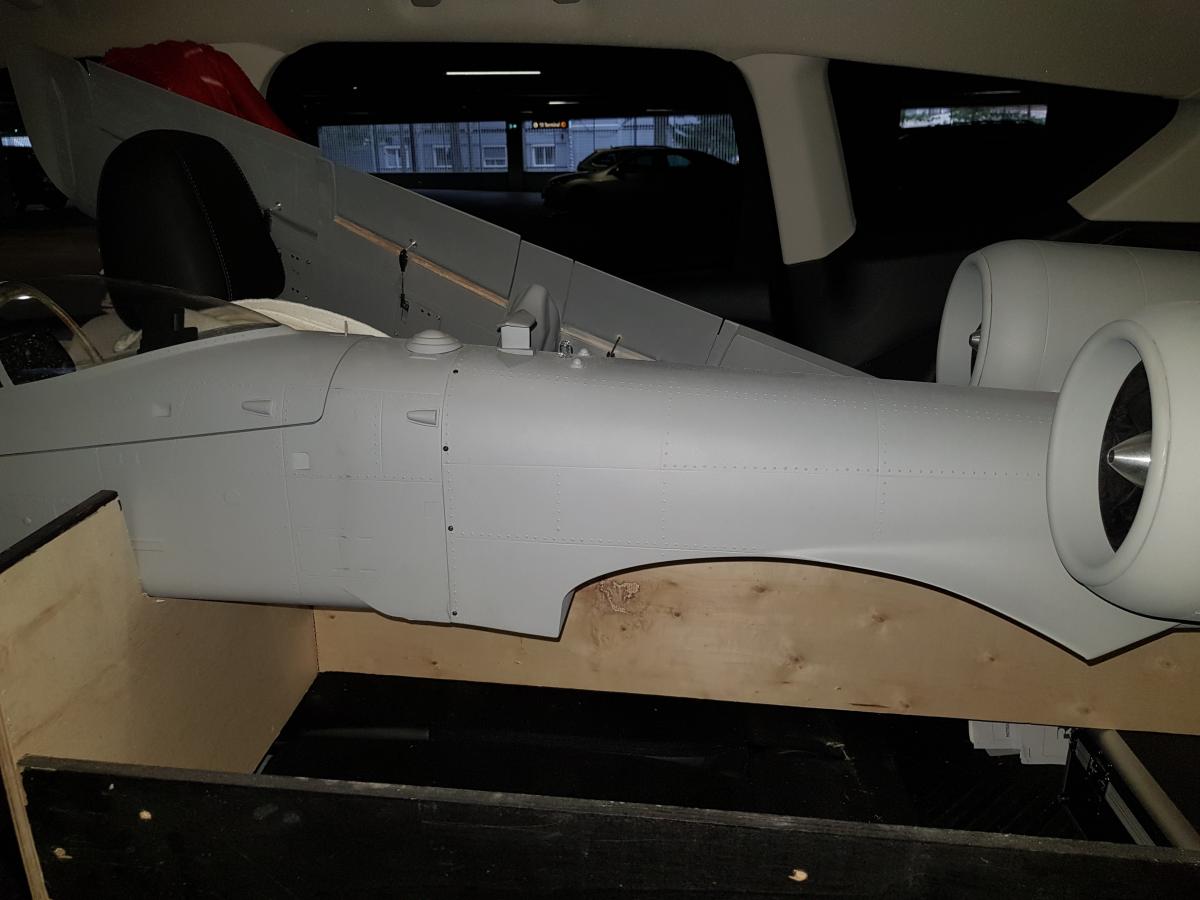

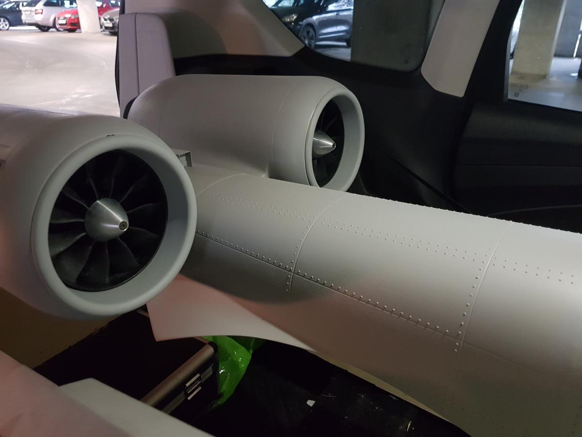

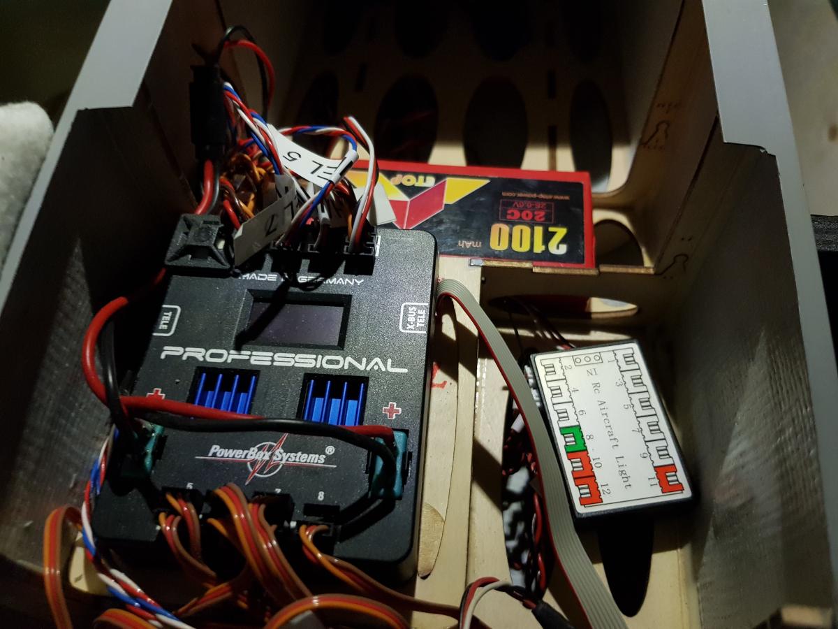

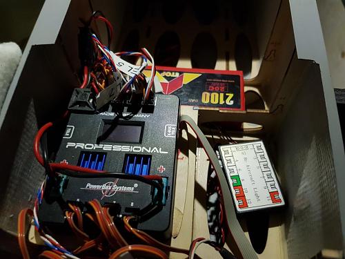

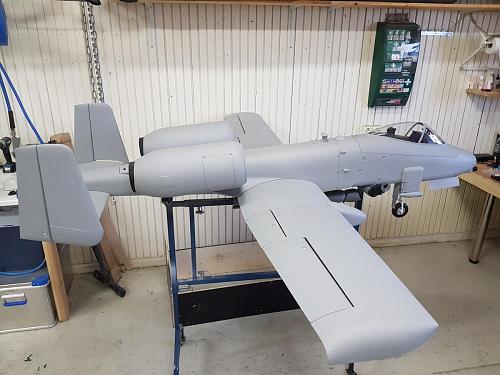

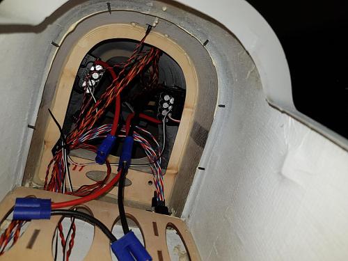

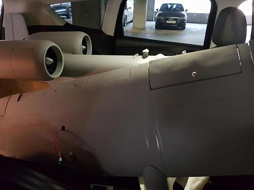

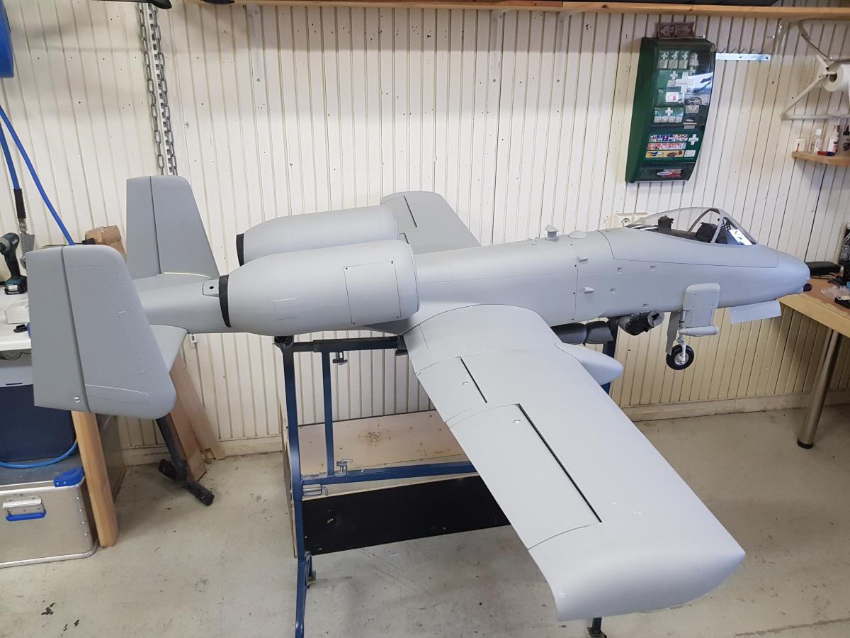

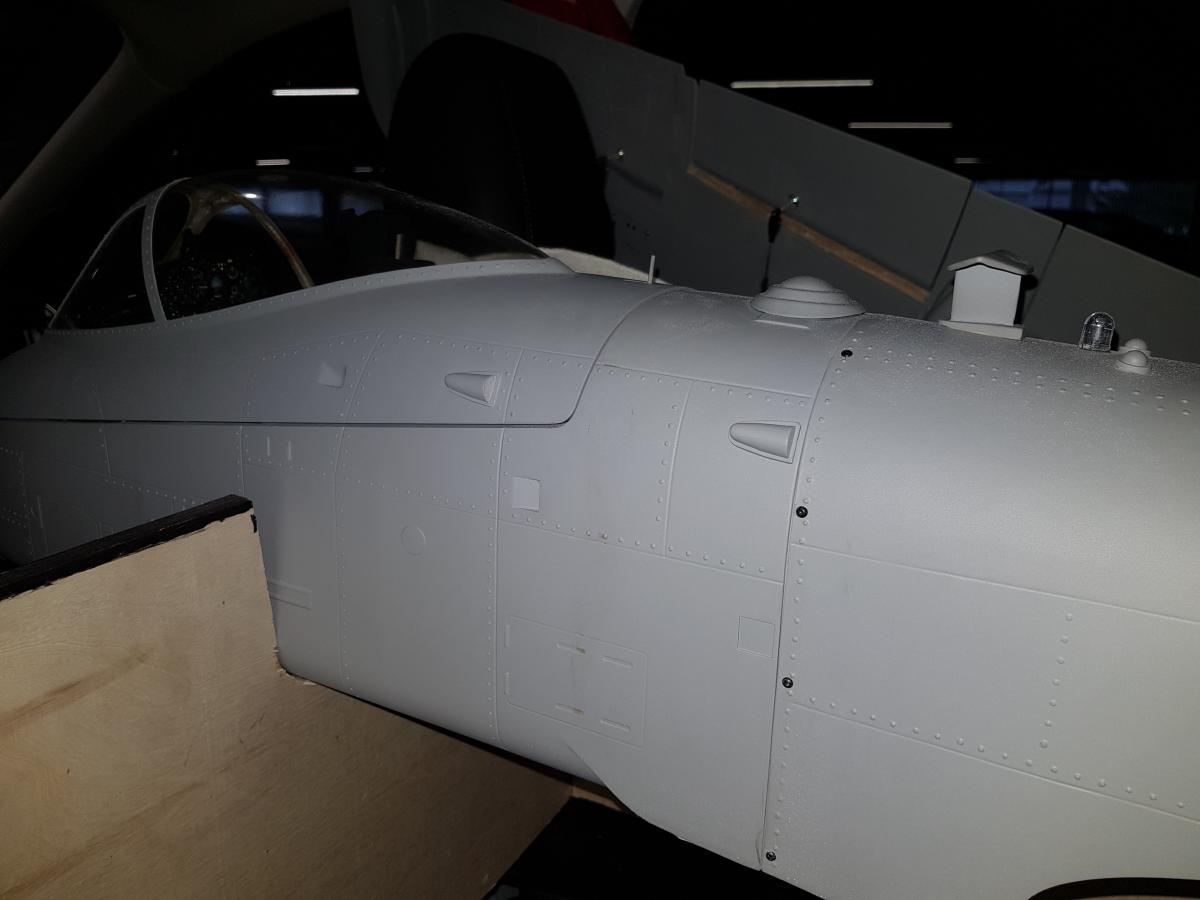

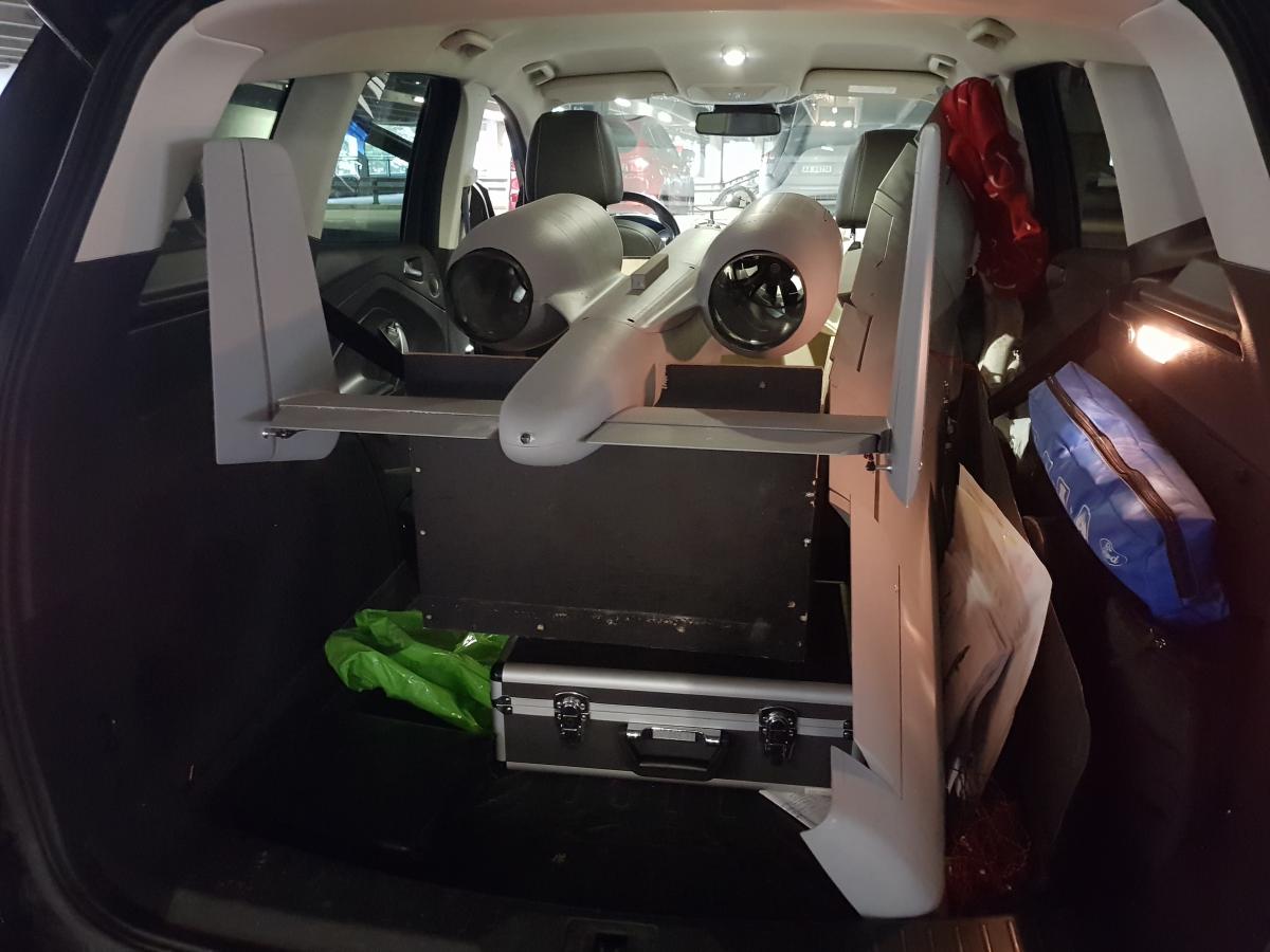

ID:	248192 Hi guys!
                                        I bought it fully built but unflown. Picked it up a week ago.
                                        It's built "by the book" as per the manual without any modification.
                                        The wing is glued together in one piece with Hysol.
                                        My plan is to try to split up the wing again.
                                        I fear i just might destroy the wing in the process.
                                        I feel the wing is built too weak and i want to beef it up with a carbon tube spanning from aileron to aileron.
                                        I also want a three piece wing because then i can transport it standing on the wheels.
                                        The details on this kit is superb.
                                        The only bad thing about this beauty is the center wing section which is too weak for yank and bank flying. Easily fixed by a 20mm carbon tube.
                                        The plan is to use 20mm carbon tube as outer tubing as it fits perfectly in the hole in the center section behind the original wing tube. In the outer sections of the wing ribs with 20mm holes will have to be made.
                                        Then a 18mm carbon tube will be acting as wing tube spanning from aileron to aileron.
                                        After this upgrade i won't be concerned overstressing the wing.
                                        Here is a few pictures from when i picked it up.
                                        • #60
                                          Sisaksen, that's exactly what I've done is add a 20mm carbon tube right through the center section. It's easy to glue it to the two outer ribs on each side. I also plan to fill the center part of the wing to about 6 inches on either side of the wing saddle area and the entire leading edge cavity with a ridgid expanding foam after all my wiring is in place and tested. I believe that should add a good bit of strength.
                                          As far as your one piece wing, if he hysoled the wing tubes into the sockets on both sides I don't see you being able to get them apart without destroying them. Anyhow she's a nice looking bird. And it looks like good electronics were used in the build, that is an upgraded retract controller I thought I saw. It's definitely not like the factory one I received with my kit. For what it's worth I spoke directly with the roban factory and they we're willing to sell me a new wing center section, I was considering buying one and opening it up and try to rebuild it but I decided against it. I'm sure you could get a wing from them if you wanted to start with a new one. In fact i believe there was someone on the rc groups thread that had a bunch of extra parts they were trying to sell. It's a long thread and would probably take forever to find the post. Whatever you decide to do I wish you the best of luck, we need some more good success storys about this model.
                                          And BTW, what fan and motor combo are you using
                                          Thanks
