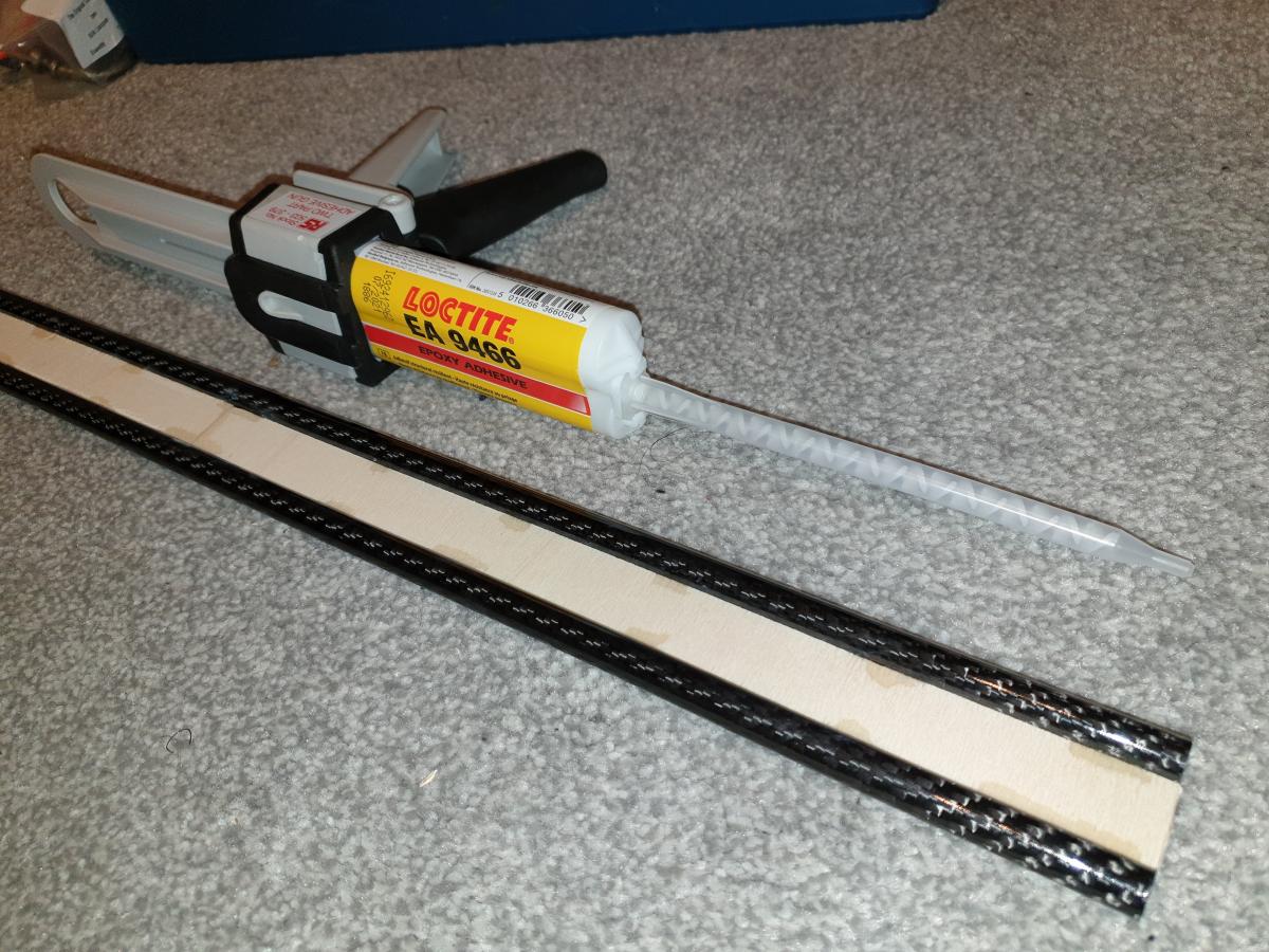

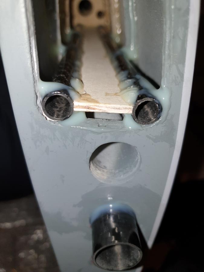

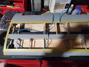

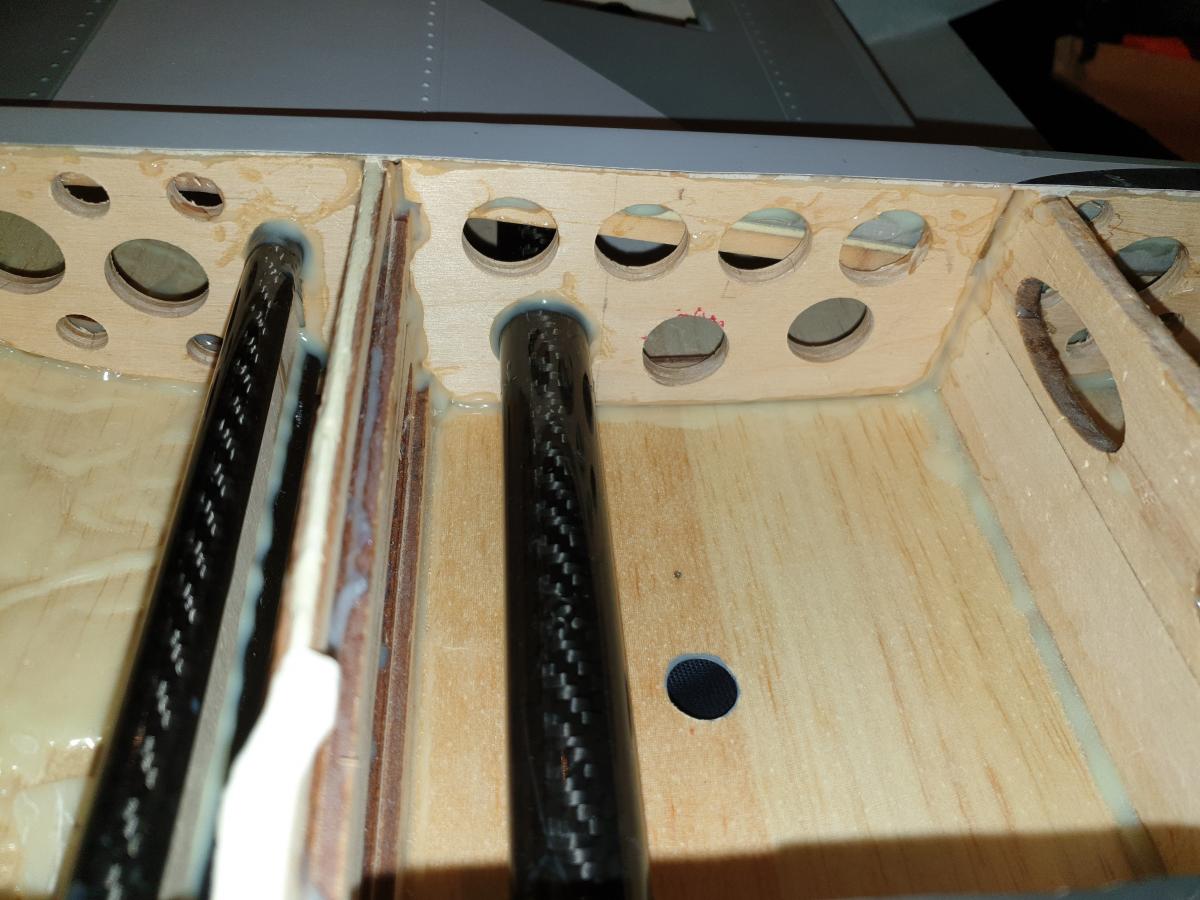

        I'm strengthening the centre without cutting open the whole wing section, there are a lot of pieces of internal woodwork not glued to the wing skin, and the glue is not the best anyway!
        By using epoxy glue gun with 150mm nozzle I've been able to reach almost every part inside to add proper glue via the middle section I cut out, and the other holes, already I can tell it's much stronger.
        Also made a spar with two 10mm carbon tubes and 1/8 ply to go into the front D section as well as a 20mm od tube through the middle.
        the trailing edge where the flaps are can also be strenghened from outside with epoxy resin and fibreglass cloth.

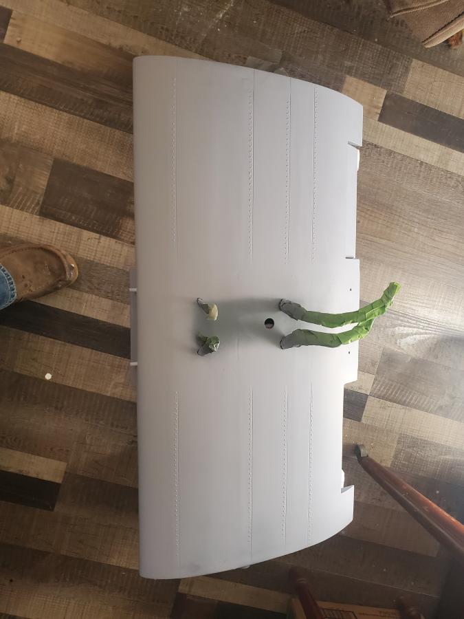

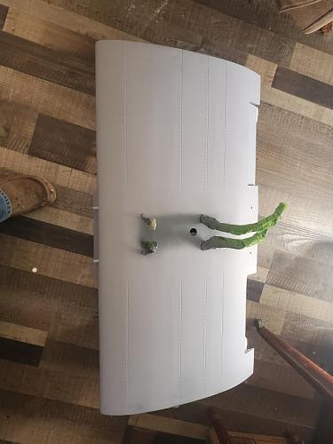

            It used to be the daddy til mibo came out with the grande 1/4 scale 40k afr ...one day she'll be mine haha .here is the progress of the wing canter section spar and retract structure repairs Click image for larger version

                My additions to the centre section have added 400g, weight before starting was 687g ........ may have used too much glue on all internal parts, It is considerably stronger now though!!!

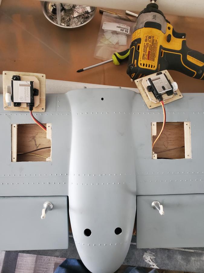

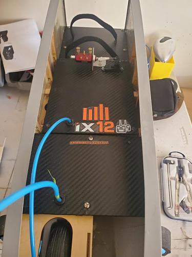

                            Skytrak i can attest to hrbs they are great and I use them in everything also amazon has 6s 5000s for a pair at $130 ...u get 2 for the price of 1 I have 4 sets for the roban so its only 260 for 4 needed per flight ...also your mods will definitely hold up whats the center section weight...id like to compare..I only added 1 18mm all the way through and just got it sealed up and painted back with air lines and servo wires in Click image for larger version

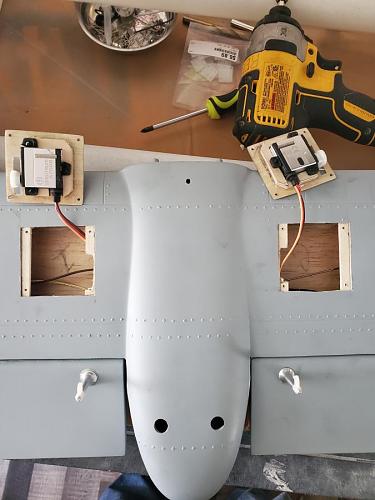

                              Thanks for the info guys, I was leaning towards the HRB's, I've never used them but I read the reviews and most are good. Thanks r the weights skytrak you answered a question I was gonna ask next if anyone had some. Im re-thinking my elevator servo setup. I'm thinking about buying two more servos to drive each elevator half. I stress tested the stock setup with two pair of channel locks and it seems fine but im starting to worry about it failing over time, Reaper, when you get a chance can you post a pic of how you set yours up, i remember you saying you separated the two halves on separate servos. Thanks again guys

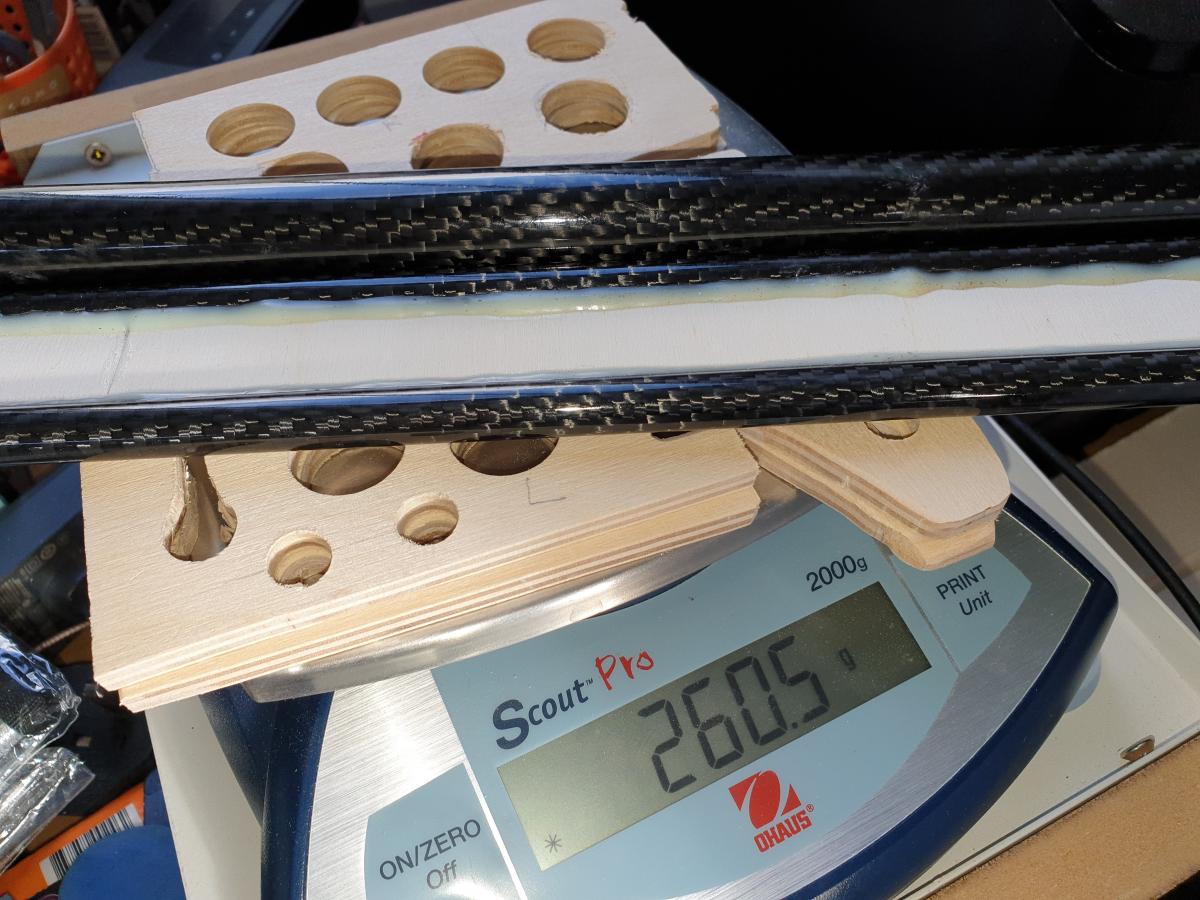

                                My centre section now weighs 1087g additional parts were 260g and 3× 50g tubes of epoxy, One tube was wasted really as I used it with a long stick before I cut the centre open, most of that didnt go where i wanted it to.
                                So I've added about 400g, could have done similar at 300g if I'd lightened the ply some more and used less glue!

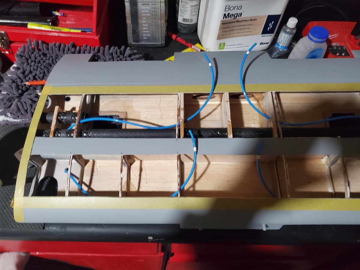

                                      As far as the unskinning it was too easy to peel off the ribs...just be careful..and that's the only reason I went through the top was to beef up the gear mounts ...if it took a hard landing the would push through easy or I would have done it like skytrak..just measure 3/4" off the panel lines and cut them things...just dont cut thru the ribs....its real easy to get the skin off...go back to my pic and look over the gear...I used the cut offs from the 20mm carbon tube too put those short tubes thru with another former down the middle off the gear mount in-between the blind nuts...it my look a lil off center but my blind nuts moved cuz im young the air gear from robart

                                          And no the foam isn't needed ..this thing isn't going anywhere...haha u can definitely feel the difference and im pretty sure skytrak can attest the foam will be unnecessary weight i i promise ya you don't need it..im cutting the wing tips next and gunna glass and reinforce those also...im not taking a chance... Click image for larger version
