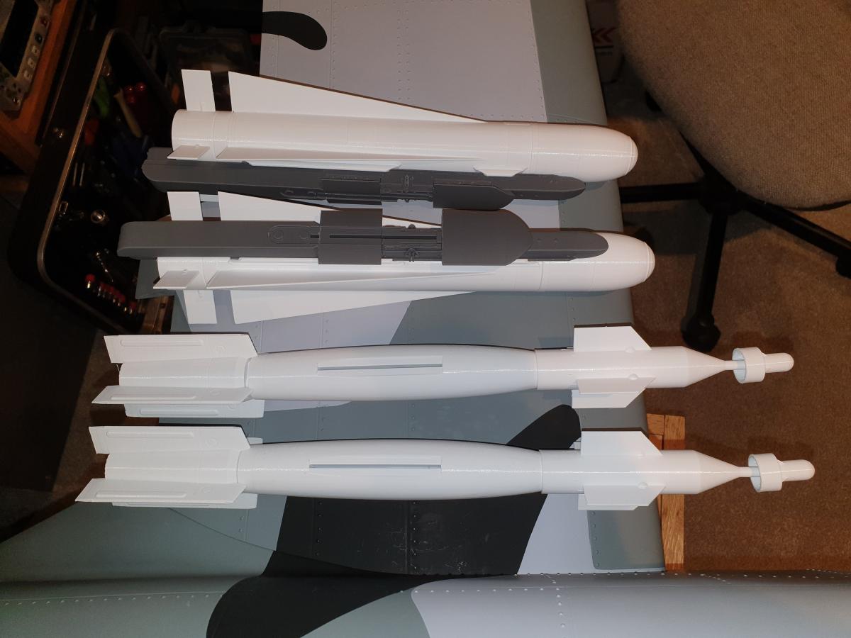

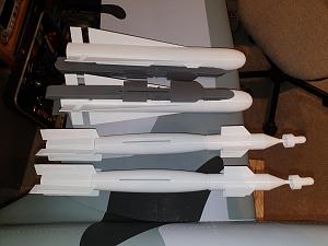

                            • 3D printed missiles...... found on Thingiverse.com 1:10 scale
                              Re-sized in the 3D printer software (easy) to 130% about 1:8 scale. 3D printer best toy I've bought since the A10 🙄🤣

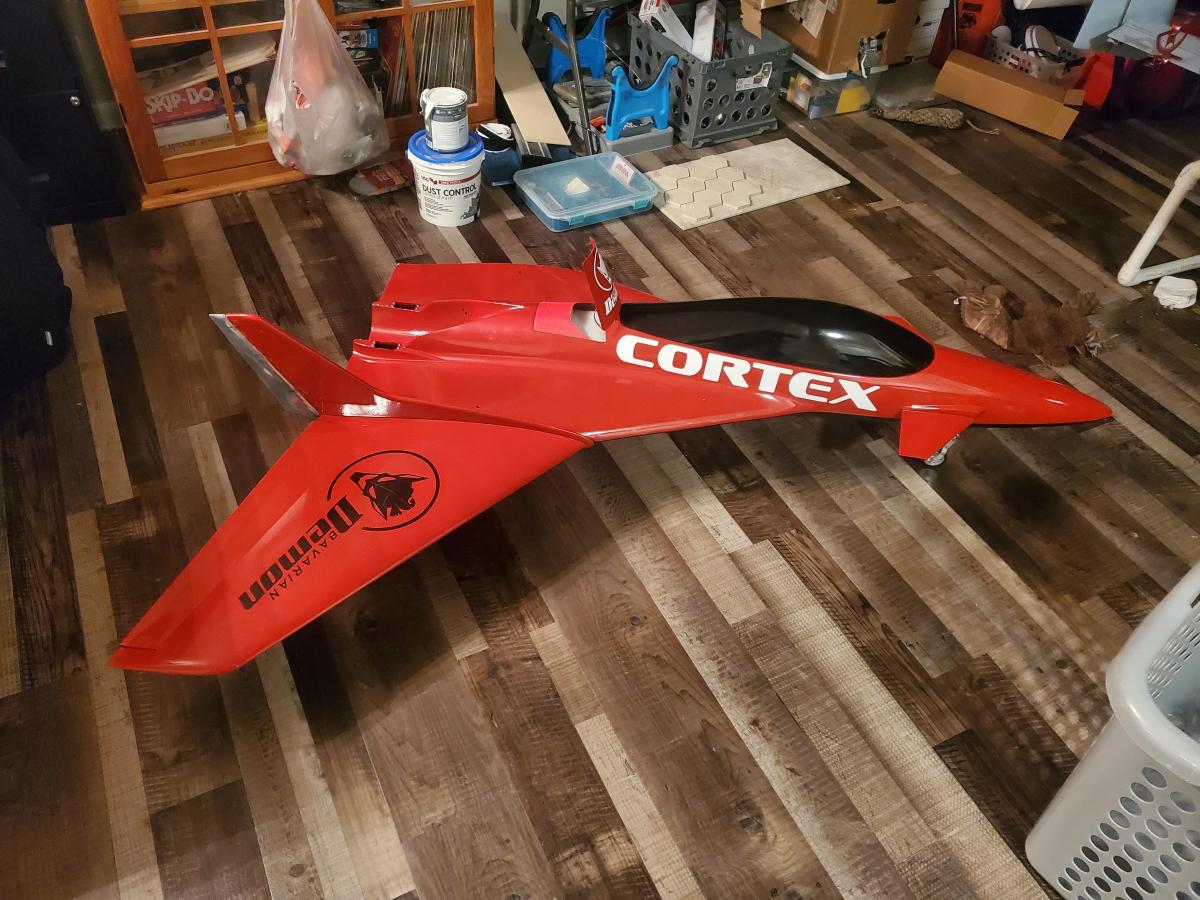

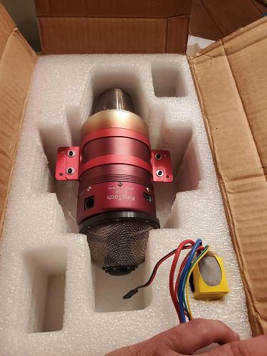

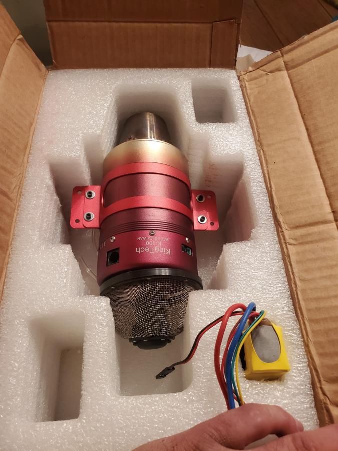

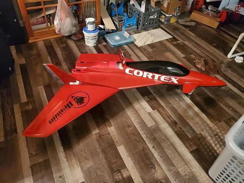

                                • Hey sky almost done all wiring except motors this week I'm sending Gary my het's to get the new fans installed and the jp mains and brakes are at the machine shop and he said 2 weeks to get to it and complete...after that she's ready.i bought my first 2 turbines and have been working on those to get ready to get my waiver on February 19th -21st...I purchased a brand new swiwin v2 3d hotdog and a k100g2 to go in it ... and a new boomarang elan with a jetcat p120 so im hustling to get em done before the 19th...also a huge 122"hangar 9 su-26 imac beast with a dle-170cc its a very nice plane ....has 3 servos per aileron...ridiculous haha Click image for larger version

                                  • That thing doesn't look fast at all.

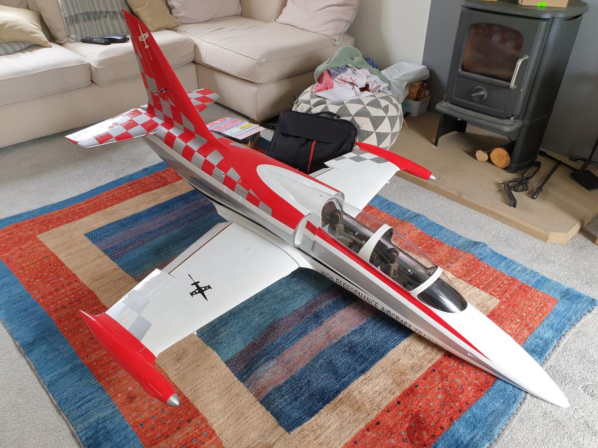

                                    • Awesome stuff you've got there Reeper, those should keep you entertained all summer 🤣👍

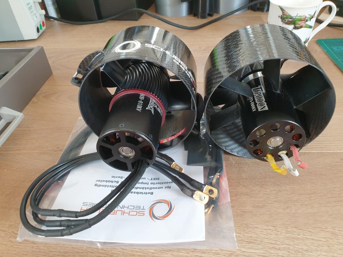

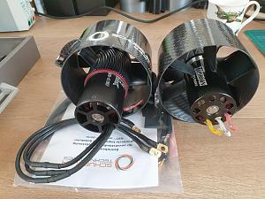

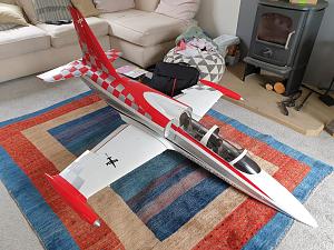

                                      I've got a few other projects on the go, problem I have is sticking to one until it's ready!
                                      Click image for larger version  Name:	20210122_125631.jpg Views:	1 Size:	147.3 KB ID:	297076
                                      Click image for larger version  Name:	20200711_144434.jpg Views:	1 Size:	207.9 KB ID:	297077
                                      Awaiting EDF conversion, with Schubeler/Tenshock
