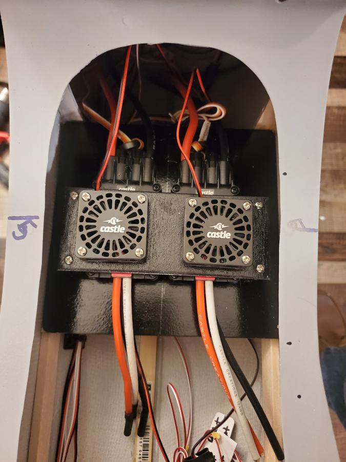

      Today is the day the warthog is fully rebuilt better than ever...x2 jetfan pro 120mm with het 590kv motors.
      putting in a whopping 33lbs of static thrust and I dropped the weight from 32.5 lbs down to 29.5lbs..... I pray 🙏 everything goes right today winds are 5-12mph Click image for larger version

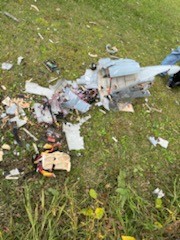

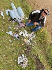

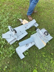

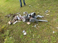

        Well complete failure on maiden ..before anyone else crashes get in contact with me I know exactly what needs to be done know to reinforce the wing it definitely had everything to do with the center wing section...it needs to be opened up and a spar put through it and filled with foam for sure....hey jinkx u where right...haha but other than that if you guys fix that you will have a great flyer ...she was smooth and easy to fly for the spilt darn second Click image for larger version

            Reeper38 That is just a pitiful photo of the crash site demise of your efforts and large expense. :head_bandage:
            When this thread was first introduced In April I was pretty active trying to get the authoritative word from Motion to confirm/deny the structural/fan issues that plagued this model for five yrs prior to Motions dealer acquistion.
            After Alpha's post #32 in early April(concerning wing structure) and no response on my question in post #35 about ChangeSun fans I just sorta lurked in silence on the sidelines.
            Your posts #165 on the fans catastrophe and todays wing failure posting has squarely confirmed my concerns about this Roban model and am now resolute in avoiding this one.

                    Looking at Reepers photos the wings broke clean off next to the fuselage, looking at this photo, no wonder, just a thin ply rib with very little glue!

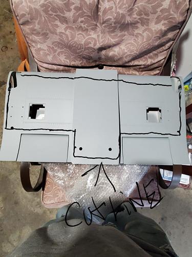

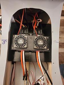

                      Skytrak your absolutely right thats where it broke..I have a new one coming and will build it right...stay tuned haha...ill log the entire build this time...make sure u glass the leading edge and trailing edge of the whole wing...then what im going too do is is run 2 carbon spars from wing tip to wing tip with webbing the epoxy everything together then fill it with foam...then shave out the servo pockets....its alot of work but it will be worth it ...also add internal structure to the fuse ..I ran horizontal balsa sticks mid. And sides down the whole fuse then a plate to connect the sides then added epoxy over em..Click image for larger version

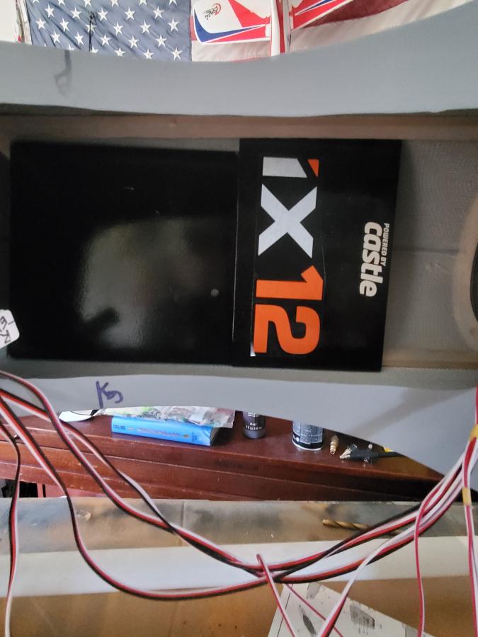

                        Alright round 2 begin....every one please pray for a successful build....haha after no.2 ill definitely have had spent enough to get a bvm or skymaster w/turbines Click image for larger version

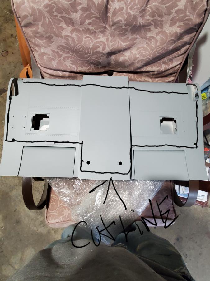

                          And this is where she's getting opened up...need too add bigger plates for gear and block it out so it connects to ribs and upper skin and install new blind nuts for air retracts...from my newly crashed pc21 then adding 2 carbon spars and sheer webbing all the way through ..this time I will show the full build from beginning to end Click image for larger version

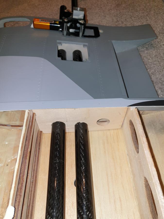

                                Trial fitting carbon tubes 93g per 1000mm

                                    Thanks u should cut out the sheer webbing and continue the main spar also ..imo that right where mine broke .also the roban guy said to layer cloth on the leading and trailing edges...im opening all of it wing tips included..im making damn sure this one dont break..and im going to make it top gun scale ...I like the retracts how hard to mount and what struts u useing?

                                        20mm OD 1mm wall, retracts are Electron 40evo, ordered them with 11mm trunnion for front and 12.7mm for mains, original struts fit nicely, front needed woodwork mods but mains needed very little, changed T nuts from 3mm to 4mm and put plenty Hysol glue around internal edges.
