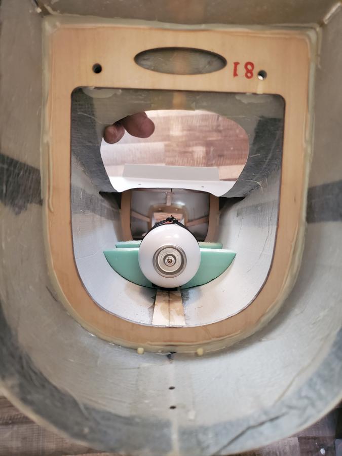

      Also added these formers over the wing connector plate...all the had was it attached to the skin...it isn't tied to structure so the heavier the plane gets the more u need that strengthened Click image for larger version
          Yeah, I knew about the wing connector plate from a guys post in the RCgroups forum. I like your first elevator setup. I think that's the way im going. I already have two servos that will work that I had in a sailplane. I'll use those in the rudders since they really don't need a ton of torque. I'll use the new ones I bought for the elevator halves. I really wish I could afford to buy one of the reduced price airframes Motion is selling. Im thinking about buying one anyway and kinda force it into my budget. As much money and work I've got into this project I'd hate to not be able to rebuild it if I had an incident

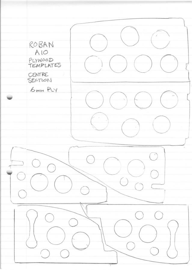

                    #249
                    Jink - photo in #227
                    I put the ply forners in the middle, level with fuselage, there was nothing in the middle to support the new carbon tubes. Even if you have glued a tube in already you could add something similar, added a lot of strength!
                    I scanned them before fitting and saved as an A4 file, I can attach template file for cutting if you want to download it.
                    The two 10mm tubes I put in the front was easy and worth doing, with a 1/8" ply shear web between them.

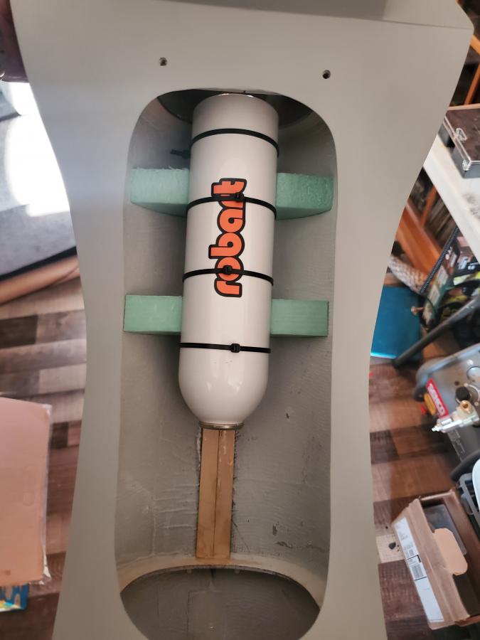

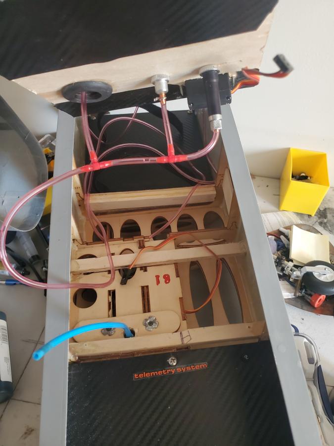

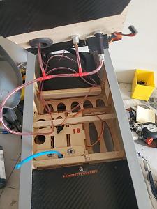

                              Air tank and fill valve and gauge secure Click image for larger version
ID:	289900Click image for larger version
ID:	289901Click image for larger version
                                      Skytrak, do you have a pic of them installed, im not sure i understand exactly how you installed them, im just trying to weigh all my options before I perform surgery on my center section, thanks

                                        #259
                                        Jink,

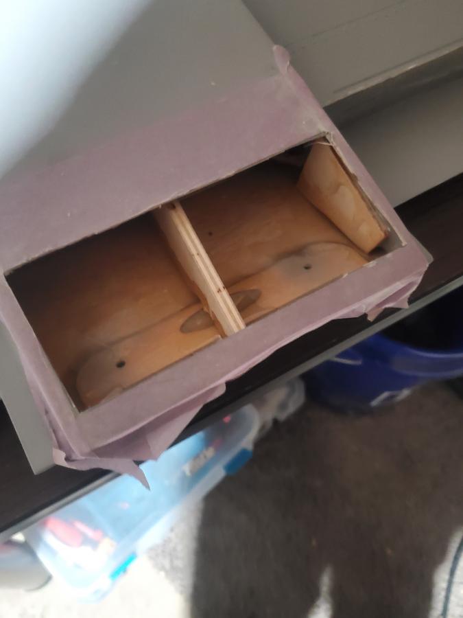

                                        Cutting the centre open underneath is the easy option as less cosmetic repairs are needed, I just left a 20mm edge all around, to close it up afterwards I'll glue a balsa or thin ply strip around then glue the cutout piece back in.

                                          I still need to add a piece of ply and epoxy/cloth to strengthen the part that attaches wing to fuselage.
                                          with the long nozzle glue gun I was able to re glue probably 80% of the internal structure of the entire wing, all 3 sections, including beads of glue around the plywood landing gear mount.
