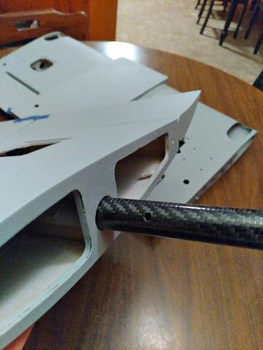

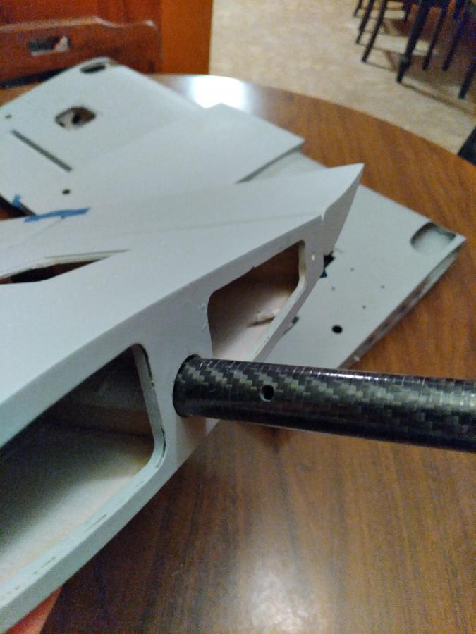

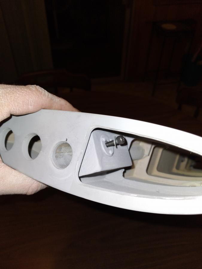

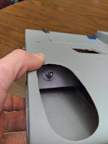

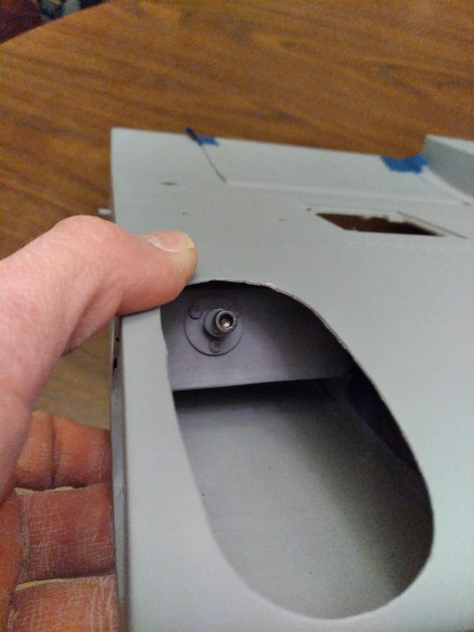

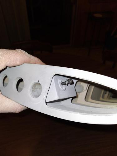

      I said I'd post pics of my outer panel attachment mod so here they are. If I had known I was going to have to open up the wing I may have done it differently. Since I have to open the center section and outer panels I've decided to do a double wing tube because of the weight and size of the model. Im going to use one of the 20mm tubes im adding to the center section as a sleeve for a second wing tube. Ilm going to add ribs to the outer panels to attach the additional wing tube. Iv already ordered the tubes so ill post new pics of the additional mods when completed Click image for larger version  Name:	20201219_185120.jpg Views:	0 Size:	35.4 KB ID:	290908Click image for larger version  Name:	20201219_185150.jpg Views:	0 Size:	54.3 KB ID:	290909Click image for larger version  Name:	20201219_185343.jpg Views:	0 Size:	62.5 KB ID:	290910

          I notice you've got carbon tubes in the outer section, I like the mod with screw in wheel well, but will it crush and weaken the carbon? I'm using the aluminium tubes, might glue a carbon one inside those for added strength

            The hole is only drilled through one side of the tube, Im not particularly crazy about the idea of drilling a hole in the wing tube but the hole isn't on the stress point. For added strength I took a 6in carbon ferrell that was made to join two sections of the 18mm carbon tube together and hysoled it inside the wing joining tube centered on the joint where the two wing sections come together. After I drilled the hole I took thin CA and saturated the inside of the hole and took a small round file to open it back up to the size of the set screw. It doesn't put any pressure on the tube at all, it just prevents the tube from sliding out of the center section. The easiest way to get a perfect fit is to add the block to the sleeve on the center section, insert the tube, drill the hole, then add the blind nut and set screw, then insert the tube in the center section, tighten the set screw and then apply the epoxy to the sleeve on the outer panel and slide it on to the tube tightly and tape the two halves together until dry. Then you can back the set screw out and pull the two halves apart and your set. Just make sure you have the angle right to reach the screw with gear pods attached with a long ball driver, i bought one 15 in long just for attaching and removing the outer panel

              Yeah I actually like that idea..damn if I hadn't epoxied the wings together I wouldve done that...thats a great idea to attach the wing like that..thats not going anywhere...put I do handle the a-10 myself and its not bad flipping it by yourself ..I made a tall stand out of pvc...to help Click image for larger version

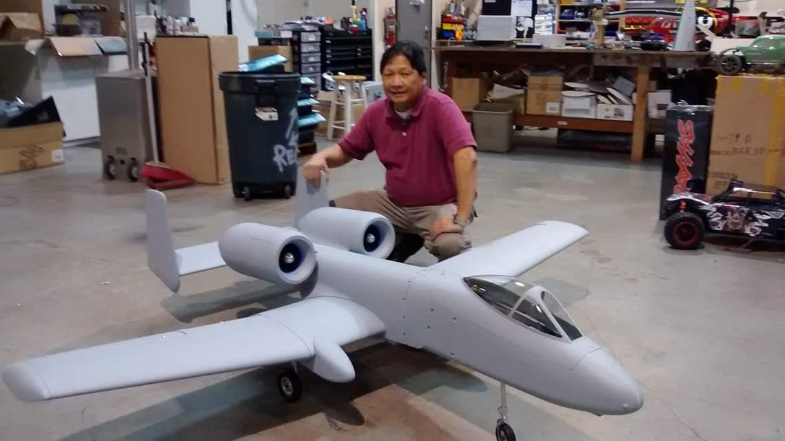

                          When we first did the prototype model, we tested different motors and finally ended up using the Scorpion HK4035-560KV motor with 8mm shaft. We had asked Scorpion to have this particular motor done basically for the Roban A-10. I believe they are no longer available. However, I have to make my recommendations to replace your factory plastic provided EDF units. The photos above in camo scheme was well made including all the mods I could think about. CG was spot on and weighted 31 lbs. The aircraft took off successfully. Upon reaching 100 feet,these powerful motor's fan blades shattered and motors popped out on both sides of the engine nacelle.
                          I suggest using the Shubeller composite 120mm Fan casing. Since the Scorpion motor with 8mm shaft is no longer available, I am using the HET 560 motor for this one final build I am doing. You may call EffluxRC and let them build the EDF unit that includes precision fan blade balancing if you decide to go thatroute. . It'll cost an extra thousand but it'll be worth it.

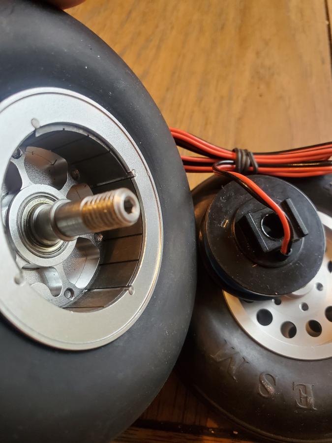

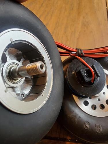

                                  #296

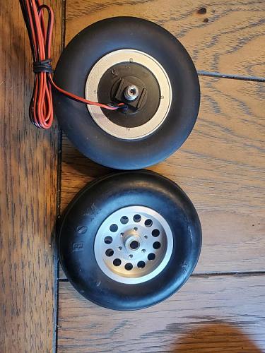

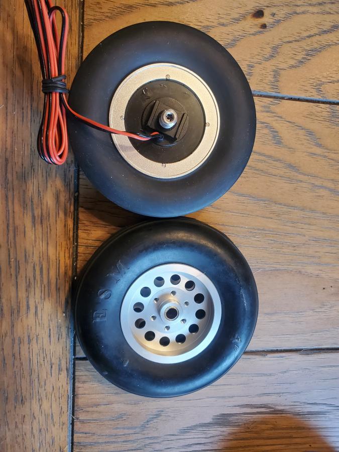

ID:	291457 Jinx i already recieved the jp 95mm they are so close in size they will be fine.when I tried to order from xicoy my debit card wouldn't work over seas so I said screw it and ordered jps ..they will be fine im taking the axels to a local machine shop and having new ones made that will be longer and step down from 8mm to 6 and mill the hole in the struts..and jp also sells the springs for the struts in the right sizes so I ordered a bunch of different sets of stiffnesses to see what works best.. Click image for larger version

                                    #297
                                    Originally posted by Reeper38
                                    When you figure out what springs work best let me know, iv got to replace mine too, I fly mostly off grass so I was going to not use breaks for now but my wiring harness i built are wired for breaks so I can add them easily later. I have my carbon tubes and other materials I need to modify the wings. I've got a week off coming up after the first of the year. I plan on spending it tearing the wings apart and reinforcing them. I think I have a solid idea for the mod. Kinda taking ideas from you and Skytrak and adding my own twist to it. I think it will work just fine. If not I guess I'll buy a skymaster
