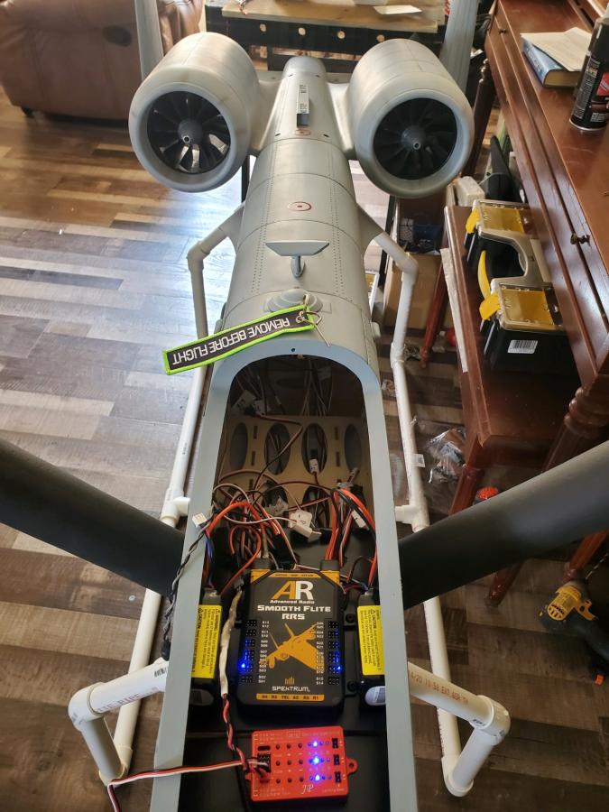

                • I'm using the 26ch smooth flite from booma and the jp hobby landing gear controller .the gear its self doesn't have a switch

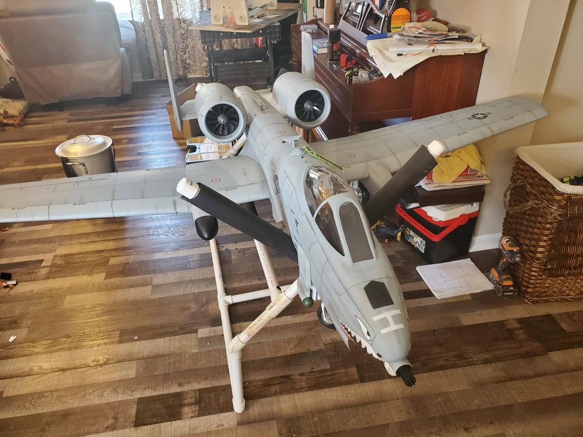

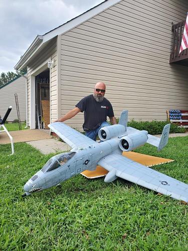

                  • She is done finally just put it on the xicoy and have the cg dead on ...the right wing needed 10oz to correct and the nose needed 1lb so the auw is 30.5lbs ...hopefully will be posting the maiden video Click image for larger version
ID:	275321 Sunday....wish me luck
                    • Looks fantastic Reeper38! Love the subtle detailing/weathering. I wish you the very best of luck on your maiden Sunday! Looking forward to a successful maiden video and report!

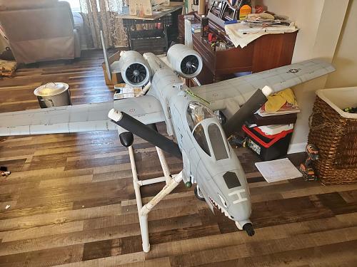

                                    • Well hopefully its nice next weekend and I can maiden this hog Click image for larger version
ID:	275757Click image for larger version
