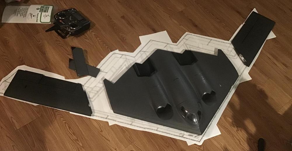

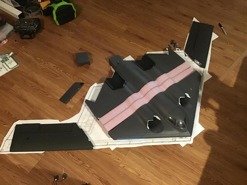

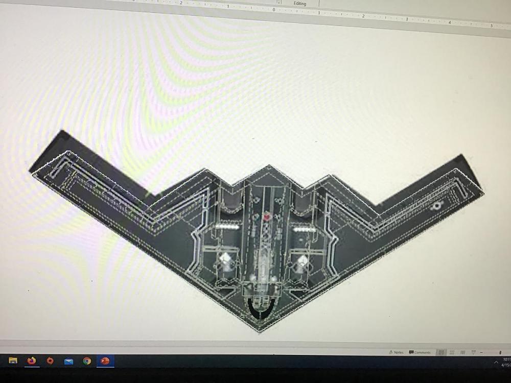

    Around 2 months ago, I picked up an LX twin 64 B-2 Airframe Kit on sale from Banana. I’ve wanted to give this one a shot for a long time now, and the price was right. However, every time I looked at the model, it looked like a cartoon version of a B-2. The outer wing panels were oversized, and the canopy/engines didn’t look right. I finally pulled the overhead view into PowerPoint and overlayed the 3 view of the real thing:
    Click image for larger version  Name:	67ED08D6-8497-4B71-B3B5-B1F02375E0B3.jpeg Views:	10 Size:	96.5 KB ID:	250072

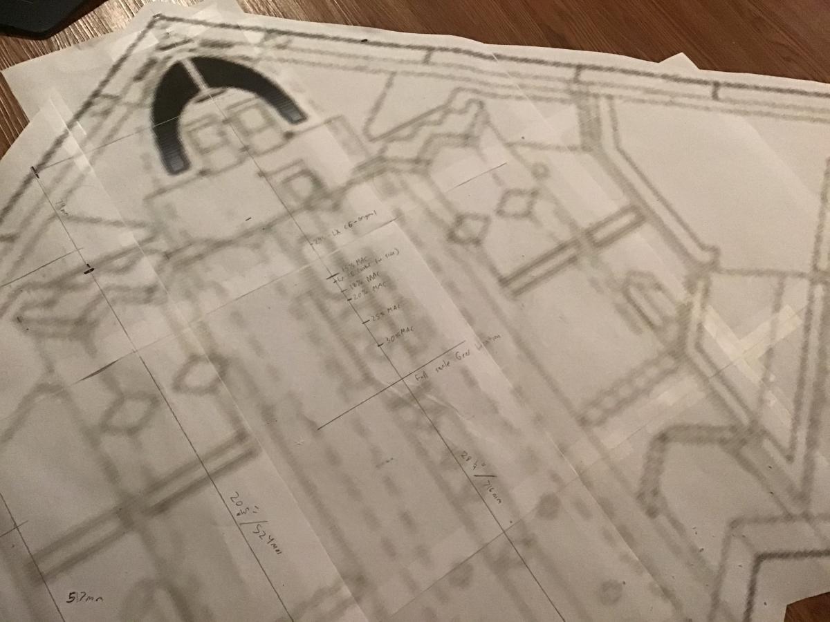

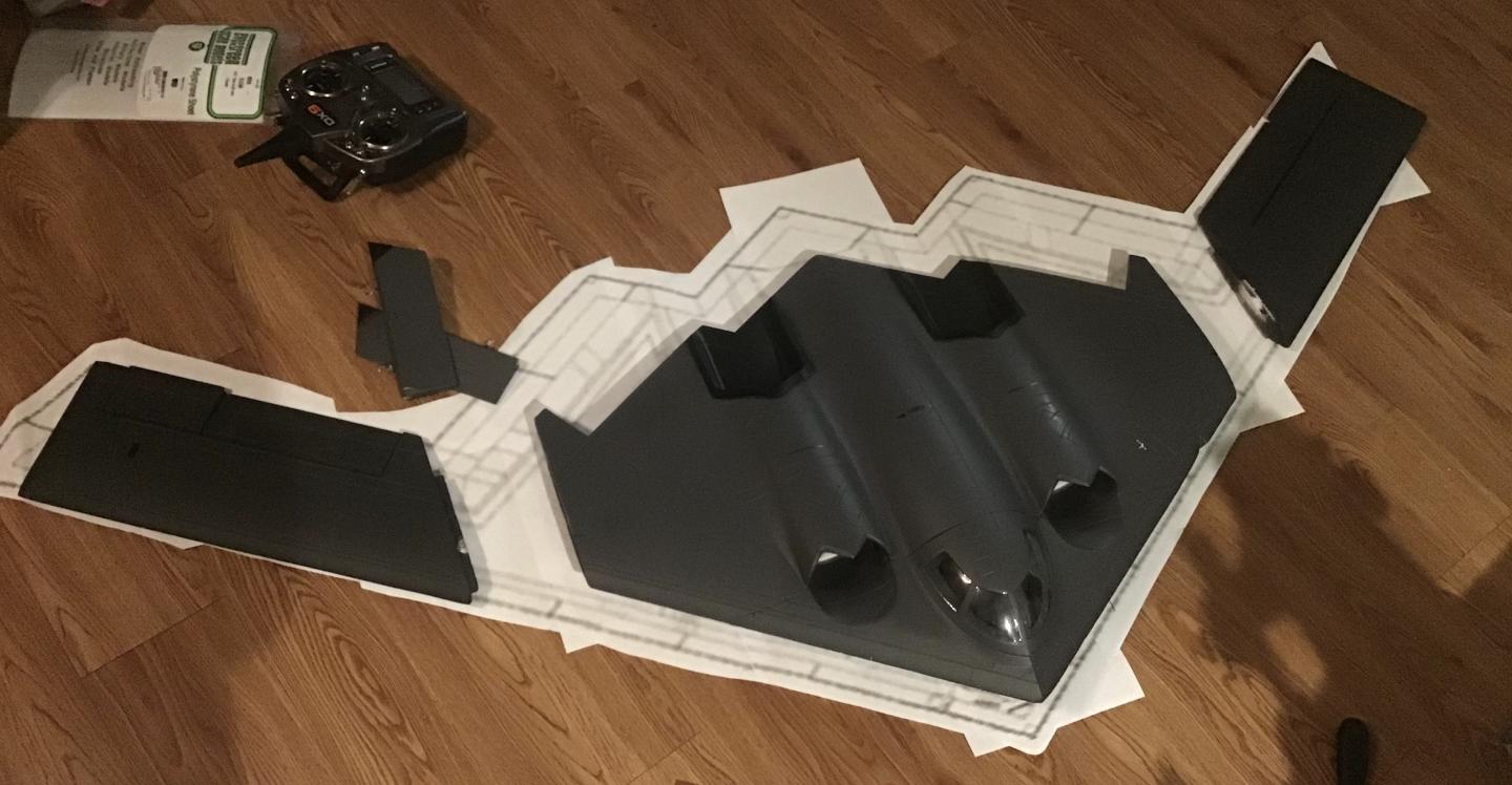

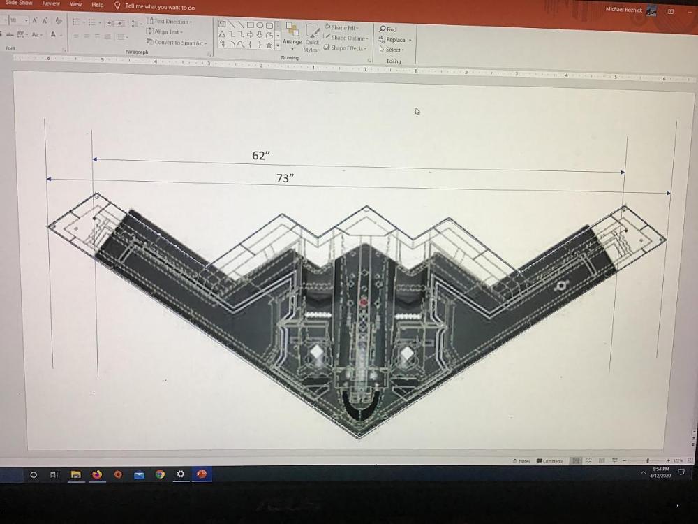

    The oversized outer wing panels were definitely the most noticeable, but the canopy also appeared to be significantly oversized for the airframe, and the intakes were too far outboard. Out of curiosity, I stretched the 3 view out until the canopy size and endings spacing was correct:

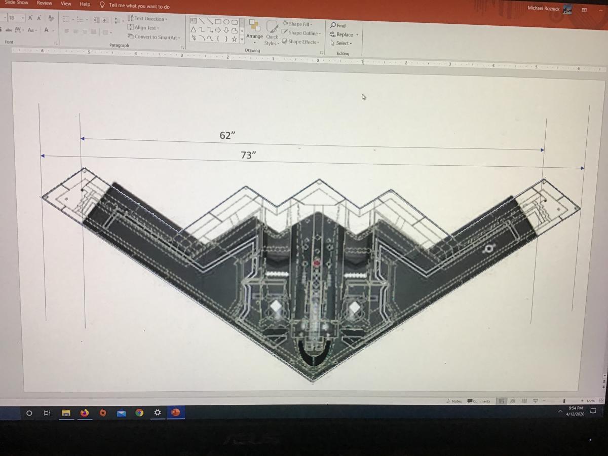

    Click image for larger version  Name:	F232745D-3285-4566-A799-9A78545DDB7E.jpeg Views:	7 Size:	97.8 KB ID:	250073

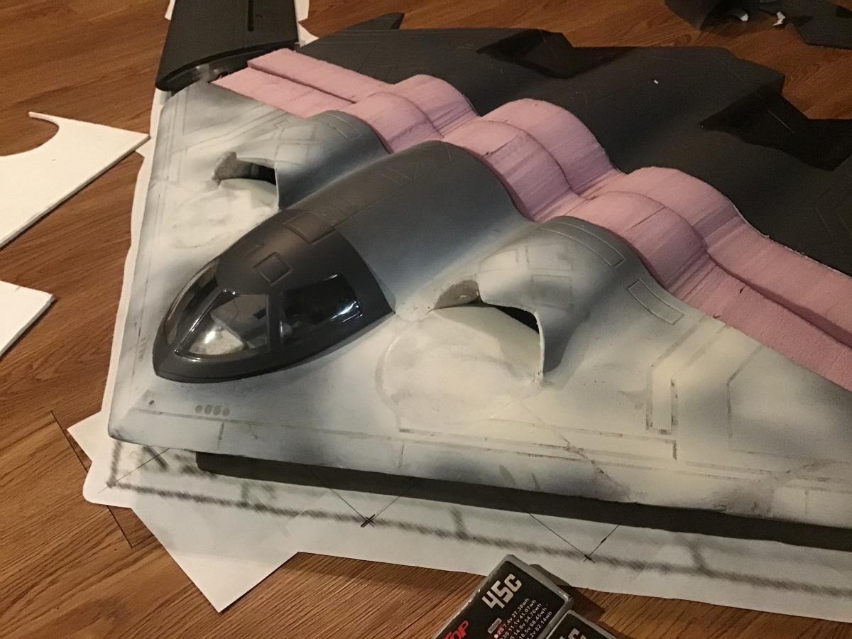

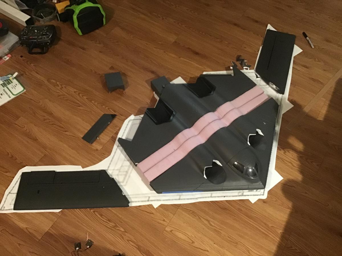

    Now this started to get me thinking.. At this larger size, the outer wing panels are nearly perfectly sized. I printed off the 3 view scaled to the larger wingspan and started planning. A 3” spacer added straight through the center section would stretch it to scale size:

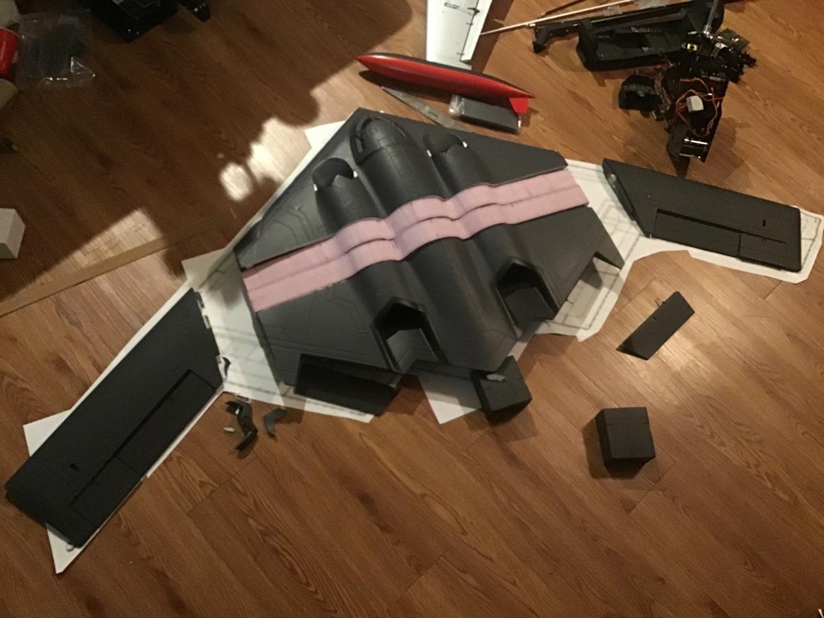

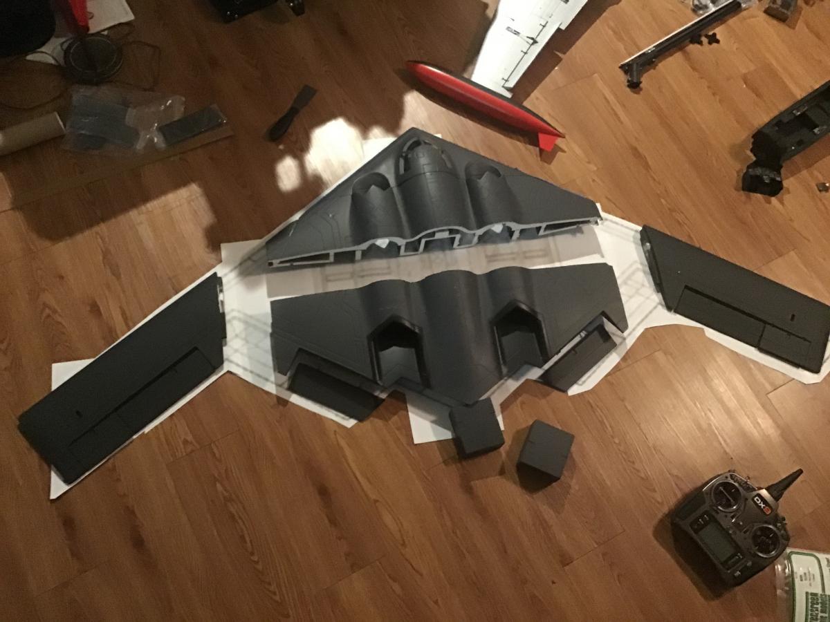

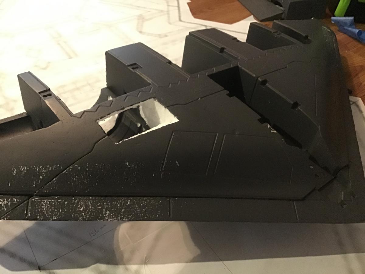

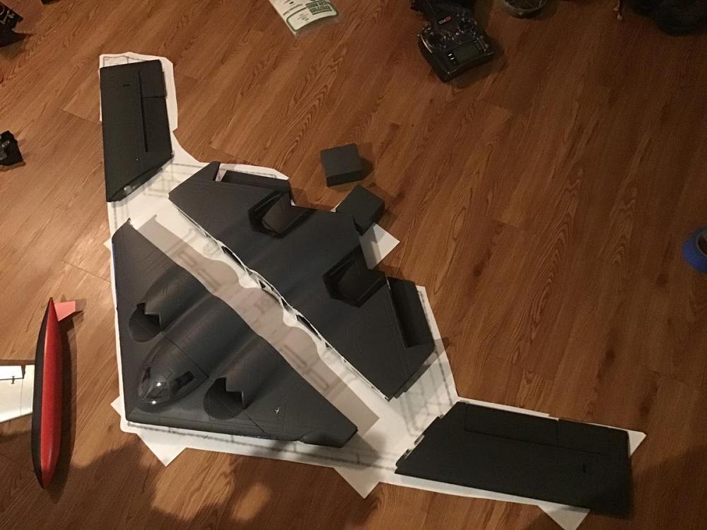

    Click image for larger version  Name:	D7C3892B-1BFE-4AFA-A480-D71B4BB14D4E.jpeg Views:	7 Size:	121.8 KB ID:	250074 After a few days of debating how to proceed, I got out my jigsaw and cut the airplane in half:

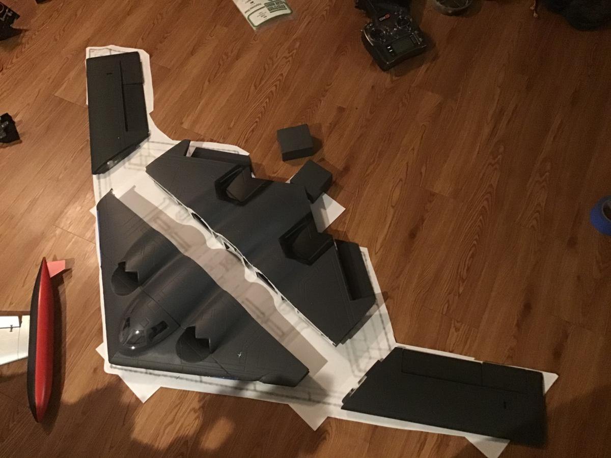

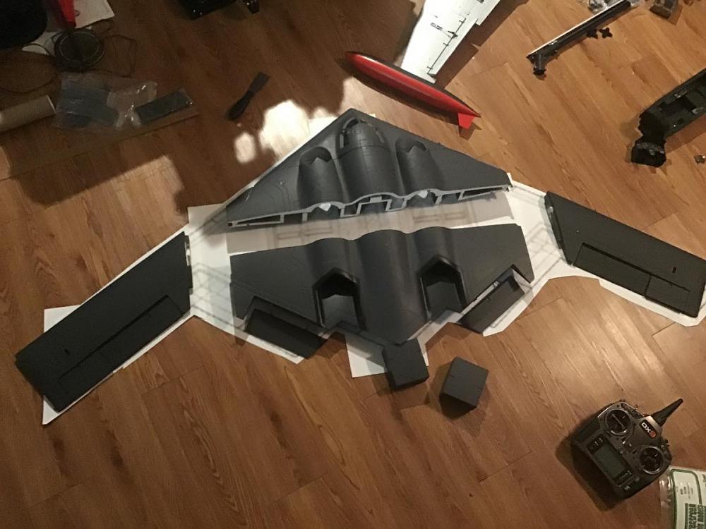

    Click image for larger version  Name:	D0A300EB-E443-44E2-8D42-32744CD95C20.jpeg Views:	7 Size:	110.7 KB ID:	250075Click image for larger version  Name:	9F97B2E0-64BD-4D0B-A349-AA1CE7030BA8.jpeg Views:	7 Size:	114.0 KB ID:	250076 I then fabricated 2 spacers from 1.5” pink foam to fill in the gap.
    Click image for larger version  Name:	EF348B7F-BACB-42A1-80EE-C4F813219801.jpeg Views:	7 Size:	118.3 KB ID:	250077Click image for larger version  Name:	A0A60E56-AE98-47DD-A18D-D9A0C72CBCB5.jpeg Views:	7 Size:	124.1 KB ID:	250078 Next up will be the challenging part: Integrating the landing gear, structure, bomb bay, and battery compartment into the new sections. For propulsion, I picked up 2 of the new 6S 64mm units from the Eflite A-10. Hopefully they will be up to moving this guy once the rebuild is complete.

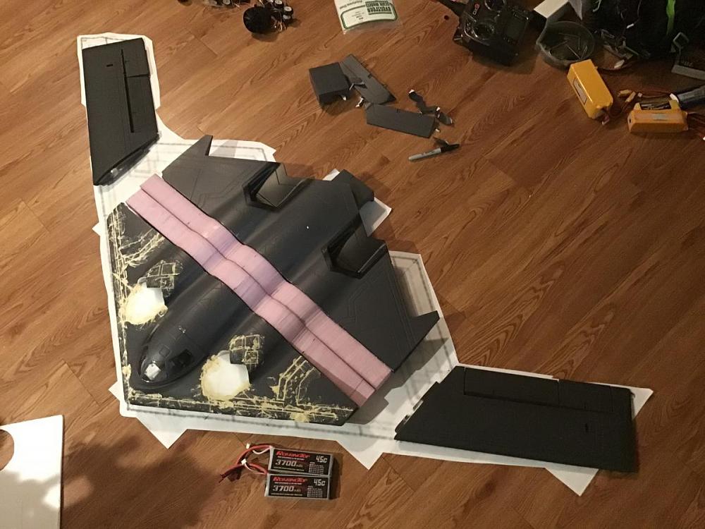

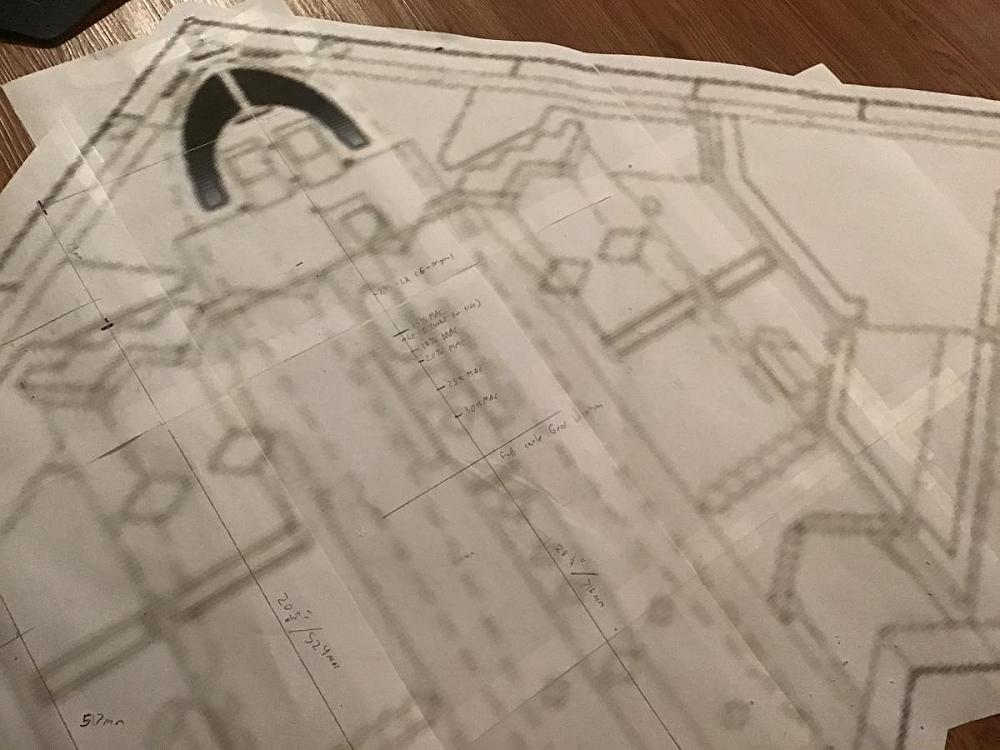

        Thanks Alpha and Wesley! Banana has always been a grey zone for me. I only go there when I need a real engineering challenge :). One of the next objectives on my list was figuring out the Aerodynamic center and setting a CG to aim for. I ran the geometry through an online calculator, and came up with the following static margins:

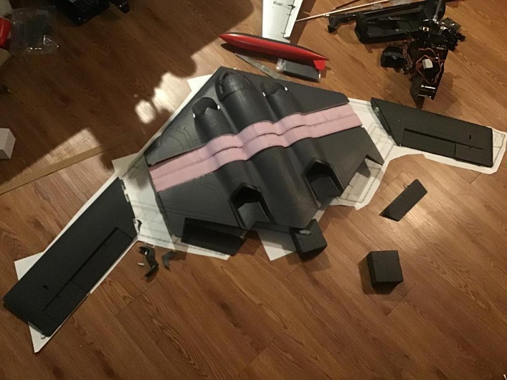

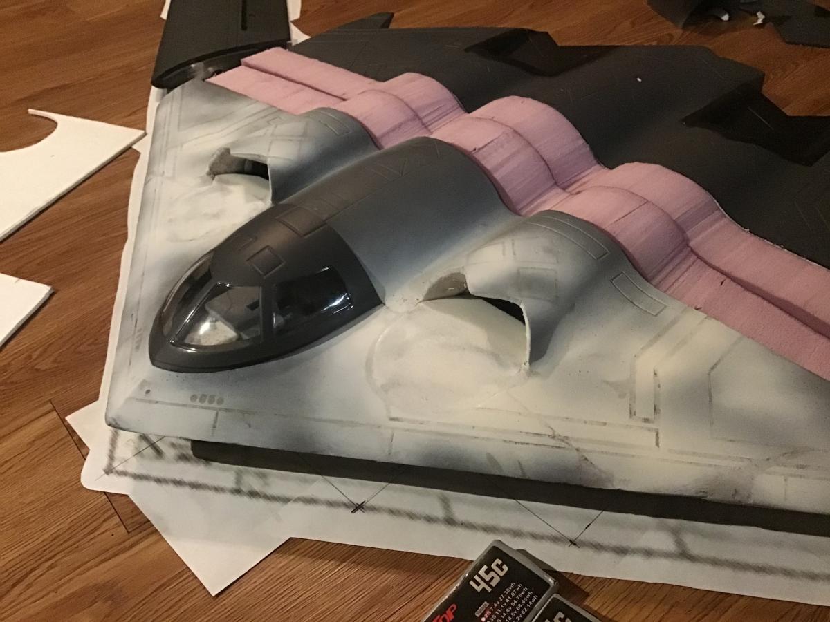

ID:	250197 For now, I’m aiming for around 18% MAC for the maiden flight. This CG position is also going to inform the location of the main landing gear. The landing gear on the real thing is very far aft (around 35% MAC). I will move it to around 27% or so to try to get smoother rotation. Hopefully that will improve things a bit in that regard. It will however, shorten the already close-coupled distance between the mains and nose. I will be planning on installing a gyro for both nose wheel steering and the drag rudders at some point down the line.

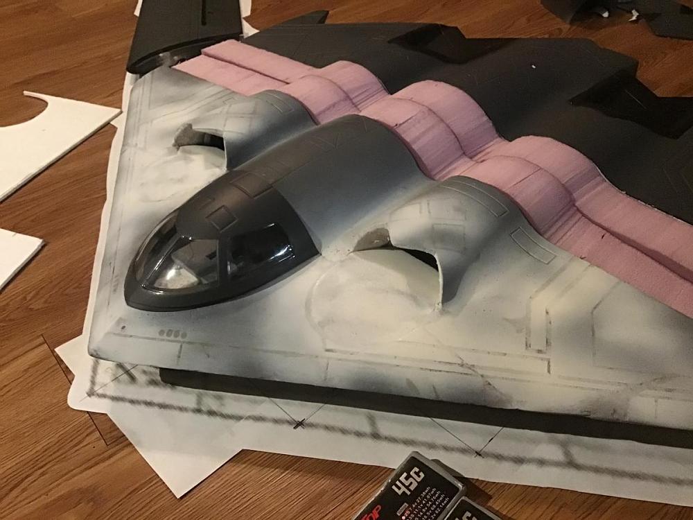

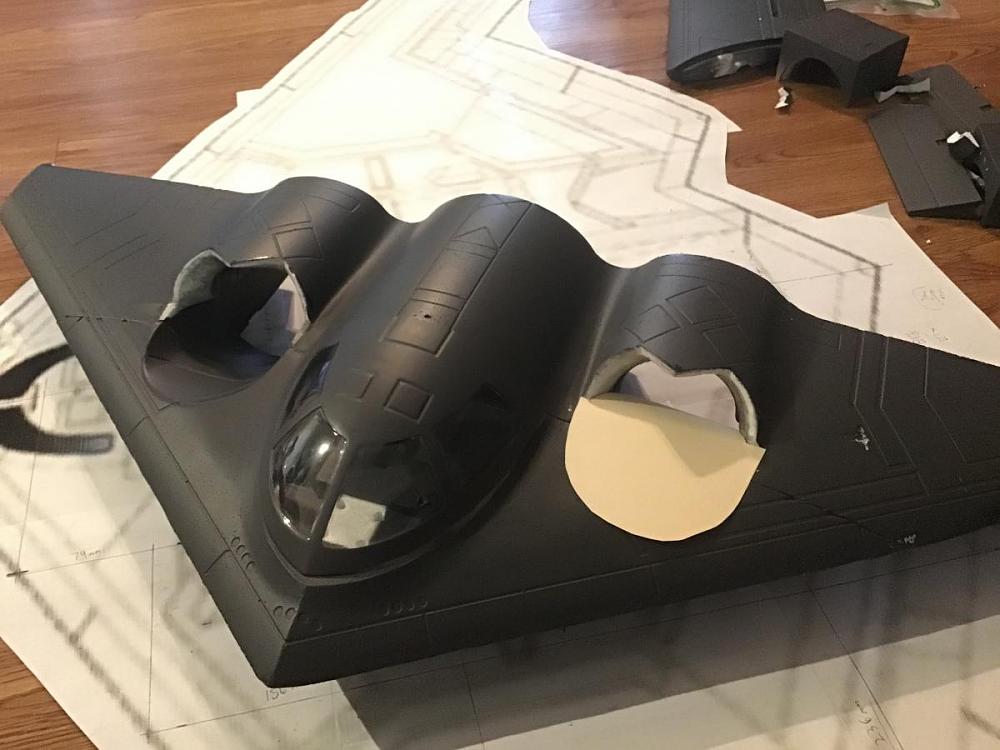

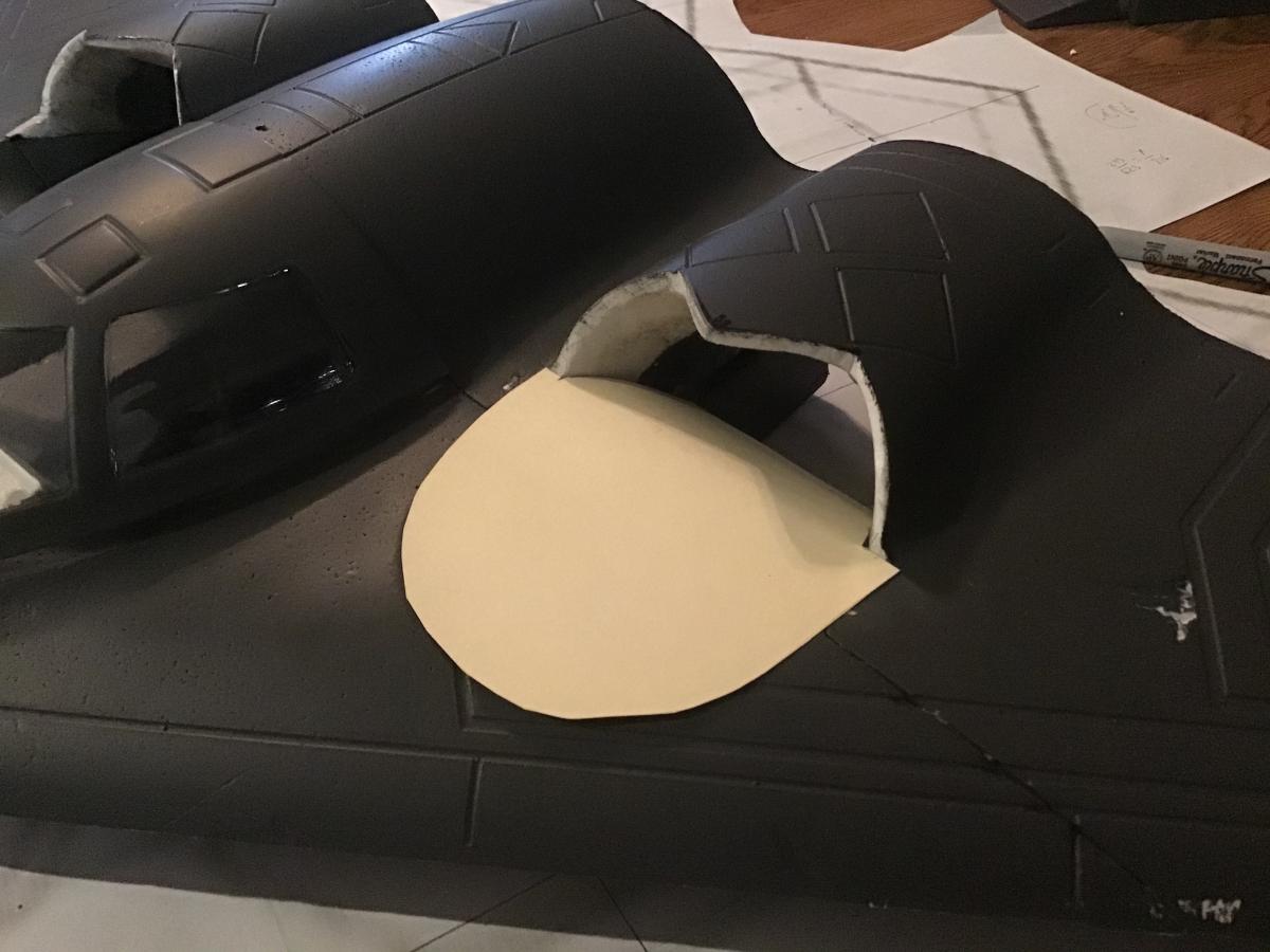

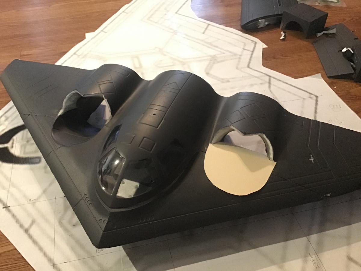

        The next priority item was the intakes. I cut them back by around a 1/2” to move to the scale position. I’ve always found the giant divots in front of the intakes to be a major eye soar on this model, and wanted a way to make them look more scale. I decided that a cheater grate was the best way to accomplish this. The divot will be covered up with foam, but here’s a preliminary check on how it will look:

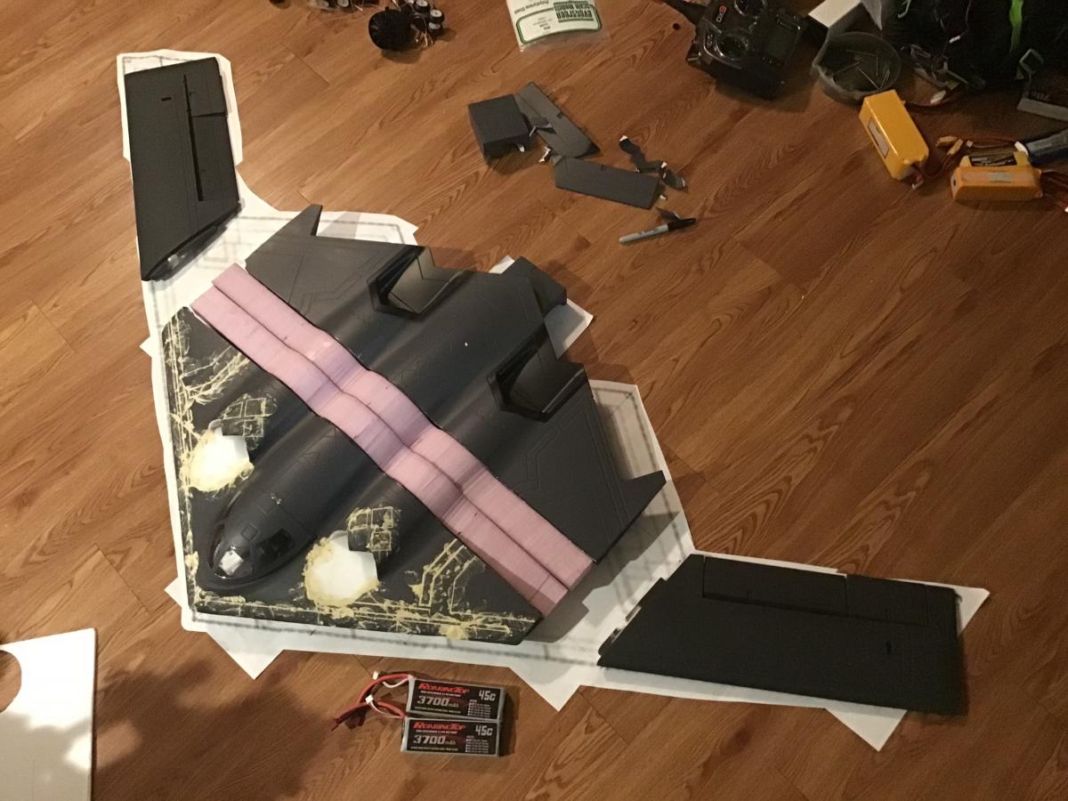

        Another issue was battery space. Stock, there is no way a 6S battery would ever fit. I was however, able to remove just enough structure to accommodate 2 3S 3700s. Those will be tied in series for primary power. Although I would have loved to have the functional bomb bay, I will probably end up using it as the gyro/receiver bay. There is so little space to put anything in this model, it’s pretty much the only place that works!

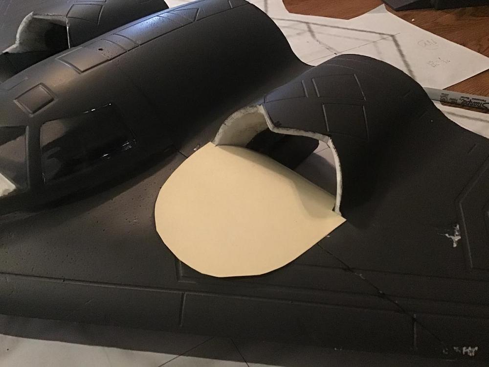

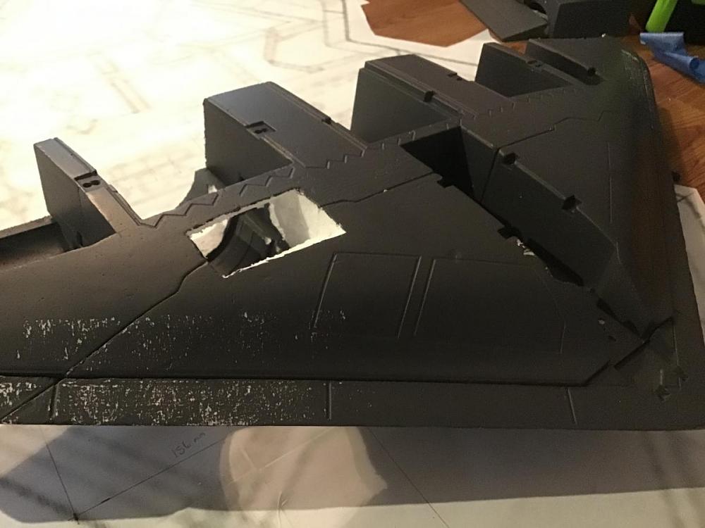

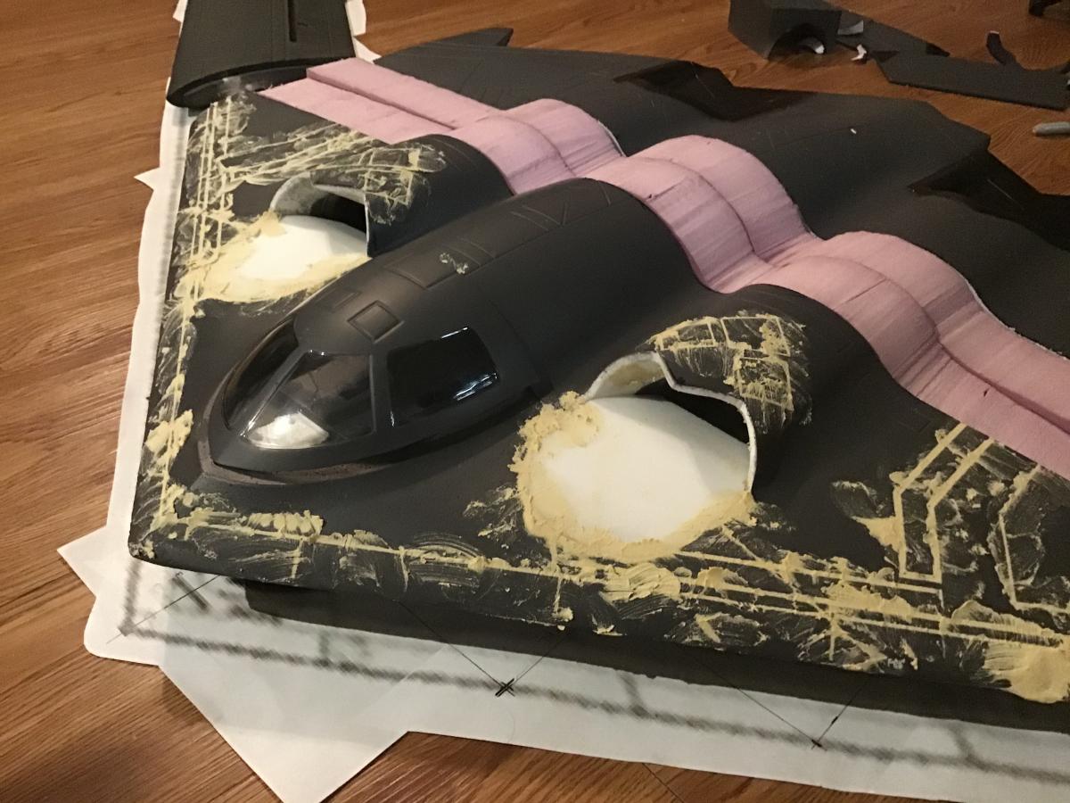

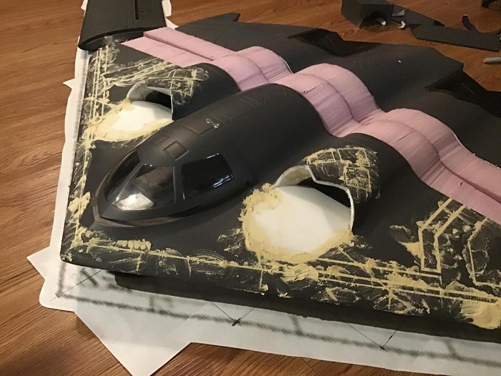

                Anyways, I made the blocker plates for the wing divots today out of Flite-Test style dollar tree foam board with the paper removed. I also started filling in all the gaps and panel lines with Hobbico filler. Already starting to look a bit more like a B-2! The canopy is also going to need some mods down the line. Like to original airframe, the oversized cockpit windows make it look like it flew out of a cartoon. Now I’m just waiting for retracts to arrive so that I can start working out the gear configuration.
                Click image for larger version  Name:	09D9DF8A-47EC-44DC-BF9E-951C885EA109.jpeg Views:	4 Size:	131.8 KB ID:	250667Click image for larger version  Name:	52DAAA9B-4B2C-4EBF-BAB3-0CBC4071C3F5.jpeg Views:	3 Size:	137.5 KB ID:	250668
                  Definitely beginning to take shape! Very cool, I've never seen anyone attempt this before with the LX version. Can't wait to see it all finished. As for LX, great analogy. Such potential, we've seen it with their ambitious air frames for many years. Hell, their F-117 was my first EDF! (Yeah, let that sink in). Yeah, as you can imagine that lasted about a minute, lol. Good ol' Banana Hobby's descriptors: "Super Stable! Perfect for beginners!!" I didn't know any better at the time but I was their perfect customer: No experience, but HAD to have a stealth fighter! Take my money!
                  Thank God for Freewing. I don't want to even think where we would be with foam EDF jets without them. Speaking of, if Freewing were to ever develop their own B-2 (imagine?!?!) your finished product might be the closest guess we could ever see as a foamie B-2. I'll be anxiously checking in on your progress!

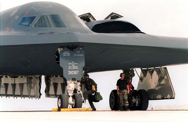

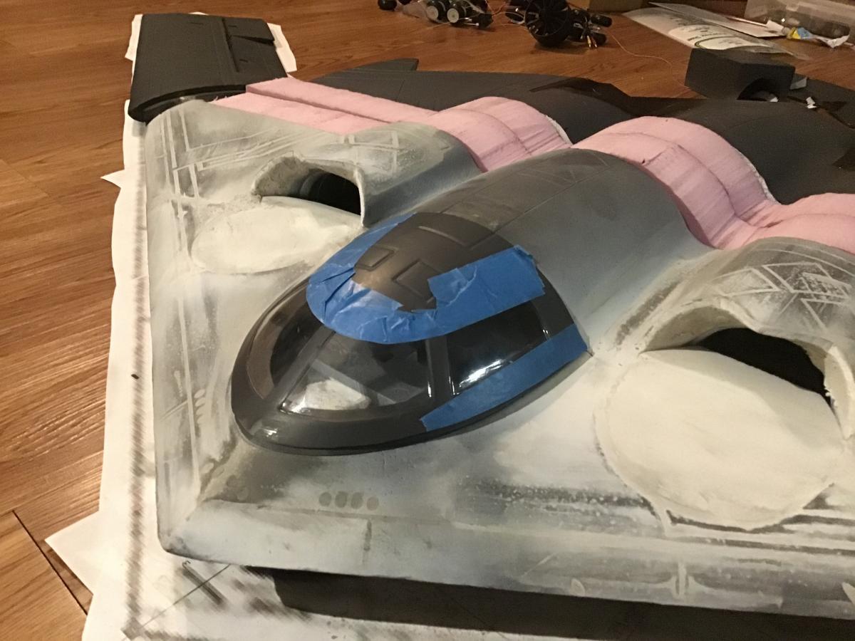

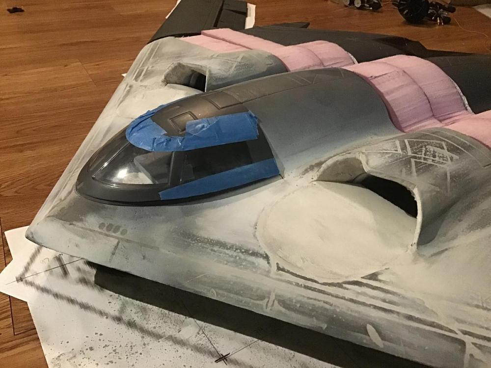

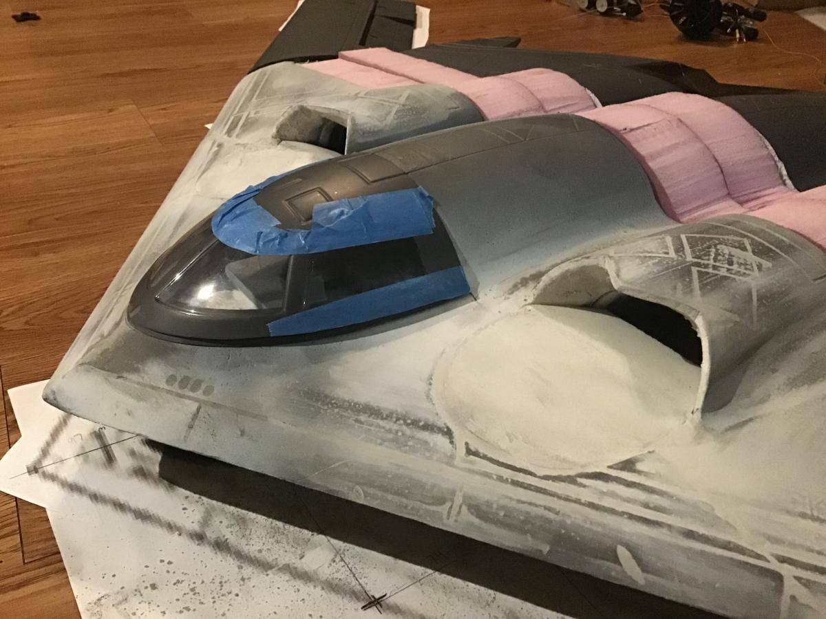

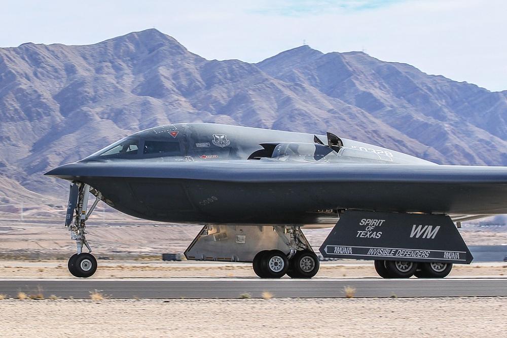

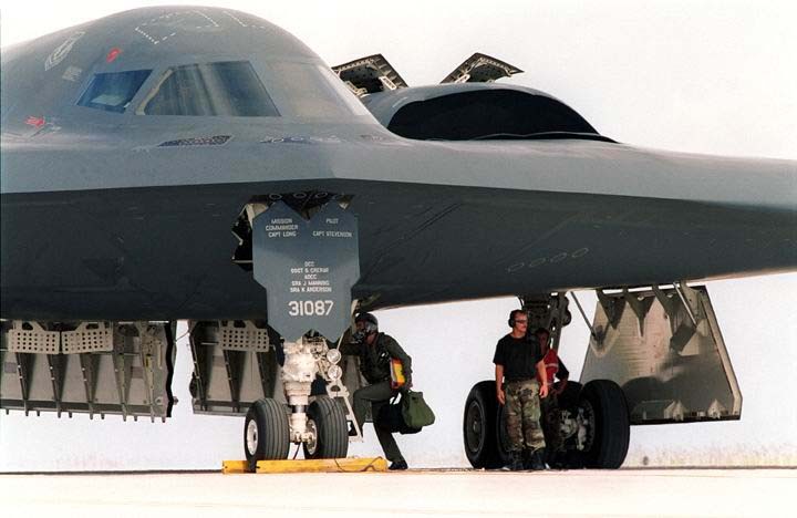

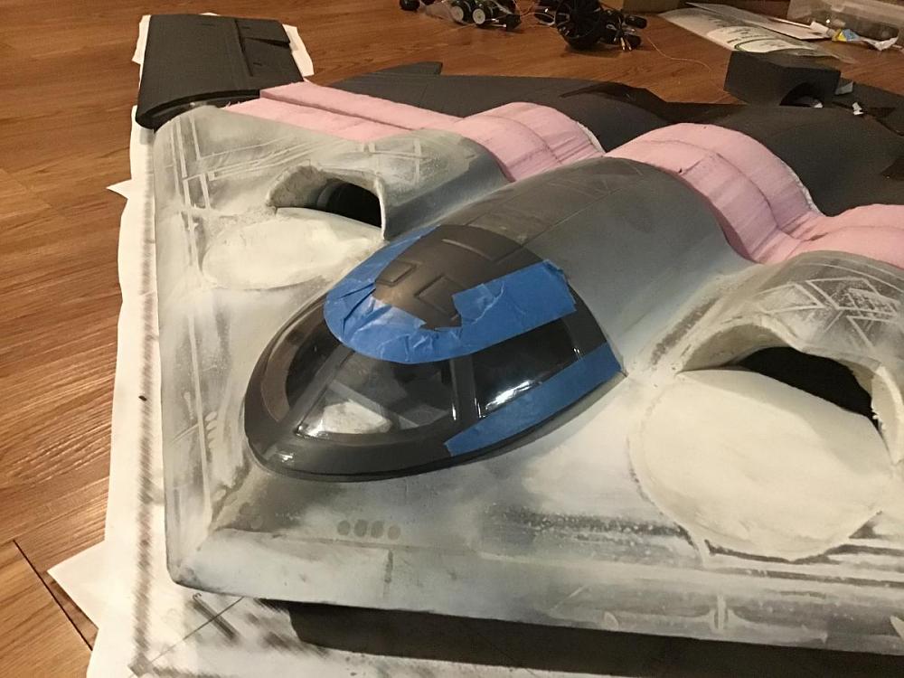

                            Not much progress today, but I’ve been messing with tape to see what it will take to get the windshield looking a bit more scale. There is definitely an improvement by altering the shape of the windows, but the angle of side braces really bothers me. It gives the side windows quite a different look than the real thing. I’m also not a fan of the thick raised canopy frames. The real frames are perfectly flush to avoid radar returns. For now, I’ll probably just modify the stock one a bit, but if I can get it flying well, I might end up making a new windshield from the start.
                            Real B-2:
ID:	251181Click image for larger version
                            Stock:
                            Excess Window blocked by tape:
ID:	251177Click image for larger version
                              • 4878

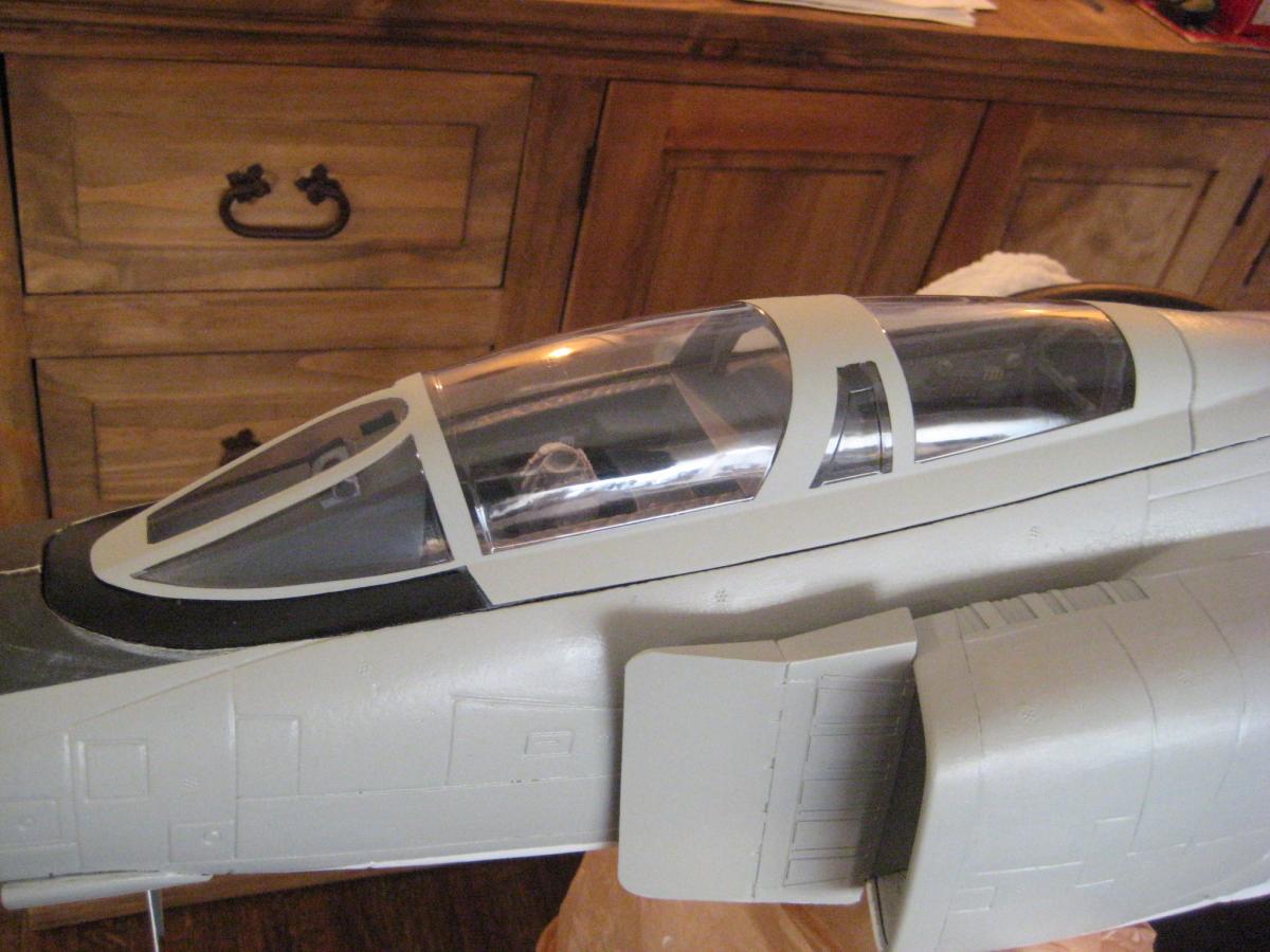

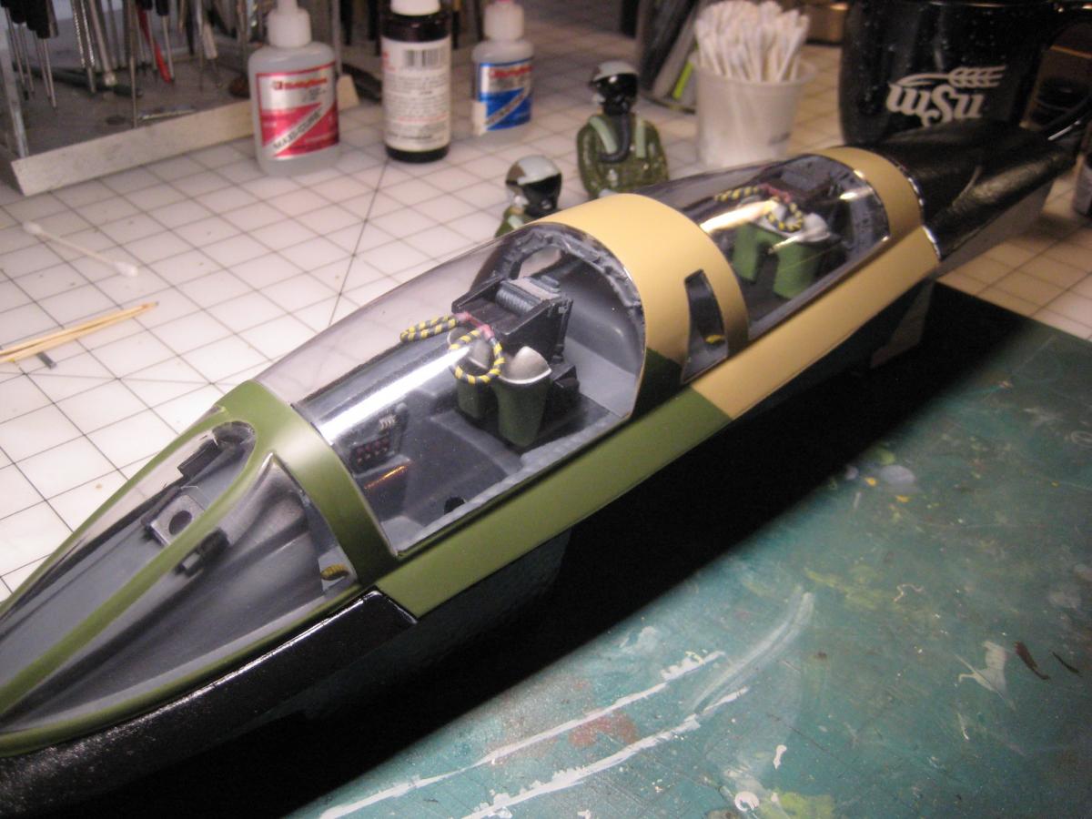

                              F106DeltaDart, 90% IPA will dissolve most acrylic paint. I used that to remove all the paint from my F-4 canopy and re-masked the for a more accurate canopy frame and window shapes. Could you do that for this? Best, LB
                                    Thanks for tip Elbee, I’ll give that a try!
