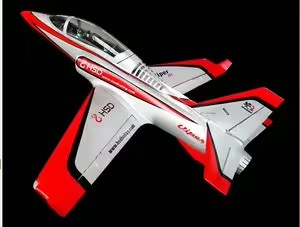

              Sorry to revive this thread but thought I drop my curiosity regarding this topic. I own an HSD viper 75mm kit. I ordered a freewing 80mm 12b 6s power system from motion. Since this is 5mm difference, do you think it’s plausible to move forward with this mod? The airframe has vents on the top deck. I would imagine it would work out just fine. I will have to hog out some foam for perfect fitment. If anyone would chime in. All opinions will be taken into great consideration.
                • 5393
                #27
                Yep, should be fine
