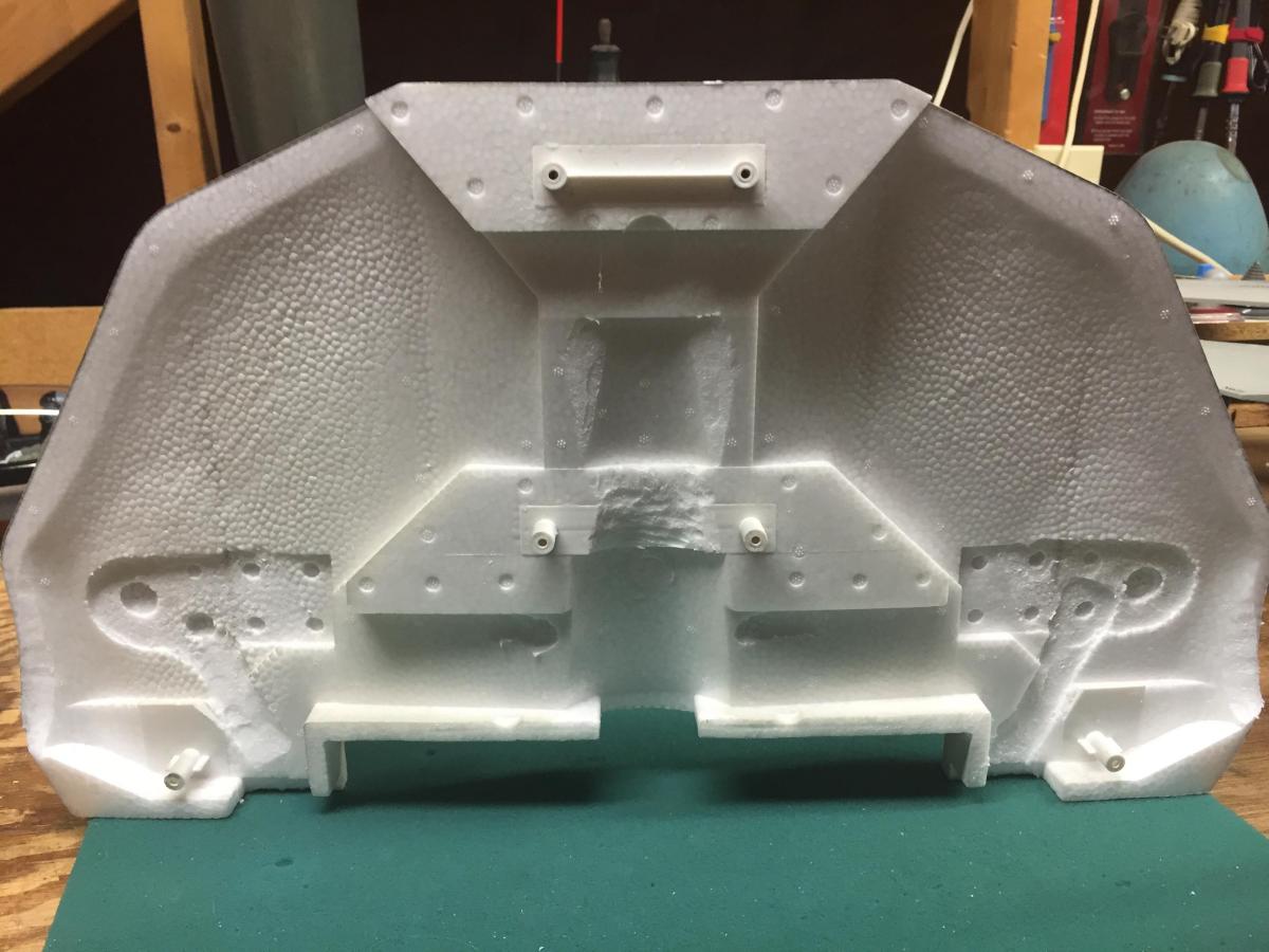

      As far as the fitment of the foam, the only bad part is the cover over the wing sweep mechanism. But we've found that if you trim the foam on the underside of the cover in certain places, it fits better.

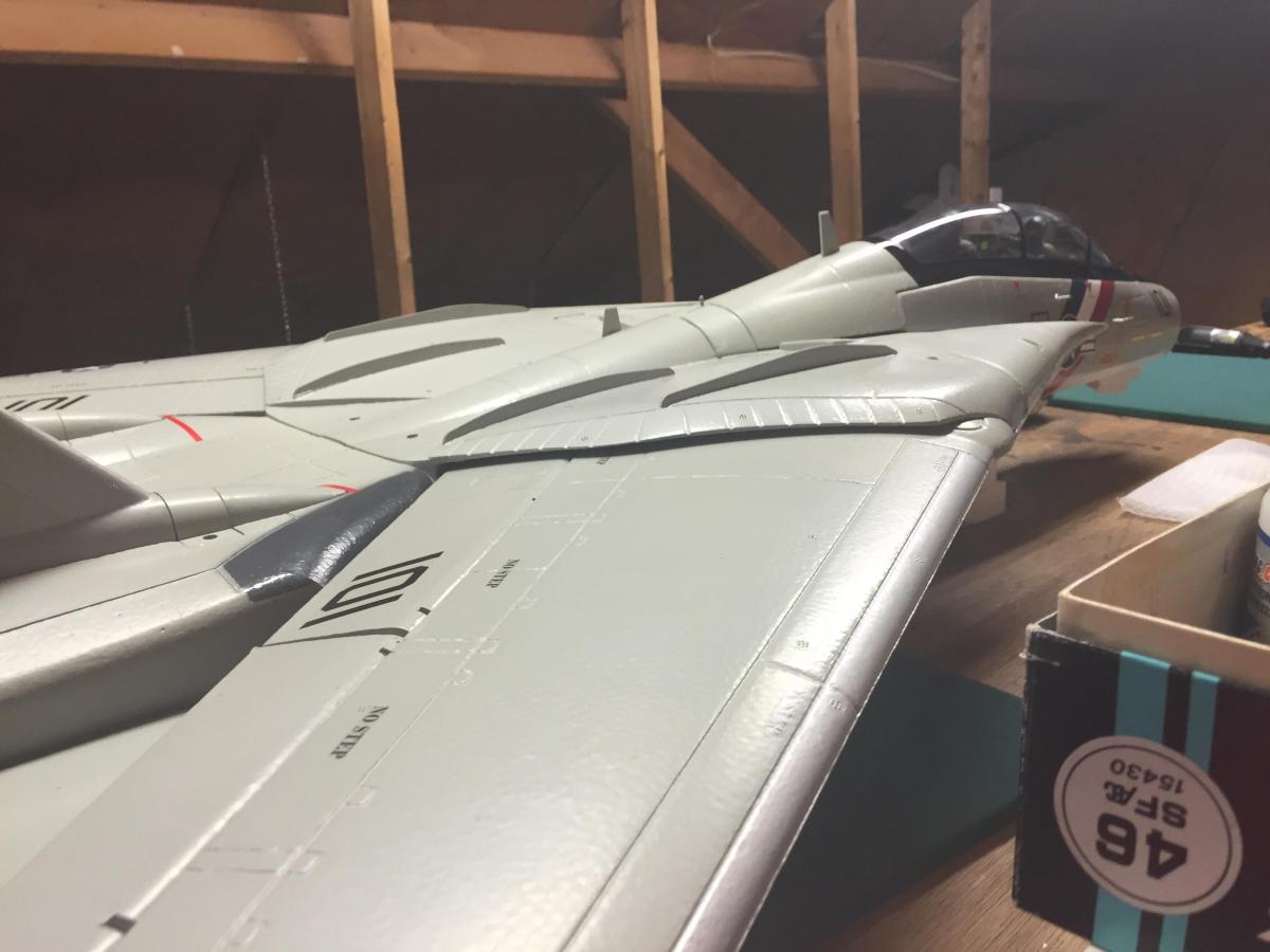

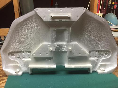

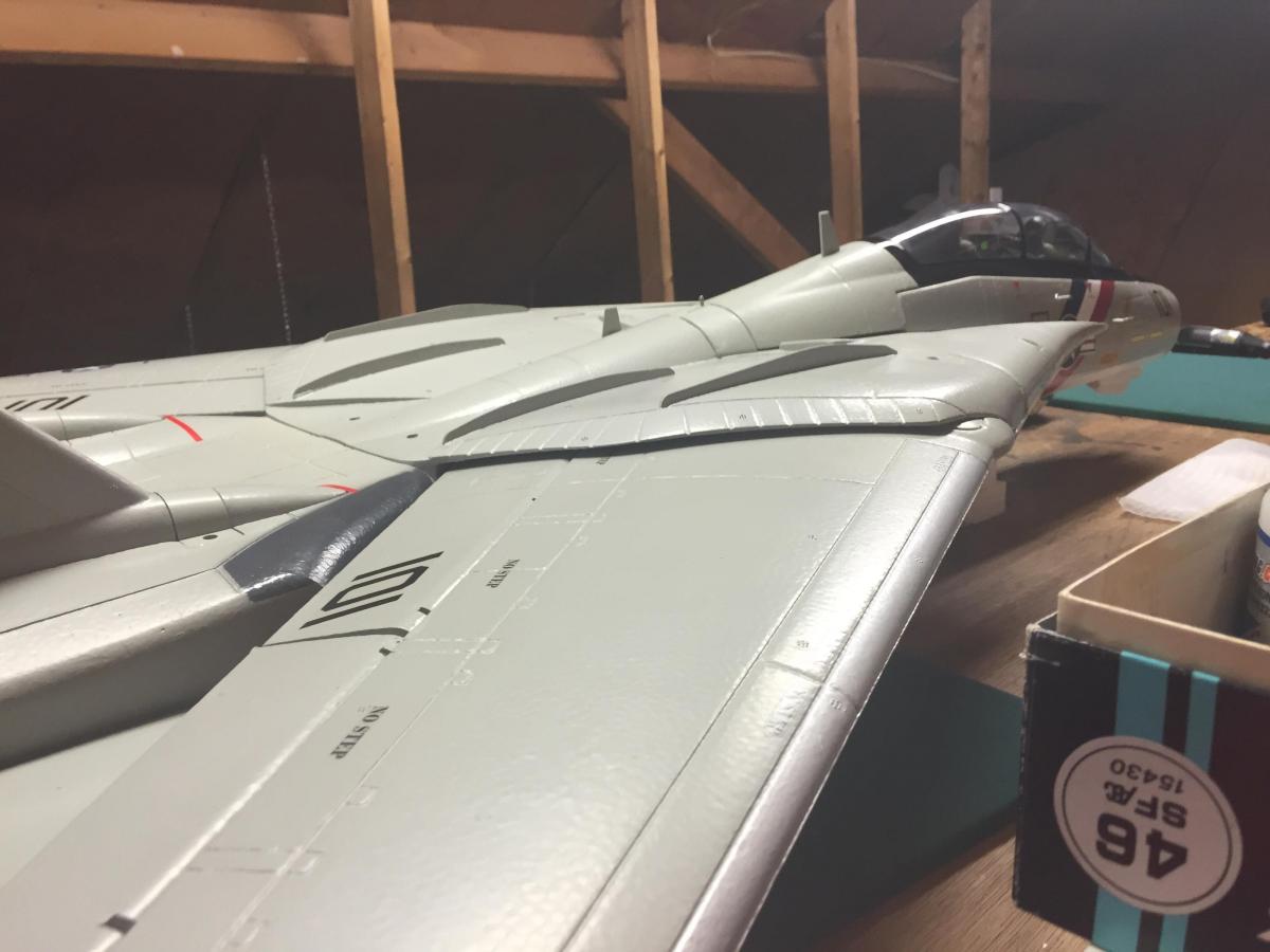

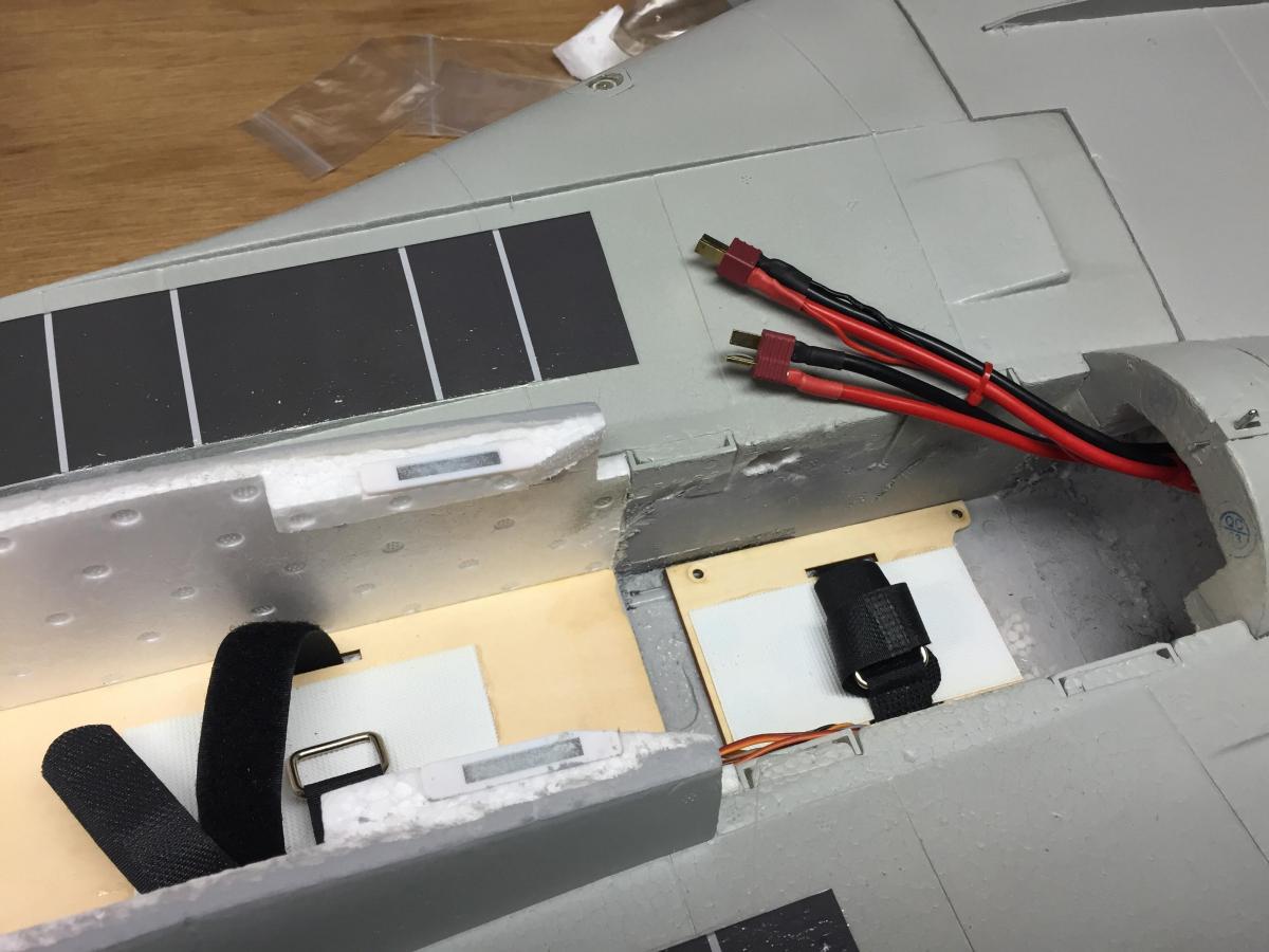

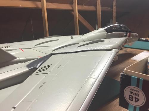

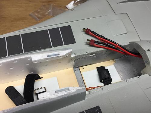

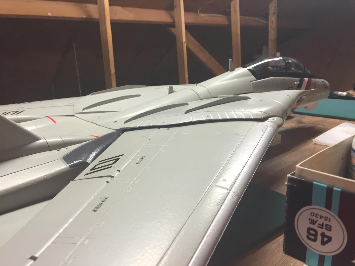

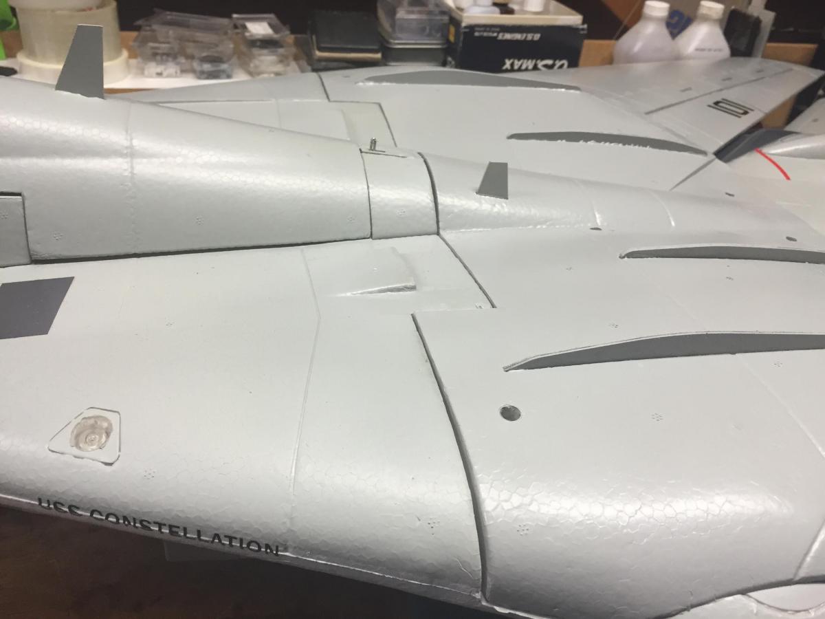

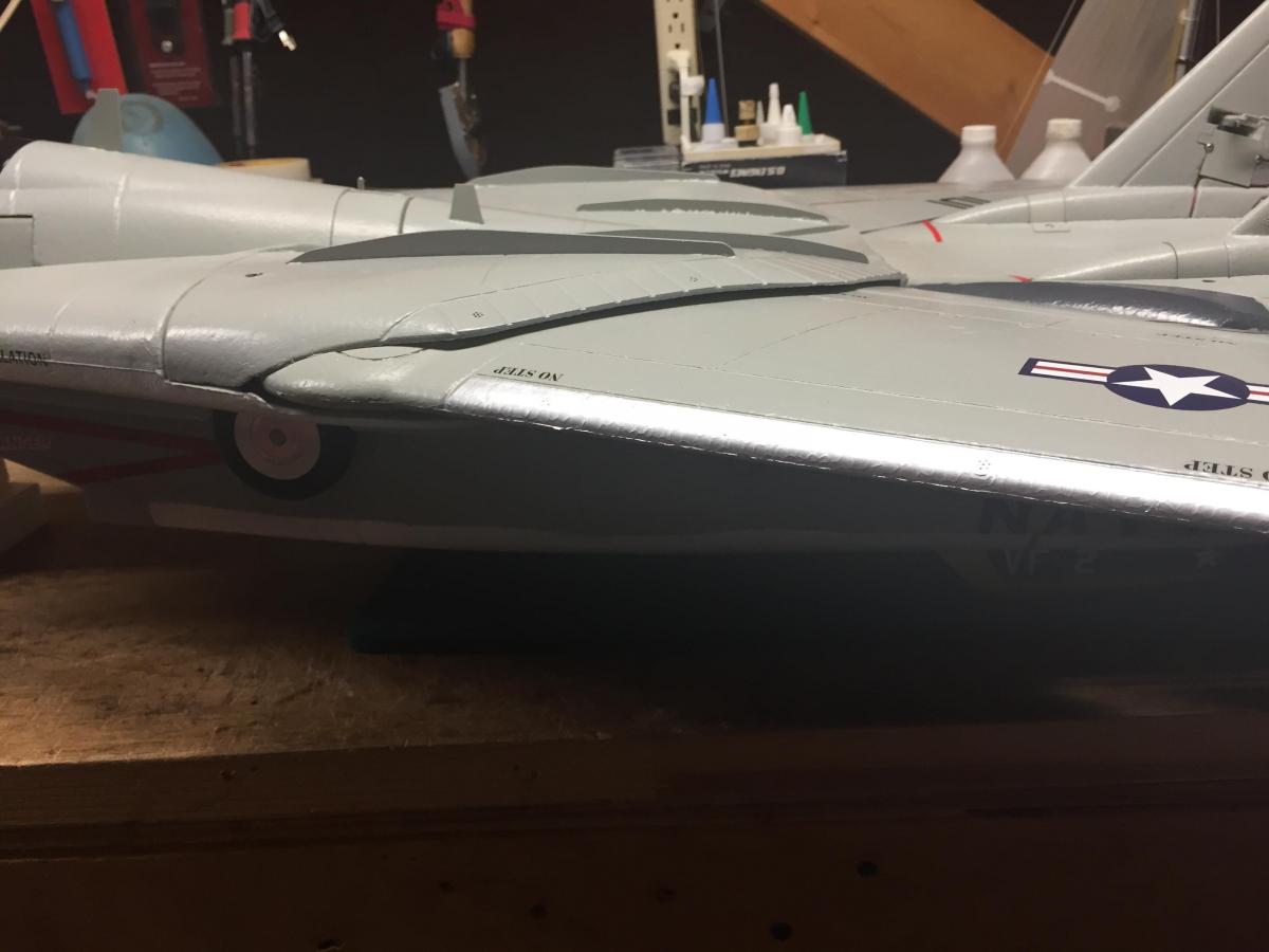

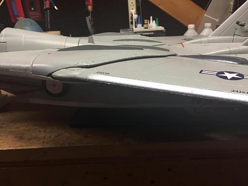

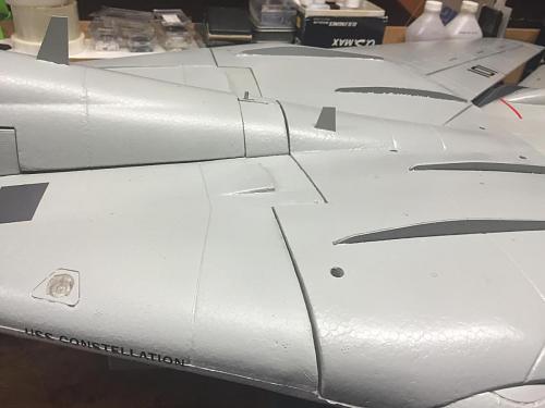

          Here's how mine ended up after a lot of work trimming and heat massaging. Also a lot of battery area clean up.

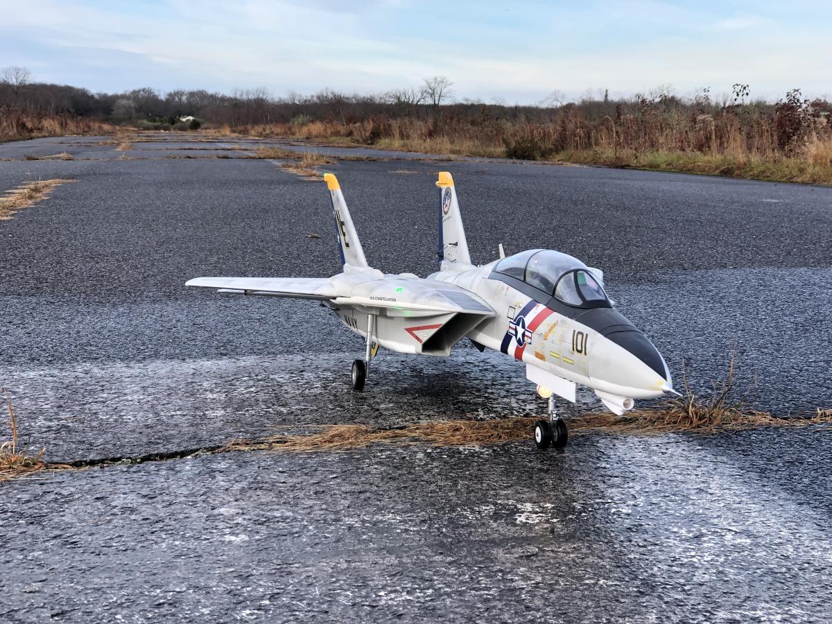

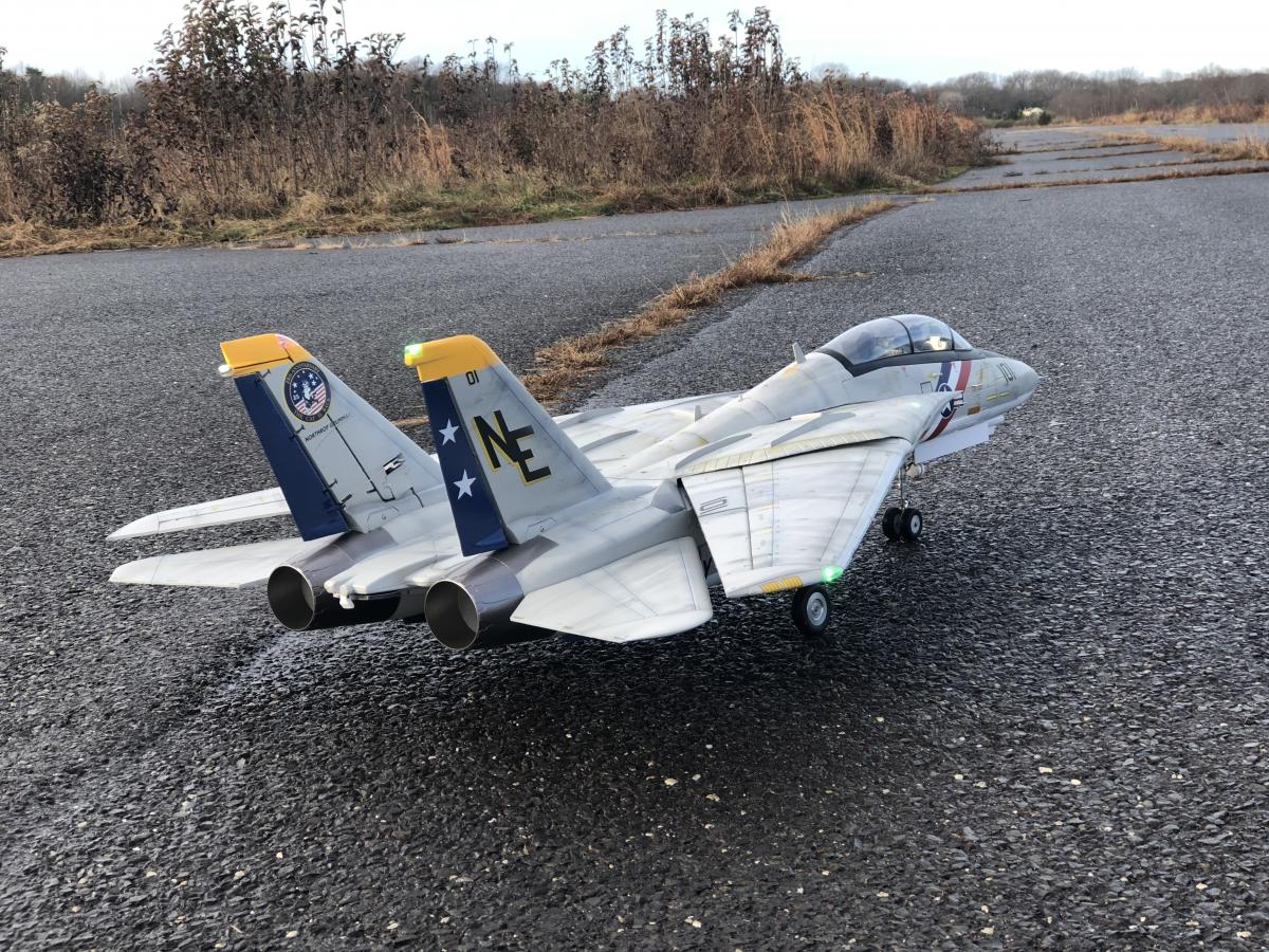

                I’ve flown mine with the a10 power system, upgraded main gear support and battery tray mod. I don’t see a need for a v2. It’s a heavy bird and most of the weight is in the swing wing mechanics. These wings are built to support this bird by just the pivot bolt so I’m sure the wings are heavier than normal carbon spar types. The only upgrade I would’ve like to see would be those rotating gear. Love my dirty cat.

                    GREAT weathering! I love it!
